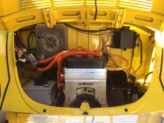

Give the batteries respect. Your complete pack will have enough current to run about 10 houses and there is no way to turn it off. It is basically a live electrical panel. Those final connections are live.

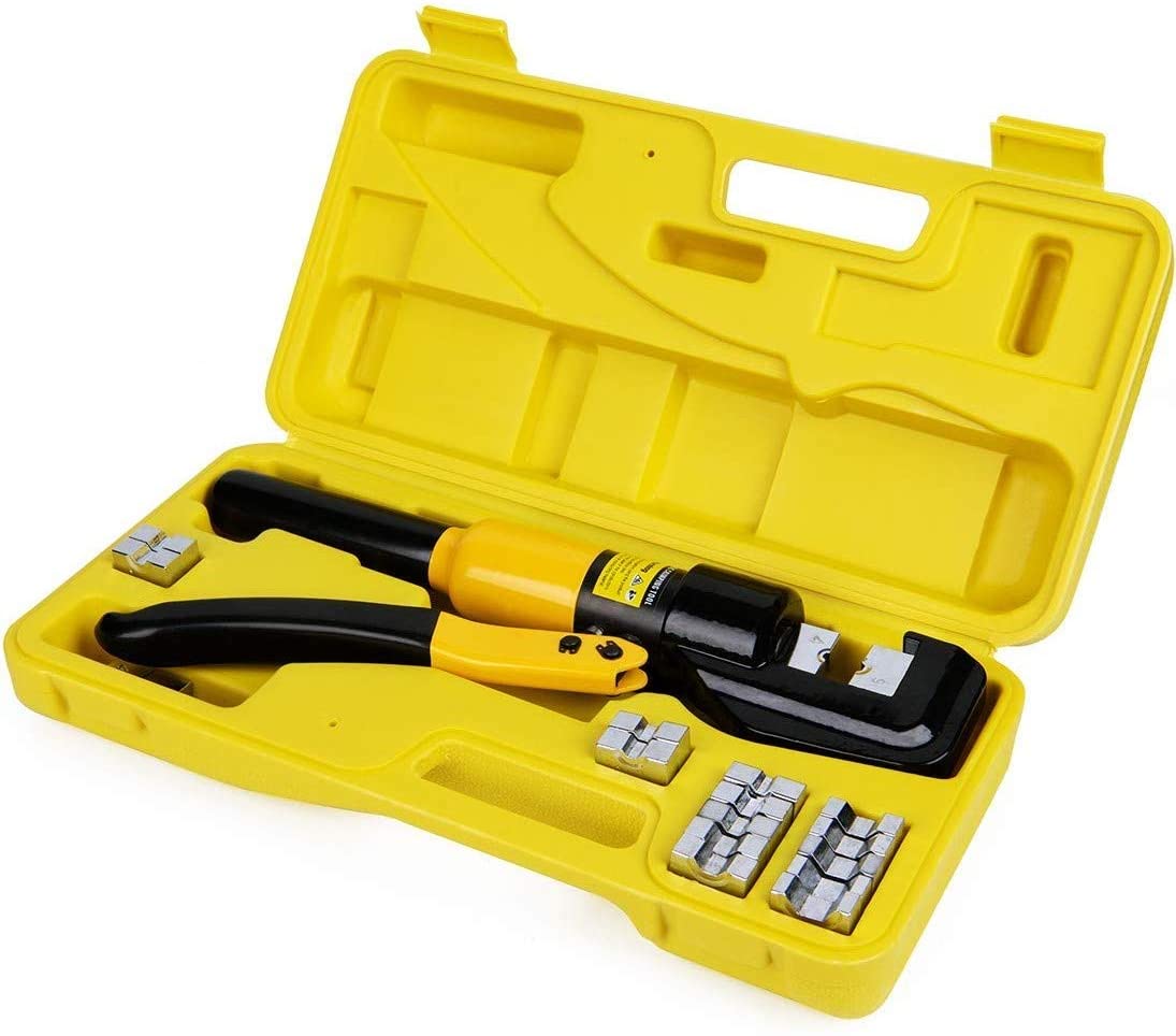

Most all my electrical tools are main brand stuff, however I did purchase this crimping tool on Amazon and I am impressed by it. A main brand large crimping tool would cost $1500 (have one at work), for $40 it works well.
Hi
Thanks for the follow! Lots of strange new tools for this project we are finding. Okay cool I will add to the list!
