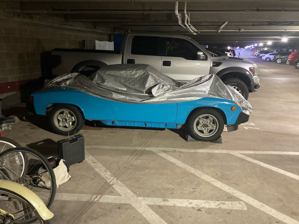

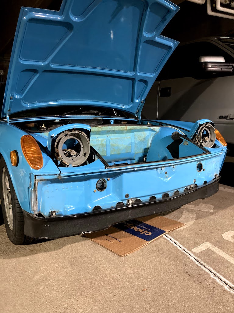

Greeting from Denver. I was at a 996 meetup a few weeks ago and started talking to a guy selling his 914 project car. A week later, I am said owner of a 1975 Laguna Blue 914 with two 2.0L motors, a couple of transmissions, and lots of parts to put it together. To top it all off, I made a new friend in the PO and have had a warm welcome into the 914 world.

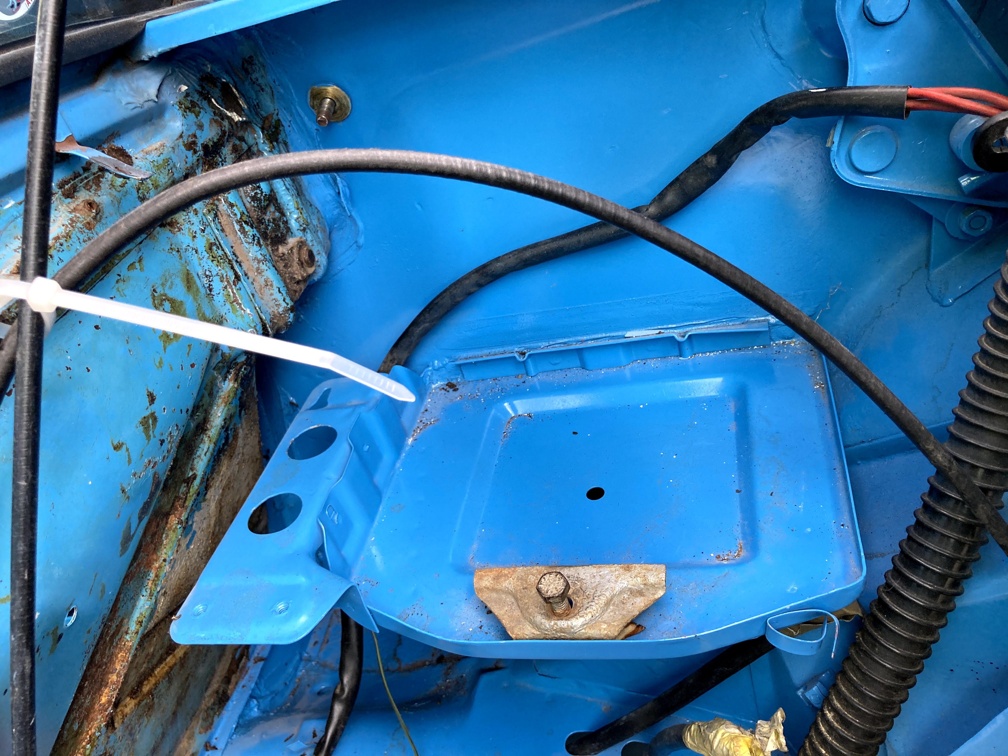

PO spent a lot of money and effort to addressing rust so I'm starting off with a fantastic chassis. I'm spoiled as I come from the 996 world where I don't have to worry about many of the issues that come with 45+ year old cars. I'm decent with a wrench, though I have no fabricating skills and have never rebuilt a motor, so this is all a learning experience.
The plan is to clean the "complete" motor and redo seals, belts, gaskets, other basic things to get it running and just drive it. Meanwhile I'll explore options on the second block, and am already looking into a 2056 build. Step one of getting the car back on the road looks relatively straightforward, but the catch is I don't have a garage/shop to work on the car, so much of it will be done in my livingroom and parking spot.
Already appreciate all the knowledge posted here and I'm finding inspiration in a lot of your builds. The search function has been my friend, but I'm sure I'll be asking questions going forward.

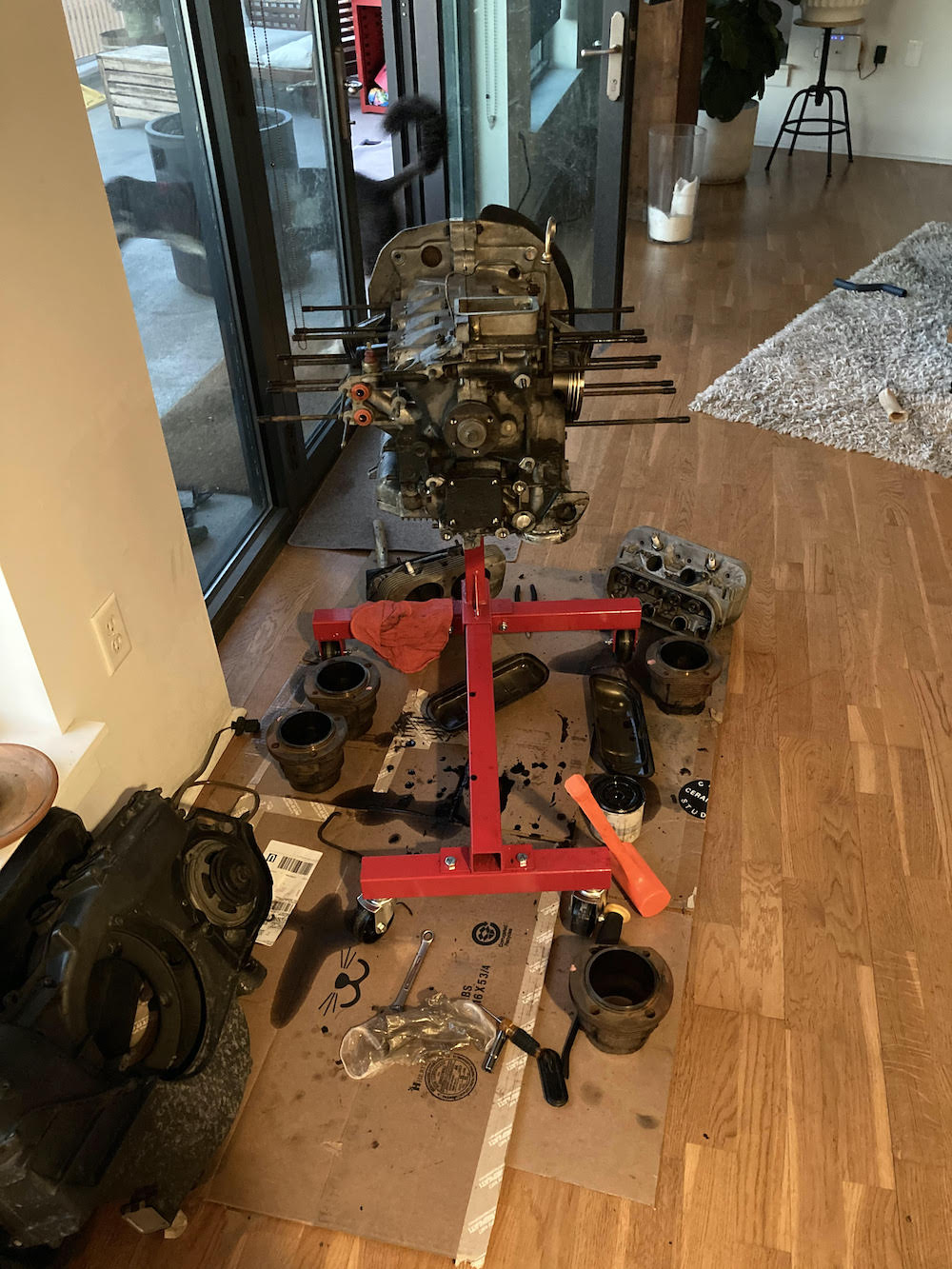

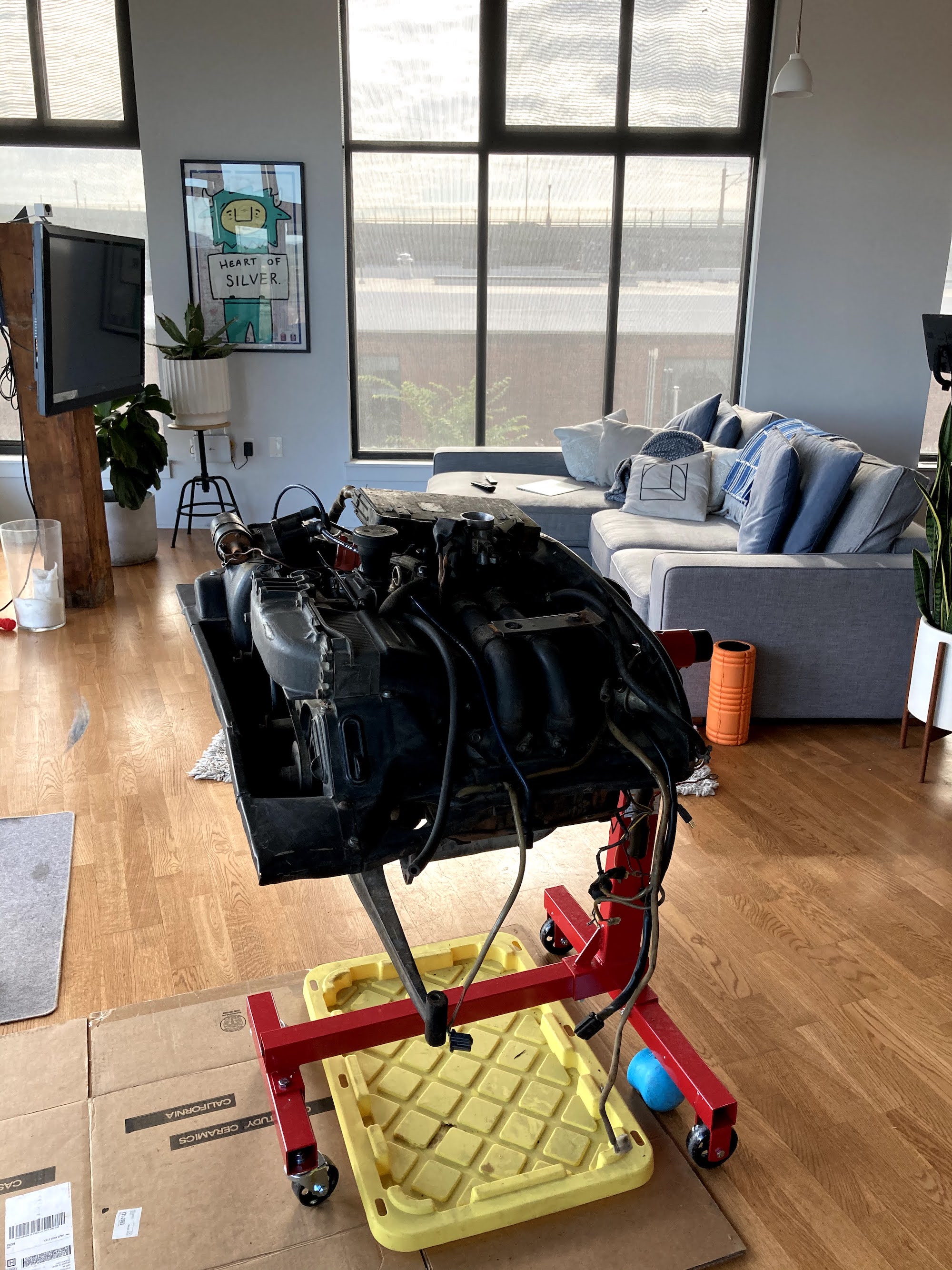

Yes, I do mean it when I said I'm tearing down the motor in my livingroom. I have a very understanding girlfriend.
Nojoah
welcome.png Looks like you have a great car to start with. You definitely picked the right girlfriend. first.gif
Cairo94507
What a terrific color and nice chassis. I don't think I could get away with the engine in our home, but you got a keeper there if she allows it. beerchug.gif

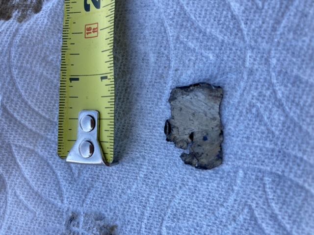

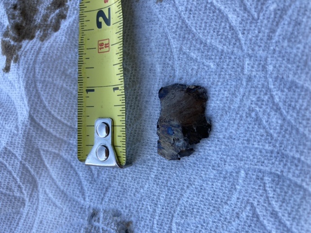

Just a few days in and I already have a scare. I’ve pulled tin off the engine, cleaned everything I could, and ordered hoses, hardware, and seals. I just opened the oil filler neck and saw something at the bottom of the chamber. I grabbed a magnet, and this 1” piece of metal shot out.
Does anybody have a clue as to what this might be? I’m hoping it’s a foreign object and not a piece of the case, but I’m stumped as to where it came from. My hope with this motor was to run it without splitting the case, but that plan is in doubt now. The metal piece has jagged edges and is shiny. Any guesses are appreciated.

Opened the sump plate and it’s metal city! Looks like it’s time to split the case and check the damage.

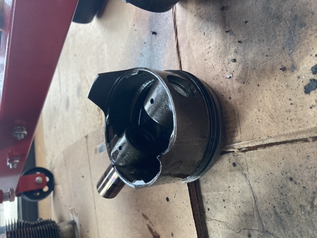

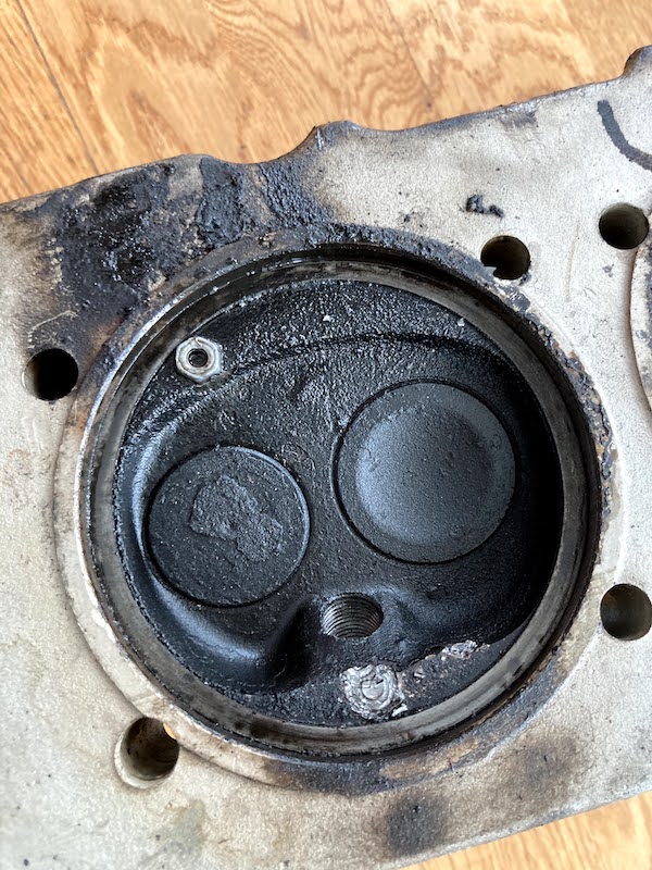

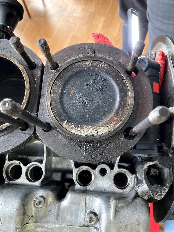

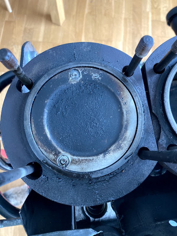

If I were a betting man, I’d say this could be the problem. The remains of piston #1...how does this even happen?
IronHillRestorations
Friction from worn rings, or a bad rebuild

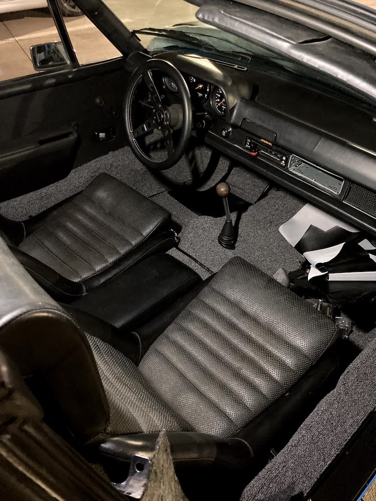

The car made its way home with me today and is ready to be reassembled! It's amazing how small the 914 is compared to my 996 2S. Having not run across major issues yet, my super ambitious and 'straight forward" plan is:
Interior
- Test electric and start to button up the cabin
- Replace dash
- Install door cards
- Install perlon backing
- Install carpet
- Install seats
- Door cards
Suspension & brakes
- Get tires mounted
- Install new front/rear rotors and hubs (5 lug conversion)
- Mount rebuilt calipers
Fuel
- Install all new hard lines
- Install all new fuel hoses and filter
- Install gas tank
Exterior
- Paint side skirts
Motor
- Reassemble 2nd 2.0 that came with the car and run it ASAP
- Build out the second 2.0 into 2056 perhaps over the next 1-2 years
- Rebuild the second transmission using Dr. Evil's course
Having just typed out that list, it feels a bit daunting but really excited to get going and build my first car! Also, the dog is already upset about how much attention the car is taking away from him. Hope to reward him with a wind-filled drive this fall.

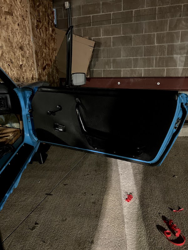

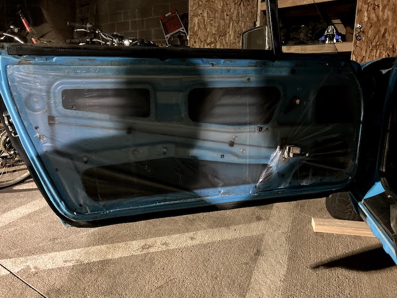

So I started the weekend off with an easy project - getting the door cards out of my storage unit and mounted. There are a number of writeups on the topic, but I purchased some 3M double sided tape from Amazon, HDX 2mm drop cloth (had laying around), and the Auto Atlanta door panel hardware kit.
Despite having 15ft of tape, I still ended up about 1.5 feet short on the bottom of the drivers' side door. If I were to do it again, I would left a 9" opening in the middle of both sides.
The AA kit comes with 3 rubber nipples that I assume are supposed to go into some of the holes. I couldn't find a good diagram online or in any writeup as to where to place these, so I ended up leaving them out. The 9 plastic rivets clipped in securely and I regret not ordering more speed clips as some were missing from my door.

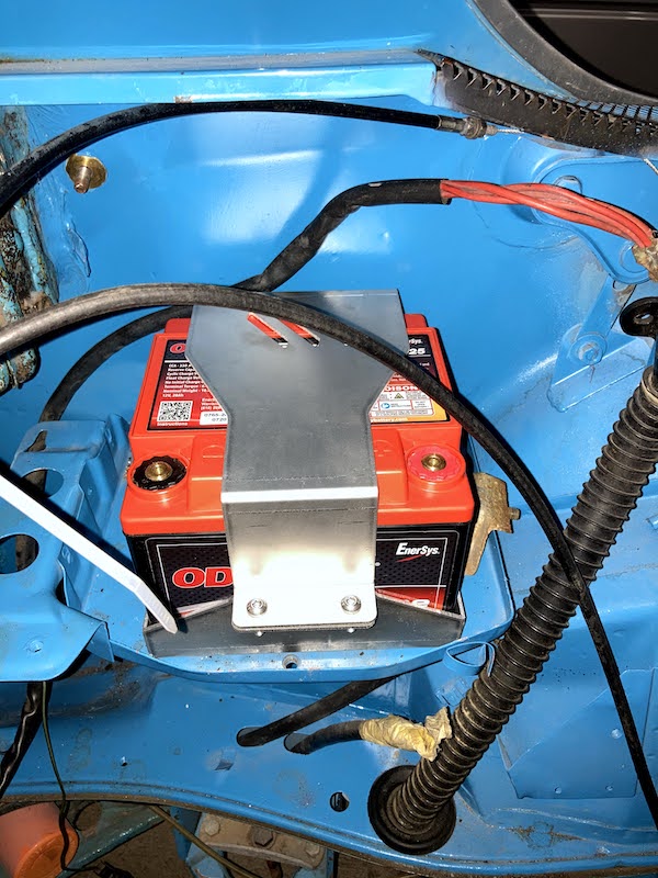

Thanks to @fiacra and @rfinegan for the battery write-ups. I ended up purchasing an Odyssey PC925, as well as ebay battery tray and SAE terminals. Battery fits very snug in the mount, but the lip seems to stick out too far to allow the Porsche battery bracket to fit over it. I've got to play with it still, but materials-wise I;m sitting pretty at the moment

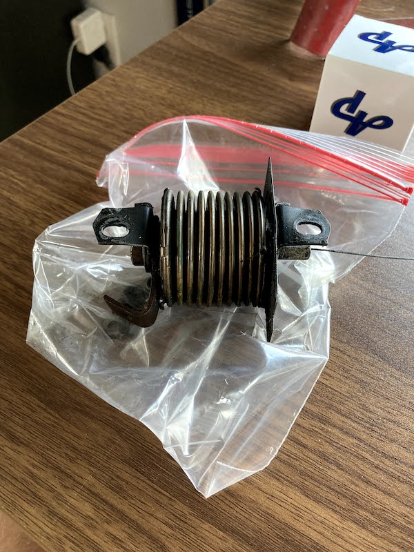

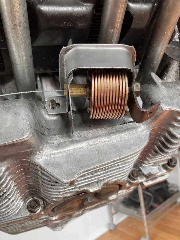

Thermostat bellows were blown, so a quick search pointed me (and my wallet) in the way of Awesome Powdercoat.
The new brass hex screw that came with the kit was slightly larger diameter than the old one, so 5 minutes with the Dremmel opened up the hold in the side of the bracket enough to ensure the thermostat can expand without binding.

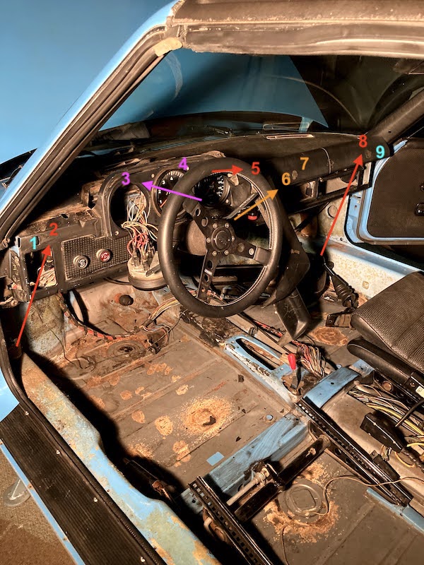

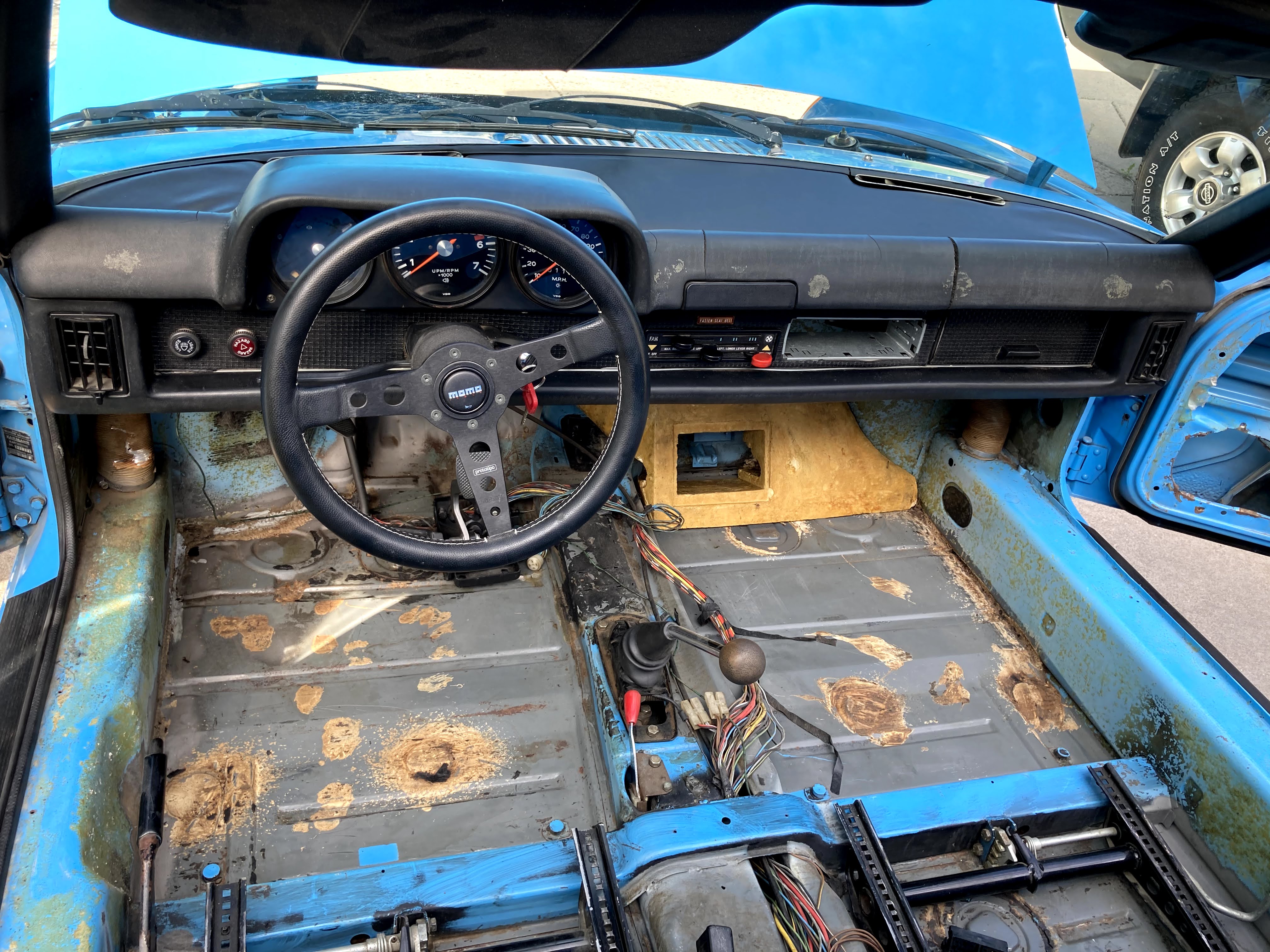

My car came with a cracked dash, as well as 2 spares (one in worse condition, and another in ehh shape, but better than the installed one). I'm having a drink now, but I sure should have had 3 before taking on this project.
I was able to get the lower dash (knee pad) off easily, but with it can clouds of dust and dirt. I took my hand and banged on the metal bar that the knee pad attaches to and with each thump saw waterfalls of debris coming out from the dash. I did this for 5 minutes until there was nothing left to rain down. I don't know how so much crap got lodged up there, but I filled up a vacuum canister from what came down.
Now on to the upper dash. This took way too much trial and error even with forum instructions. Maybe I'm bad at following directions and have too large of hands, but please see below for what worked for me to access the hidden nuts. I worked my way from left to right, ripping off disentegrated dash as I moved on. FYI all nuts are 13mm
1. Used a crow foot wrench inside the vent to loosten, then removed by hand
2 used a 1/4" 13mm deep socked and extension. Started from the hood release and worked back up towards the dash to access the nut
3 I did not remove the instrument cluster or steering wheel. I removed oil temp gauge and used a 13mm wrench to slowly access the nut hidden way back under the sheet metal. This was the most difficult one to access and because I don't have thin/narrow wrenches, it was a drawn out process of 1/3 turns and resetting the wrench
4 same as #3, but removed the speedo to access
5 red arrow should be pointing straight up as I used the same methodology as with nut #2. A long extension and deep socket should allow you to loosten and remove while looking up from underneath the dash. To reinstall, keep the speedo out and use a crow foot wrench and your fingers to tighten the nut just to the right of the opening.
6 make sure your radio is out to get access. again get under the dash and look up. you should be able to use a nut driver or crow foot to loosten the nuts and then pull them out by hand
7 see #6, you should be able to access both nuts at the same time
8 remove the glove bot metal strap. it is next to nut #7 and held on by a 4mm?? nut, . you don't need to pull out the entire glovebox, just loosten the strap. at that point you can get back on the floor and use same method as #2 and #5. Long extension to loosten, pull out by hand
9 crow foot wrench going through the vent up and to the right. probably 5 small turns to loosten it and then unscrew by hand
By now, your back is sore, your fingers are dirty/bloody, and your neighbors have learned a couple of new curse words. Congratulations! You should have 9 plastic nuts and metal washers. The dash should pull up and out. installation is the reverse. you now deserve another drink.
Anyways, I hope this helps at least one person out there that is frustruated with removing the dash and is wondering why no combination of socket set is getting the job done.
The installation is really a PITA. But at least at that point you know where the attachment points are. And your vocabulary is up to speed. The local crew got together and did one of these a while ago.

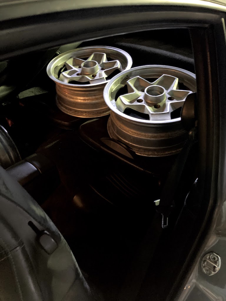

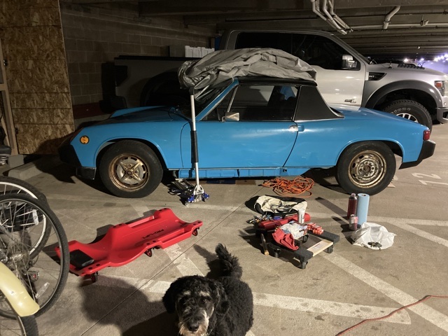

I am tackling the 5 lug hub conversion this weekend. 2 concerns right now:
  1. I have brand new front hubs in a box. It would appear that the PO fully installed and seated the inner and outer races into the front hub assembly, but I do not see any signs of grease. Do I need to remove the races to ensure they are greased, or would these be ready to install?
  2. It appears that Swepco 101 is the hub/bearing grease of choice. Can't find it anywhere in Denver on short order. Have others had success with Lucas X-TRA heavy duty grease? It looks like what @iankarr uses in his install video, but always nice to get group feedback.

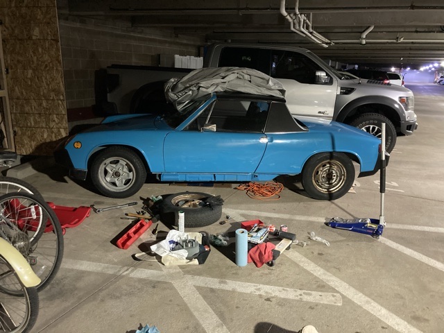

Fronts done. Rims look rough, but really happy with how the 5 lug conversion bolted up. Tried to remove the nut on the rears and broke my socket extension. Off to HD for an impact driver and to try the rear again tomorrow

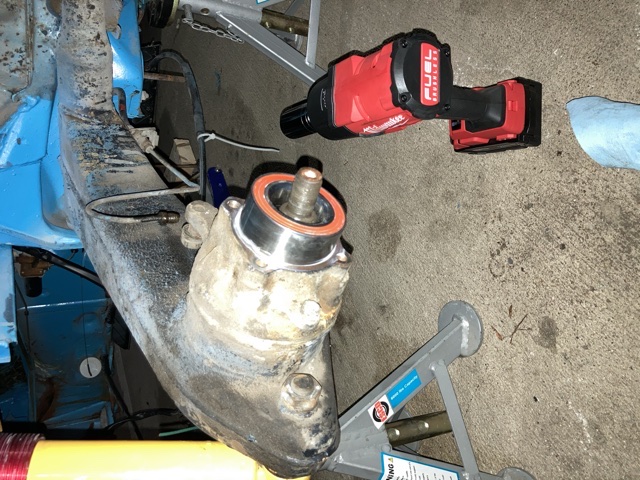

Old bearing out, new bearing....stuck. Had these in the freezer over the last week, used grease, nothing!
On to plan B...bearing kit rental from Oreilly
iankarr
Tough to tell for sure, but from the picture it looks like the bearing went in crooked. Decent chance that bearing won't be re-usable, so you prob want to have another on-hand in case...
andrewck
QUOTE(iankarr @ Sep 20 2020, 04:31 PM) *
Well a bearing press made easy work of re-inserting the bearing. Based off your comment, not sure it may be a great idea to reuse it. How will I know if I made a mistake in re-inserting it. It certainly didn't feel wobly or lose when I got it seated.

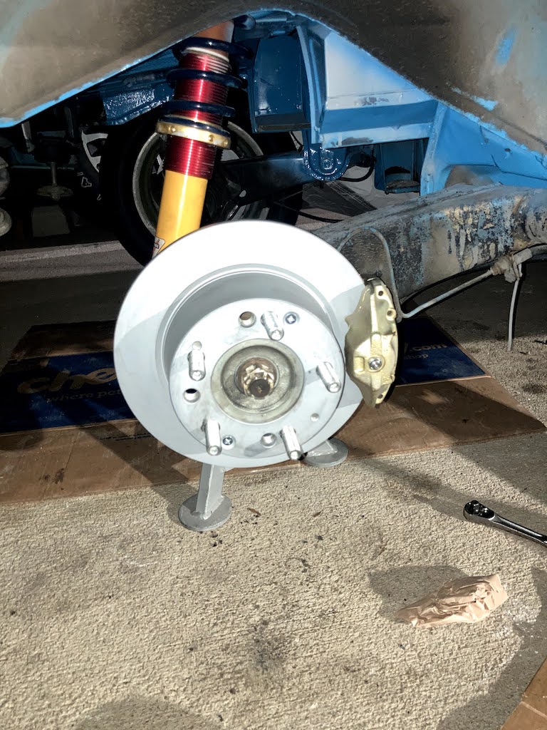

Rotors, pads, and calipers installed. There is binding between pads and rotors, so will need to adjust the calipers...which I hear is not fun. Calipers won't sit flush to the trailing arm, so need to also figure out how to torque them down.
Had a friend help install the stainless fuel lines through the tunnel and in the engine compartment. Hope to get fuel lines installed this weekend and the fuel system buttoned up. One more thing off the list.

Got around to working on the replacement motor today. Turned it, and it spun 359 degrees, then stuck. Tried it again...same result. Pulled the motor apart and found this mess. It appears that a PO dropped a nut into the motor and at some point it went BOOM. But I was told the motor was good when it last ran...
At this point, I'm 0/2 on motors that came with this car. There is a 3rd motor, but I'm not willing to chance anything even though that motor turns over. Complete teardown and rebuild coming and I'll go to a shop for machine work. The question is do I go 2056 at this point? Will start calling shops in the Denver area starting tomorrow, and explore what my other options are.
To say I'm disappointed is putting it lightly.

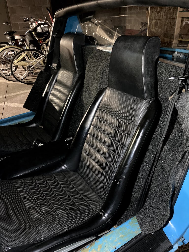

andrewck

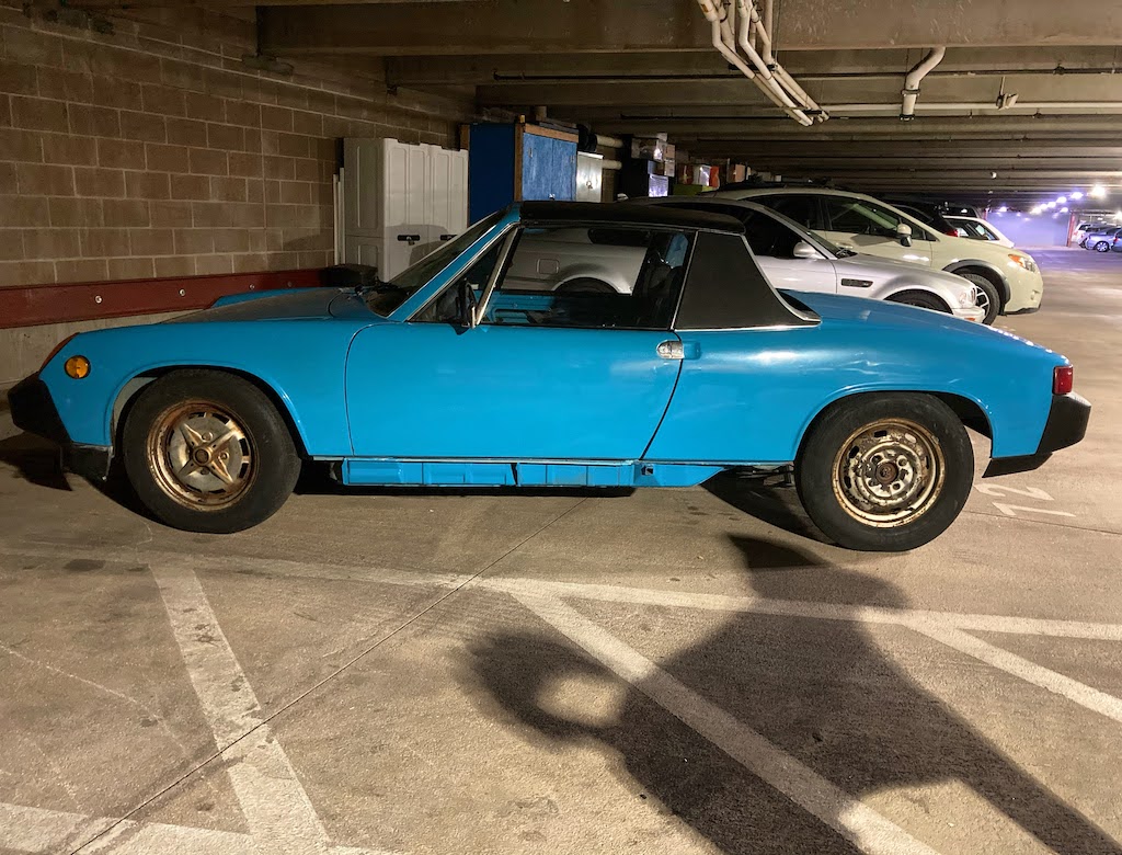

It's been a while since I've posted progress, but the car has slowly been coming together. All parts ordered for the 2056 motor rebuild and assembly should start in the coming weeks.
Interior has been finished (perlon backing off ebay) and a newer carpet kit

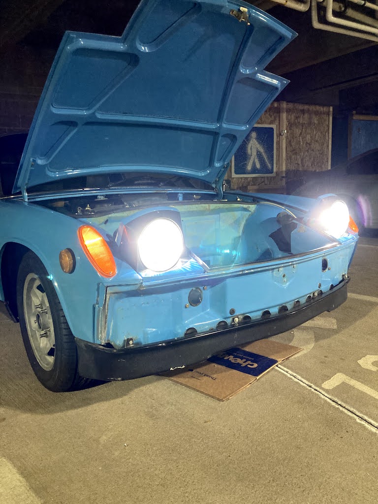

LED headlight kit from 914Rubber arrived the other day and got install this morning

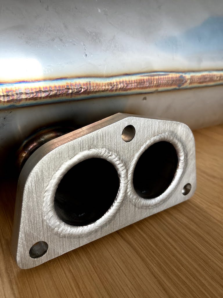

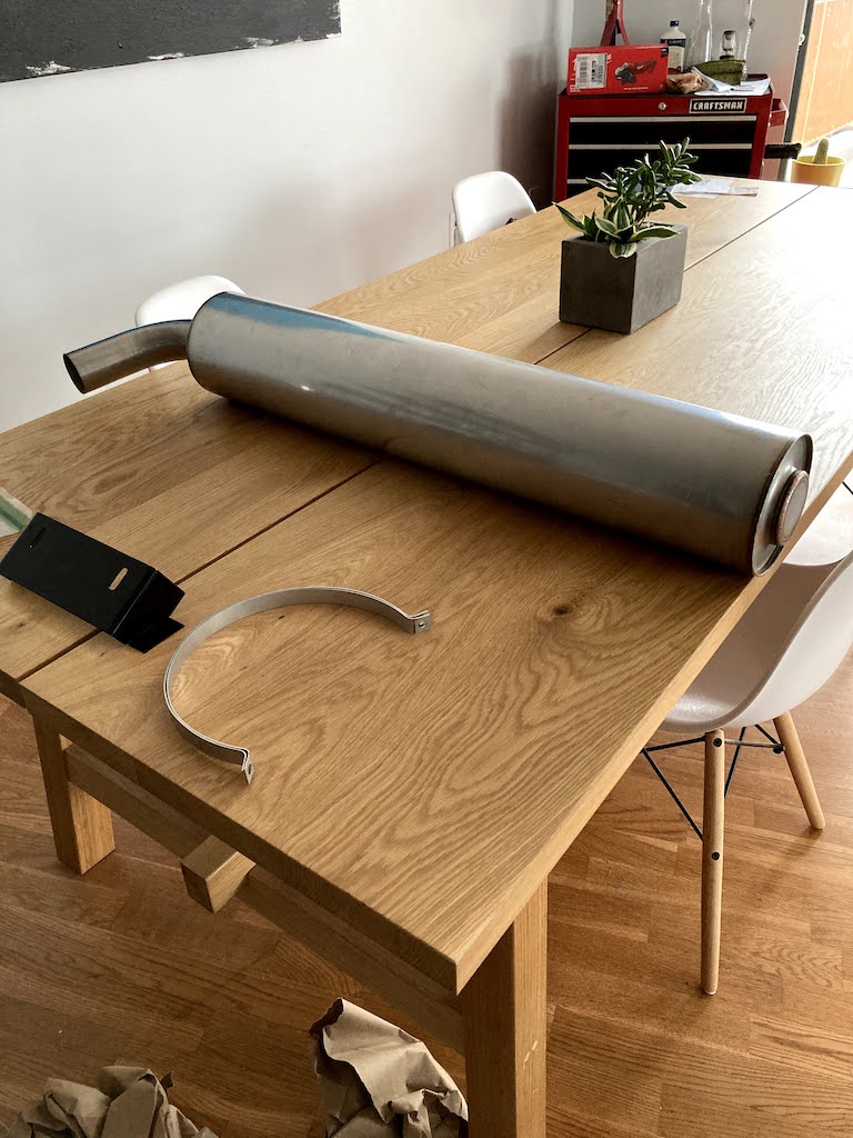

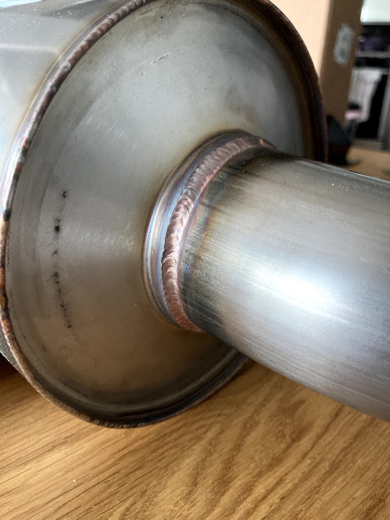

Ben's muffler arrived this afternoon, and....well you just have to see it to believe it. The welds are art and I feel bad to cover them up.
Excited for the next few weeks as things hopefully come together quickly
