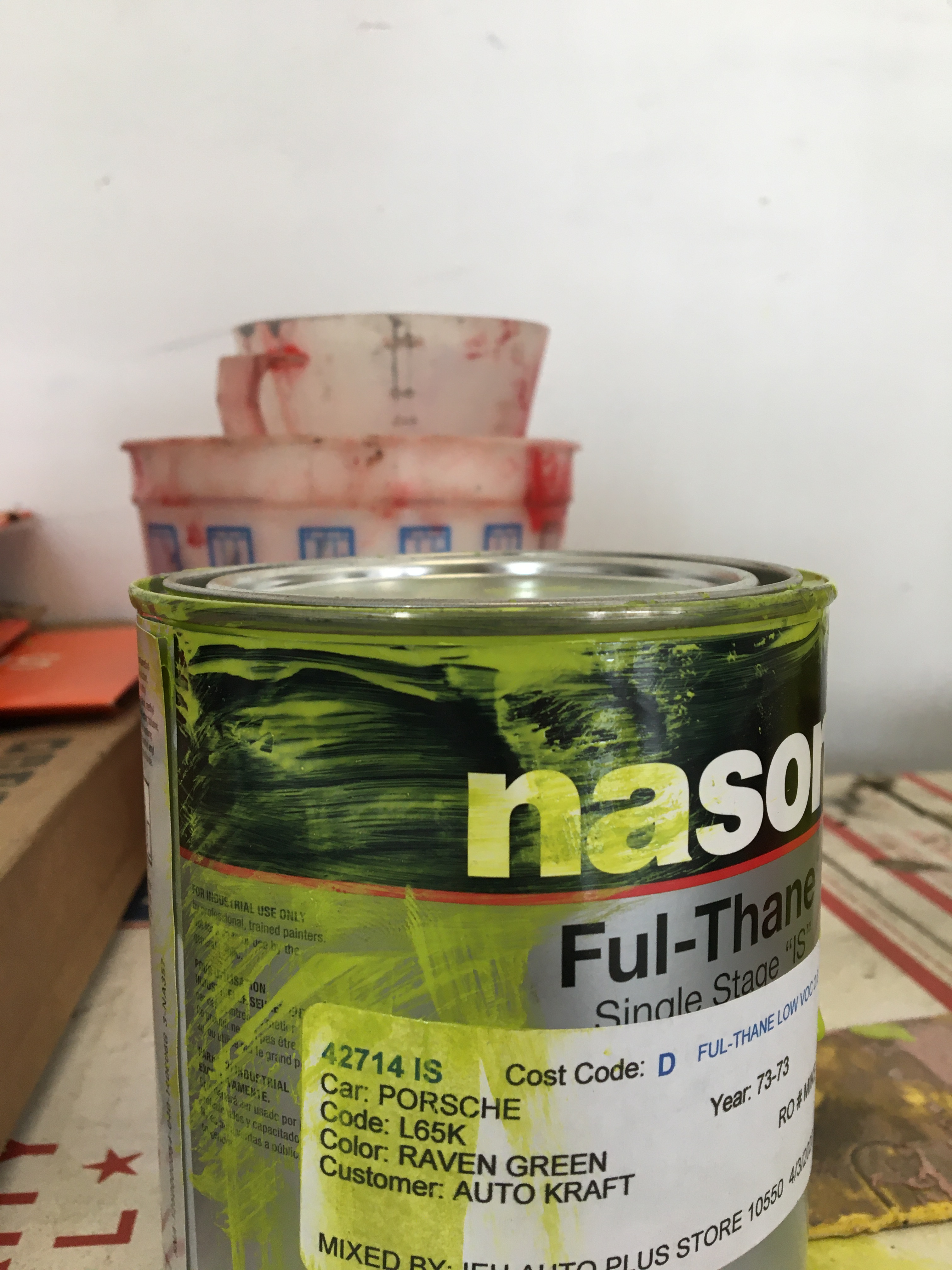

This is what I used.Click to view attachment

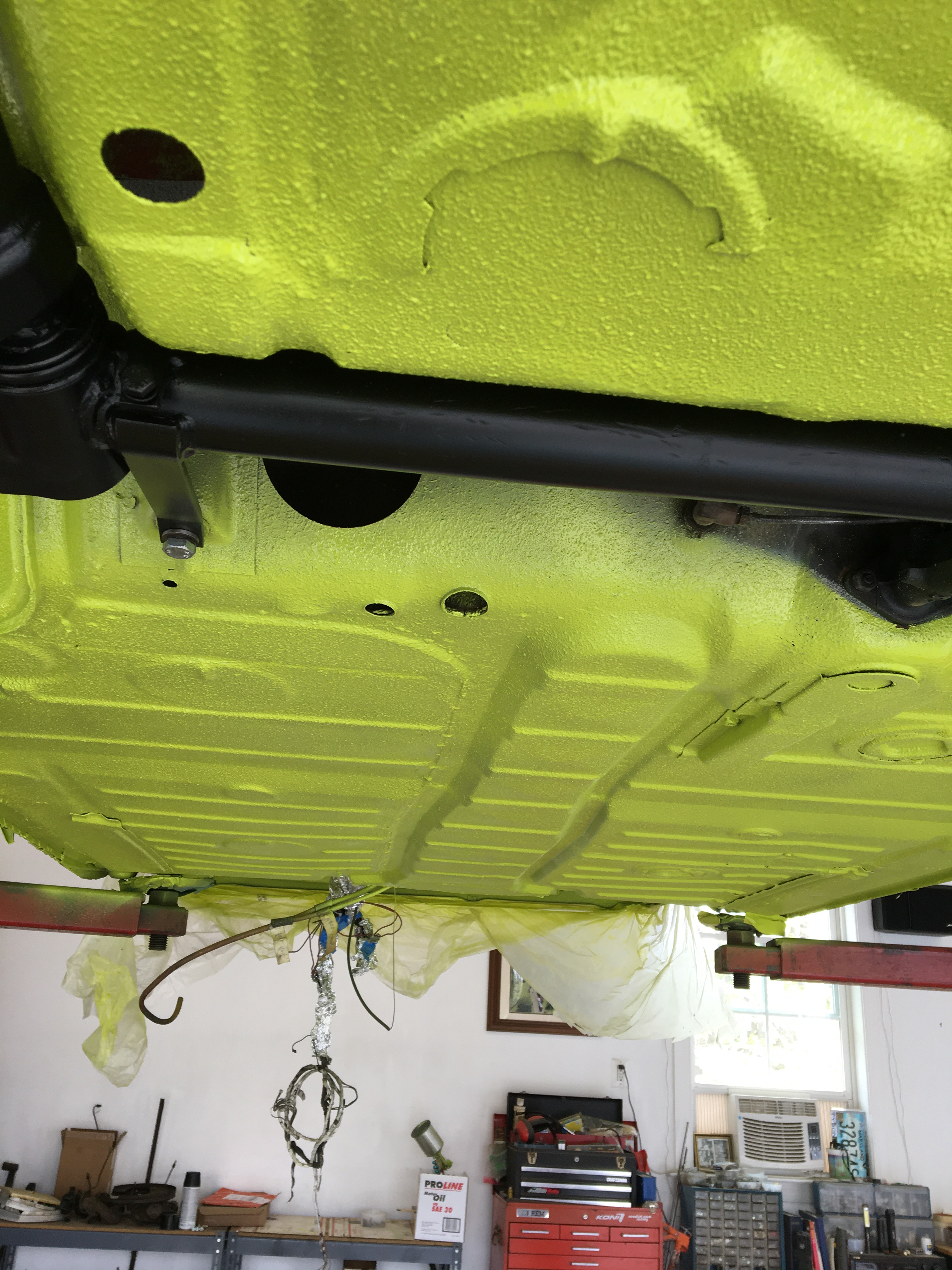

Turned out perfect . This is single stage ,no clear coat.Click to view attachment

partsman912
Bottom is as nice as the top . This was the first time using Nason (you may remeber them as Dupont) paint .Always used PPG in the past but the local supplier went out of business. I must say it was wonderful to use if you go by the spec sheet directions. Car was down to bare metal used epoxy sealer first then medium build primer before putting down 3 coats of color.
