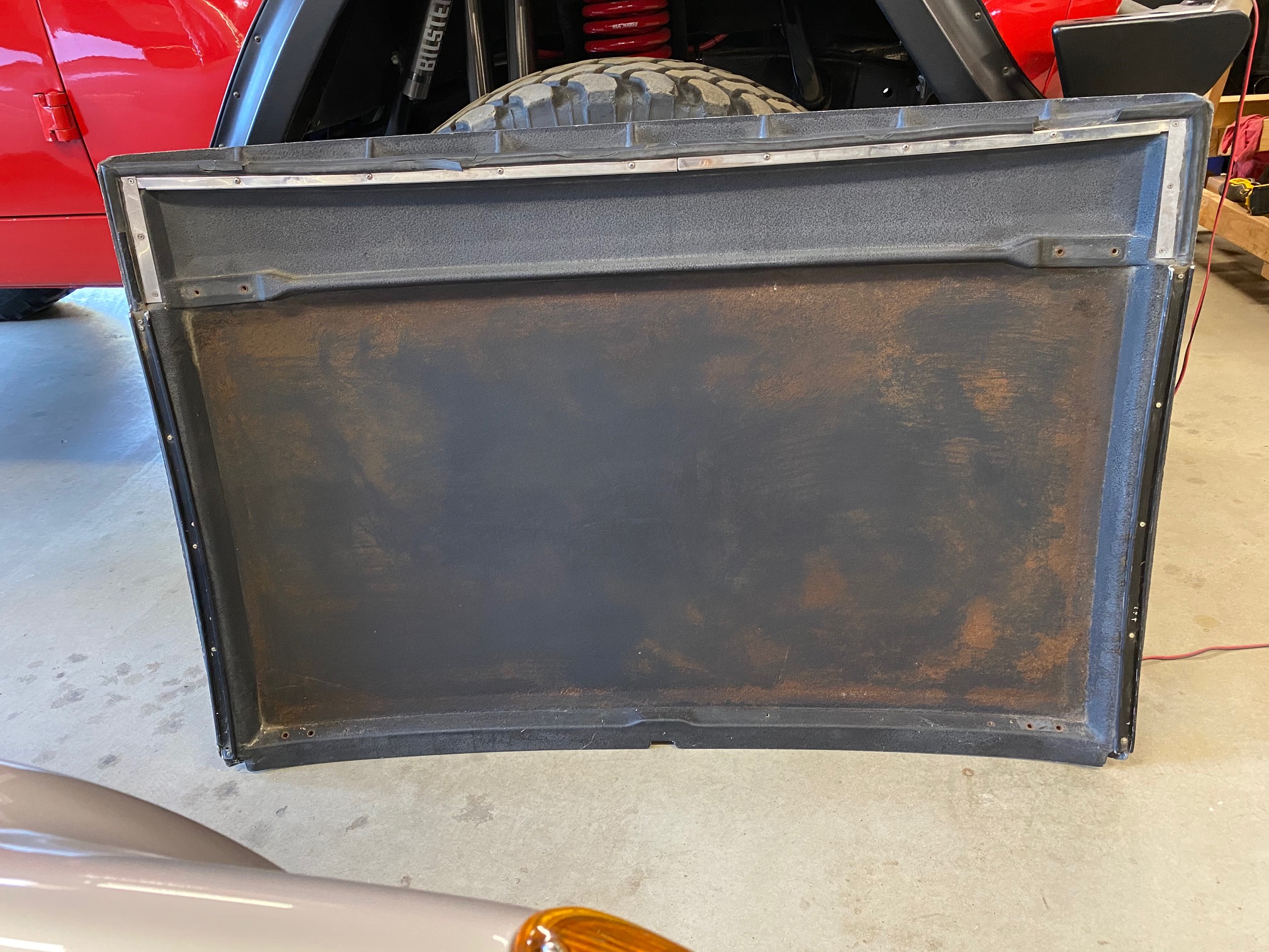

ClayPerrine
I have a lot of recent experience with this.
The top must be matched to the type of window regulator. If you have early regulators, you have to have an early top. If you have late regulators, you have to have a late top. It has to do with the seals and how they meet up to the top edge of the windows.
I know this for fact. My red six conversion (Igor) is a 73, and the top (painted to match the car) is an early top. So the seals don't fit right, and they leak. The top on the Blue 70 914-6 (Elwood) is a late top on an early car. The seals don't quite reach the top edge of the windows. So I added an aluminum strip between the top and the seal mounting track. They actually touch the windows now, but they don't fit right either.
I actually took the top of the red car and put it on the blue one. The seals fit fine when I do that, but the car looks really funny... biggrin.gif
I have a early top that I am going to get refinished like they did at the factory for the blue six.
Also, a 70 914 didn't have a headliner on the underside of the top.

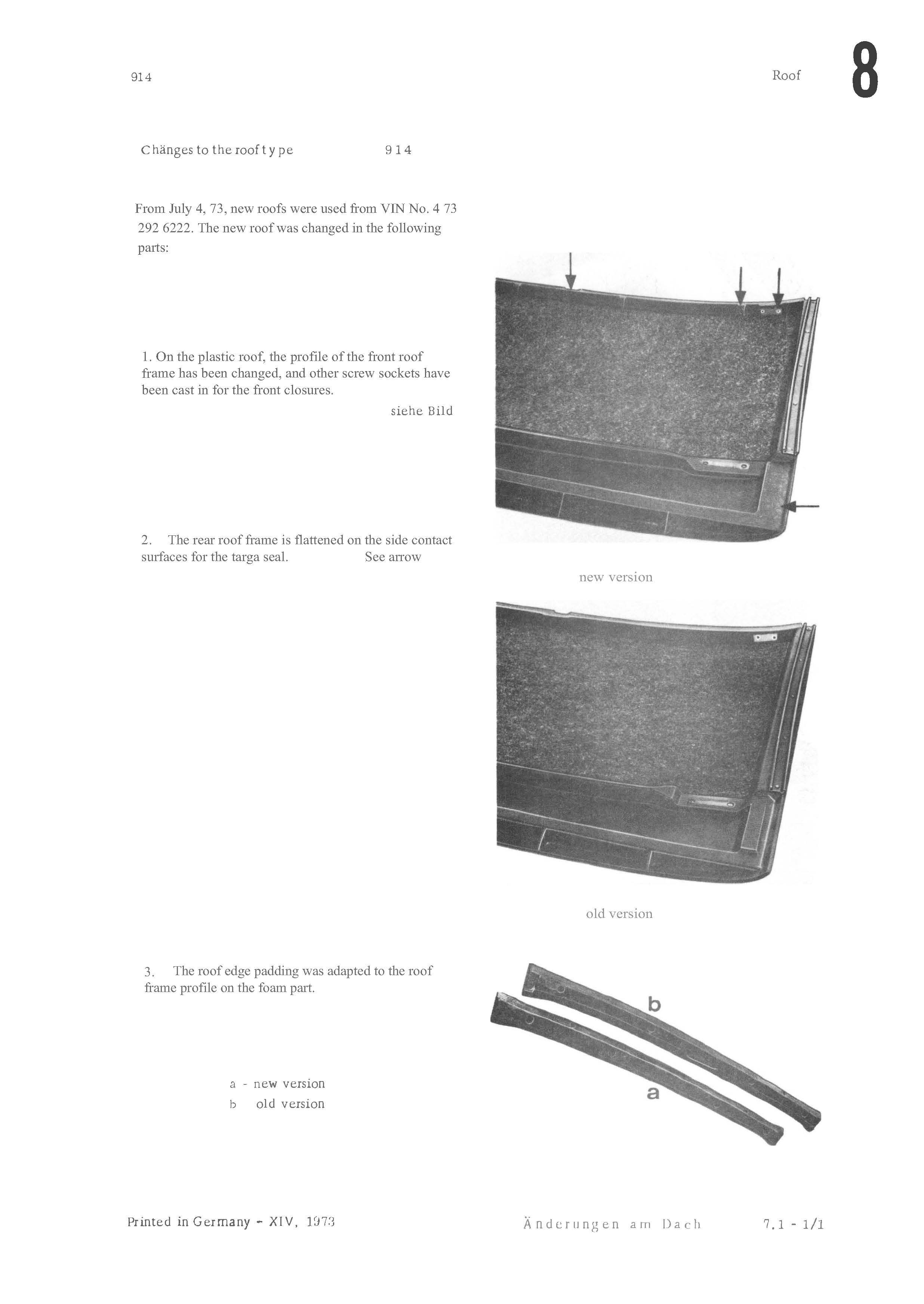

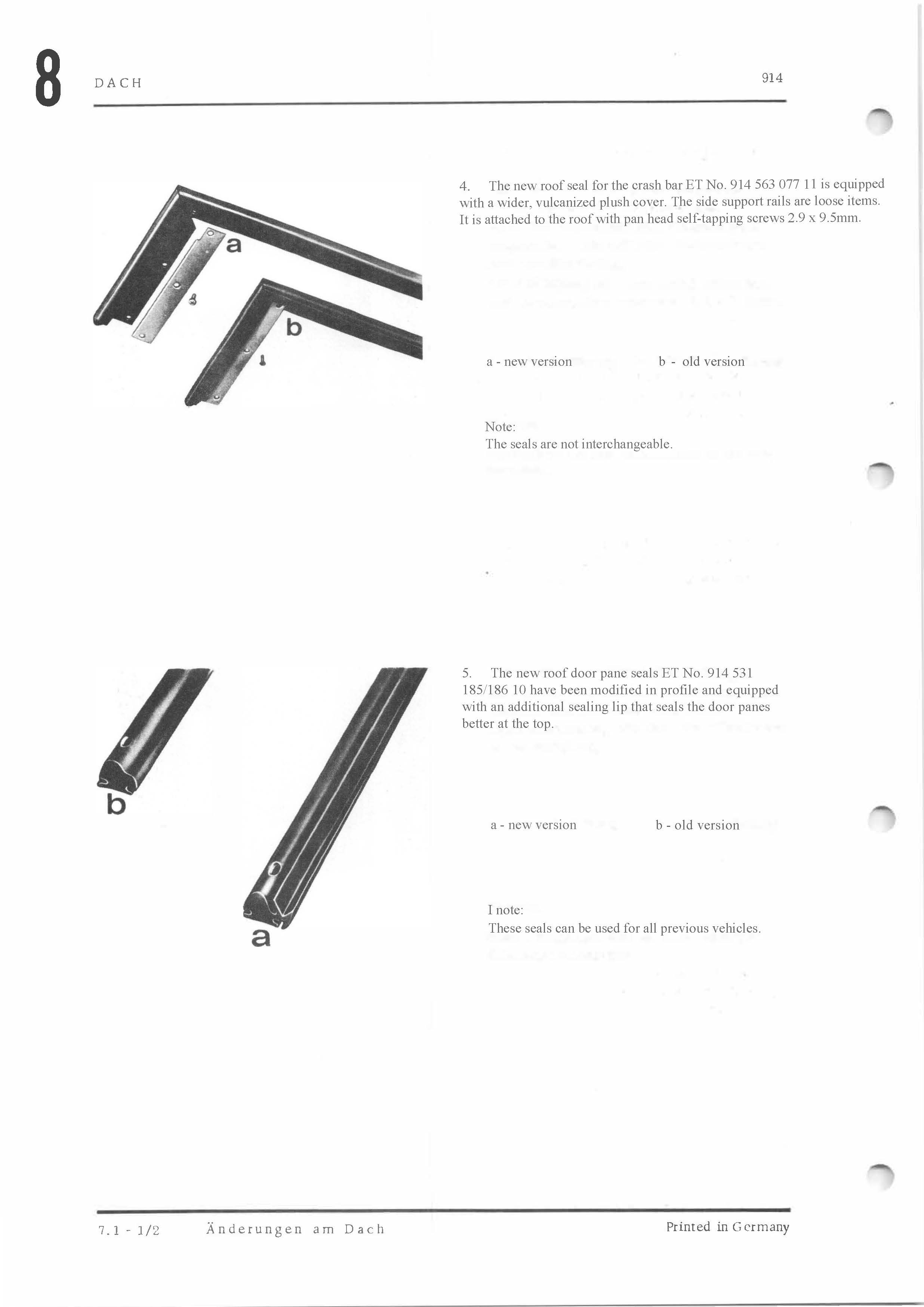

Good evening,
I am quite new to the forum but have already enjoyed a lot of different topics and find them quite helpful and motivating.
Hope to contribute to this one. Looking at my Porsche 914 workshop manual I found the following information about the change of the roof:
From July 4, 73, new roofs were used from VIN No. 4 73 292 6222.
Further on Porsche introduced a new seal for the rear part that is not interchangeabel.
I have tried to translate both sides that are covering the roof changes and attached them.
Click to view attachment Click to view attachment

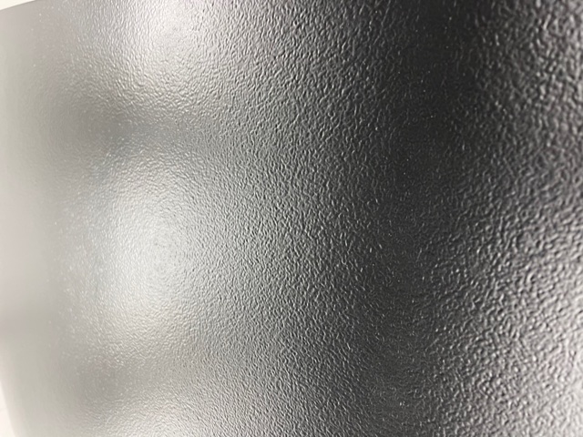

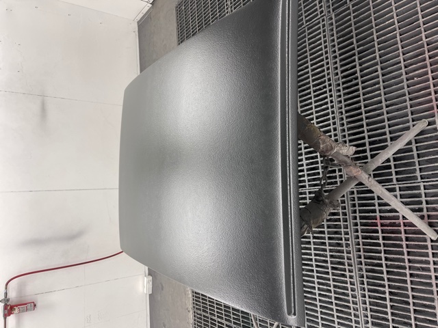

So my top is nearly done... dug through old threads here and ended up using Wurth black SKS with their special gun... then shot with satin (semi-gloss) black--looks real shiny in these pics because it was literally just sprayed, the "shiny" will die down quite a bit as it dries beerchug.gif
Should be picking it up from him next week, need to get new aluminum for the window seals next and pick up the other seals from 914rubber beer3.gif
MM1
Vielen Dank @hwo and
eric9144

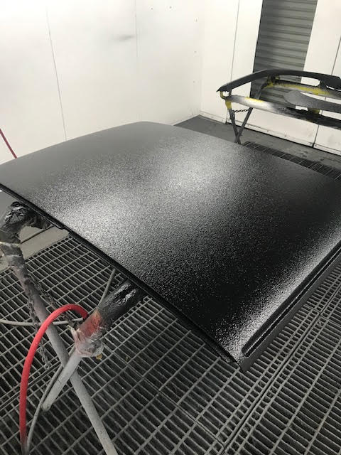

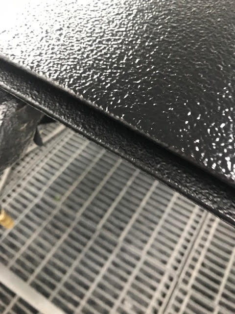

I'm curious what you guys think, I know it's in the bright lights of a paint booth and the paint is wet and more reflective than it will be in real life...but is the texture too thick? Also should I have them remove the texture from the rib that goes into the windshield section?
When I go out and look at my other roof that's factory it looks smoother, but I'm not sure if I'm just being picky. I might have to take my other one up and compare it.
QUOTE(eric9144 @ Nov 12 2020, 08:08 AM) *
eric9144

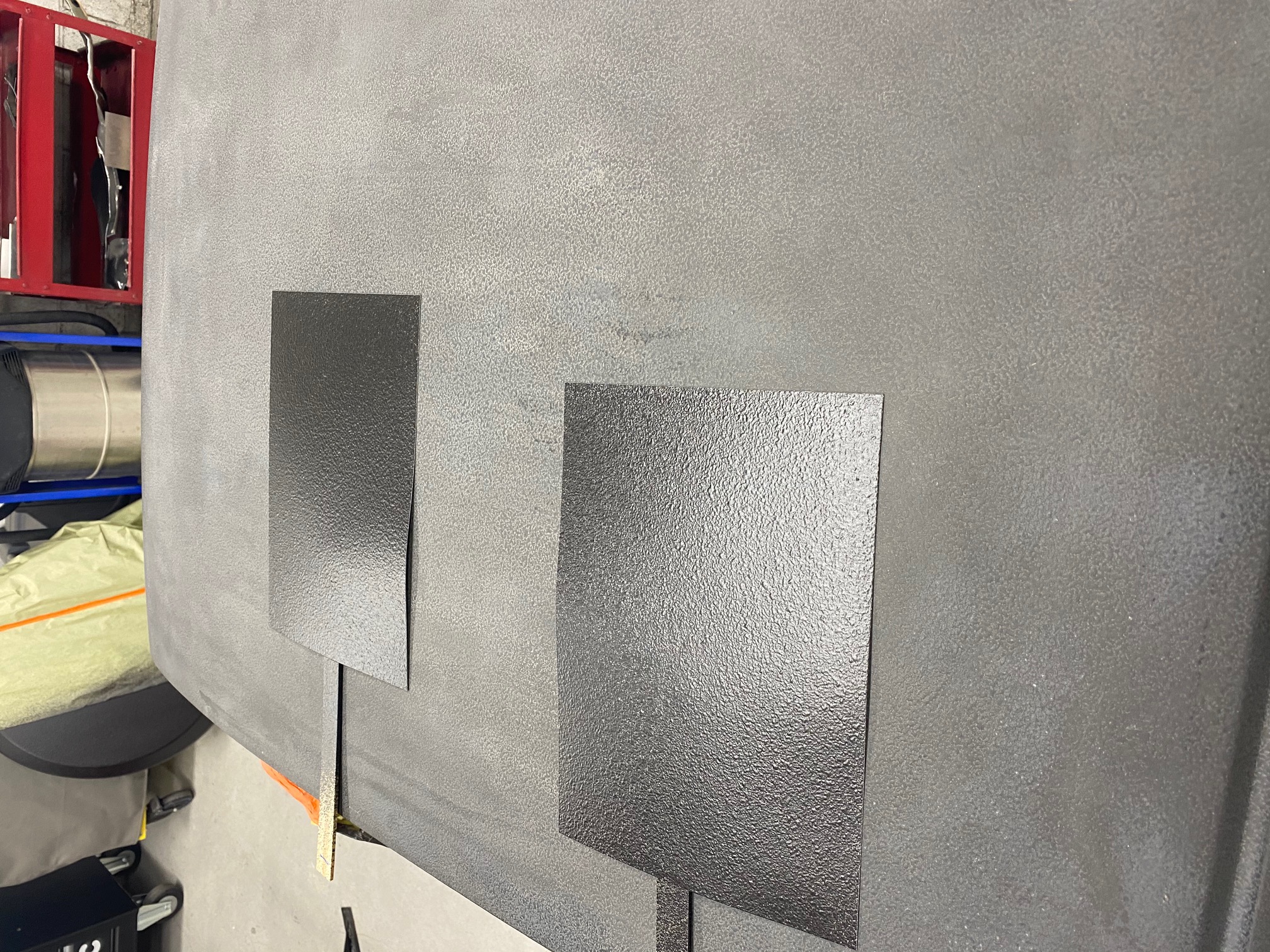

The 1st attempt was too thick IMO, so I brought them up another spare roof with factory texture and we're working on spray outs to get the Wurth SKS to the right consistency...we're getting close, I'll share whatever the magic dilution rate is when we get it exactly right

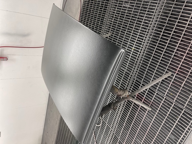

Was harder to get the texture dialed in than I expected, had to be thined down a bunch and then knocked down at the end slightly to get it right.
Ordered up new rubber and a headliner from 914rubber on black Friday as well as latch HW and screws from Bruce Stone, should have the roof back this coming weekend first.gif
Click to view attachment Click to view attachment Click to view attachment
