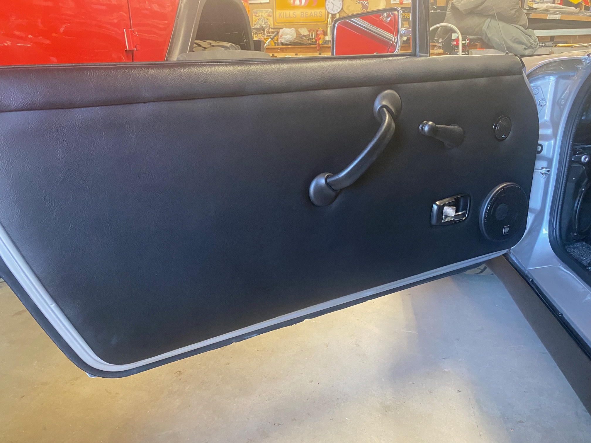

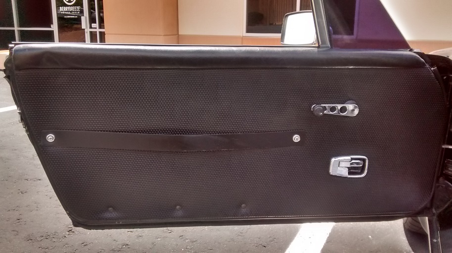

Mine are about done here. Lots of hours but redid the entire door panels with it. Ended up fabricating the door pull mechanism too. Not an easy task. Fiberglass trim pieces to cover up my mechanism, but turned out nice. Have not cut out the window cranks yet.

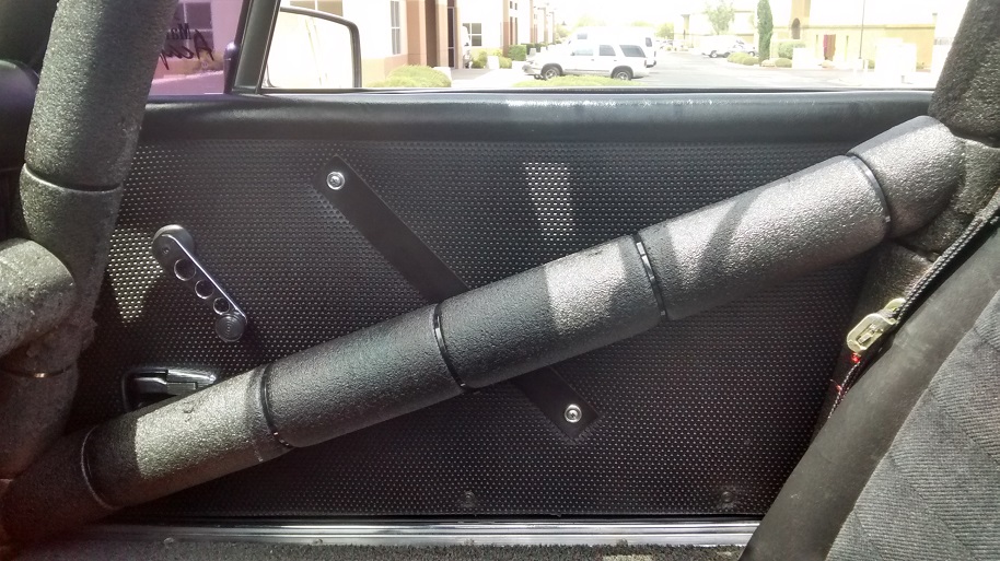

Door latches were flipped to allow for clearance with the roll cage.

I am loving the look gentlemen! One thing the strap. On Costa05's car he fabricated the pull strap. (nicely done BTW). Let me get this right... The pull strap is not plug and play you will have to figure out how to intertwine the door lock and release lever to make it work. Am I correct?

Definitely not plug and play on mine! Someone likely has the perfect easy solution already that I missed for the loop style pull strap... like you, I would love to see their ideas. beerchug.gif

VW Beetle door * pulls , I had covered in black leather. Flipped over door handles...easier to actuate when the side (cage) bars are bolted in; and shorty window cranks to operate with the interior verticle bar.

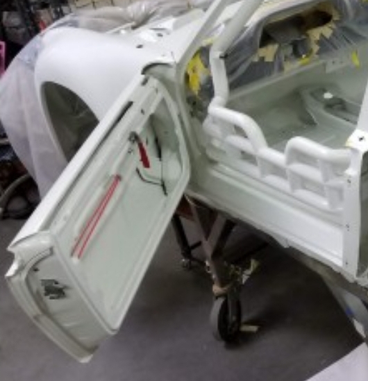

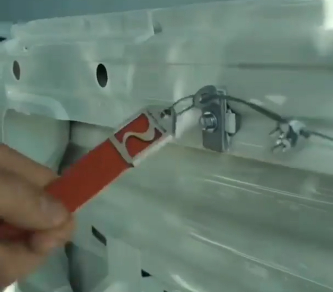

Any custom door pull will require the Action of pulling on the spring loaded arm in the door mechanism. Check out the way we did a basic door pull on our current build*...the red Rennline key strap to the rescue !
*the white 9148 gtt, I think that you just got to see the body parts of it when you visited with your Son smile.gif

Clever solution! On mine I recreated the mechanics of the stock handle using metal pivot arm and the existing rod. Then had to hide it somehow. It was a bit complicated and time consuming.

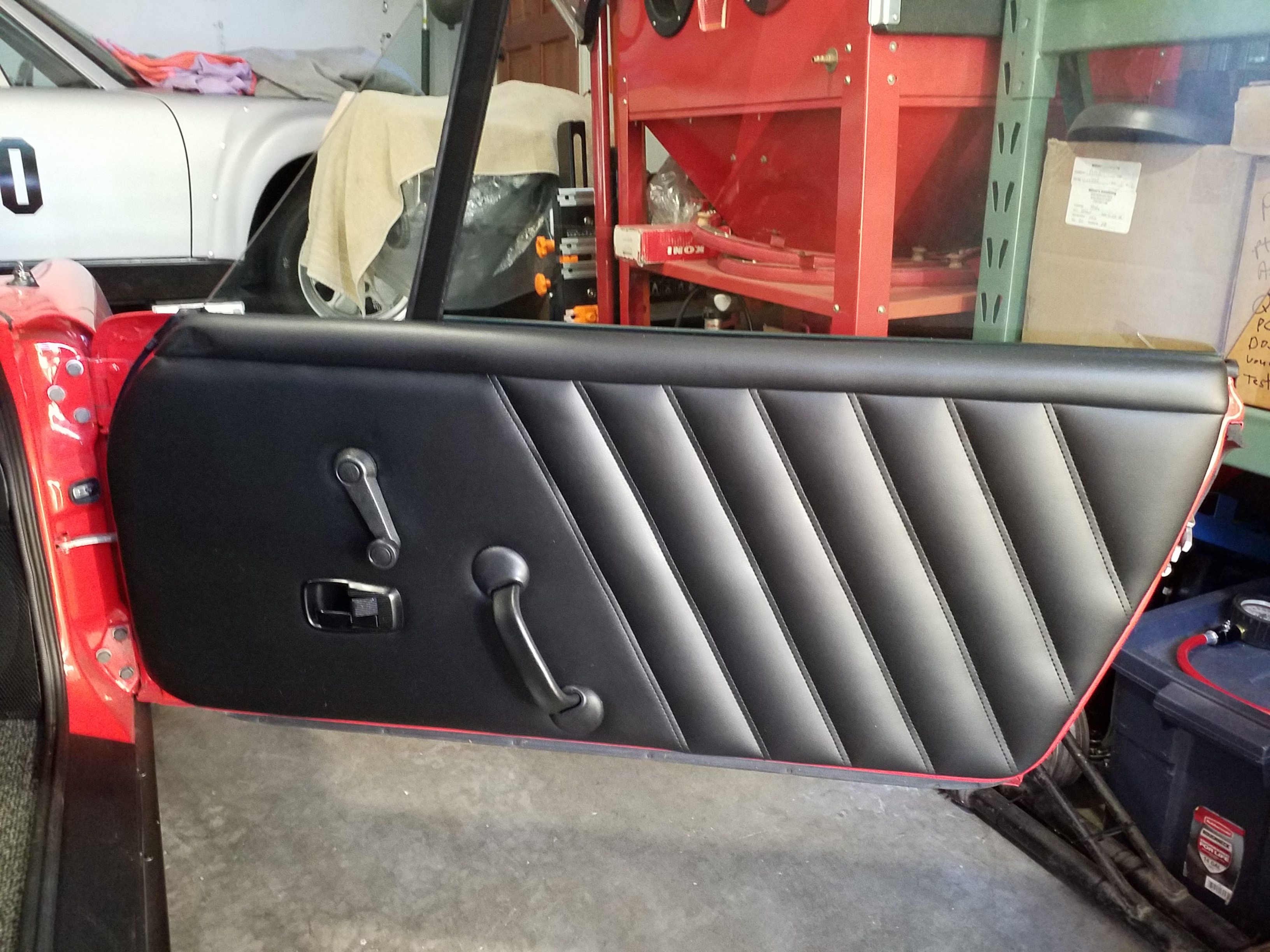

Took a little longer than planned as we are down an employee. She got a better job offer so can't fault her there but finally done -
Shown with handles not attaches as we will leave that up to the customer for how and where they want to mount and it should really mount to the metal.

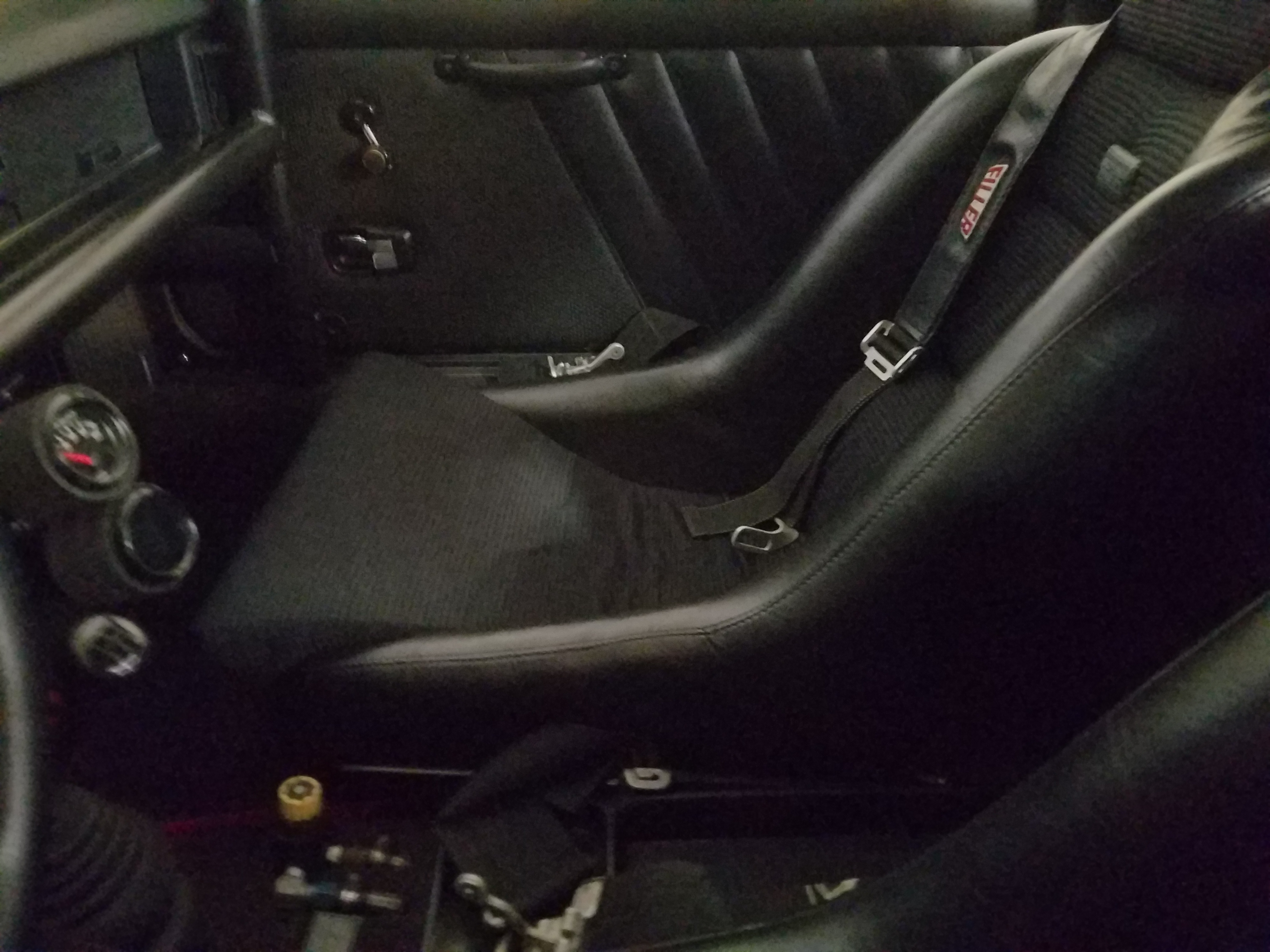

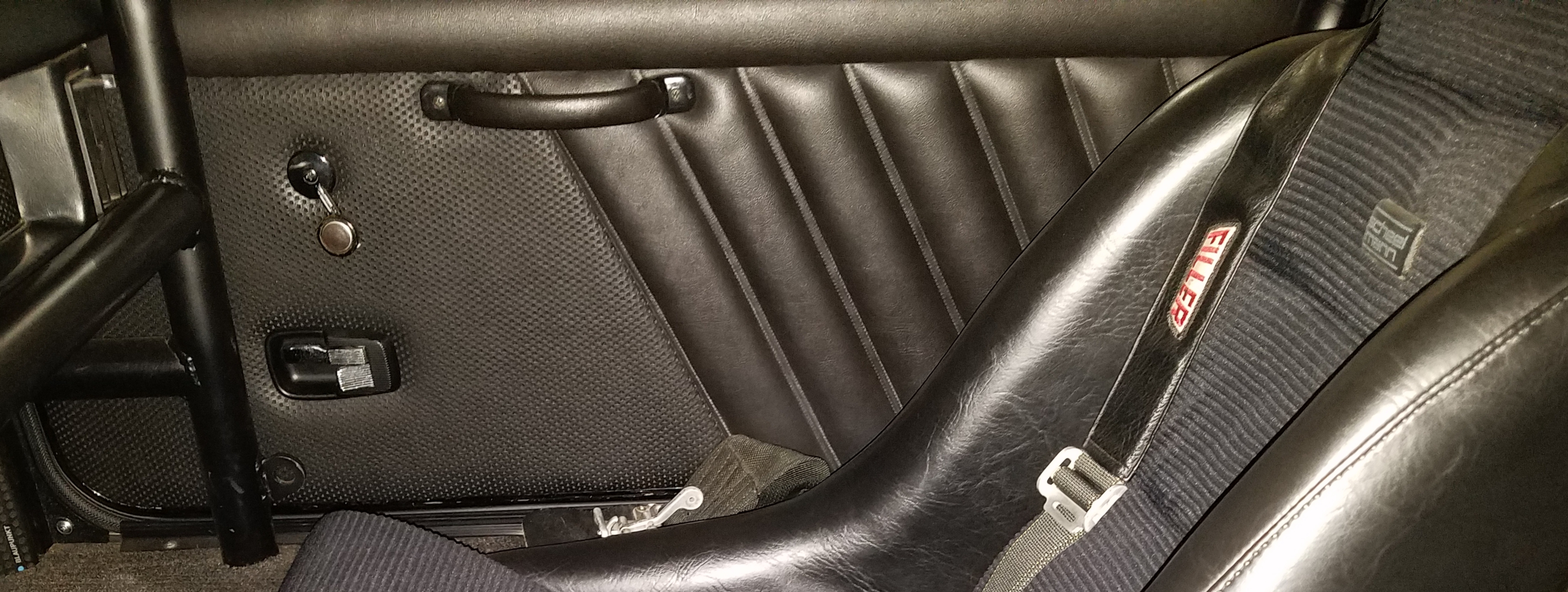

@Maltese Falcon did you make or buy the shorty window cranks? I need those biggrin.gif Can't unroll past the cage with the doors shut blink.gif
Maltese Falcon
QUOTE(eric9144 @ Oct 22 2020, 07:39 PM) *
Nope...I don't mfg / or sell these, but not hard to build;
Just take a couple of these (same as beetle or vanagon) , drill out the small rivet at the round knob. Remove the vinyl cover off of the handle (not reused). Measure where you will need the knob for roll bar clearence then bandsaw the Metal stem and deburr. Center punch the stem, drill a small hole / for a small screw , nut and washer, loctite.
I think that some of the VW knobs had a pop-out plastic disc...makes it easier to set the new hardware in the handle. Otherwise you will need to drill a small hole through the knob to do this.
I painted the assembly with satin black Krylon, and a bit tricky to spin>>but they work !
