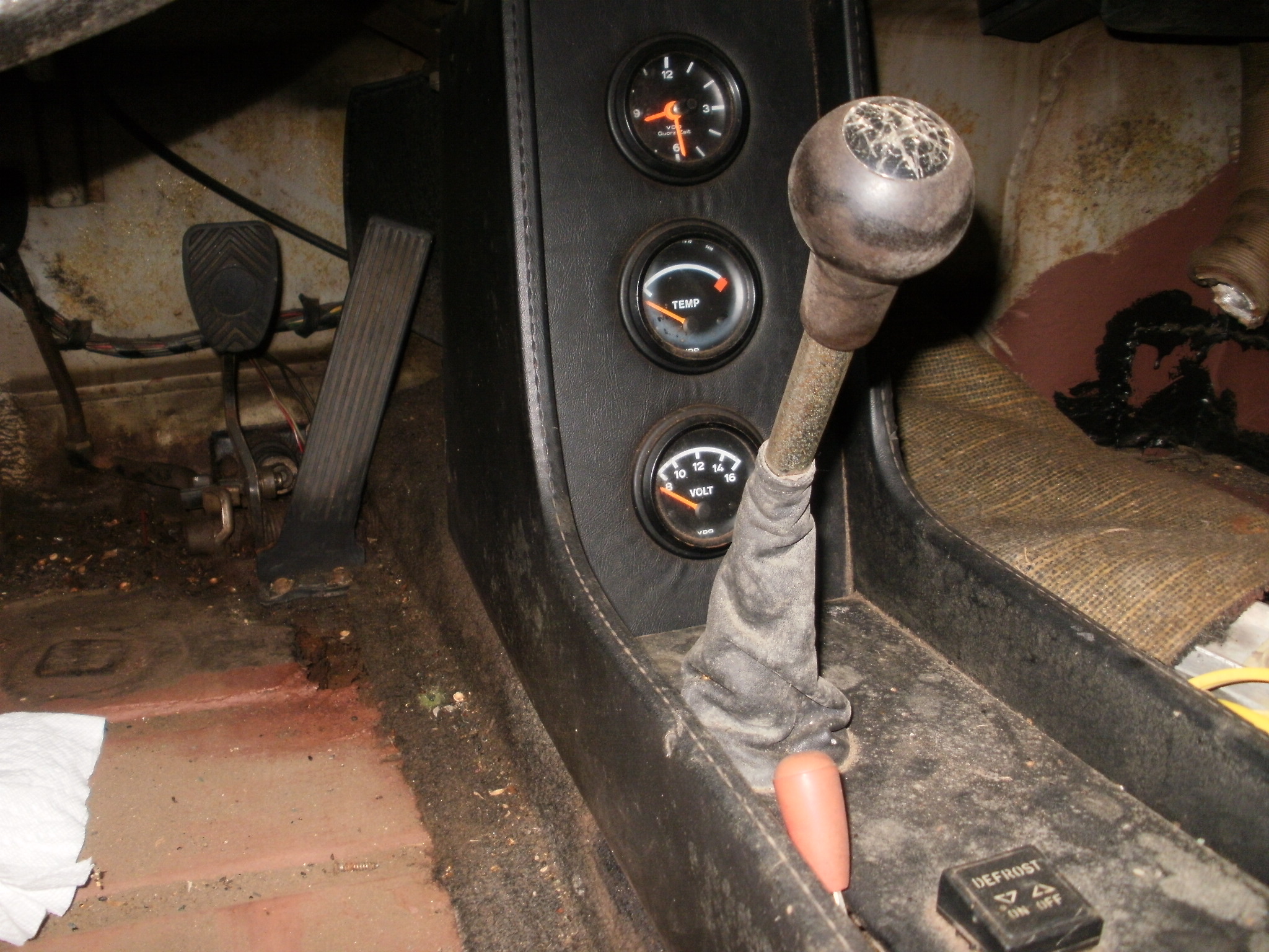

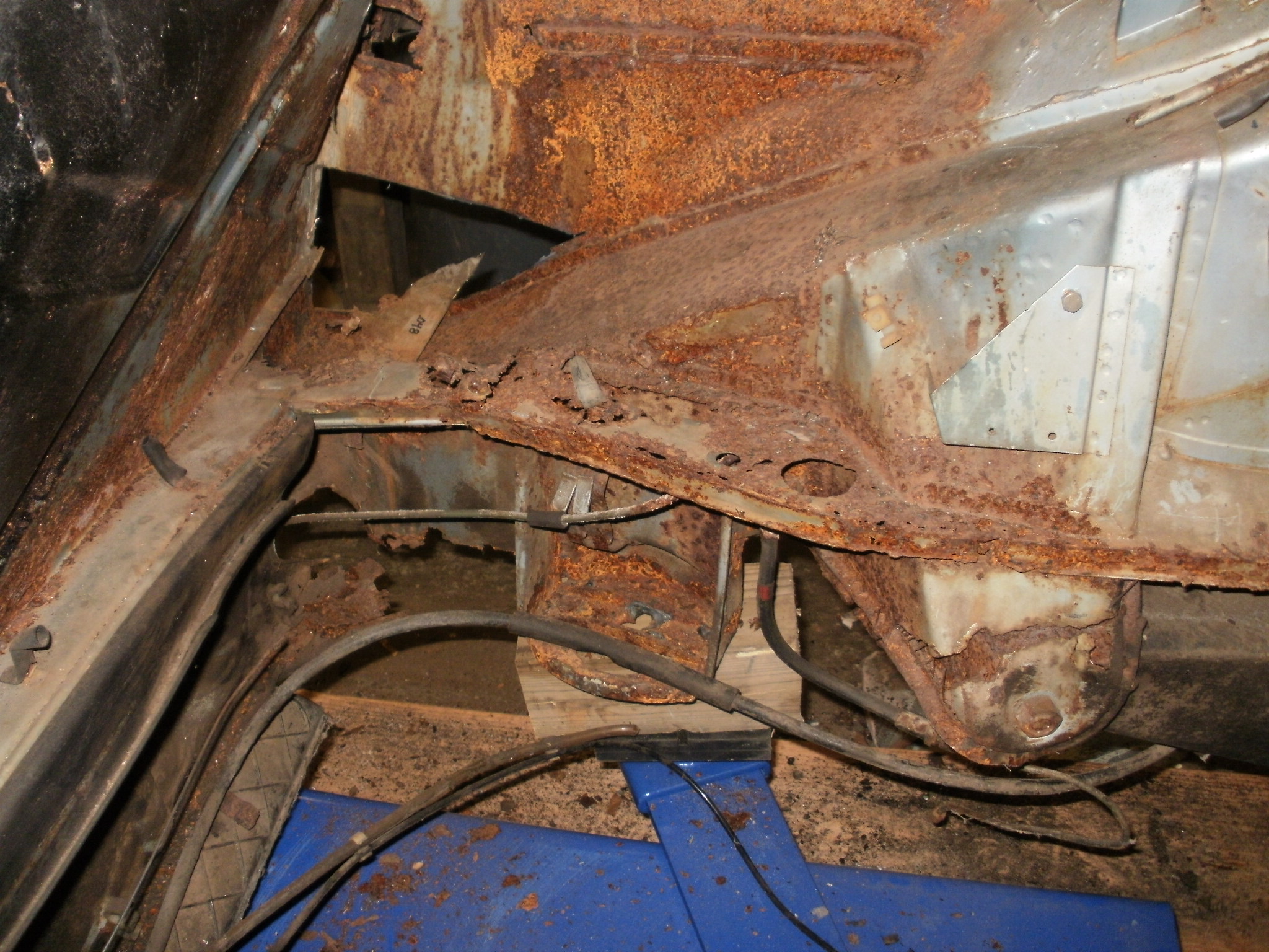

Click to view attachment Click to view attachmentGot it, from what I can tell this one is a fair candidate. The frunt and rear trunks are decent, longs with front and rear connections are required as well as trailing arm mountings, ...... Yes, it's going to be an adventure

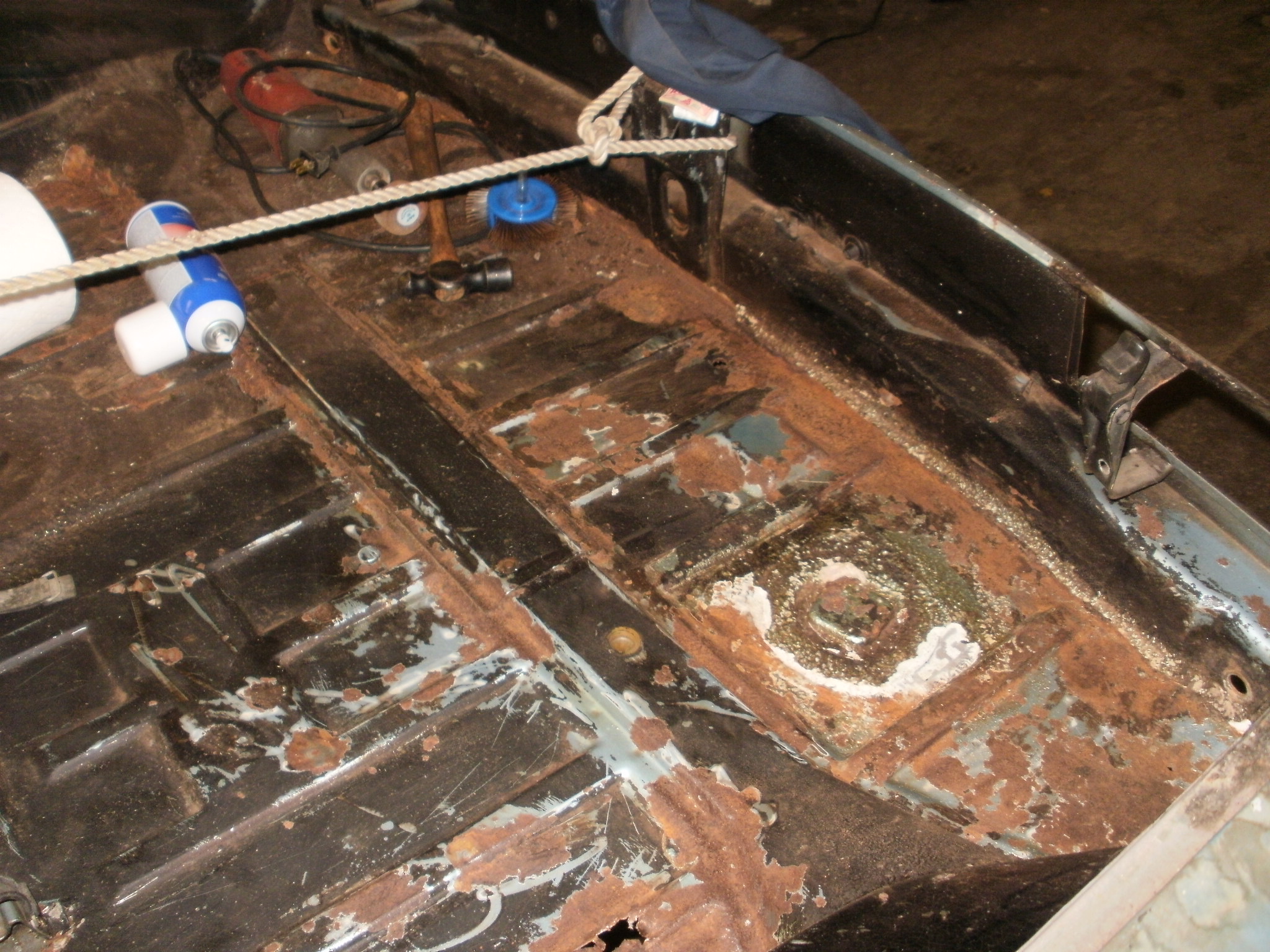

Click to view attachment Is this whats known as the "hell hole", going to be a few hours in here
Superhawk996
Nov 25 2020, 03:36 PM
Whoah! You got a project on your hands.
