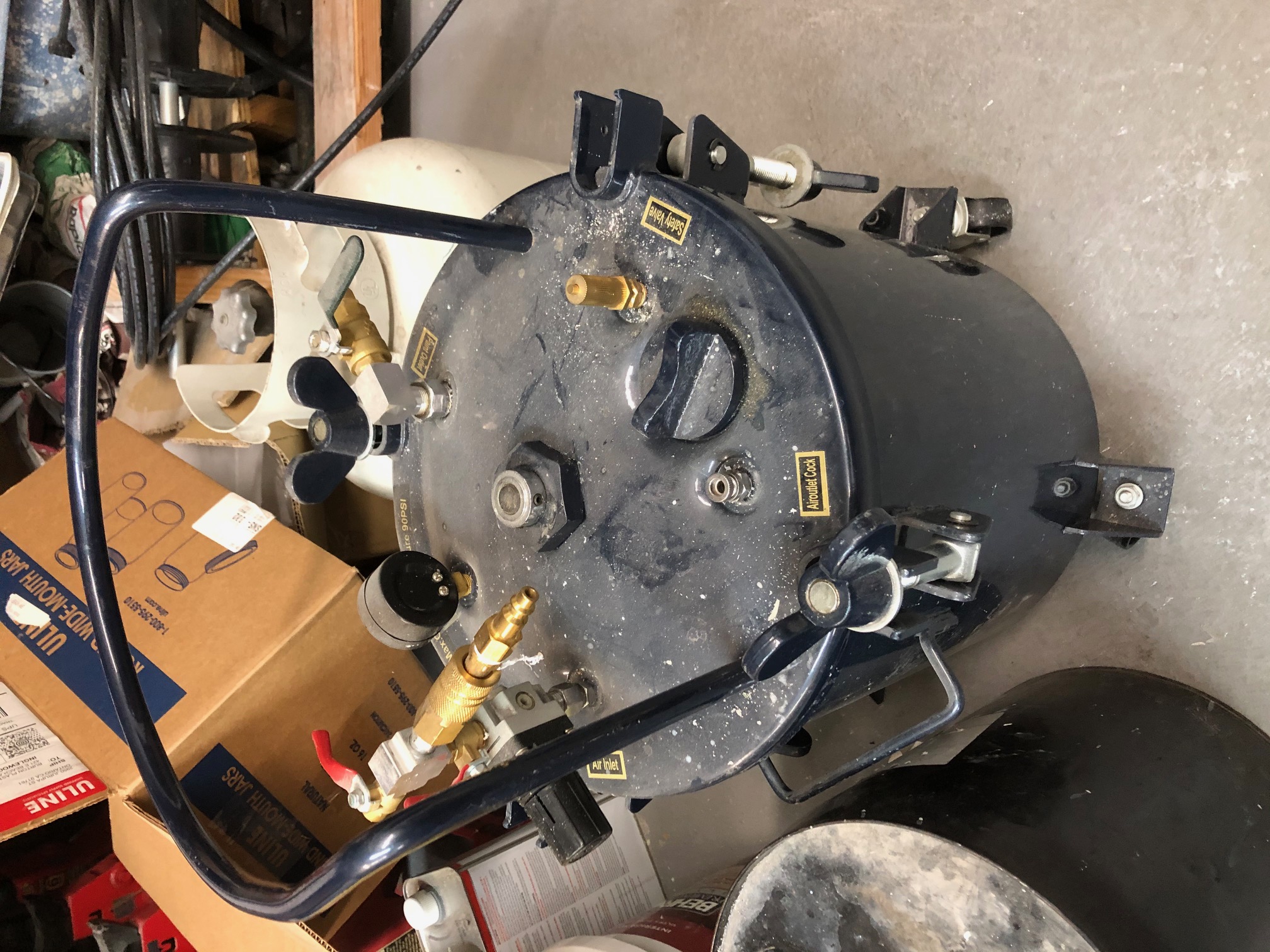

This is a mixing paint pot I use for pressure casting. I think I got it on Amazon
Most I deair but sometimes I just go with the pressure casting
