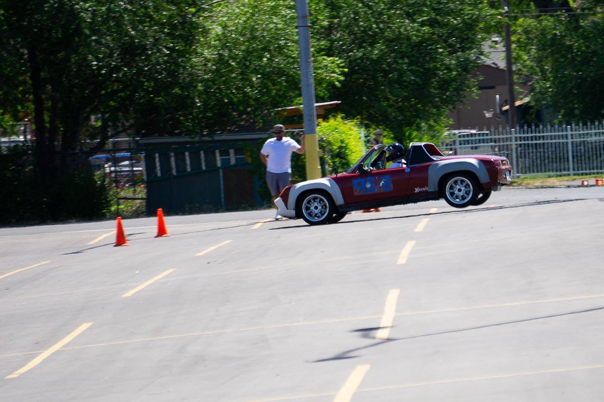

Local PCA stuff here isnt that intense and a lot of the lots we have access too tend to favor handling over HP. Well prepped 914s with a half way decent driver usually have a chance of landing near the top. Not saying its going to be possible, but for me the fun is in the challenge.
Also mine only vaguely resembles a street car at this point.
The SCCA guys would probably mop the floor with me though.

100% / 0% weight bias???
