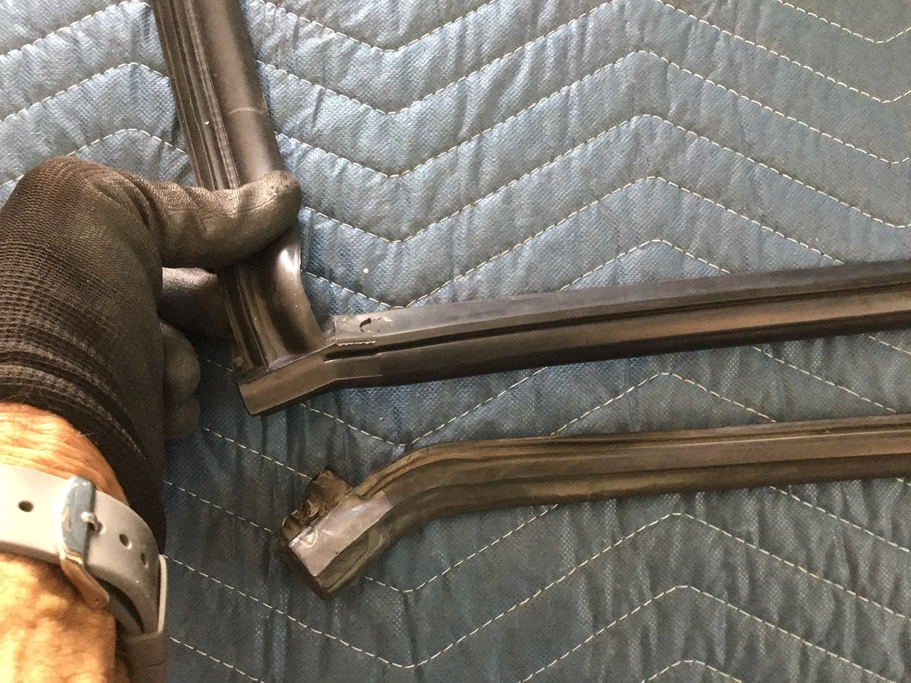

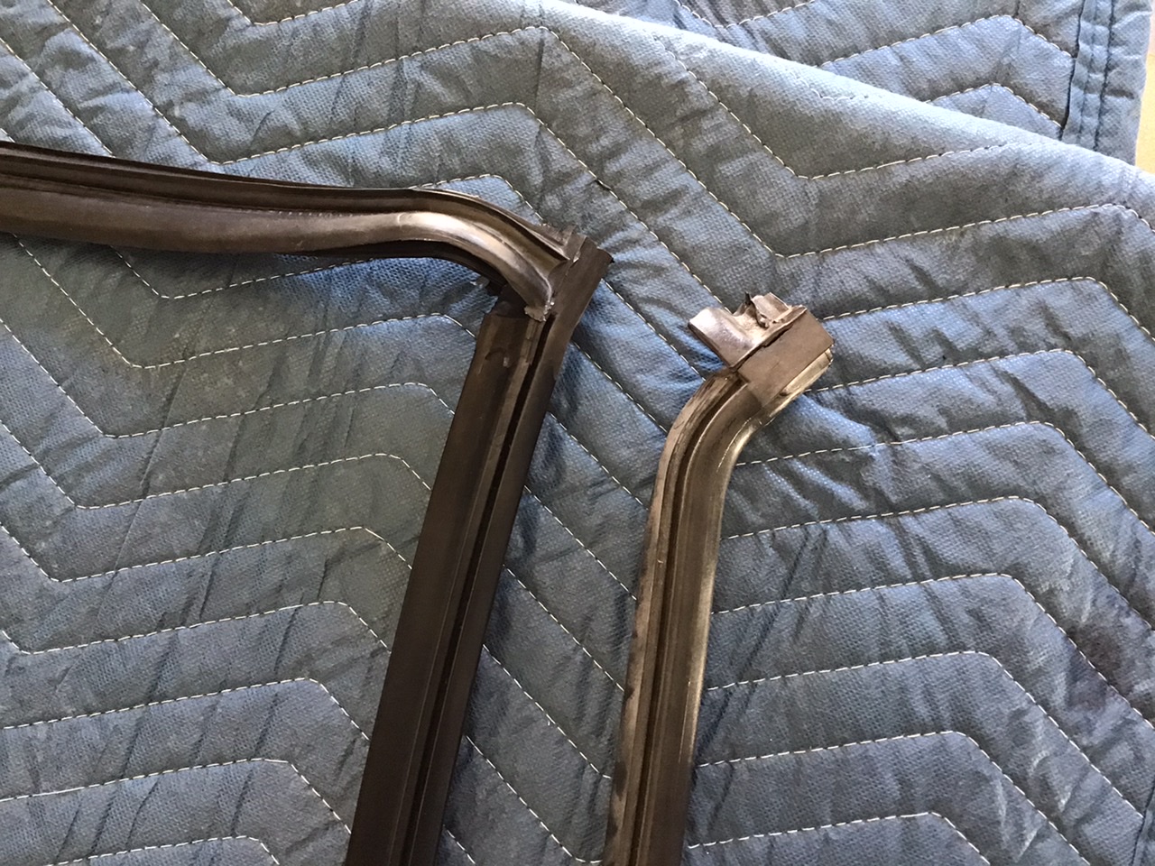

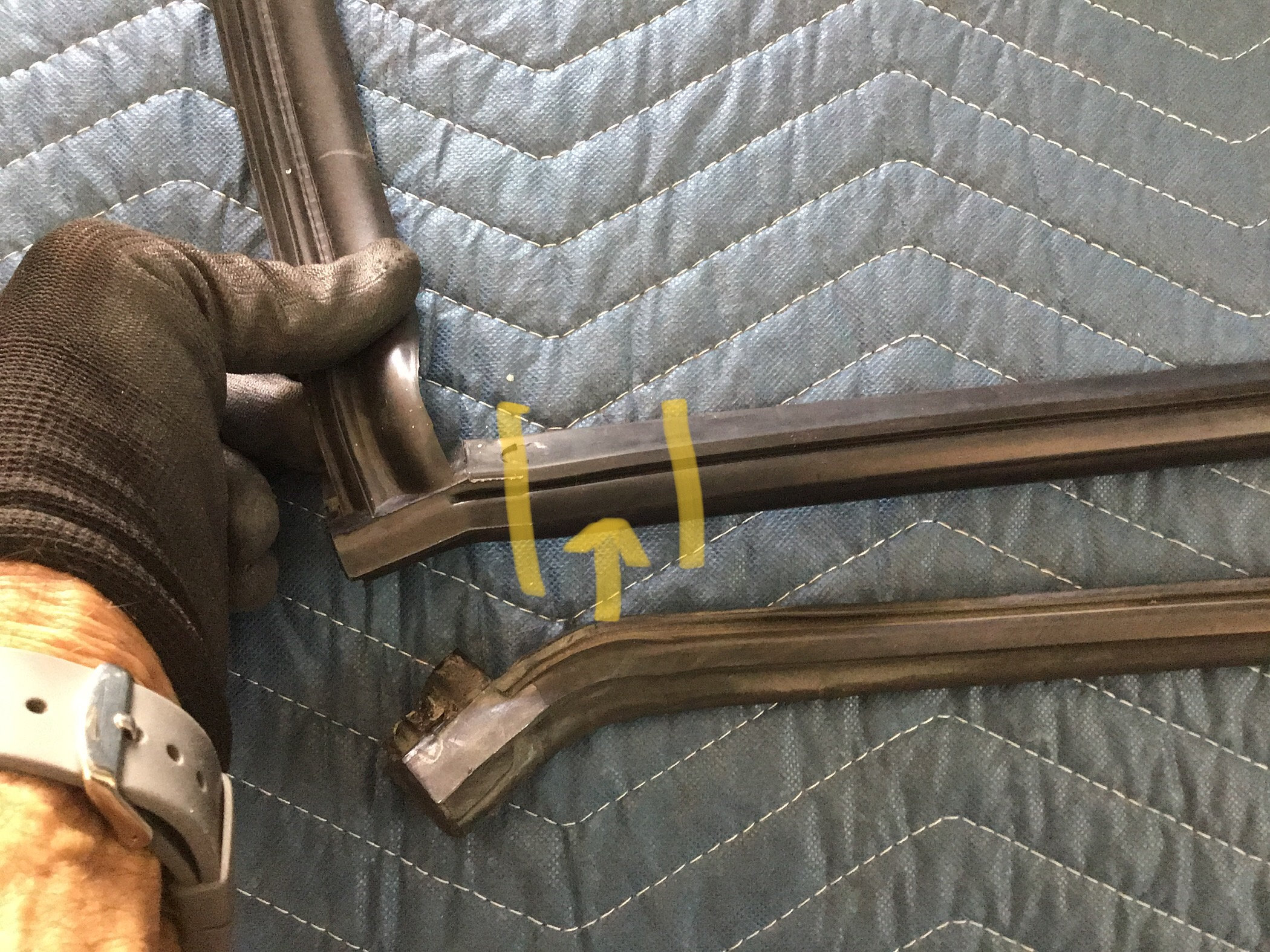

I would take installing the air box 5 times, over putting this seal in. I cannot get it to conform at the top where it makes the bend. headbang.gif
I have tried heating the rubber in this area to get it to conform to the bend without any luck. The 914 rubber piece is reinforced in the exact location that it needs to make the bend. Not sure what to do at this point. hissyfit.gif
You can see where the original piece is bent.

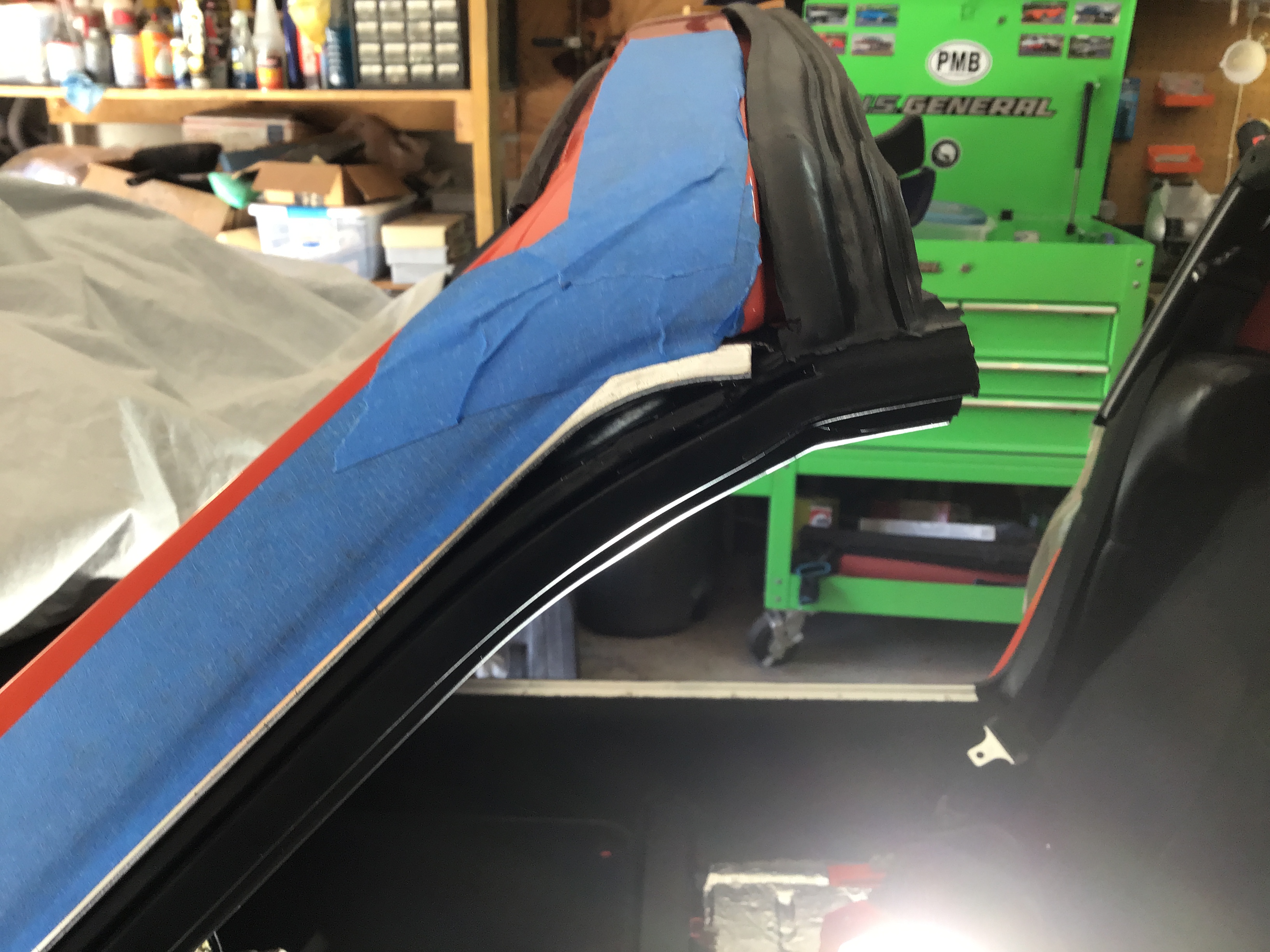

I did this about a year ago, work from the top down, fit the curve in first and don’t stretch it, eventually there should be extra that you will trim at the bottom. Take your time, tape the edges.
Your photo shows that the top corner is not installed correctly, the edge of the rubber should be perpendicular to the ground so the roof weatherstripping butts up against it.

Morph914
QUOTE(mgphoto @ Apr 3 2021, 11:39 AM) *
Exactly, if the piece fit up into the curved area it would pull that piece down into the proper location.

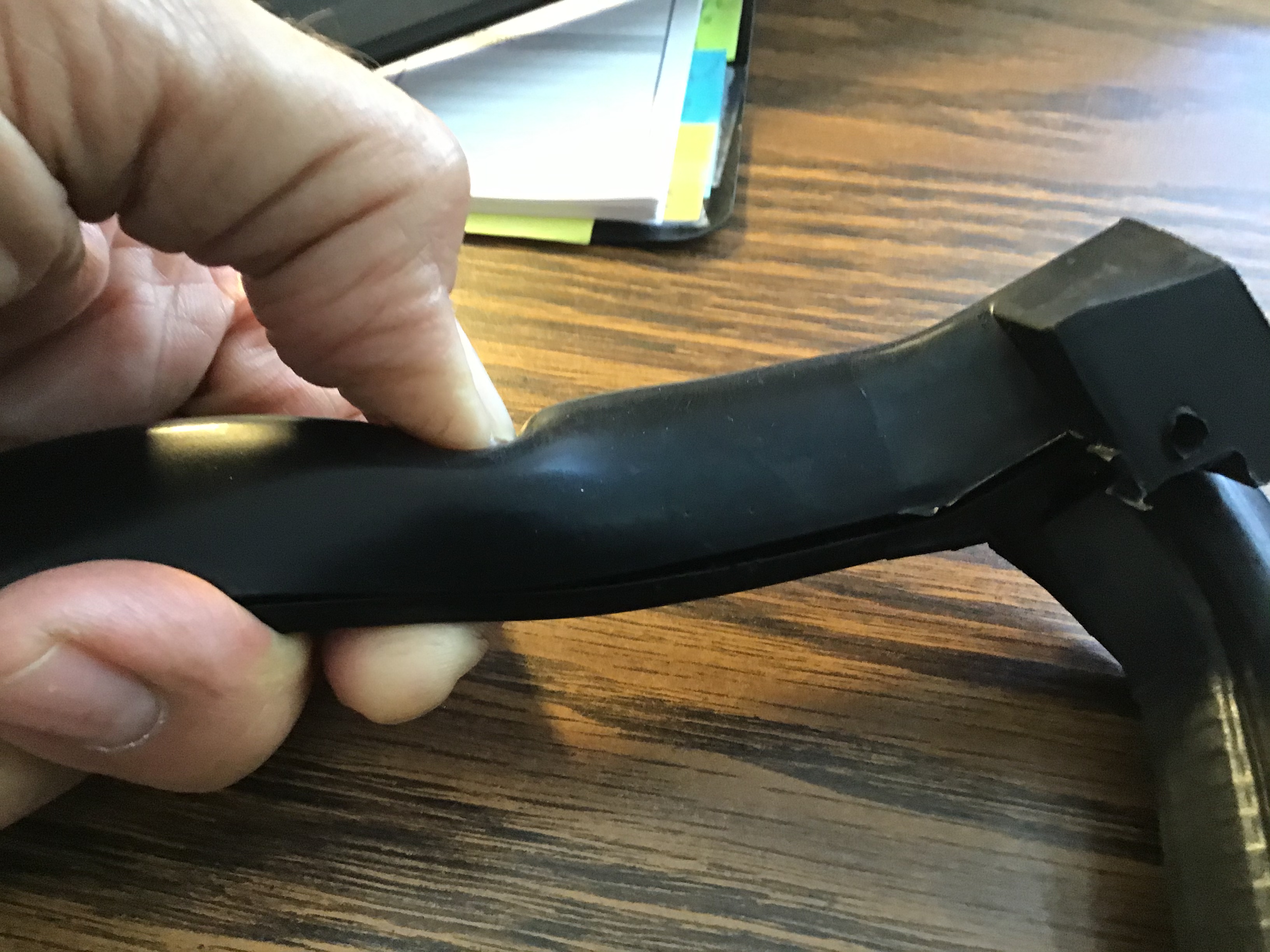

I have had success in getting the backside interior lip into the grove using soft soap but it will not stay in at the bend even after getting the exterior lip started. Once I release pressure it simply pops out of the track at the bend. My seal has a hard piece inside that is about 2” long on the left side and smaller on the right side at the exact spot where the bend is supposed to happen. It looks like this is where the top blocks was molded to the vertical part of the seal. This is not allowing it to have flexibility to stay put.
I am sorry to be a PITA but out of this entire build this piece has so far given me the most grief. I am not a dumbass hack, this should not be this difficult.
In the picture, I have marked where the hard piece is inside the rubber. Is this normal?
Thanks for taking the time.

QUOTE(Morph914 @ Apr 4 2021, 12:33 PM) *
@Mikey914 - can you please address whether the hard internal structure is normal where Morph's picture indicates it to be?

The hard internal structure is the top section. No metal or internal structure there.
Morph914
Ok, I guess I will need to exchange mine for one that does not have this hard piece, because it will not bend and stay in the track.
You can clearly see in the picture where the hard section starts just to the right of my thumb.
Mikey914
That is rubber and part of the corner block. It's there to allow a good bond between the sections. Its not on the corner..
It does appear that a longer piece than required was used here.

Mikey914
The internal joining block should be about 2-1/2" in I just checked my stock and it conforms.
We had to have some mass in this area to allow for a better seal when the window is closed. Making this seal we had to make many design choices and as the seal evolved over the last 12 years we have continued to improve them. We can angle the internal block some on the next run this may help.

Morph914
QUOTE(Mikey914 @ Apr 7 2021, 10:19 AM) *
There was a time that these were going for about $900 each. This is the main reason we made them. as we didn't charge $900 we are about $230, we have continued to make investment in this and many other seals to help keep the cost of restoring these seals down. Are they 100% identical to the NOS OEM, NO.
We have made many improvements that others have copied. A prime example is the internal clips. We use stainless or aluminum where the factory originally used plain carbon steel. Anyone remember taking off an old seal and seeing that the seal rusted from the inside out (the clip)? This is now a standard for most manufacturers.
We always stand behind our products. If you are not happy send it back. Purchase price will be refunded.
As you can see in my picture, it extends well past the 2 1/2” mark, but I will measure tomorrow to make sure. I did notice that the passenger side is more in line with your 2 1/2” mark.
I appreciate you guys and am not looking for a refund, I may have to exchange this one for another.
