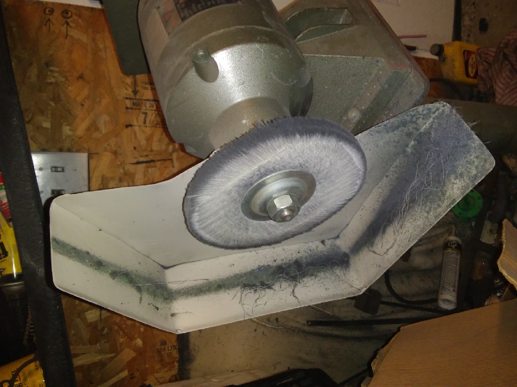

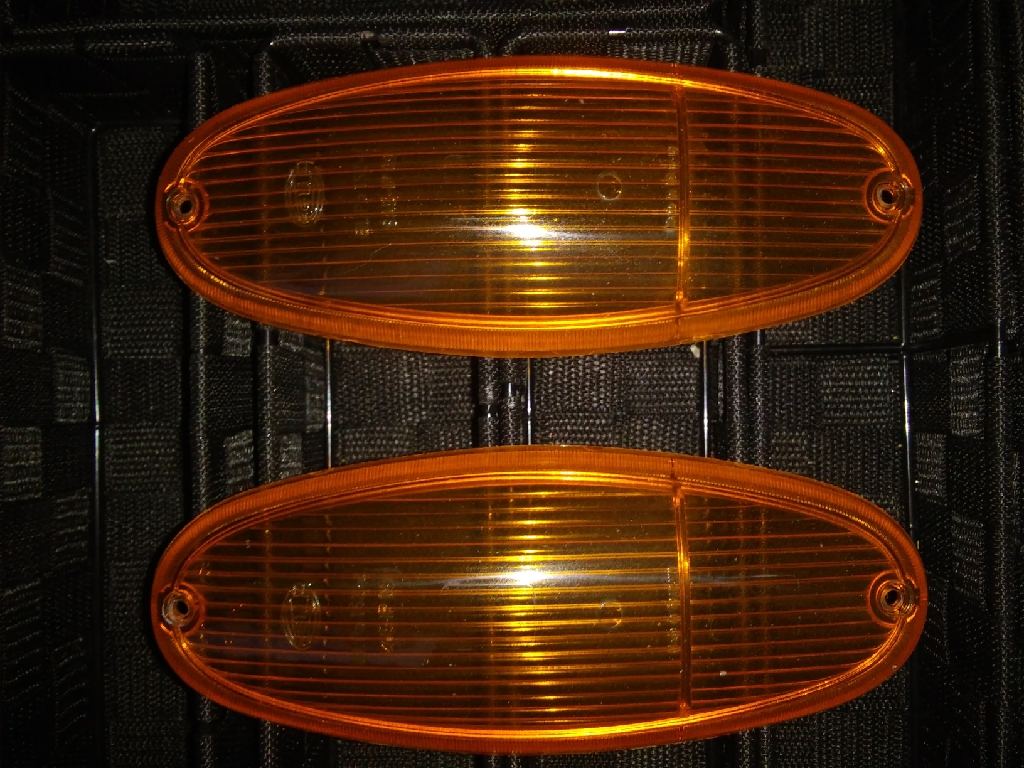

In 85' I finally replaced the broken, cracked and aged lenses. Bought brand new hella's for the front and rear. Been working on the front sheet metal and every time I looked at the front lenses I'd get bumbed out. They looked so good new. I had built a polishing machine and have been doing metal for years. But never did plastic, I was afraid the high speed of the machine would melt the plastic. But I had to try. Click to view attachment
I was surprised. Takes a light touch. The metals I polish will remove skin they get so hot.

Those came out nice, but I say you were lucky.
For others out there - use Mother's Plastic Polish by hand - much safer done by hand, & same results without risking expensive Hella lenses.
In 2013-14 I did all sorts of plastics surfaces on our `88 Westy to resto the interior & any lenses not available new/NOS to take off 28 years of family camping, & everything came out fresh as new.

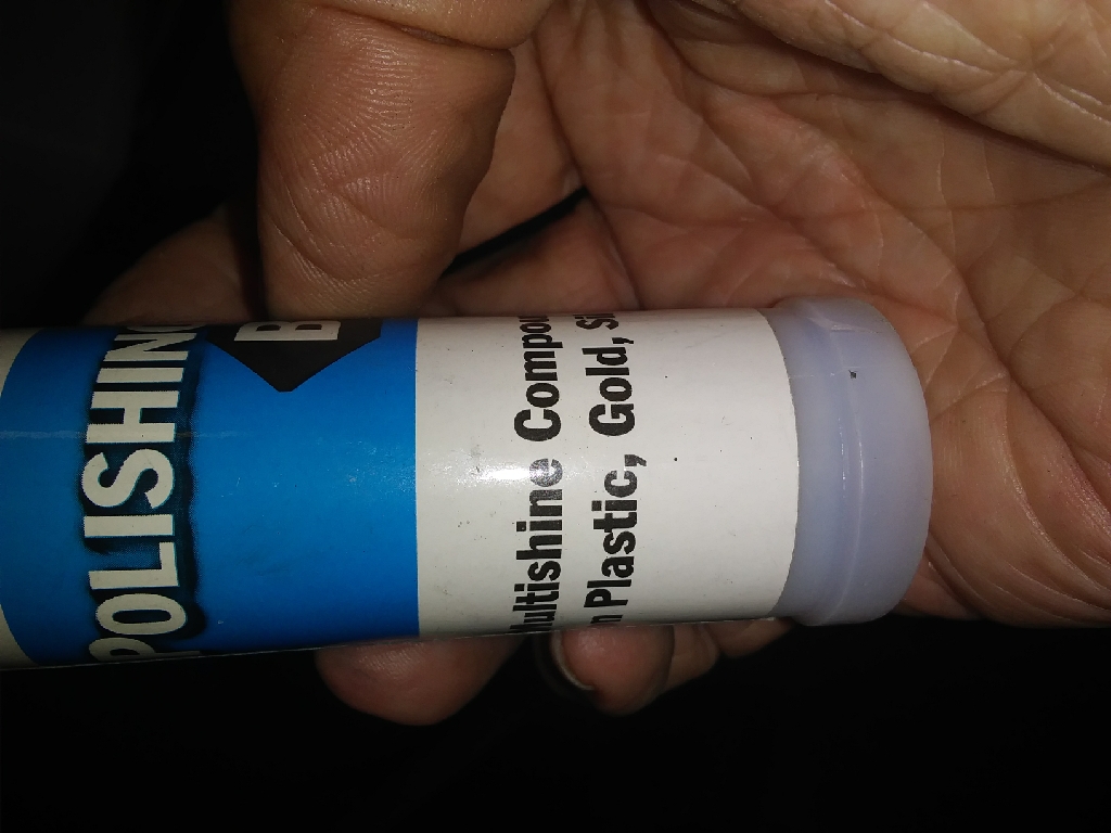

Lucky, sounds about right. But I need a light tough for gold and silver also. So maybe a little skill and a lot of luck. You also need the right compound or you'd be screwed, first touch. I'd have to agree, by hand is safer

It's just a fabric wheel. Make sure the compound is for plastic.Click to view attachment Click to view attachment
