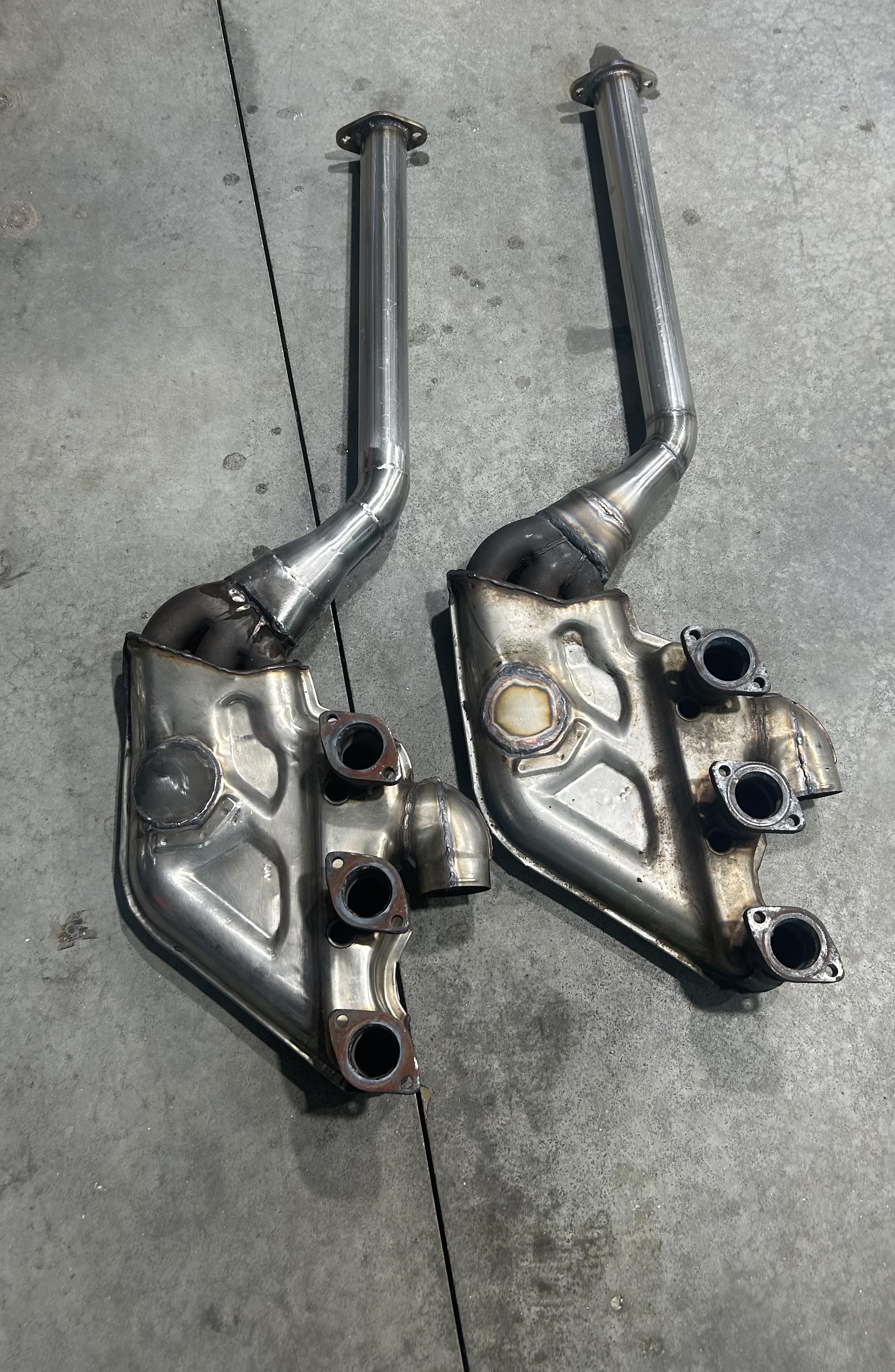

I have been dragging my feet doing these but got a good start this morning. This is a hard process to quote that’s for sure as it is straight up custom. I run this set up on my hot 2.4 with 1.5” sleeves and they work really well. A good solution all the way up to 3.6Click to view attachment

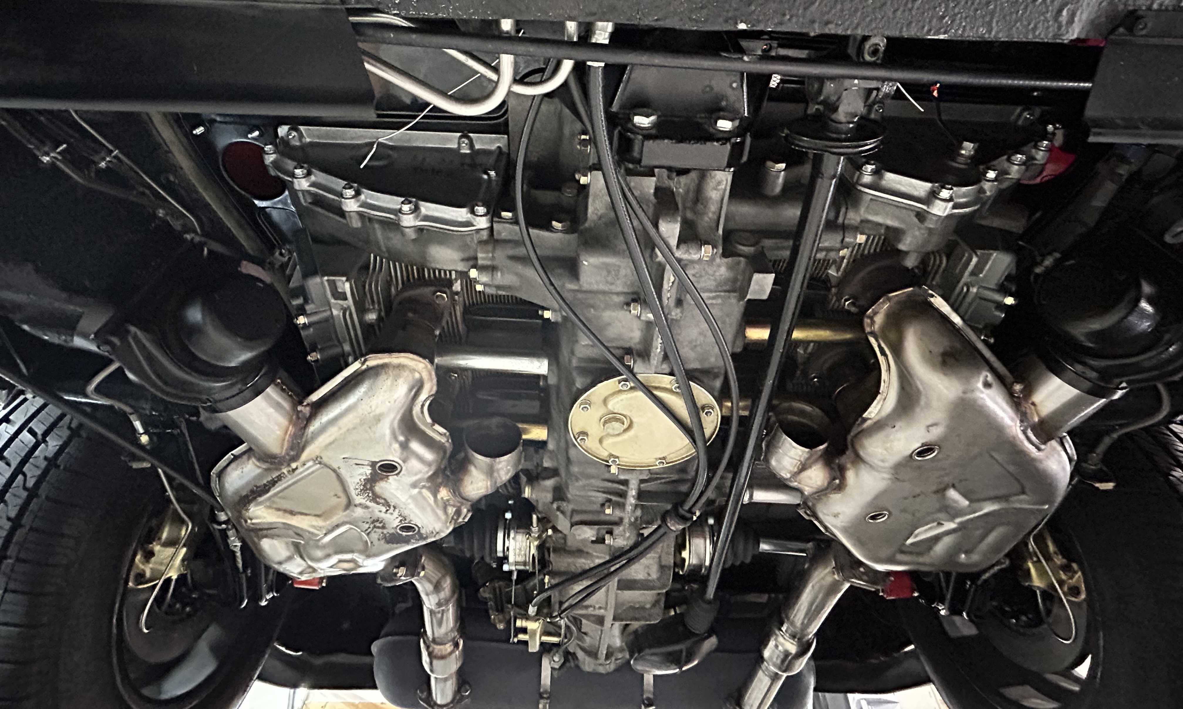

@MB911 - Ben, can you post an installed picture with them hooked up? Do these flow better than your original, large-tube SS heat exchangers? Will they bolt up to a stock banana muffler? Thanks and Happy Thanksgiving, Michael beerchug.gif
mb911
QUOTE(Cairo94507 @ Nov 27 2024, 07:44 AM) *
Here is the prototypes on my car. Do they glow more I would no probably not. They are unequal length but 1.625 OD just like my old sets. They connect to a stock muffler that’s the idea. Click to view attachment

@MB911 do the open ports in your pic get a hose from the engine blower fan? Left open? How is the power and heat? Some people live in cold climates...
mb911
QUOTE(NARP74 @ Nov 27 2024, 04:04 PM) *
lol I live in Wisconsin you don’t think it gets cold here? Basically the factory ports are shrunk so a standard hose will fit . I then cut a new opening for the heat valves and it works perfectly. It was 40 degrees the last time I was out driving and toasty in the car no problem

Ben,
How do you deal with having to flip the flanges on the left head exchanger for the 964 engine? Do you move the access tubes for the bolts??
Also, I have a set of these heat exchangers. How much to get them converted???

Clay you have to be very patient and do them with out access tubes. I have been flipping the flanges on these for 25 years now it works but it’s a fresh day kind of thing not after work.
These sets I quoted 1500 to do the conversion on. May go up a little but that’s what I would do them for you for as well. You helped me a ton. Moving forward 2k . It’s a lot of work.

I run these on my 2.4 with 1.5 inch sleeves in them and they work really well for me. I know you have talked many times about one heat exchanger but why ? If you have 2 of the cores make them both functional and if you don’t hook up the other side so be it. From a valve adjustment standpoint point they are about the same as any other heat exchanger. Nothing is easy while the engine is in the car.

I think the ones I use to build and then contract were probably better but these are a great option. After the exhaust business went sideways I got rid of anything that resembled it and having these on a short stroke turbo years ago made this natural

Agreed^ These might be a good value as I think I have a set of these a friend was going to give me. There seems to be a fair amount of take offs so the cores might be easily available for low cost.
The biggest issue so far is finding reasonable cores. The ones sent to me by clients so far have cost them about $500 and then they are into me for about $1500 (supply chain issues changing pricing which equals more time on the next sets I do) your in $2000 pretty easily
mb911
Cairo94507
An excellent option as Ben's original heat exchangers are no longer available. beerchug.gif
NARP74
Where is the other heat port after you are done? Did you show it in the older pics?
