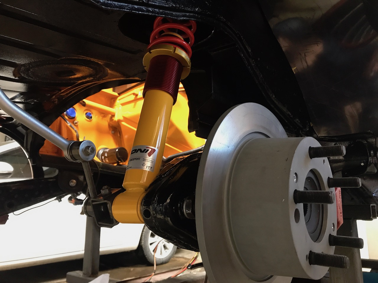

mlindner
Six years ago at the end of my 914-6 GT Tribute build I went with adjustable Koni shocks and springs from Ground Control. Just the perfect fit for heigh adjustment, order any spring rate you want (I did 150). I pushing 80, still an auto-x, hill climb and just a lot of high speed driving. Best, MarkClick to view attachment
