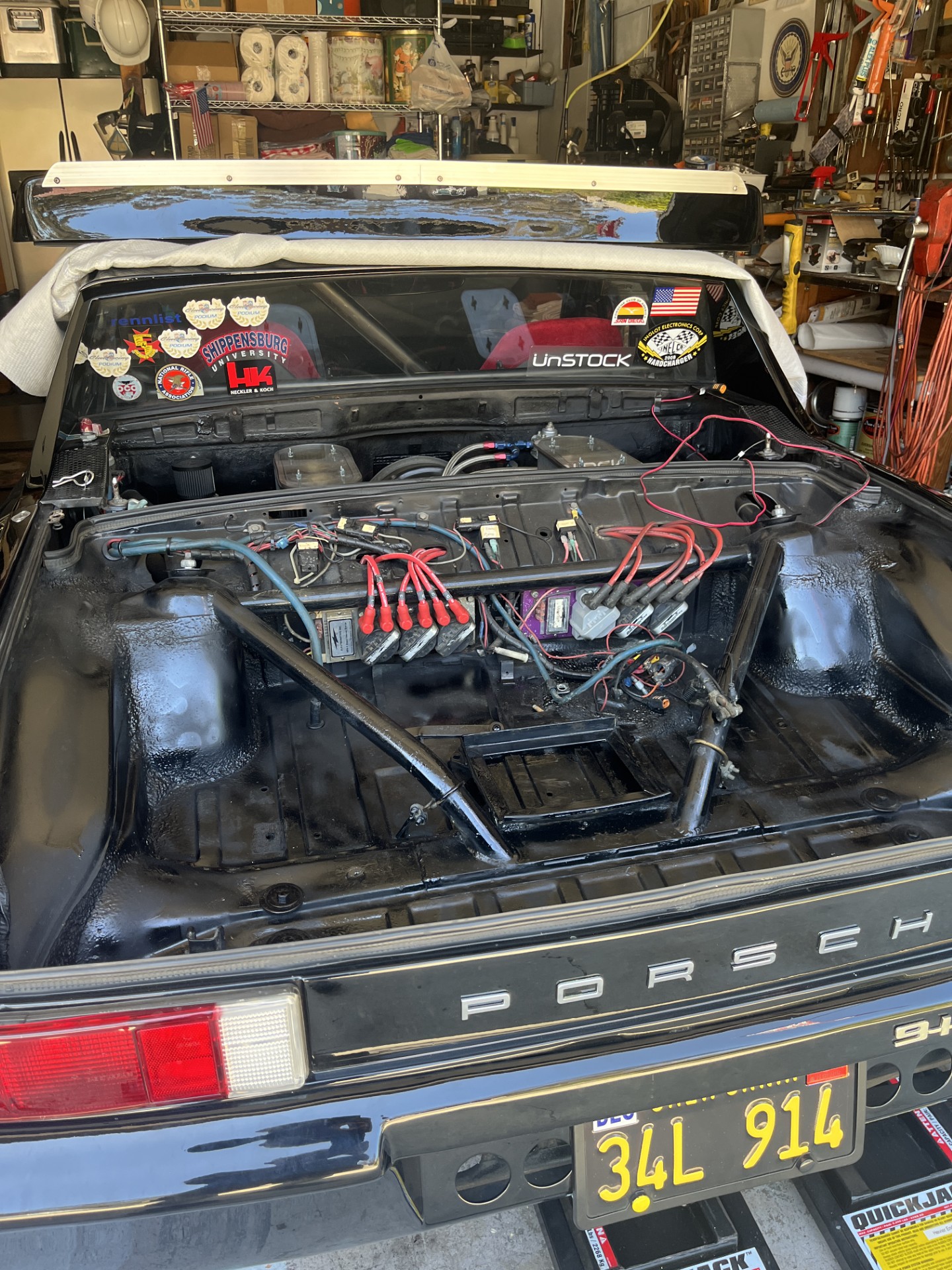

Here is an update:
The cleanup is finished and I temporarily installed the new battery to see what I've got and begin troubleshooting. My engine is twin plug crank fired and uses Electromotive HPX modules. One of them is inop now and these units are no longer produced. Additionally, my tach is fried so there must have been some voltage spike that took out those devices.
Most probably my voltage regulator/alternator caused the problem. I don't know how a battery failing, even with an internal short could generate anything above the design voltage.
So now my immediate search is for a functioning Electromotive HPX that I can acquire. And an 8000 RPM tach. If anyone has either of these available, please contact me. Alternately, I will replace the entire ignition system. I want to stay crank-fired and twin plug. What are the options?
Last comment/question. Is it possible to pull the alternator on a 914/6 with the engine in the car? I do have an access hole in the firewall. Is there enough room to side the fan module forward to clear the engine shroud and then up and out?
