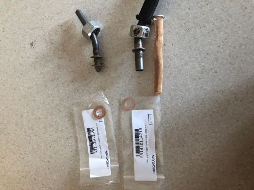

I have a small leak under the tank on the feed connection at the threaded nut. I did not anneal the copper washer, that seemed like a 50 50 issue and I took the lazy route to get it done. Now that I have several gallons of gas in the tank and have gone for short test drives, I have leakage at that connection.
I have good access to get a crow foot wrench on it and I have leaned into it quite a bit. I am seeing bad things happen if I really wrench on it. Don't want gallons of fuel pouring down on me again, don't ask!
Is there a torque spec for that nut other than the typical German phrase?
Superhawk996
For what it’s worth it’s supposed to be a fiber washer not a copper washer.
Hope you can get er’ done without pulling the tank.
NARP74
Well copper is what came with the new sock I ordered. Hmmm, more bad luck.
NARP74
Several online sources I checked send the screen with a copper washer. They may all come from the same place. Who sells the fiber washer?

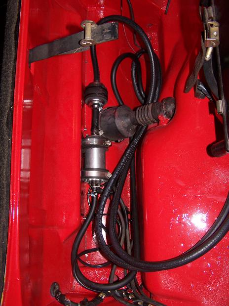

Spoke
When I redid the tank I made the feed hoses so long that I could pull the tank from the car w/o disconnecting hoses. Even welded up the round access hole I no longer needed.
Good luck with the leak.

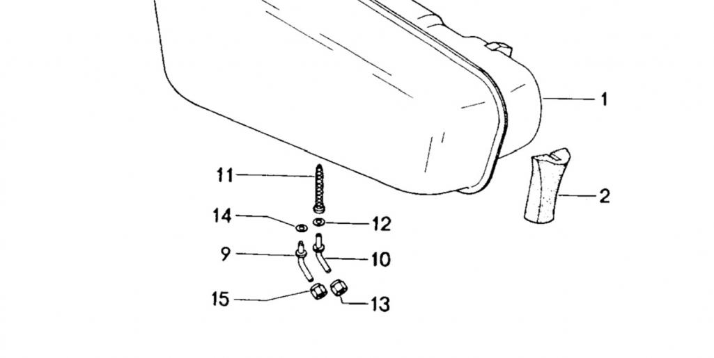

NARP74
Looking at the PET for a 74, the parts description says gasket not washer. That seems to indicate it should be fiber based.
So why is it that no company offers the correct part? All of the ones I see sell a copper washer with a new tank sock. I understand you can buy kits and other gaskets that need modification. But why does no one sell the correct product that just works?

Shivers
QUOTE(Spoke @ Aug 7 2026, 02:36 PM) *
Oh heck, you did. But where will the rodents live. Man I really like that. I’m going to make a metal cover. aktion035.gif

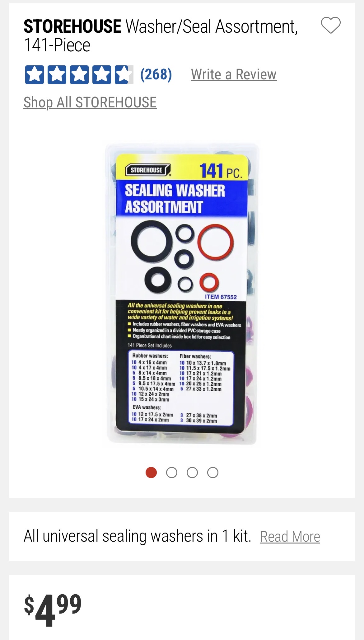

DennisV
QUOTE(Superhawk996 @ Aug 9 2026, 10:29 AM) *
The generic HF kit has washers that are so close that you’re only trimming off maybe 0.5- 1.0 mm off the ID. It is easily done with a dremel, a hand file or sand paper wrapped around a screw driver.
Have you used these without issue? HF product description seems to indicate they are for water systems. Some very cursory poking around seems to suggest fiber washers meant for fuel get vulcanized. Maybe I'm over thinking it.
What is the proper ID and OD of these? I see photos in the parts vault but no dimensions. They seem to have a wide mating surface if those photos are of originals.

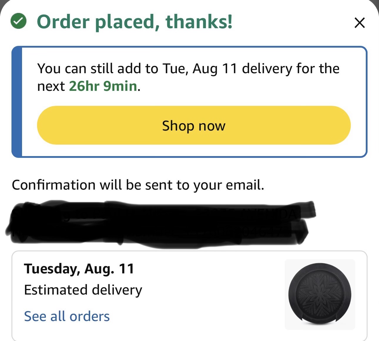

Shivers
QUOTE(914Sixer @ Aug 9 2026, 10:23 AM) *
Check the hole size and just get a guitar hole plug. Keep it simple.
An excellent idea. Thanks. There are rubber plugs all over this car. This is the one they forgot. A dab of silicone so it doesn’t drop out between uses.

Superhawk996
QUOTE(DennisV @ Aug 9 2026, 02:58 PM) *
Yes you are.
Red fiber washers are vulcanized (ie. Formed under heat, pressure and with chemicals that cause the fibers to bind together) but still allows them to swell slightly to seal minor imperfections. Though we usually associate vulcanization with rubber, fiber washers do not contain rubber.
NARP74
Amazing what you learn when you get determined and decide to go all in. I drained the tank and took both tubes apart. As mentioned by someone before, I did have existing fiber washers already on each tube. They were so old and compressed it was hard to determine that they were not part of the brazed on fitting that the nut fits against. I was able to pry them off but they cannot be reused. They might be original to the car. The car was repainted so the tank was out at one point, but it had copper washers on top of the fiber ones. No way I was going to get that to seal.
Anyway, looks to me like the dimensions for the two fiber washers are;
Larger tube, feed side, ID 10mm, OD 16mm
Smaller tube, return side, ID 8mm, OD 16mm
Those are approximate. As mentioned the old washers were very fragile.
Someone please correct these if I am wrong. I asked AI a little while ago and it said no one had entered them into 914 World. So here they are for future use.
