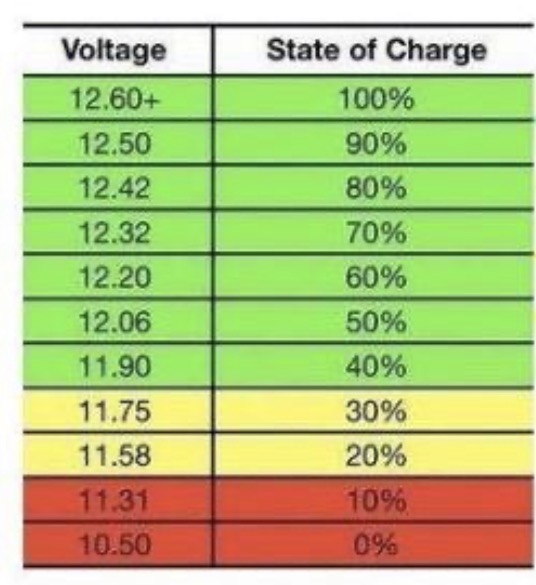

jmargush
Haven't tried another ground yet .
It has been cooler so the hot start doesn't seem as bad, but I am starting to question the battery.
After setting for the afternoon on Saturday it was sluggish to start.
Today i checked resting voltage and it was down to 12.2v.
ON first cold crank battery voltage dropped to 9.1v
Second crank it only dropped to 10.1 and then fired up ready to run.
Does this point to a battery that is on its last leg or hard to tell at this point?
Superhawk996
60% SOC isn’t great
The fact that it drops to 9.1v when cranking is basically telling you the battery is on its last leg.
If this is the best it gets after charging the battery it’s toast.
