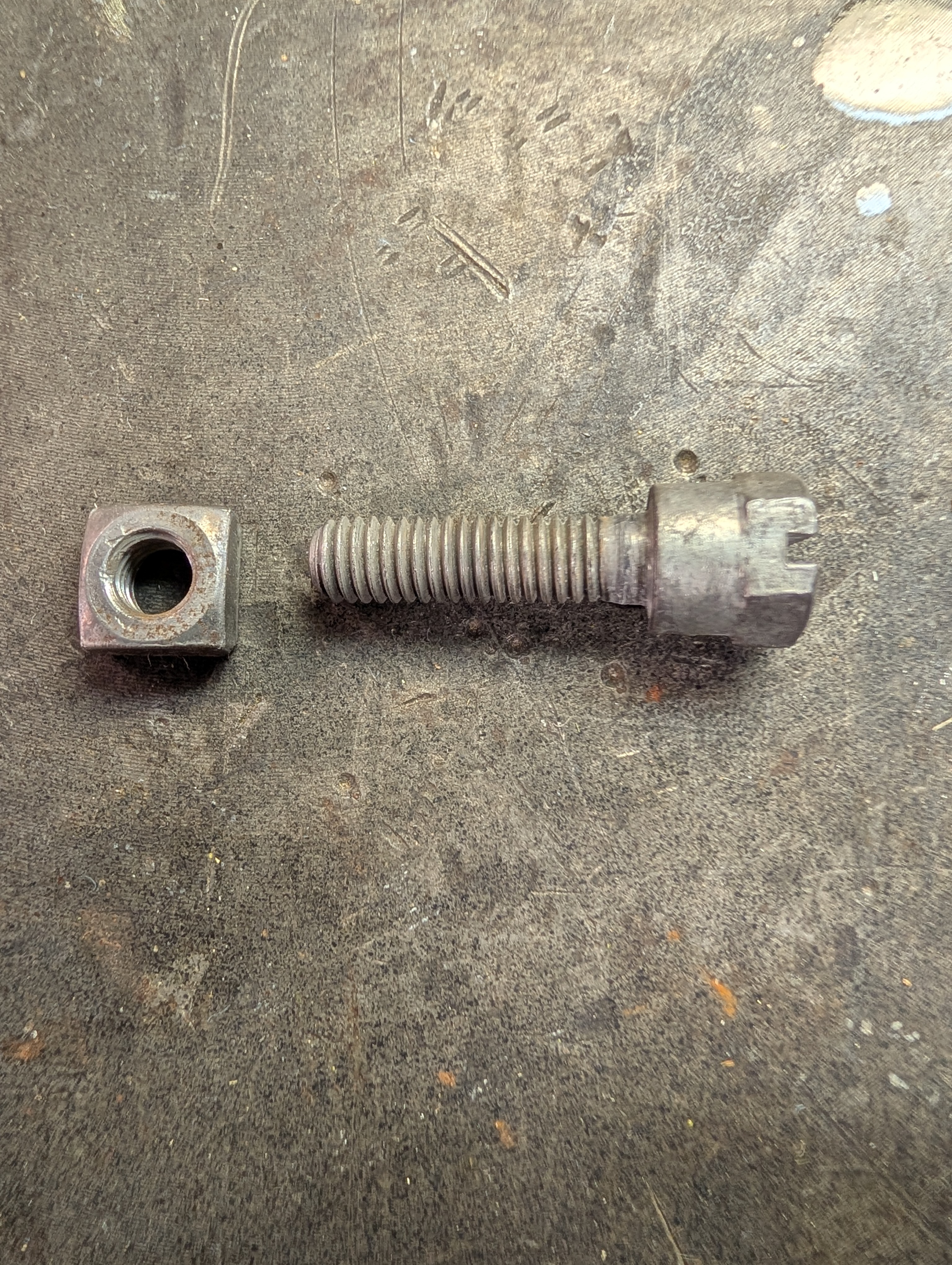

DennisV
Is this the correct bolt to secure the flapper box to the heat exchanger on a 914-6? Part number 901-211-631-00. Appears to be NLA. Paired with square nut.
It is what I removed from a pair of used flapper boxes I bought. I tried installing it on a new Dansk flapper / heat exchanger and it appears too short. Even if I try various clamps to compress the flange and close the distance.

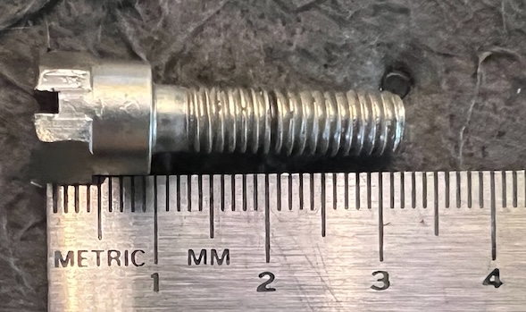

rgalla9146
[quote name='bdstone914' post='3268916' date='Aug 19 2026, 05:29 AM']
[quote name='DennisV' post='3268892' date='Aug 18 2026, 06:40 PM']
[/quote]
I assumed the 4 and 6 flappers took the same bolt. But thevpart number does start with 901.
I can check if a 4 flapper fits a 6 exchanger. Im sure i have those bolts to check.
Im betting it is the Dansk flapper that is the problem
I agree. The bolt on my flappers is 32mm
If the Dansk parts do everything else as they should a longer bolt will do the trick.
If you choose to go with OE 6 flappers I have a pair of beauties
Oh, one more thing.
The bolt extends through the elongated hole. The square nut goes on the round hole side. The round hole side keeps the nut from turning.
And one more. Put a flat washer on the elongated hole side to keep the clamp from getting bent.

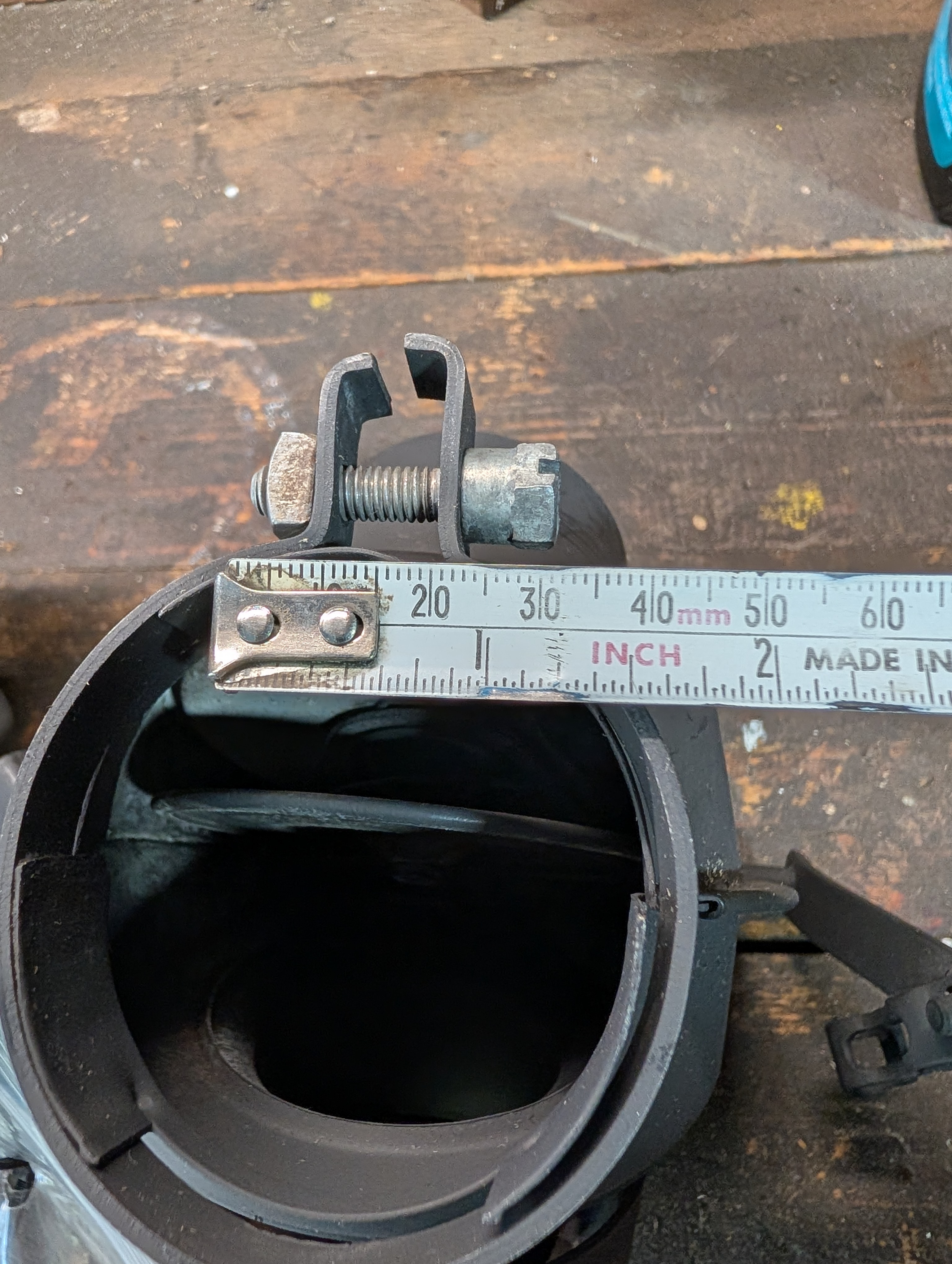

johnhora
Dennis...here is a picture I took today of my OEM original six flapper boxes
johnhora

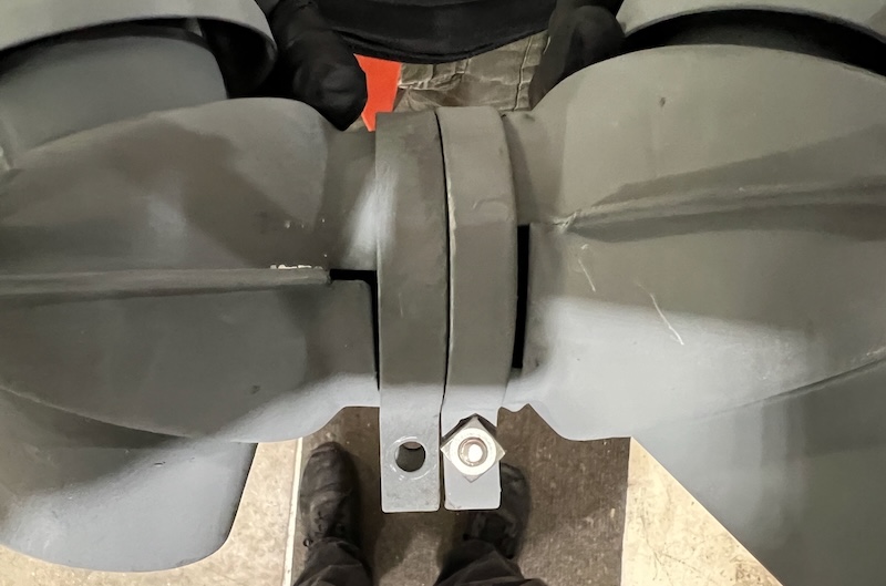

DennisV
QUOTE(rgalla9146 @ Aug 19 2026, 06:50 AM) *
Thanks for that detail.
@johnhora thanks for the photos and dimensions.
Maybe it's the end of the Dansk heat exchanger that is causing the problem. When I put the old and new flappers side-by-side, I don't see any notable difference in the diameters when relaxed.
Original on the right. New Dansk 914-4 with hole cut and painted gray on the left.

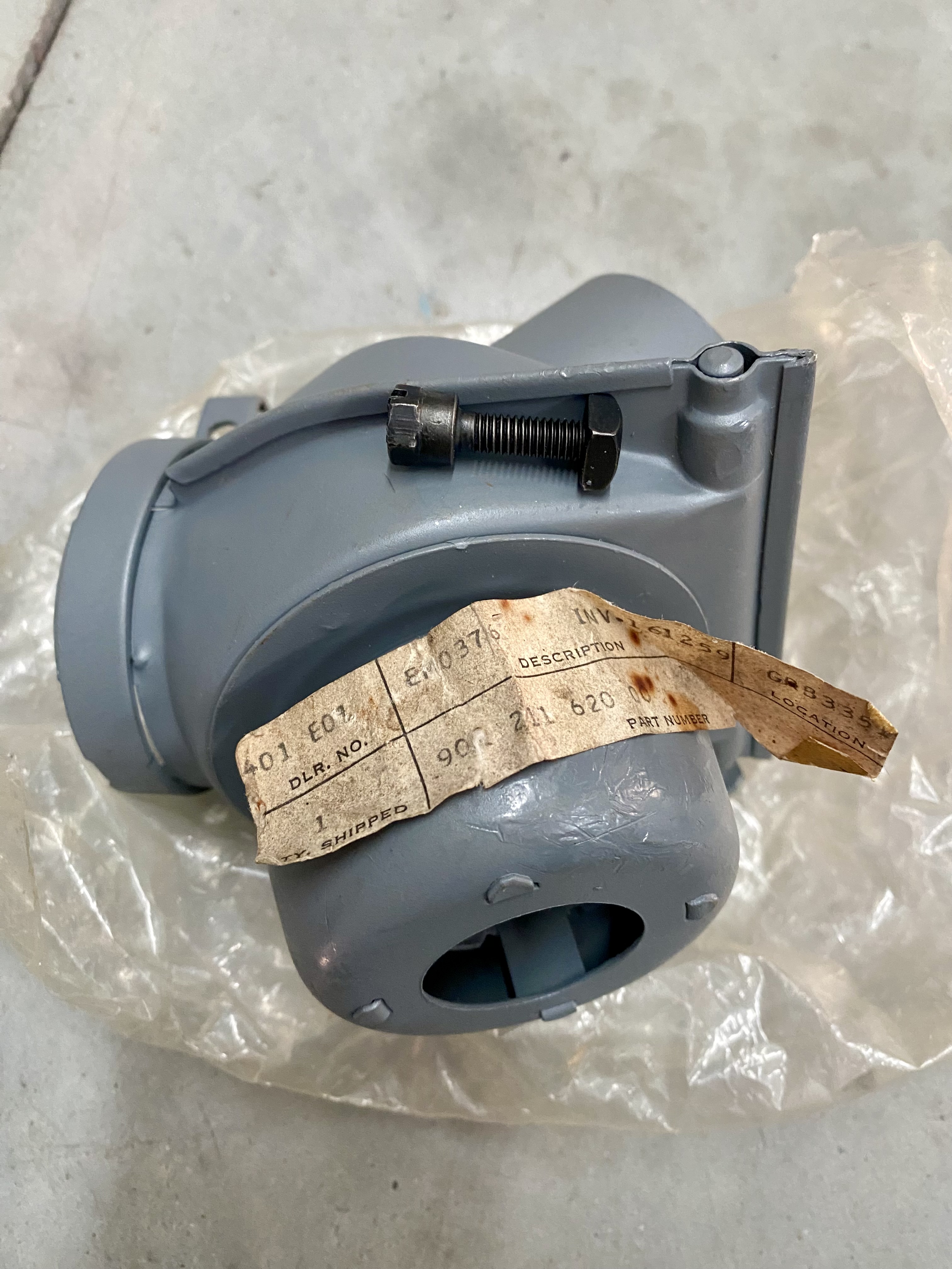

aturboman
Here is an NOS valve and retainer bolt/nut. Interestingly the replacements were black oxide type finish with the unique locking nut.
