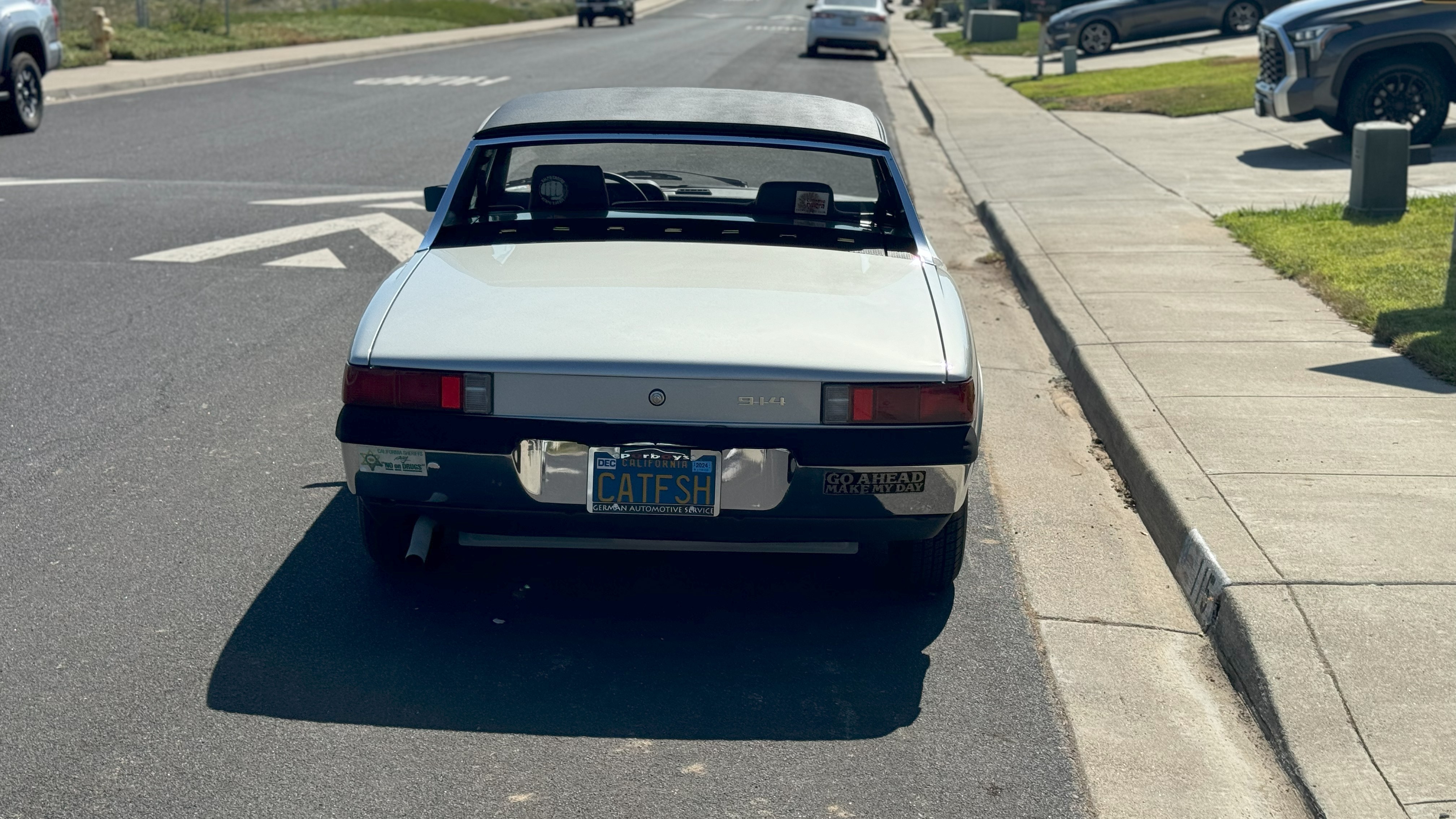

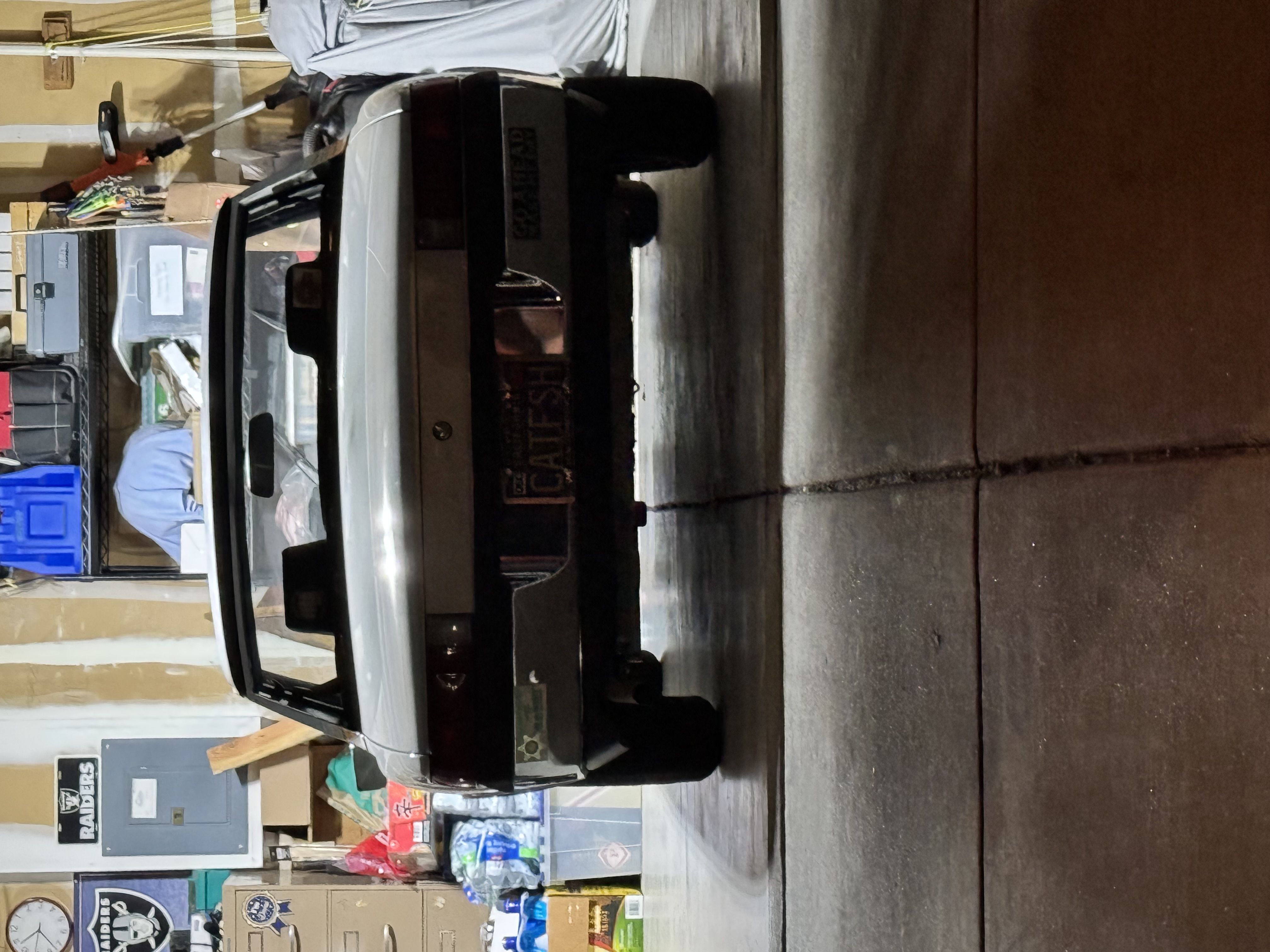

Aug 2026 .... sorry about the orientation
Aug 2024 ... for comparison

1 inch lean is significant. First thing i would check is if a rear suspension console is cracked or any issue with the trailing arm. May be difficult to see without a lift.
I would measure the ride height from the bottom of the rocker panels to the ground, front and rear.
Did you just notice the lean ?
What kind of rear shocks and springs? Could be a rear spring sagging. But they usually gag equally.

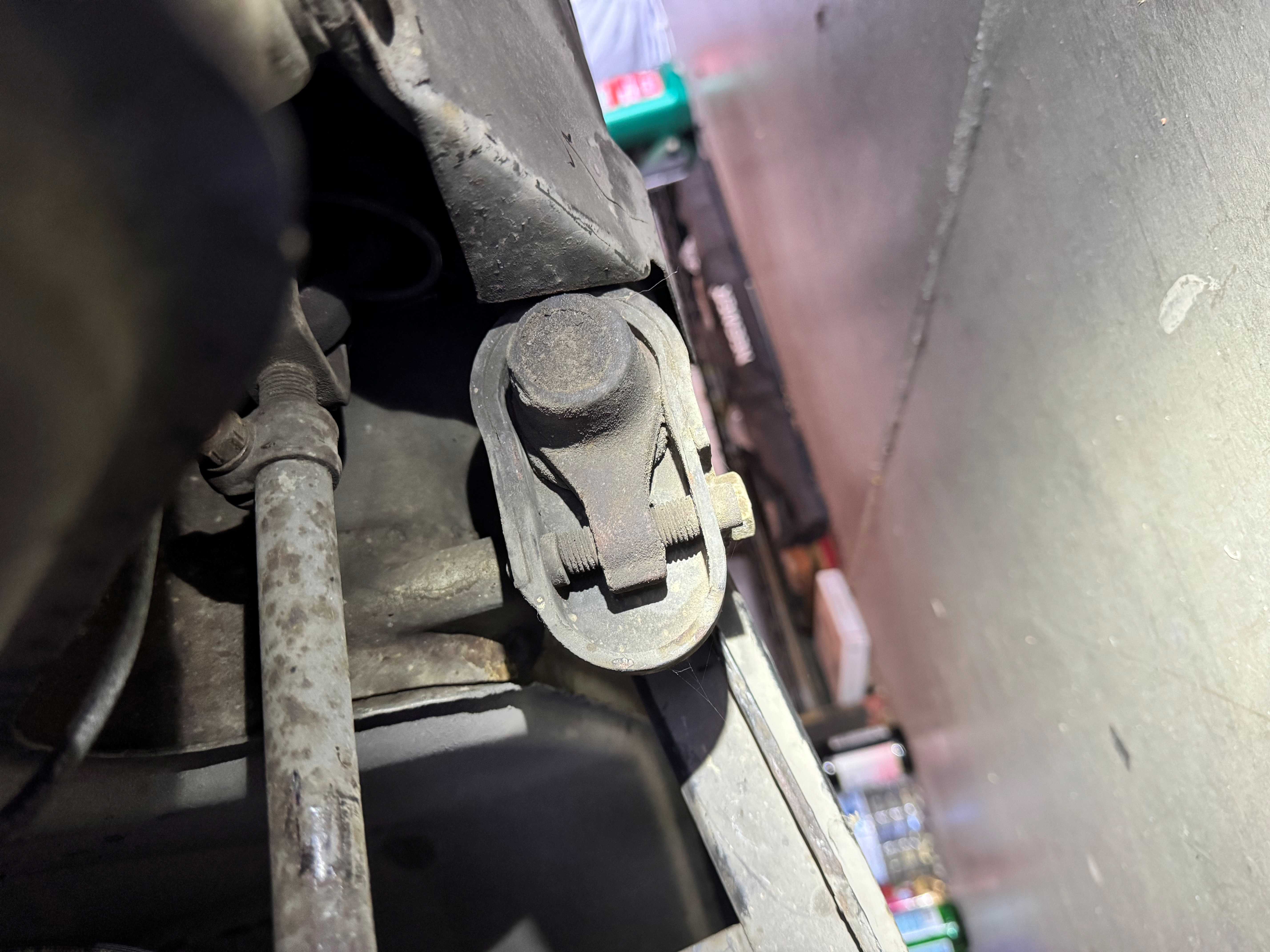

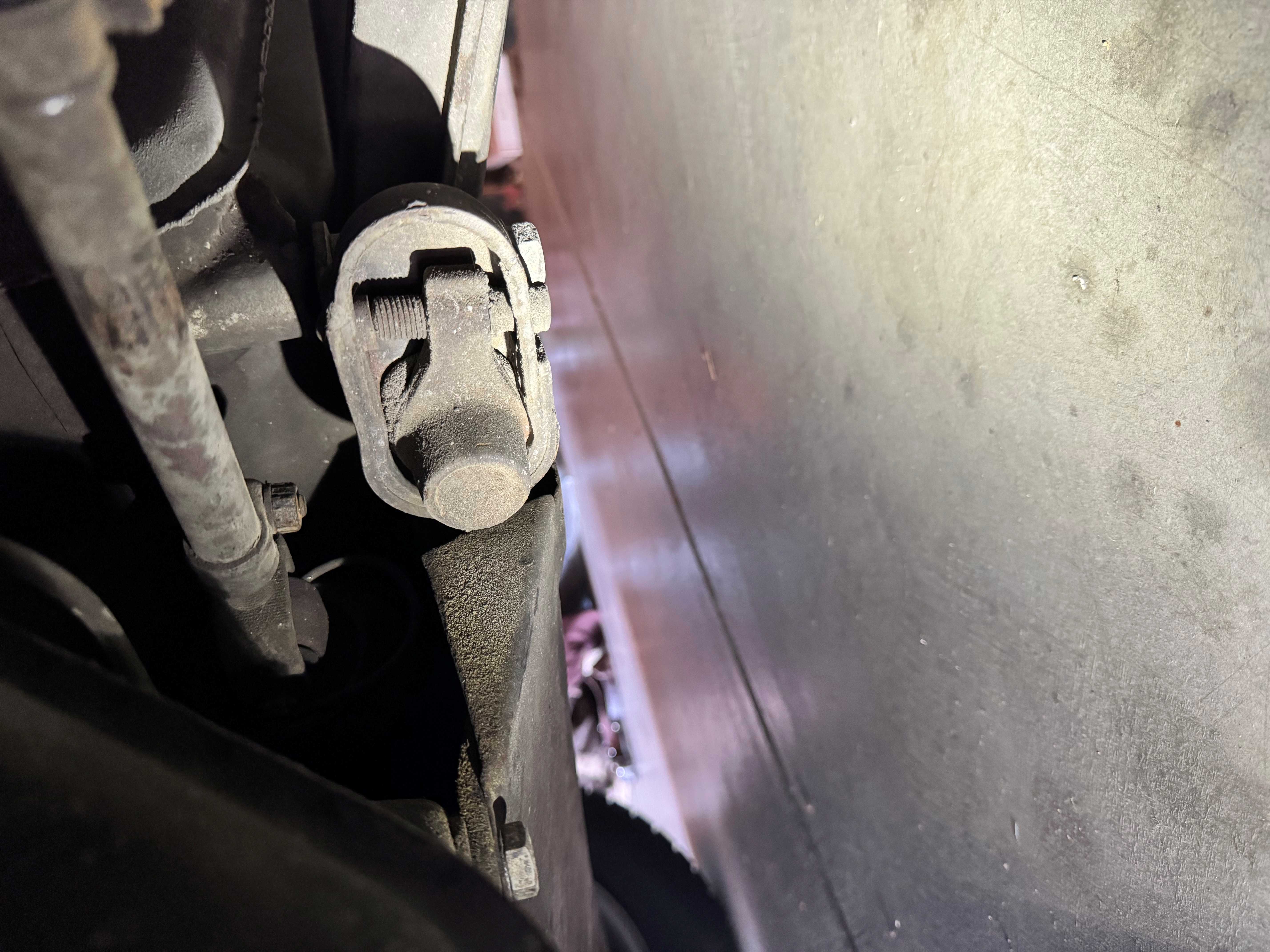

Passenger's Side
Driver's Side

You have plenty of torsion bar adjustment to play with and to get a feel for if you’re going to have to reindex anything.
Your passenger side is near max height so you’ll be loosening that one to lower that side. Driver side is low so you’ll be tightening (bolt clockwise).
Spray a day in advance with penetrating oil to make life easier.
Tightening raises.
Loosening lowers.
Take weight off the wheel when adjusting and never get under car without jackstands in place. (You said you don’t wrench much so forgive me if I’m reinforcing safety)

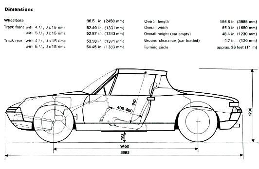

BTW - Found this image at the site below ... does that say 4.7" (120mm) from the chassis (car loaded)? Wow.
https://www.p914.org/p914_dimensions.htm
