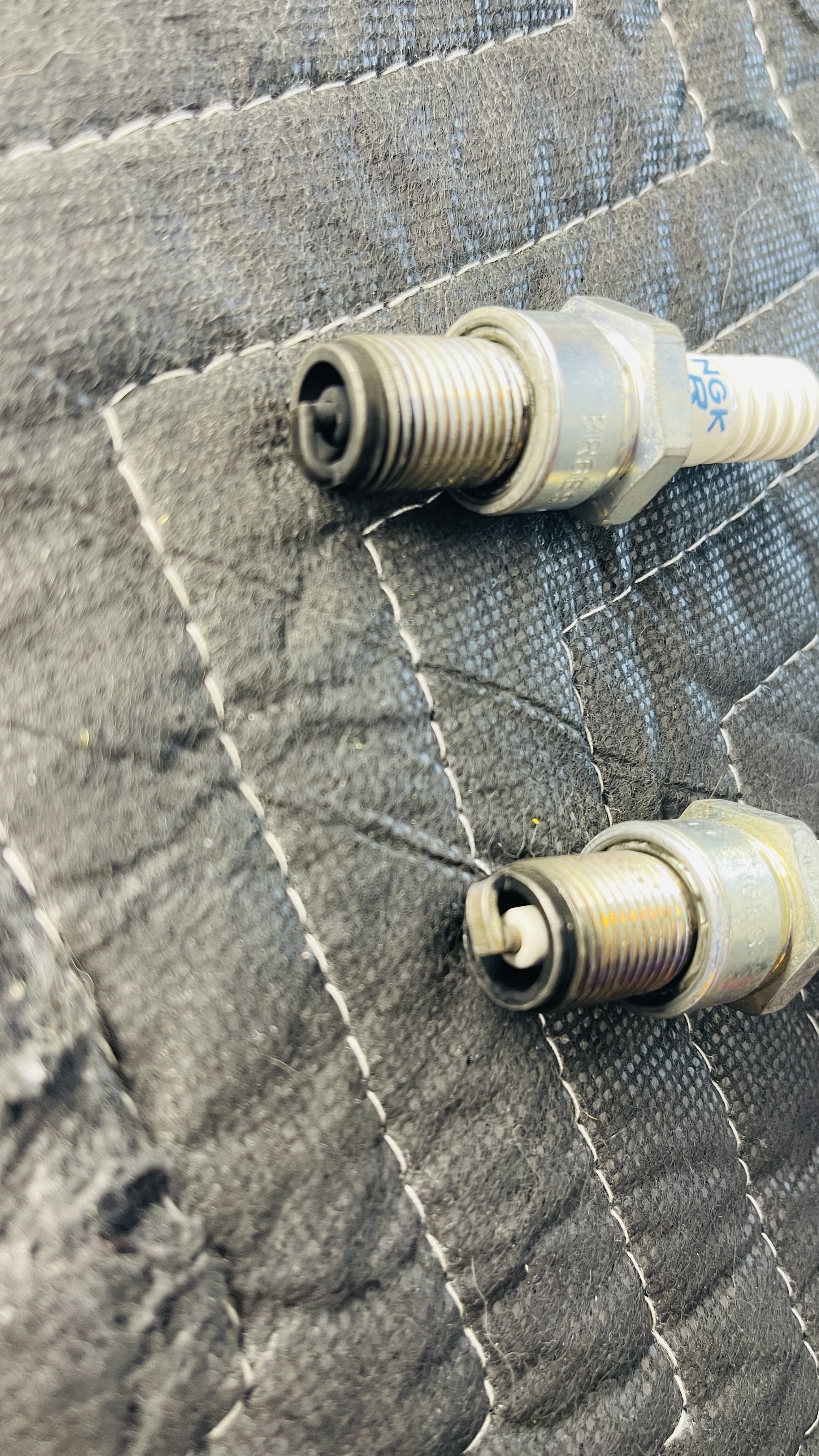

Need to determine what is missing the fuel or the spark
That plug on the bottom has previously fired as witnessed by carbon on threads and residue on electrodes but it also looks extremely lean.
If I were betting I’d put money on a clogged injector but you need to verify what’s missing and not trust a hunch.

Not enough info yet...
What do the other plugs look like?
Does the fouled plug have a gap? Hard to tell in picture.

In the end what you have there are two plugs and neither looks normal.
One fouled rich
One running lean

took plugs out and all were sooty, except #2.
took plugs out, emery clothed them, put them back in and same thing.
all sooty, except #2
