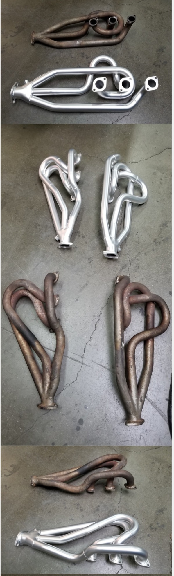

MSDS exhaust headers installed by RuF on this beauty >>my Sonauto #40 style with our improved merged collectors. Alois ordered 2 sets 1) for this white tribute car, and another set on a tribute car I noticed on Instagram. I'll give him a pass on RuF taking credit for 'Their Stainless Steel exhaust' system...I've met with him and Alois is a totally stand up guy ! The headers are NOT sold in SS, only raw carbon steel/ or Ceramic coated, these in the BaT ad are raw carbon steel.

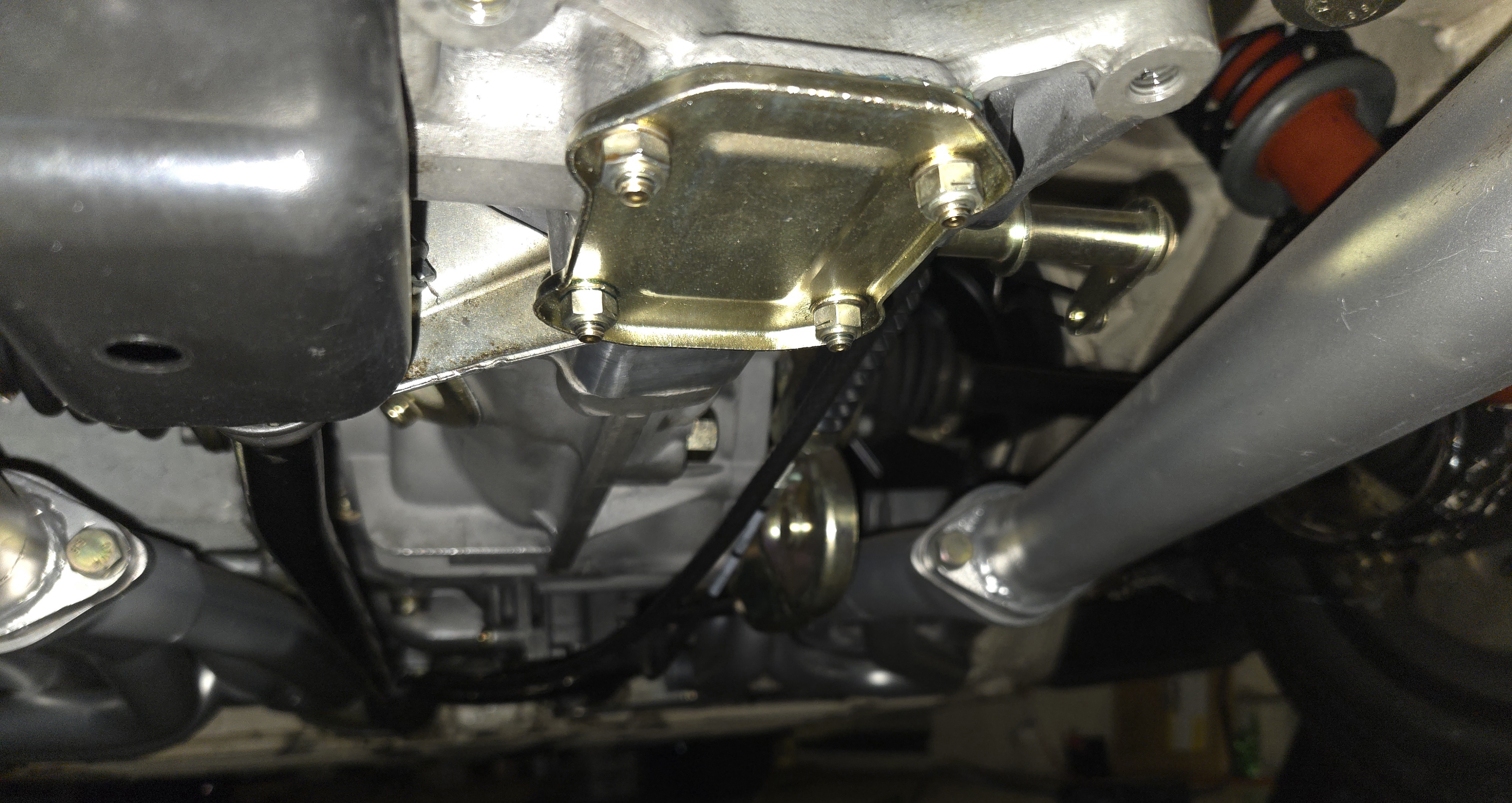

QUOTE(Maltese Falcon @ Sep 26 2026, 04:03 PM) *
What kind of rock star would route a wiring harness though the tin w/o a grommet?
wonkipop
QUOTE(JeffBowlsby @ Sep 26 2026, 06:35 PM) *
good eye you have jeff.
the answer is a rock star. rock stars are all the same.
but .......its also not tin, its fibreglass. probably passable? maybe. grommet probably shatter the edges of the no doubt well and truly aged epoxy assuming its vintage "tins" or is that "plastics" in the case of a "not a not a real porsche" engine. i dunno. beerchug.gif

The #40 gt equipped with sheet metal/ no fiberglass here. We did get her with several bumps + grinds appearing on the tin>> but came out perfect after using body shop hammers/ tools then blasted, powder coated. For sure a nice new grommet installed there too. Fiberglass is a nice touch + not necessarily period correct to a gt...but unless it is flame retardant a faulty Weber /fuel line could be a handful.

Well they did install Glendale's best.
Factory gt headers (re-purposed from 906) only available in 1.5" o/d tubing>> way restrictive on a 2.4L We build these in 1.625" and 1.75" o/d for bigger engines. RuF went with the larger size, and the engine makes just under 250 hp welder.gif

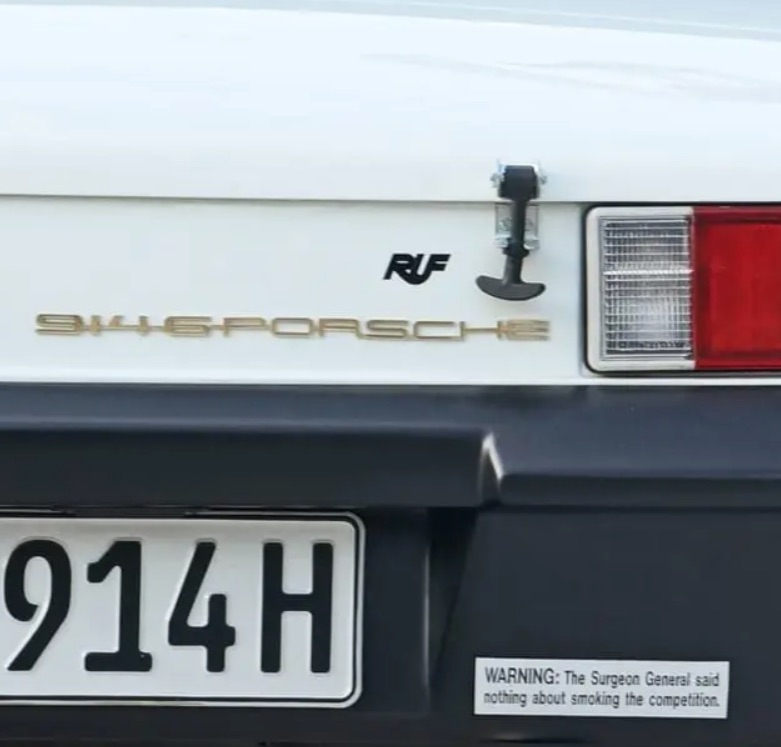

davep
The VIN stamping on the right inner fender is dodgy. The paint badge is not correct; and what number did they use for the production #? The transmission serial and type numbers certainly look like 911 and not a 914/6.
Other than that, the car build looks good.

QUOTE(davep @ Sep 28 2026, 11:05 AM) *
asterixs instead of stars either side of stamped number.
whats with that?
ones i have seen use the star symbols on that stamping.

Well, 9140430059 has the same kind of asterisks. That is the press car in England that was crashed and had a chassis replacement. Those asterisks were used on 1971 & 1972. All the 1970 cars had stars. I wonder if this is another chassis replacement? The VIN plate on the headlight bucket is correct but has some small imprefections in it.

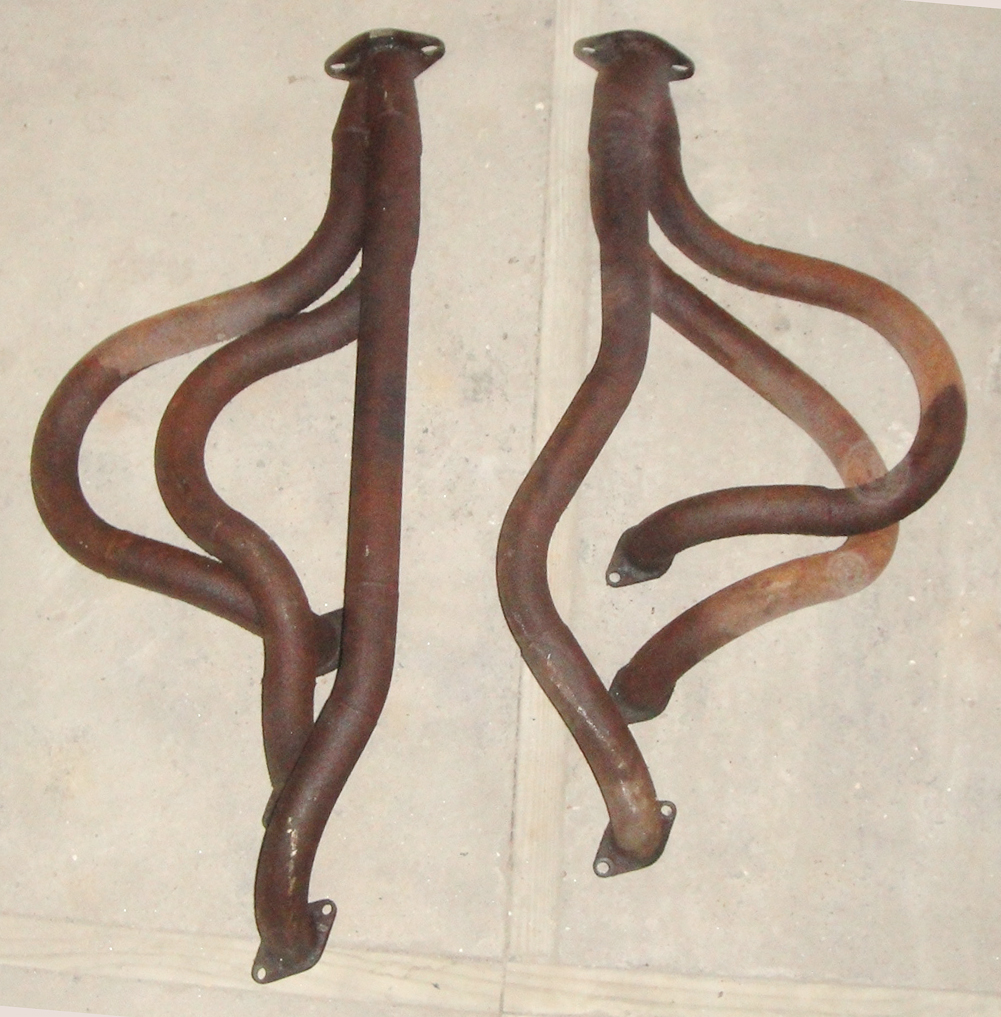

gandalf_025
Just as a for what it is worth..
This is a set of headers Ralph Meaney used on his 914's back in the day.
They look pieced together..
I used these on a 2.5 years ago..

agree.gif There are supposed to be stars at both ends. Looks like a center punch mark in the middle of the right side astrik dry.gif shades.gif

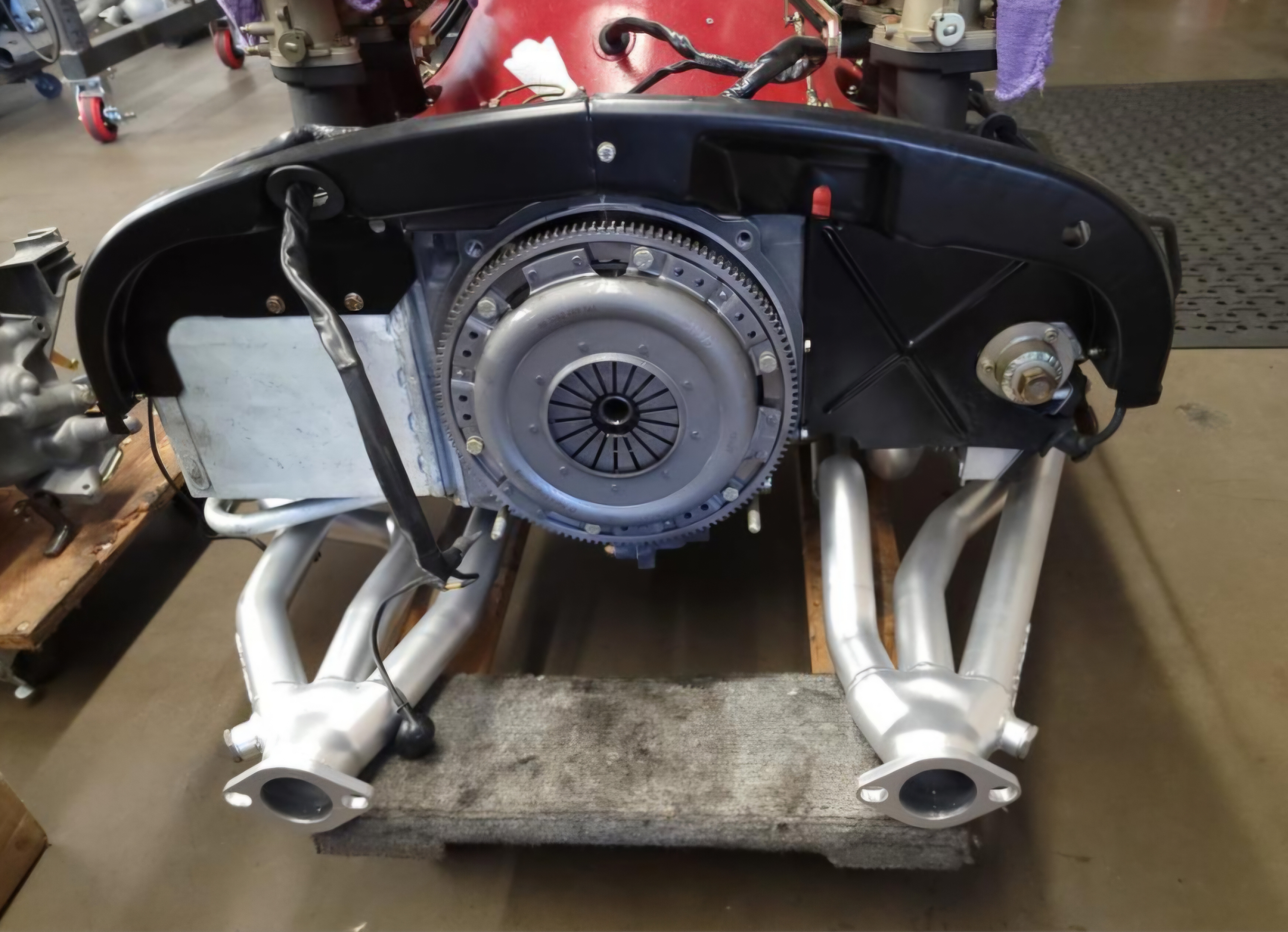

The trans is from a '70-'71 911 to get a larger/stronger pull type clutch.
No plastic pulley needed. The 914 rear cover is a bolt-on to the 911 trans.
