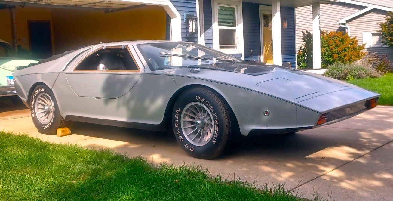

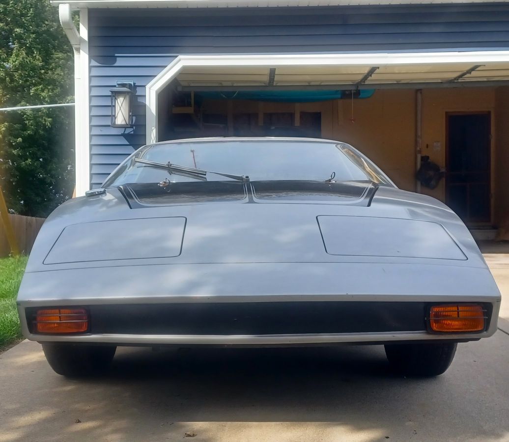

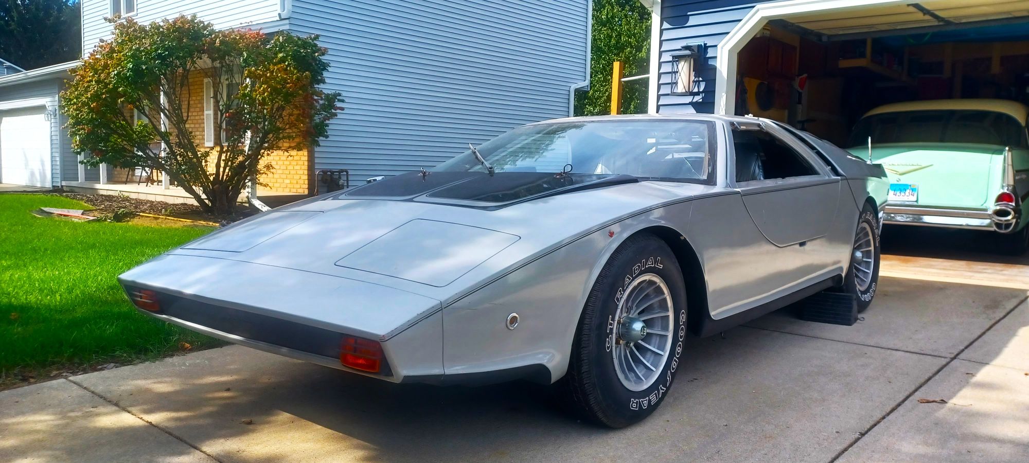

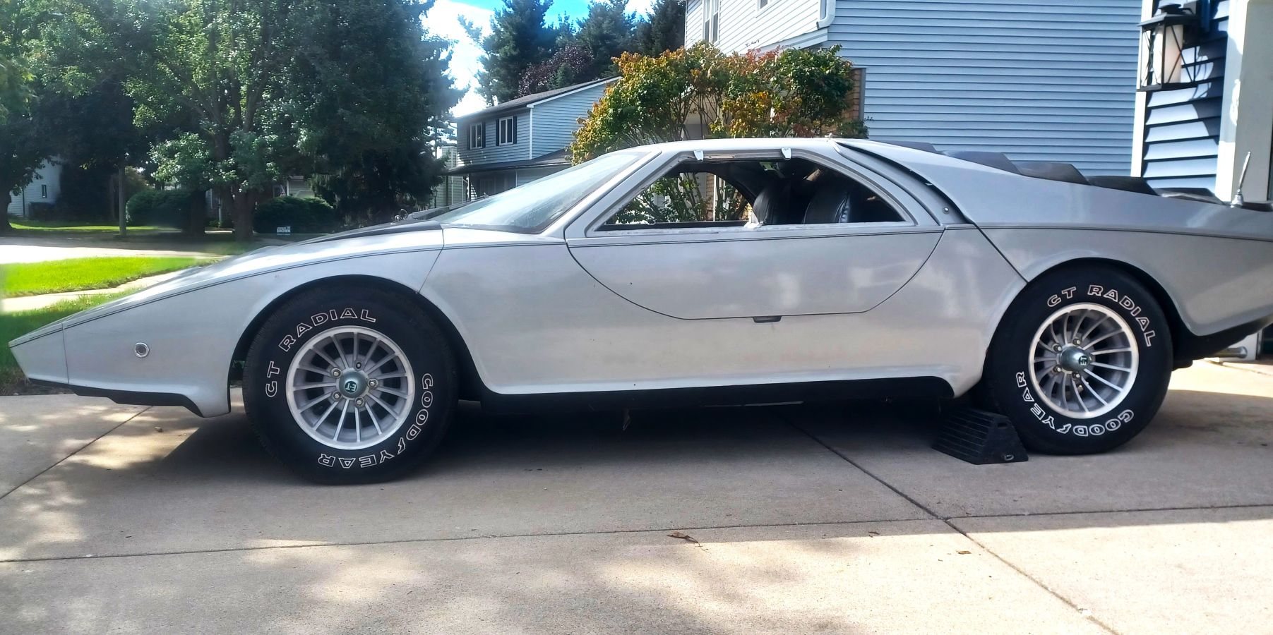

I just purchased a Fiberfab Aztec 7 Kit Car.
I bought (traded for ) another Aztec 7 in the early 80's. It was my daily driver in college for a couple of years before it caught fire and was totalled. I've always been half looking for one since and just missed out on a yellow one last year.
I was browsing FB Marketplace and found this one. Contacted the seller and purchased it last weekend.
It's based on a 72 VW Beetle with a 1600 dual port engine, a 2bbl Holley Weber, header exhaust and AC (weird looking AC compressor), etc. In true 80's style it has (had) a CB/AM/FM radio unit (missing) with a "deluxe" mic that has the channel changer, volume dial, etc. built in. It sort of looks like a mini voice recorder at first glance and also has a retractable CB/AM/FM antenna (broken).
Of course it has the obligatory "Turbine" wheels on it. IIRC, they're 14 x 7 ET's on a "Unilug" 5 x 4 3/4" Chevy pattern on adapters with brand new / 40+ year old raised white letter "letter size code" tires on it. The tires still have nubs on the treads.
One big upgrade from the original kit was curved laminated glass side windows, as the OG ones were plexiglass. They're currently out of the car in storage
The engine had some odd looking gizmos hanging off of it and wondered what they were. I climbed in the car and looked up and spotted it, an aftermarket push button cruise control system panel mounted in the overhead console! That also explained why there were these weird beaded chains dangling from the clutch and brake pedals. I don't ever remember seeing a cruise control system on an air-cooled VW.
Here's a few pics.
I’ve never seen one. Looks like a dodge front side marker.
Nice looking car.

I read Aztec (Aztek) and kit car and I really didn’t want to like it, but it does look kind of cool…

Needs an air dam. Twin Turbo Subie 6 There are adapter kits for that VW setup. Easy swap idea.gif aktion035.gif
Root_Werks
That's one of the nicer ones I've seen. Nice find!
QUOTE(rick 918-S @ Oct 1 2026, 07:19 AM) *
Needs an air dam.
That nose will force a metric shit-ton of air under the car at speed!

type 3 suitcase engine or is it an upright fan type 1?
has a low rear decklid from looks of photos, unusual for beetle based kit cars of old with upright fan engines.
quite a nicely proportioned body. never seen or heard of one before.
love the single wiper. very citroen.

Very cool, I like it! One of the more stylish and well proportioned kit cars of the era. Good advice above on the spoiler. What does it need or what do you have in mind for changes, if any?

Upright fan 1600 dual port 1600, fits just fine under the rear deck. Wouldn't mind a type 4 upgrade eventually...
Single wiper, cool. Rigid wiper blade off a truck / bus, not so cool. One of the first upgrades in the works.

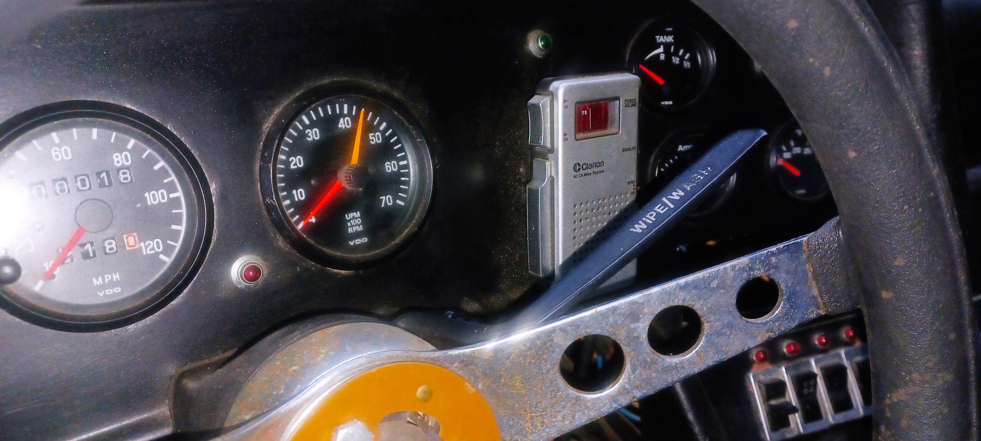

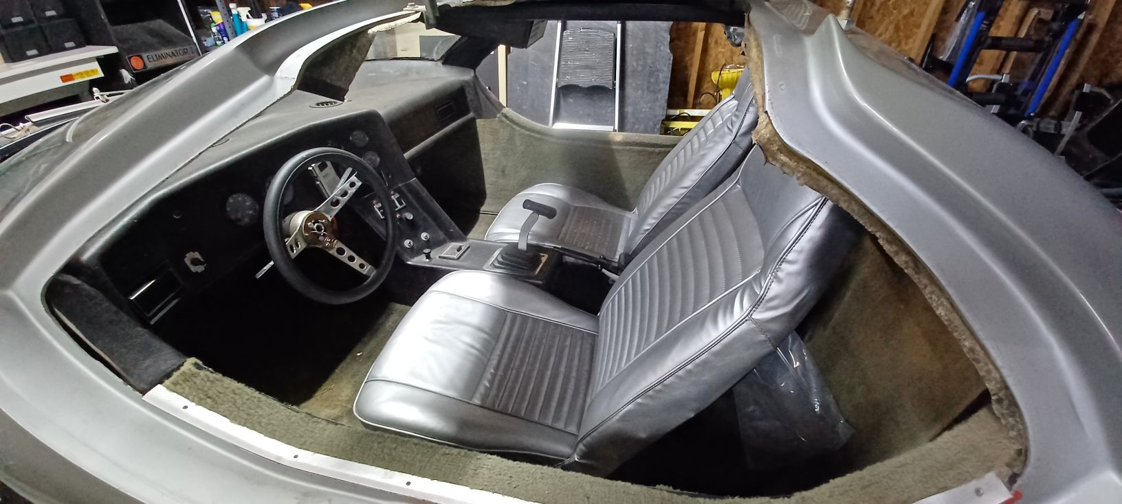

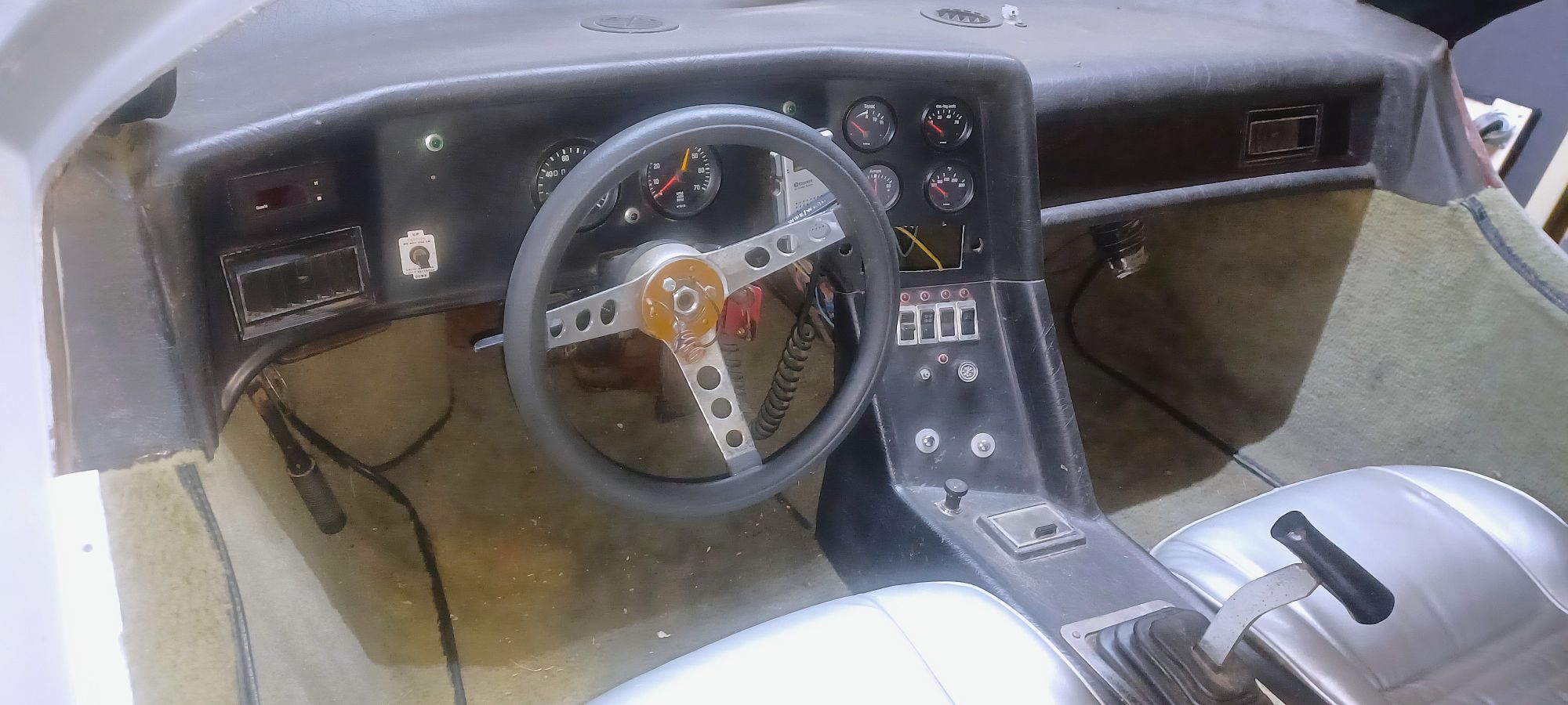

Interior pics, hasn't been cleaned yet. Needs new gripper / bulb door gasket on door opening. I think the carpet was silver at one time.
Any idea what these seats came out of? Really wish the seats backs would move / recline. Currently fixed in a laid back position out of necessity due to low roof. Seats move back and forth, maybe 4" total. 914 seat adjusters might be a better solution.
Also could use help identifying the steering wheel to find a spacer, if possible (waay too far away for my short arms) and a horn button for it.
I think the CB radio is still present under the dash. Love the CB mic!
I think the shifter / linkage has been modified / moved back, as my last Aztec 7 had the shifter MOL in the bottom of the dash console.

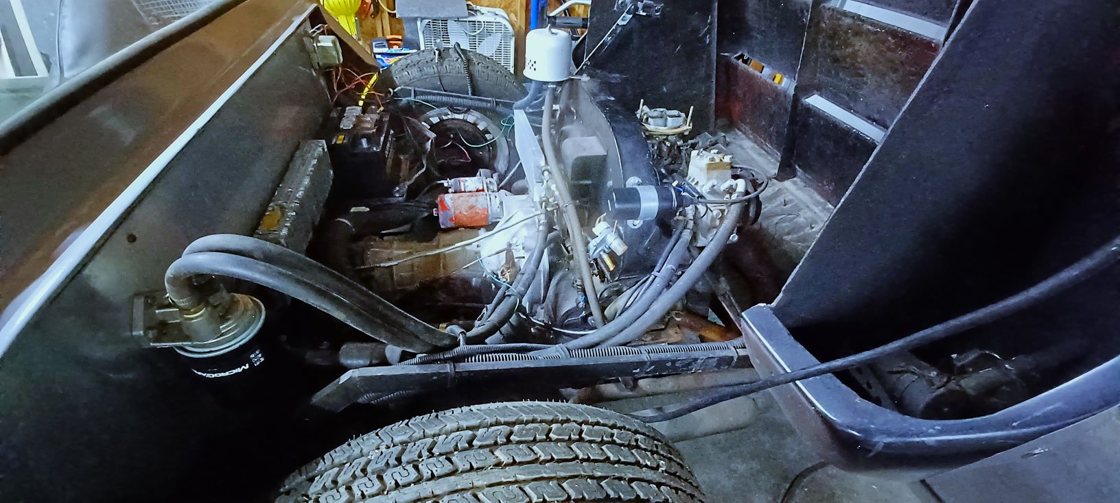

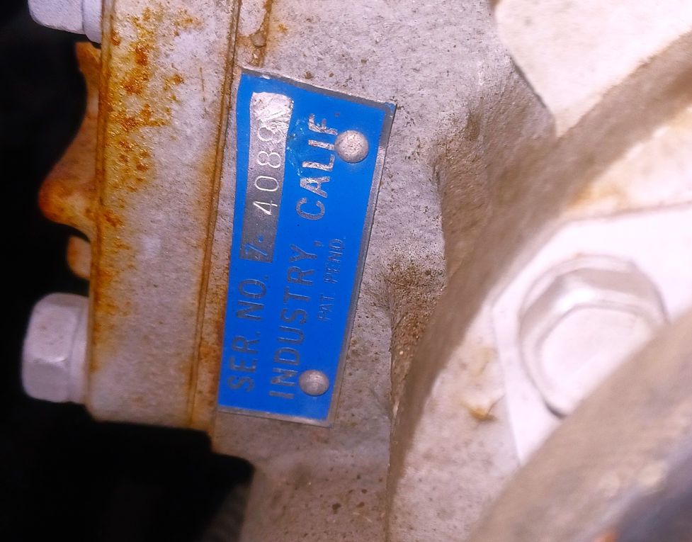

Engine bay pic. It has a Motorcraft / Holley 2 bbl carb kit on it, nice cast aluminum valve covers vented to a K&N breather, a 009(?) centrifugal advance dizzy, oil temp and pressure senders, external oil cooler with deleted stock cooler and remote filter, what's left of the cruise control components, stock heater boxes with aftermarket glass pack exhaust, etc. Still has a functioning bellows thermostat, which seems kind of odd given the lack of surrounding tin and the oil cooling mods.
I'm guessing that the engine might have a few mods / upgrades given all the extras on it.
This VW also has an R-12 AC system using a (2 piston?) compressor that I don't think I've ever seen before. Anybody know anything about this compressor?

The city of Industry, not surprised. Back in the day there was a lot of fiberglass and race cars coming out of Industry. A type 1 is a good sign. I am a little surprised with its own frame that it didn’t end up mid engine
