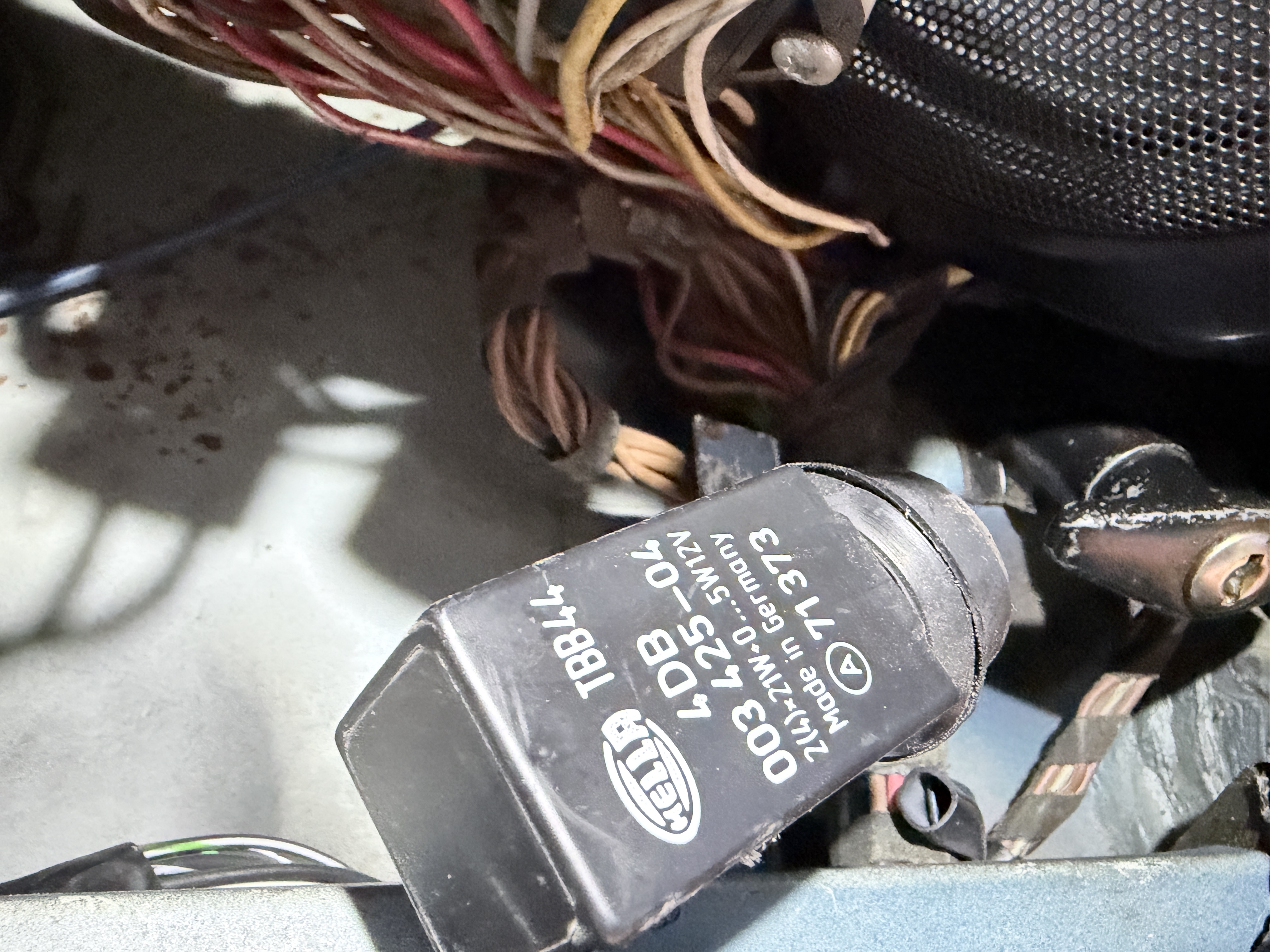

Cvrguy
The car came with a JWest fuse panel installed by a PO. When I lowered it, the common ground point was obvious. This rectangular flasher fell out from above the lower bolster. There is also a flasher module on the back of the fuse panel. Any idea which is which? What is the empty relay supposed to feed?
