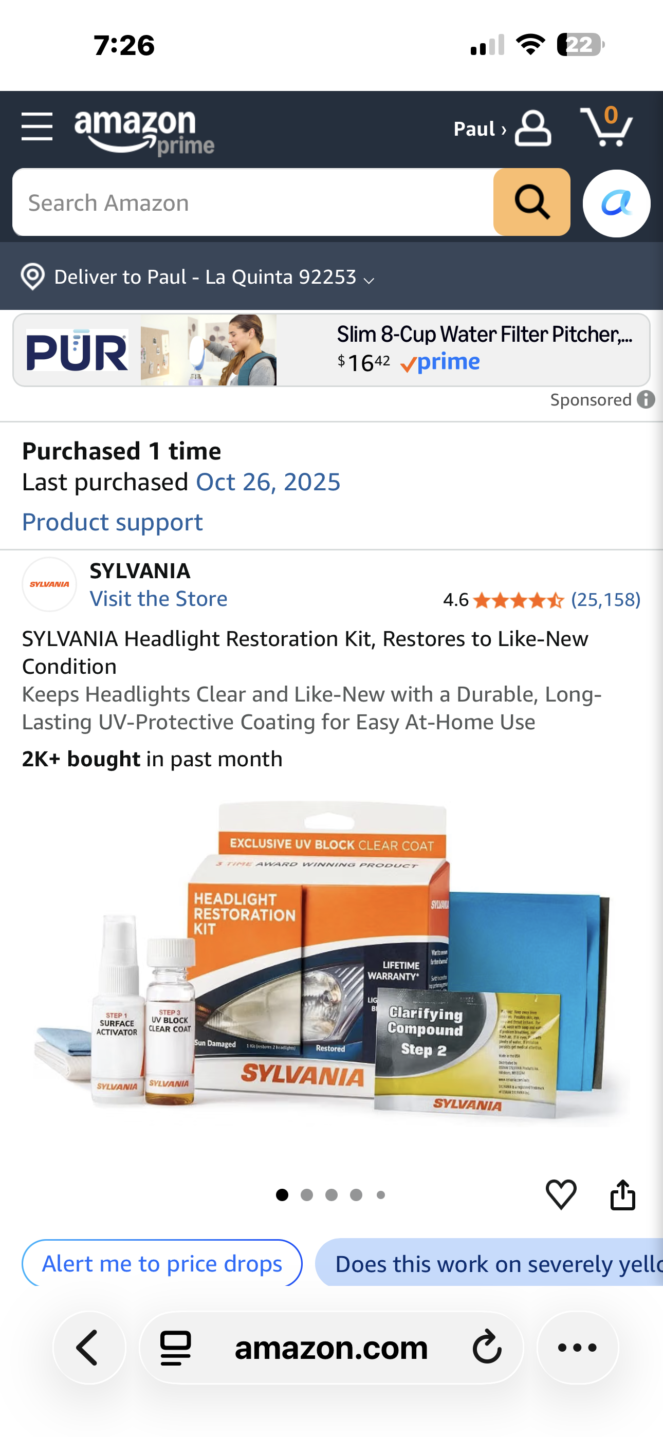

This is what I used about a year ago. They still look good.
Link below to the item on Amazon.
Amazon

Yup, the other two available are Sylvania or 3M. I guess pick one and see how long it lasts. Thanks for the input guys!
