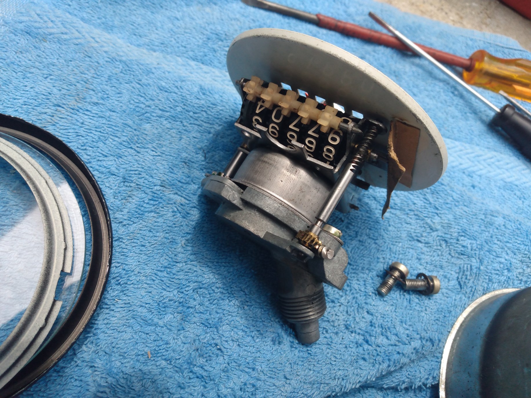

This is what you will see when you open it up.
Worm gear at bottom right is driven by speedo cable.
That turns the brass gear on the odometer shaft.
The worm threads on the other end turn another brass gear on the dial shaft.
Just have to get in there and figure out what isn't turning properly. Click to view attachment

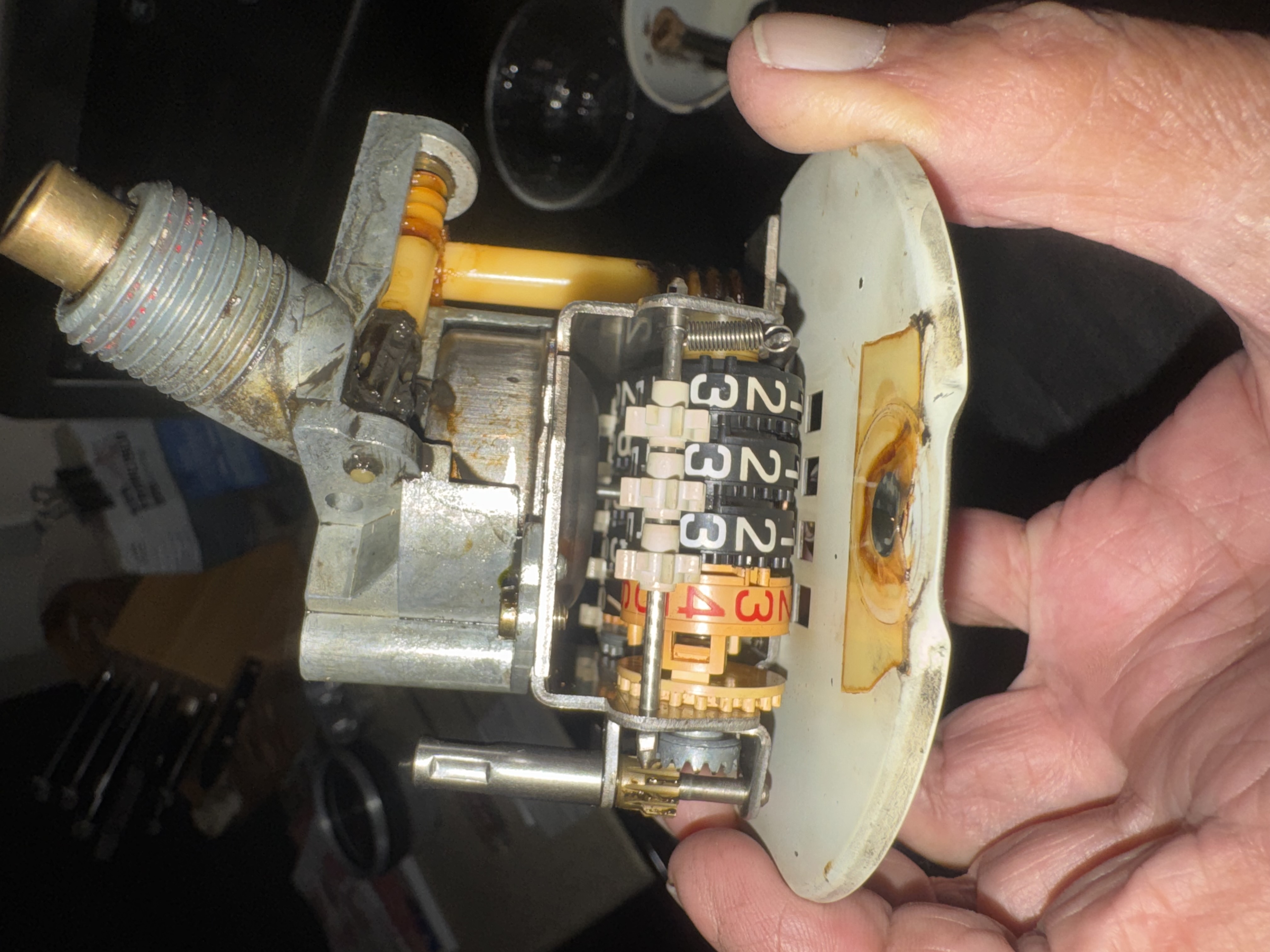

Other side.

Thank you! Just what I was looking for… gotta give it a try. Dennis blink.gif
