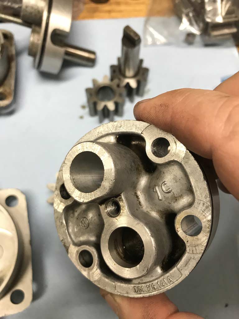

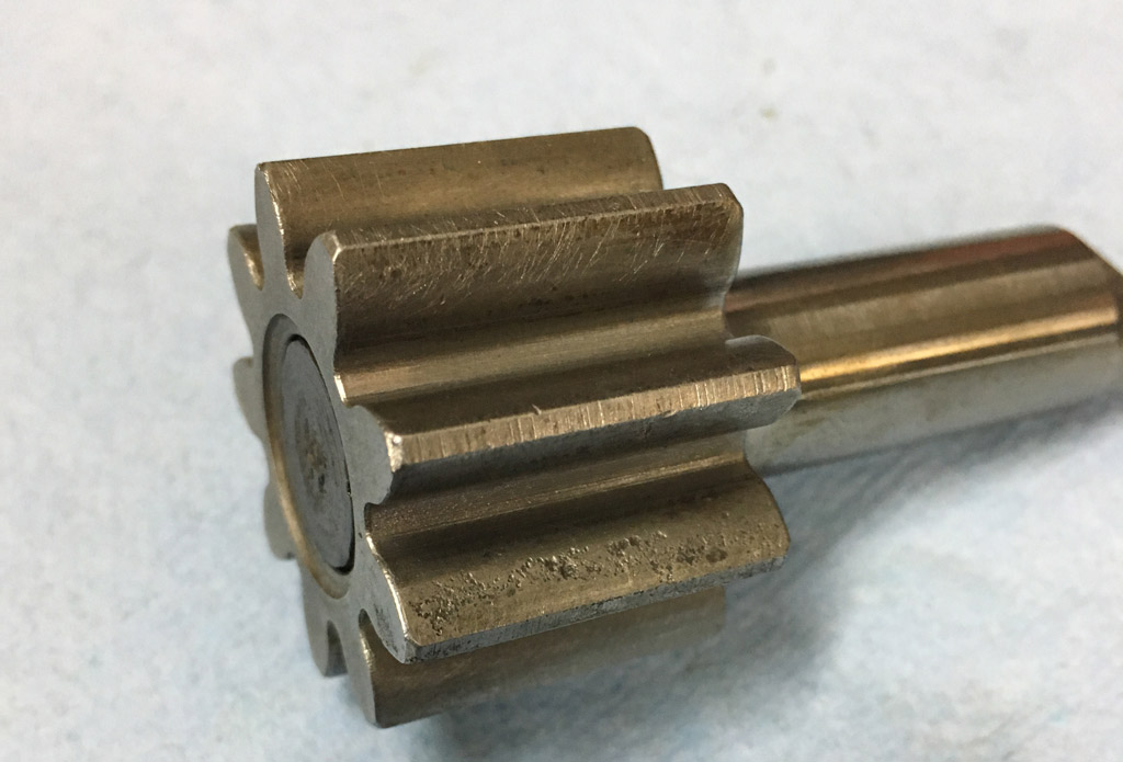

Playing with the idea of what it will take to rebuild a type 4 pump.
The pump that came out of my 2.0L engine is trashed from pumping rust. Both the gears and the housings are seriously scored.
I figured I'd roll the dice and see what might be on Ebay. Took a gamble and bought a used pump hoping I might get some core parts that are useful.
I did end up with a good housing outer. However, the gears are pitted and it the inner housing plate either has a serious casting flaw, or some sort of galvanic corrosion that pitted it. I always struggle with this kind of thing. It really would have minimal effect on the pump and it probably worked OK for a lot of years. However, I'd just like to know that it is perfect going before going into a engine.
It looks like new inner plates are available but at a cost of $150+.
I decided that since I have a donor "scrap" pump, I have nothing to lose by experimenting with machining it.

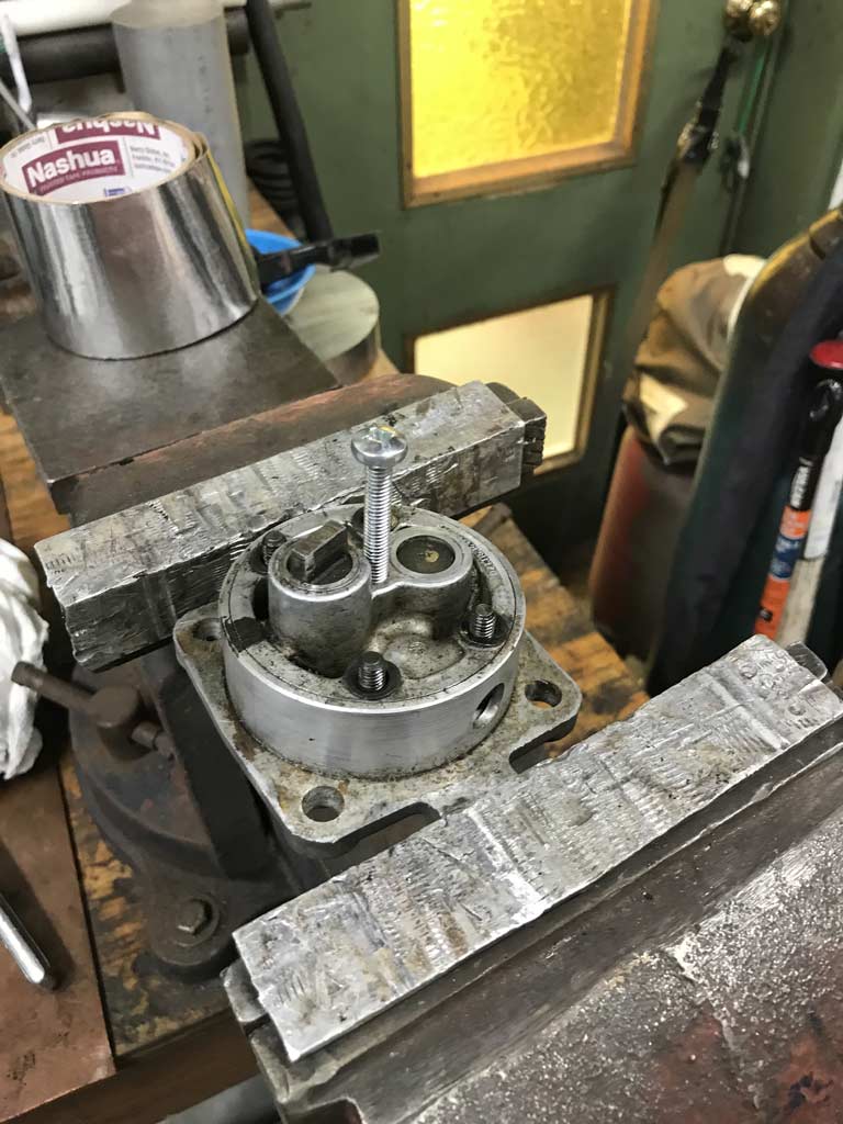

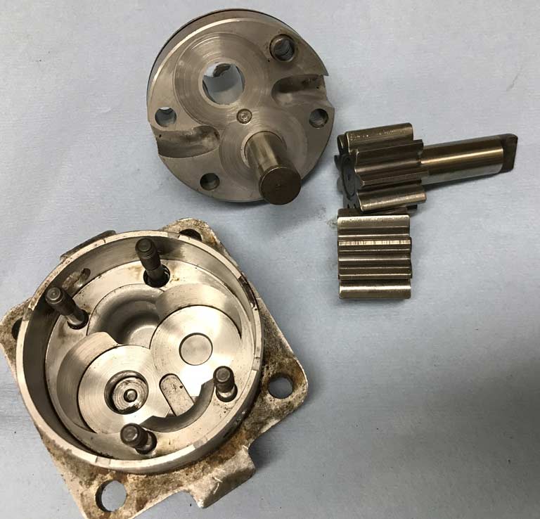

I decided to start with my original pump inner housing since that was in better shape.
On the original it had some light scoring and the stationary shaft had been pushed out toward the cam and actually had been lightly brushing the cam bolts.
No harm in messing with this one. Disassembled for machine work.

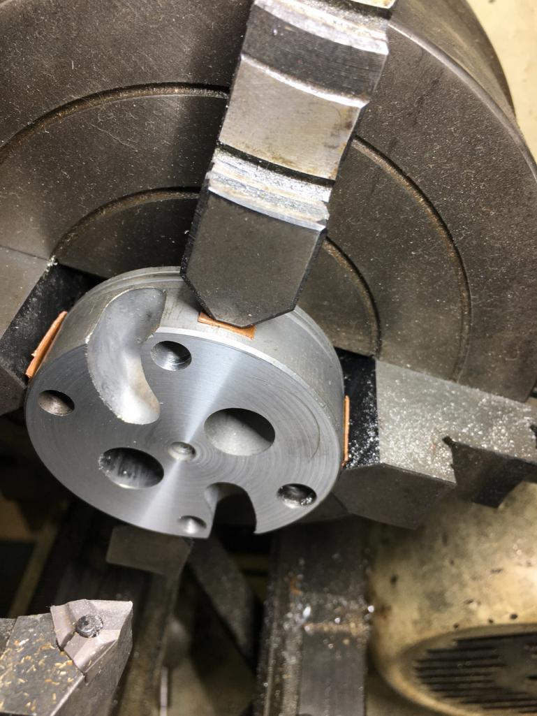

Setup in the lathe for a light skim cut.
The idea here was to just do a light skim cut of 0.001 - 0.002" to clean up the scoring.

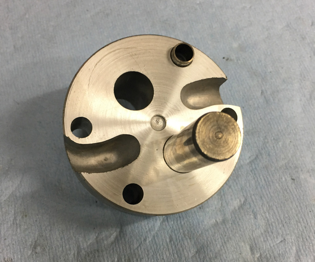

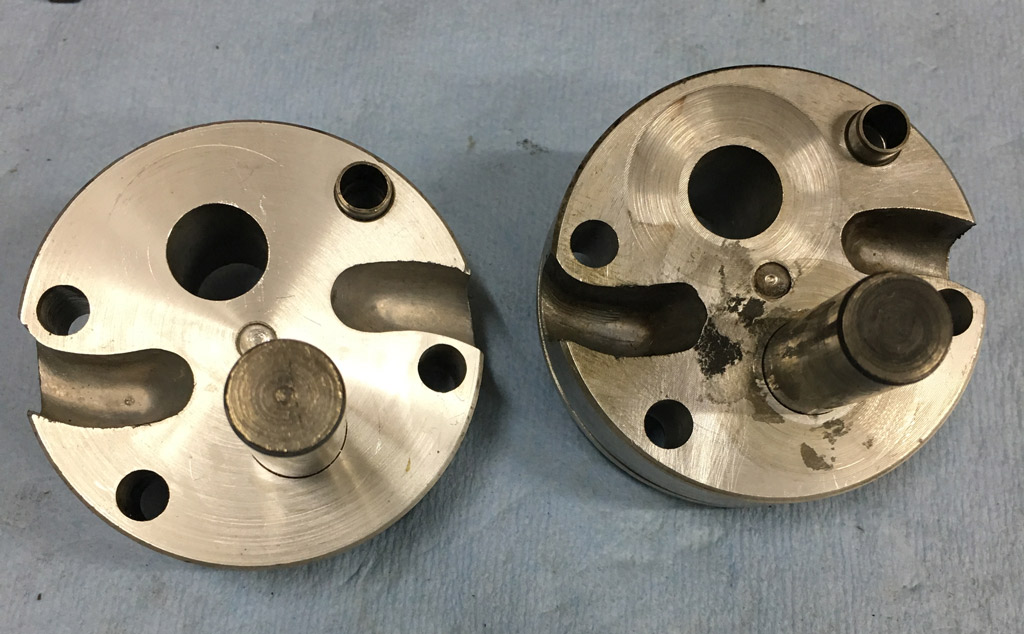

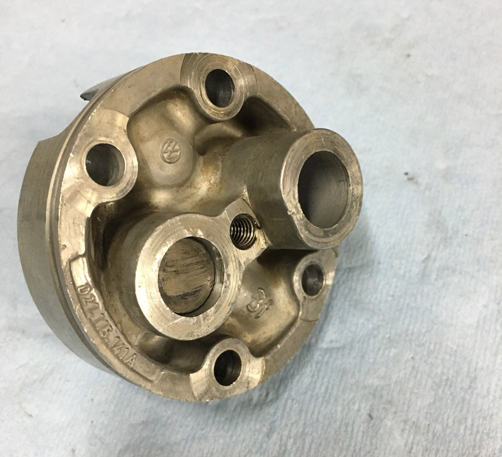

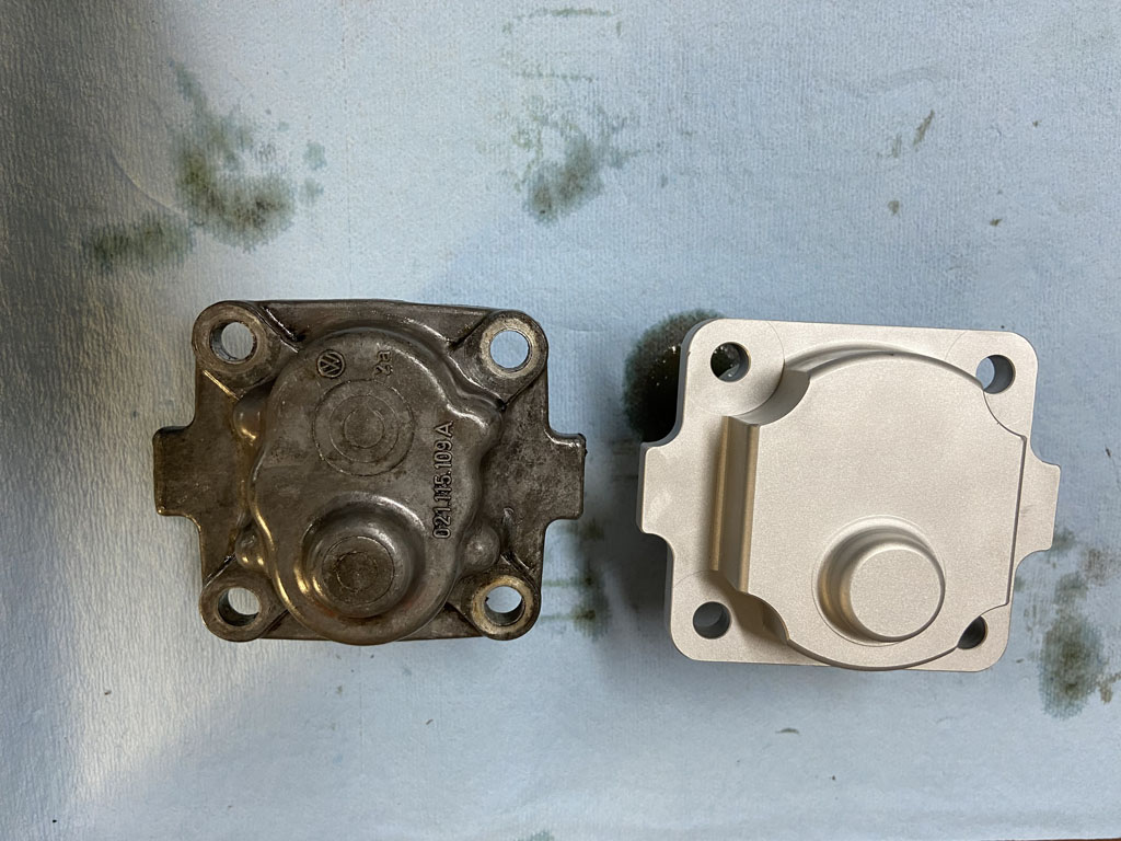

So here is the cover with just a skim cut and the shaft reassembled to suit the new Ebay housing.
The light score that is can barely be felt and will not cause any issues if I decide to use this part. Plus, it likely can be lapped out before I do any final assembly.
Here is the new depth of the stationary shaft. It is probably a good 3/16" deeper than where it started - gives an idea of just how far these shafts can be pushed out by hydraulic pressure if the engine is overheated.
Ultimately I will pin this shaft to the housing plate to prevent it from moving. We'll see if I can get to that tomorrow.
Here is a comparison of the machined plate vs. the Ebay flawed plate.

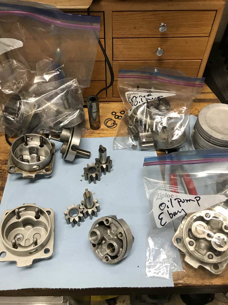

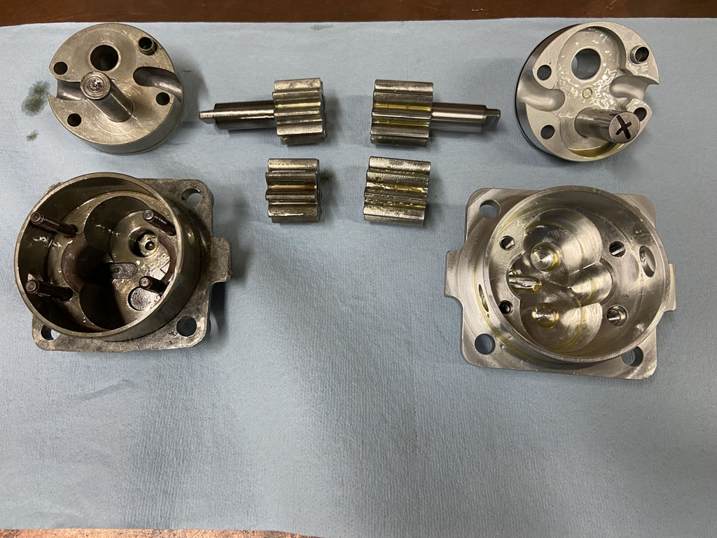

Given that I'm a mechanical masochist I haven't given up on the Type 4 Pumps.
In fact, I've begun collecting them.
Previous Roll call:
1) from my original engine - pump is garbage. Heavily scored from pumping rust.
2) E-bay purchase. Pitted gears and a housing plate that has a defect or corrosion.
3) Pump from GA000099 engine - In great shape and reusable.
But I still need a good pump for my original engine. I haven't given up on the machining of the housing plate and pinning the shaft. In fact, I will pin the shafts of both engines regardless.
But rather than get deep in the machine work at the moment, I purchased two more pumps here on the forum to see if I could find more good parts to mix and match a 2nd good pump.

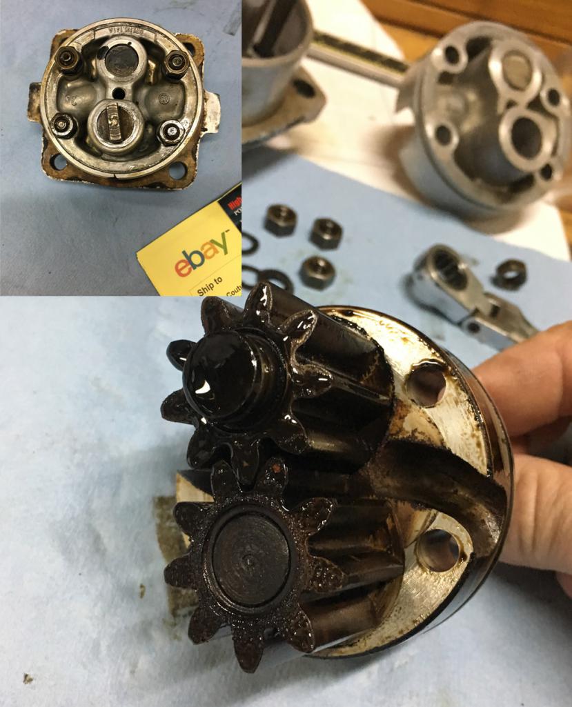

So I opened up the dirty pump first -- This is like Christmas for me. I love to see what is in the box for the 1st time.
And what a great Christmas it was. Another usable pump in great condition. (IMG:style_emoticons/default/piratenanner.gif)
Only the lightest of scoring on the gears and the housings. Perfect to reuse after I pin the shaft.

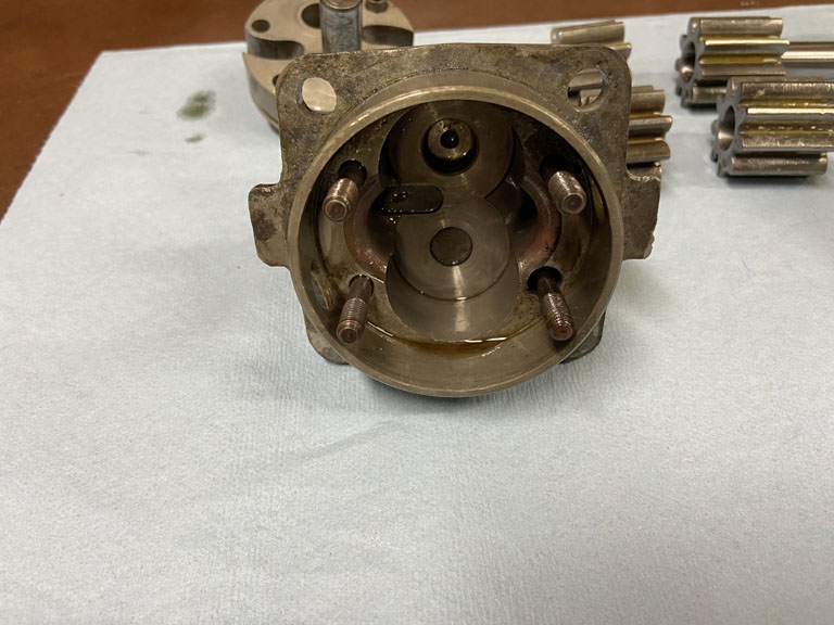

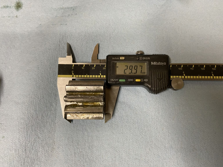

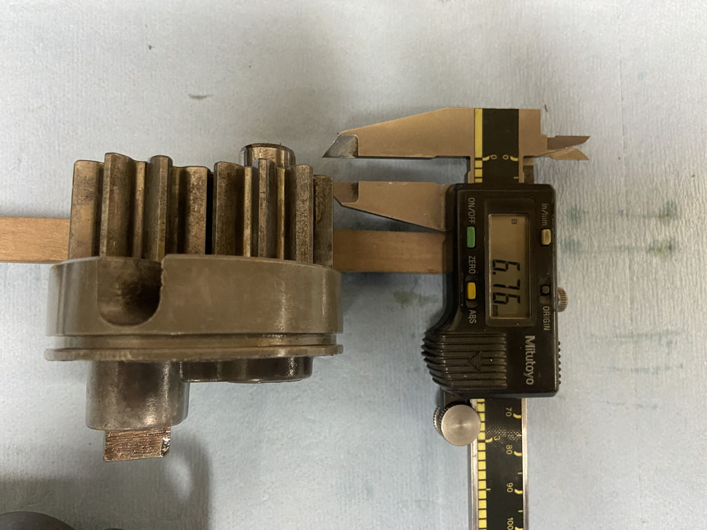

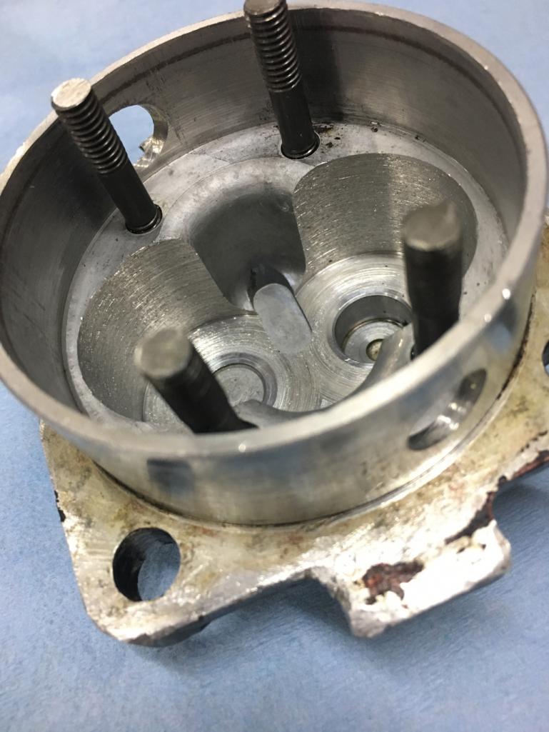

The second pump is a bit of a mystery.
On 1st inspection, it's clear that something isn't quite right. the stationary gear shaft is sitting far too deep in the housing plate. (IMG:style_emoticons/default/WTF.gif)
For the record - I have no issue with the seller on this. If you're not familiar with these pumps it would be easy to miss. Plus as always, you never quite know what you'll actually get and I didn't ask any questions since the price wasn't a concern. This was intended as a parts grab bag anyway on my part. (IMG:style_emoticons/default/biggrin.gif)
Opening up the pump was a mixed bag. The external housing is in awesome shape. and is immaculately clean. I think it was probably vapor blasted. it is that nice. (IMG:style_emoticons/default/smile.gif)
I will need to do a little measuring just to make sure the gap between the gears and pump bore is right but this part looks unused and amazing visually.
The internals are a mystery. I think the gears are 24mm Type 1 gears. They are in great shape & look brand new.
However, what is clear is that the shafts (both driven & stationary) aren't Type 4. They are definitely too short. I suspect Type 1 but really don't know enough about the Type 1 to be sure. (IMG:style_emoticons/default/confused24.gif)
However, this is sort of a blessing in disguise. I hadn't considered the possibility of being able to swap a new gear onto the driven shaft.
Now I have new toys to play with. (IMG:style_emoticons/default/happy11.gif)

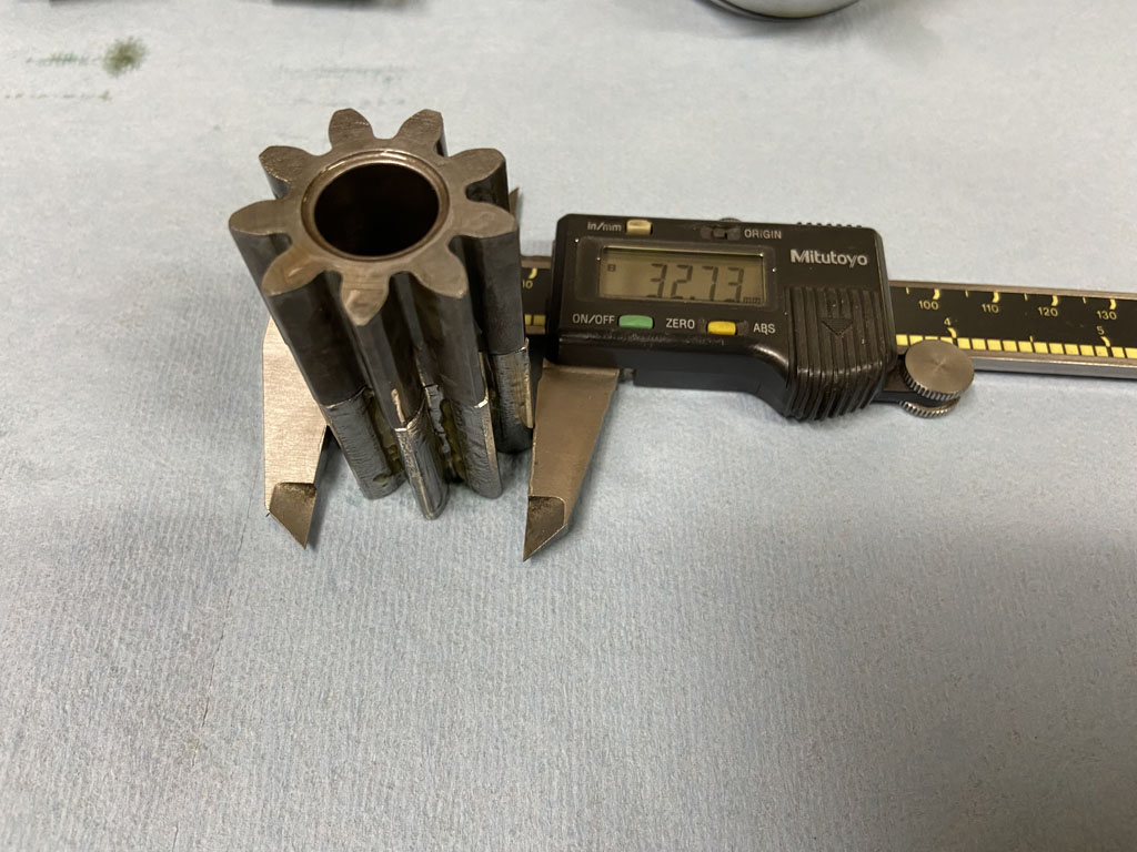

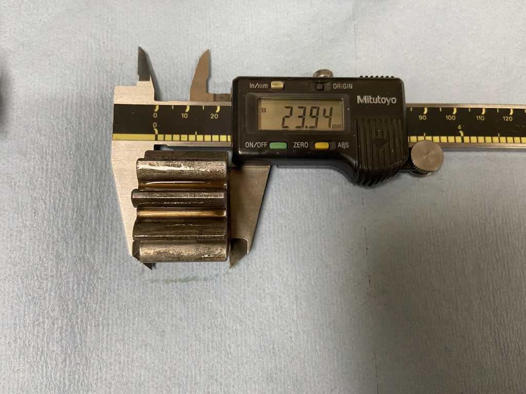

I suspect what I'll do is mix and match enough parts to produce another good 3rd pump using the immaculate housing, a machined housing plate, and probably some swapping around of gears.
The gears that I think are Type 1 seem to measure exactly the same as Type 4 gears for both OD and height. I need to do a better comparison of the tooth profile but it really wouldn't matter as long as they are kept as a pair.
New science project work ahead.
With 5 pumps on hand and two ready for use, this Oil pump rebuild project will likely get shelved for a bit other than a quick update later on when I finally pin the shafts of the two pumps I'm going to use for rebuild of GA000099 and my original engine.

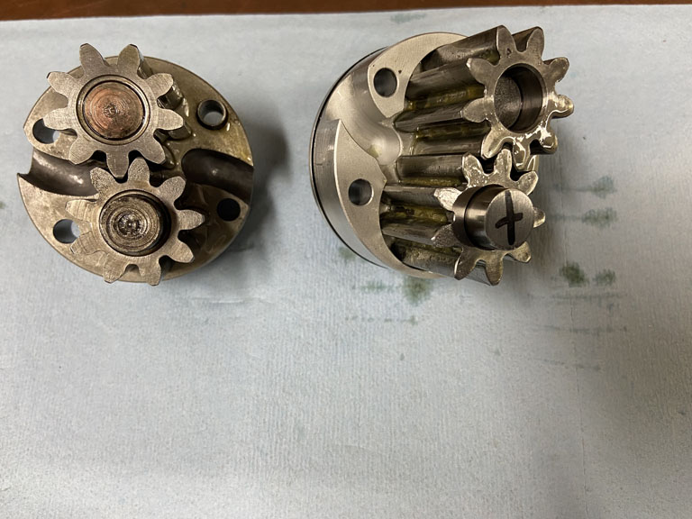

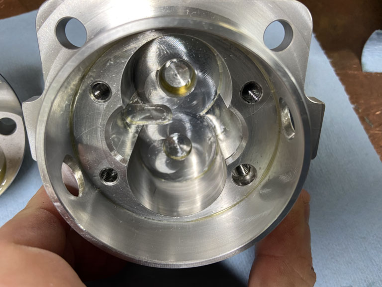

Time to light up an old thread. I continue to build my Type 4 oil pump collection with the firm belief that the Type 4 oil pump is the way to go for a Type 4 engine.
A while back I acquired one of the CNC Type 4 pumps that was offered on the Samba. I'm finally going to get around to posting a comparion to the OEM pump. In addition, I'll compare it (later on in a separate post to this thread) to a mystery type 4 pump that demonstrates why you want to open up a T4 pump before you use it blindly.
As mentioned previously my final intent is to build a fixture that will let me objectively evaluate T4 pump pressure vs. volume curves. This is still a long ways off since I'll need to machine a fixture as well as buy a flow meter which can get pricy.

The Samba pump is very nicely done. The main problem I ran into with it is that I thought it would be a duplicate of the OEM pump. It is almost perfectly close in all regards except one. The gear set is 30mm. Doh!
vs. OEM 24mm gearset.
Both gears are the same diameter.
This can be a pro or a con depending on intended use. It will be great for an external oil cooler setup. Otherwise, it will be pumping more oil and sapping more horsepower to drive than the OEM pump. It can be argued that the increased flow will provide better oil pressure when hot, but, there is also such a thing as too much oil pressure. I'll set that aside for now.
You'll notice the housing face plate for the Samba pump is different than the OEM pump in order to accomodate the 30mm gear set. The OEM face plate is flat. The Samba pump has been counterbored in order to fit the 30mm gear into the same space. All machine work on the Samba pump appears to top notch but I haven't done a deep dive on clearance between the pump gears and the pump housing. For the moment, I'm assuming that since it is CNC'd its good. It certainly looks good.
I also notice that the driven shaft is recessed deeper in the driven gear.
Looking at the amount of engagement that the idler shat has with the housing. It is about the same as OEM.
OEM is 6.76mm
Samba is 6.33mm
For me, the fact that the idler gear is in double shear is a big plus for the T4 pump.
Of course the major design flaw with the T4 oil pump is the fact that the idler shaft isn't pinned into the face plate. If the engine is overheated, the difference in thermal expansion between aluminum and steel can create the opportunity for the idler shaft to get pushed outward in the housing toward the cam gear. The easy fix is to pin the idler shaft. This should be done with any reused T4 pump and would also need to be done with the Samba pump.
Here is the comparison of the OEM housing to the Samba housing.
OEM
Samba
And finally, here is a comparion of the exterior of the pumps.
