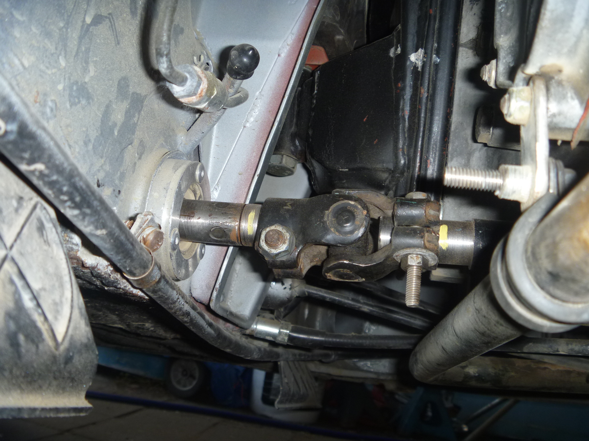

My linkage mod (IMG:style_emoticons/default/smile.gif)

I made my own bolt on double bush console as well, came out good, not a big deal but just for a boot solution I should have made the shaft about an inch longer at the U-joint.
The bolt on console is great for the bolt on crowd, but the next one for my sons 914 I'm just going to TIG weld heavy ears on like Brant has done.
