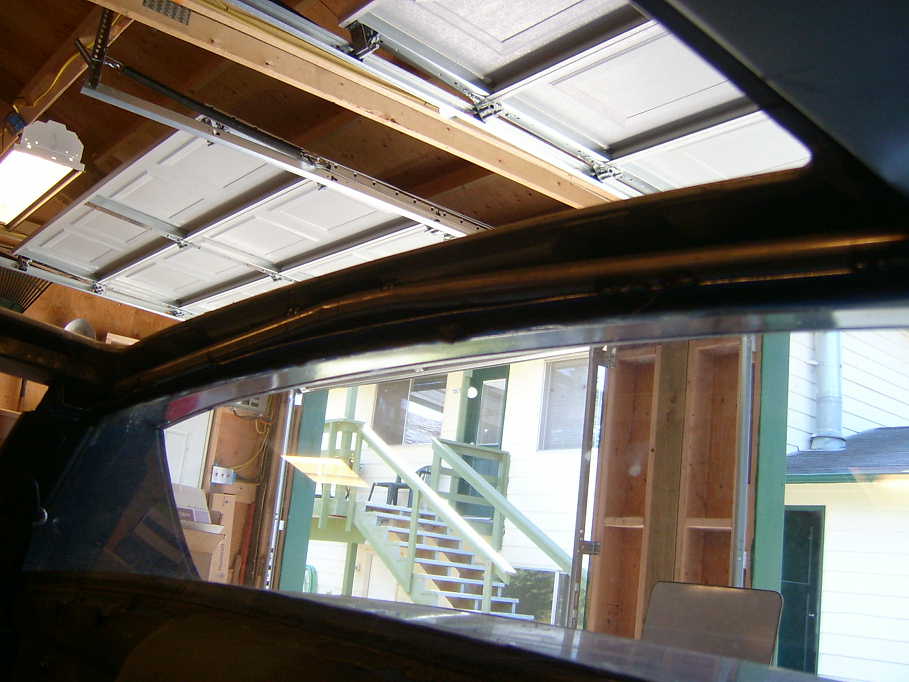

Still thinking to myself; "I can still turn back, just put it all back together" My ultra exact red lines indicate what I had to remove from the rear targa bar to have the sunroof fit correctly. (IMG:style_emoticons/default/sawzall-smiley.gif)

post Sep 18 2007, 08:22 PM
Post #34
Village Idiot
Posts: 8,652
Joined: 25-May 04
From: About 5NM from Canada
Member No.: 2,105
I can still just put everything back.....
Notice I cut off the back because I just wasn't happy with the ends or corners. I welded up metal, ground, welded, cut off, re welded, new metal, ugh, finally cut it all off and decided I just couldn't manufature that back finished piece. Having the back open for the attatchment made it perfect for welding the top to what was left of the roll bar and my added support bar.
I can still put everything back and just walk away.....
