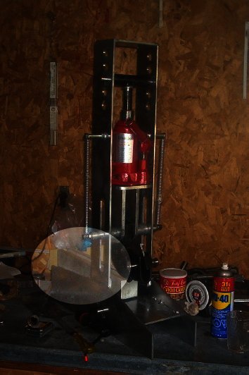

Do you mean this die?

Sorry, lousy image. Do you mean the big die or the little ones in the Speedway picture? Thanks for the help, btw.
