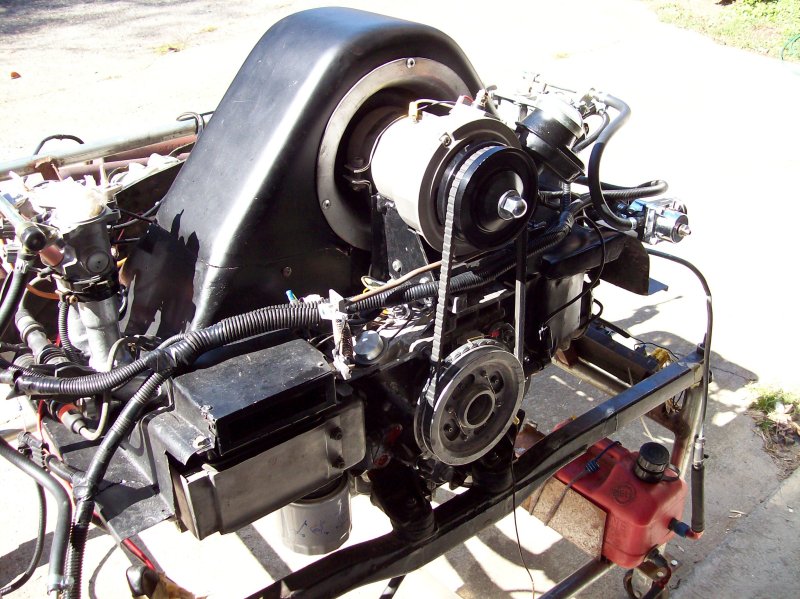

this is a jake raby dtm sample

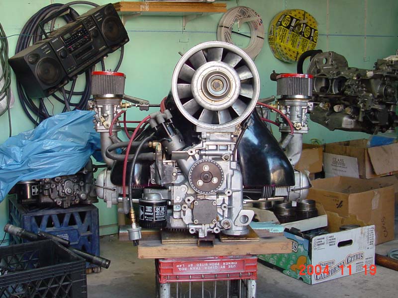

911 type cooling

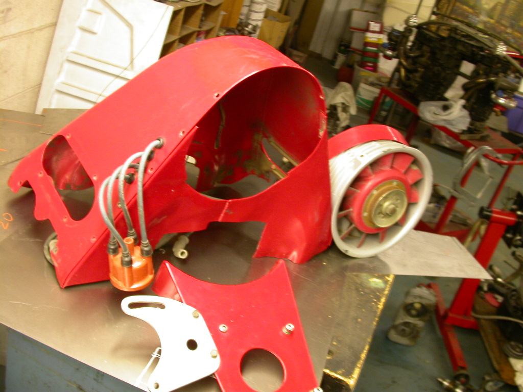

another 911 style fan, different
IMO they are a waste of time in a 914. strickly bling. great way to put a type 4 in a bug. big jump in power for a bug

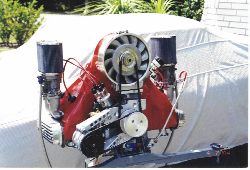

DO NOT go with the 911 style shroud , I made that mistake back 2004 , I've
had my share of issue's ( mainly unbalanced temps between cylinders ) , I didn't
do my reserach & I chose because of the LOOK's & the COOL factor , I didn't think much about the IMPORTANT part , the FUNCTION of it (IMG:style_emoticons/default/sad.gif) , If I was to do
it over I would go with the DTM v2 ( 914 version ) or possibly a horizontal
style ,again must do reserach . Ok confession over (IMG:style_emoticons/default/biggrin.gif)
Bill D.

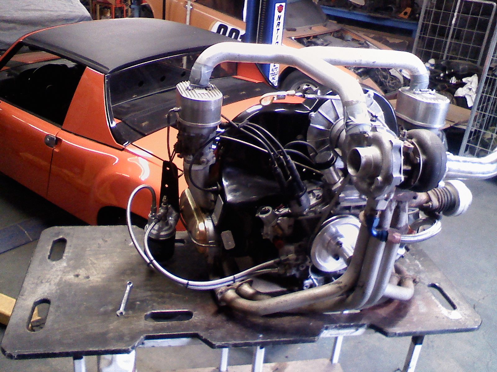

Another 911 shroud conversion...
