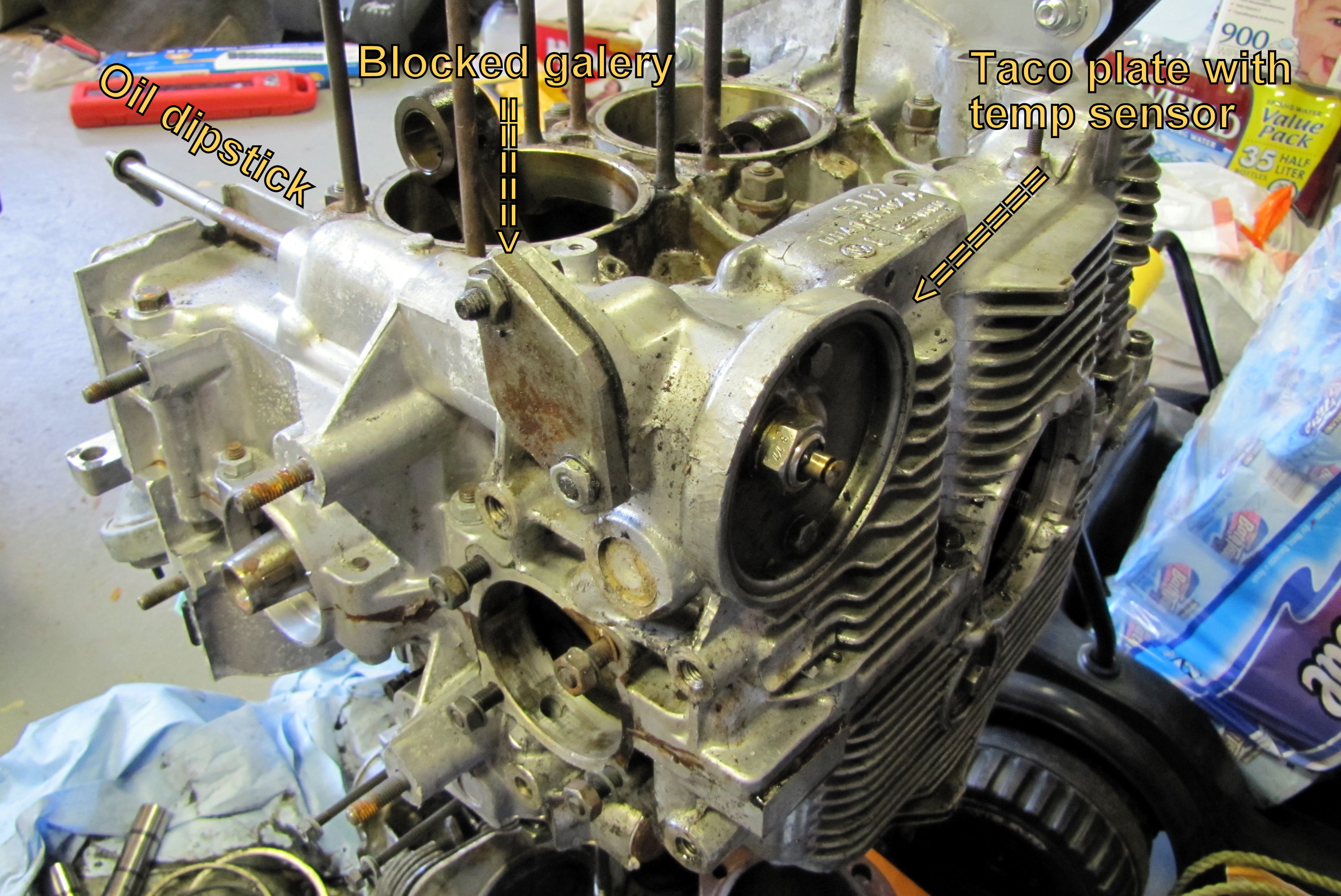

Oil pump doesn't want to come off. I took the 4 nuts off and the pump is still stacked in. (IMG:style_emoticons/default/headbang.gif)
Am I missing something? Is there anything else that holds it? (IMG:style_emoticons/default/confused24.gif)
Can I use the side tabs to pull it hard? I'm afraid to leverage on the case, not to brake it.

Yup, use the tabs and pry it off. I'm sure someone out there has damaged a case doing that, but use your head and pry carefully and you'll be fine.
You know you gots a bus case there? Not that it matters much, but that blocked off passage just above the taco plate is where the bus dipstick and oil filler tube go.

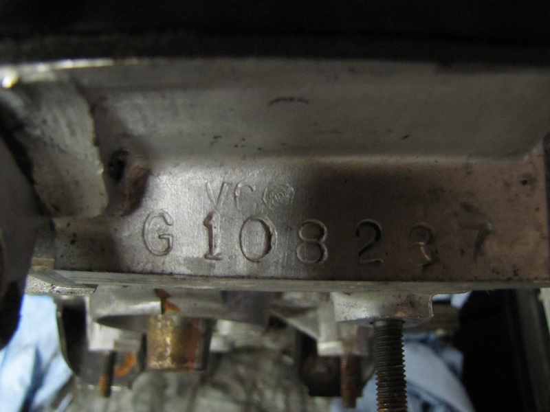

The case is a generic Type4 one. It has a strange SN on it and looks like it's a replacement case. Otherwise the case looks nice and clean without too much wear.
I don't see any problem with it being specked initially for a bus.
Here is a picture of the SN.

Speced for a bus is 100% fine. Mark is correct about the oil temp sensor location. The 914 unit will not fit. The modern 2 1/16 sender will fit, but you have to use the modern gauge.

I don't see any comments about temperature sensor location in any post other than yours. The type of case has NOTHING to do with oil temp sensor fitment, and the stock one will fit fine. Second time I've seen this misguided notion in the last few days ................

Just to make thing clear:
The engine is a 914 2.0L. It may have a replacement case but the heads, dipstick and temp sensors are in there expected location.
The diamond shaped plate blocks the access to where the carb fuel pump would go.
The oil temp sensor is on the taco plate.
The dipstick comes out near the breather.
If I could just take off that oil pump...

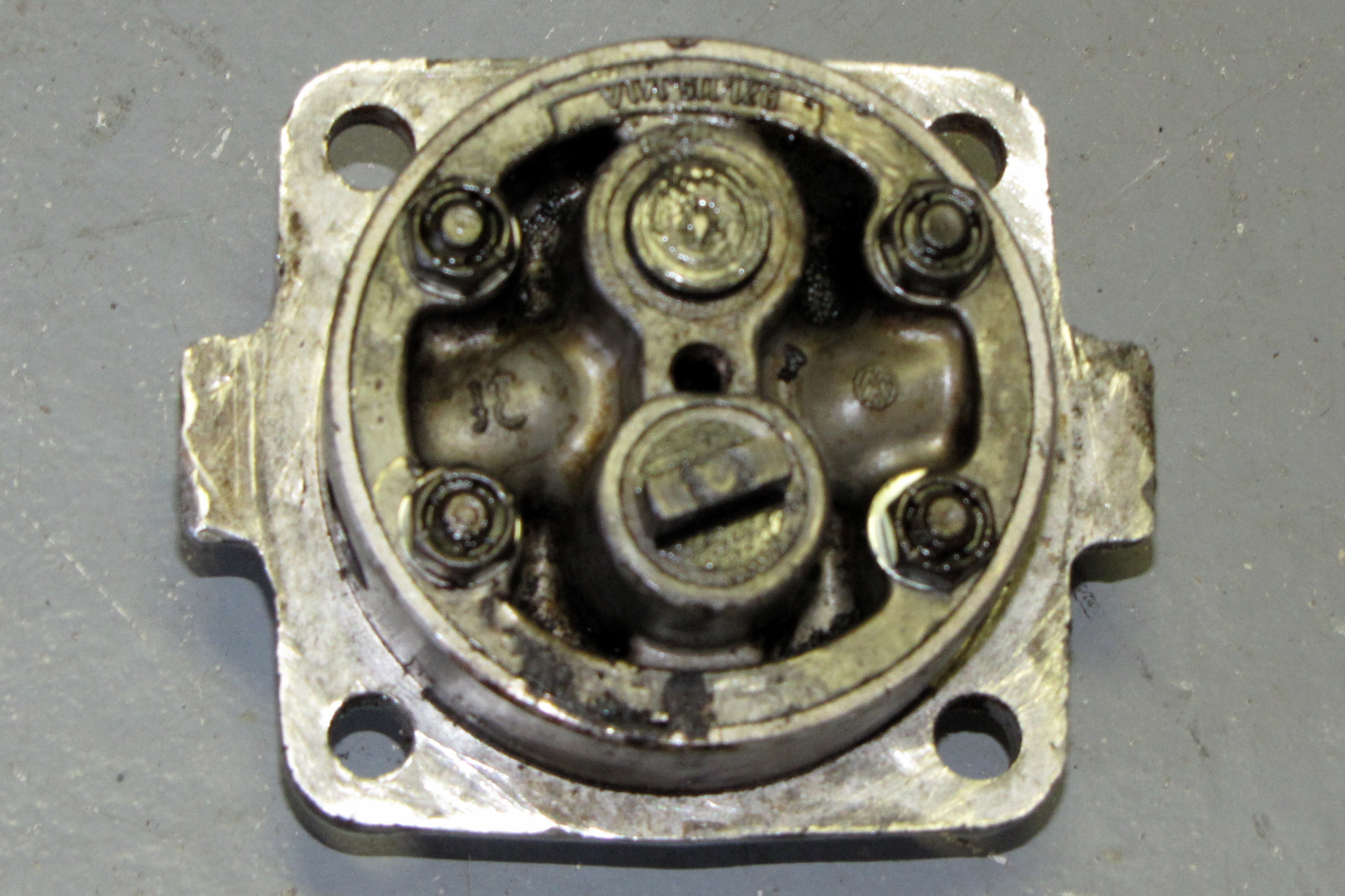

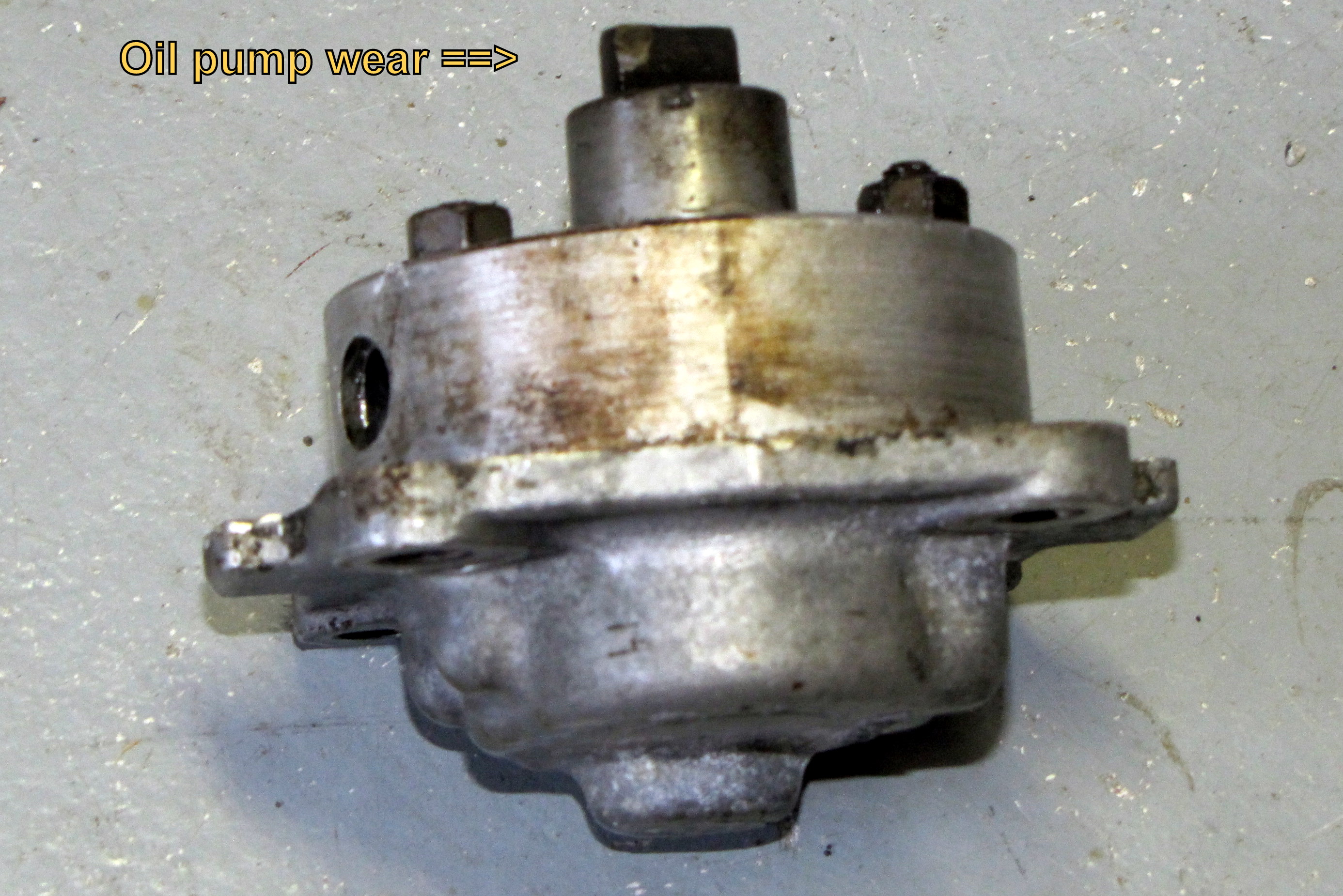

Oil pump is out (IMG:style_emoticons/default/piratenanner.gif)
It has some wear on the driving tooth. Normal width is 9.5mm and the worst wear is at 9.0mm on one side and 9.2mm on the other.
Do I need to split the oil pump? It seems the nuts have some sort of lock on them. Would I need new nuts? Are those available?

The lowermost pic of the oil pump shows a failing pump.. See that idler gear shaft?? Its become loosened in the body and is waiting to contact the camshaft. This is a common problem with stock pumps and the reason why I haven't used one in over 15 years. Once you lose an engine to that occurrence; you learn the lesson really quick.
