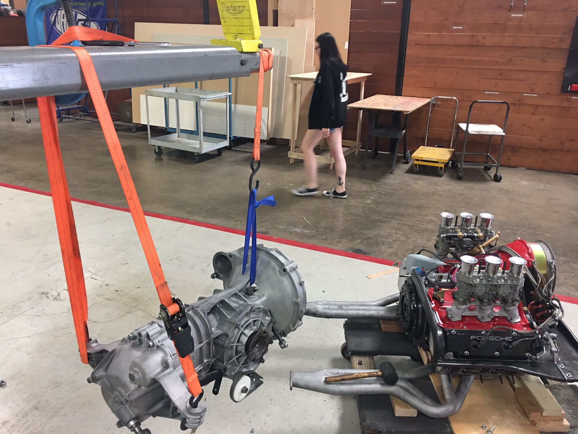

My pal C. Greene lent me an axle with two good cv's thereon.
I dropped the header on the (maybe) offending side, took off the shift rod (and while there milled a cool firewall bushing and installed it to fix other rod-slop) then R&I'ed the different axle into place.
We then test drove the 6 car and eliminated the CV's as the issue revealing the crunchy thing in Forrest's first.. gear to be just that.... a condition known as FGC.
So with a case af first gear crunch, first gear is toast. I like toast.
However, for this engine, (and me),....... I want a good setup for a 901 box with a 3.0-6 pushing it down the lane.
Question is: What does one expect to expend on a fairly reliable 901 mated to a 3.0 -6 ?
There is no simple answer to the question.
My Pal Steve says consider Boxster 6 tranny.
My pal Larmo says throw a match on the car while "tuning gas fed carbs with a leaky fuel line and call Geico..." Just kidding ....... (IMG:style_emoticons/default/av-943.gif)
but the options are few with the age of 901 technology.
I am down to plucking the tranny (AHHgin!) .....and pulling the 1st/ reverse stack off and fixing that issue (IMG:style_emoticons/default/WTF.gif) that is,>>> or buying a newly rebuilt box. And then Who Knows?
I just want to drive the beast along the way to a good reliable (HeHe) solution... (IMG:style_emoticons/default/beerchug.gif)
Any past experiences on 901 repair costs?

Replace the main cage bearing "while your're there" and re-hab the stack.
Have the bearings cryo'd. and rehab all the sycro's and gears.
$2500 plus or minus any other bad stuff....another slippery slope while your in there.

The good Dr. did, in fact, pick up my PM to him a little while ago and he was spot on in terms of one relatively inexpensive way to go about a fix. Pluck the 1st/reverse gear stack and replace everything that is suspect. Bolt it back together and drive (IMG:style_emoticons/default/driving-girl.gif) until another stress issue arises..... (IMG:style_emoticons/default/hissyfit.gif)
I've taken apart a tranny or two..but never reassembled one.... and like an idiot, i sold a five gallon bucket of gears and parts and pieces for just about nothing.... (IMG:style_emoticons/default/sheeplove.gif)
