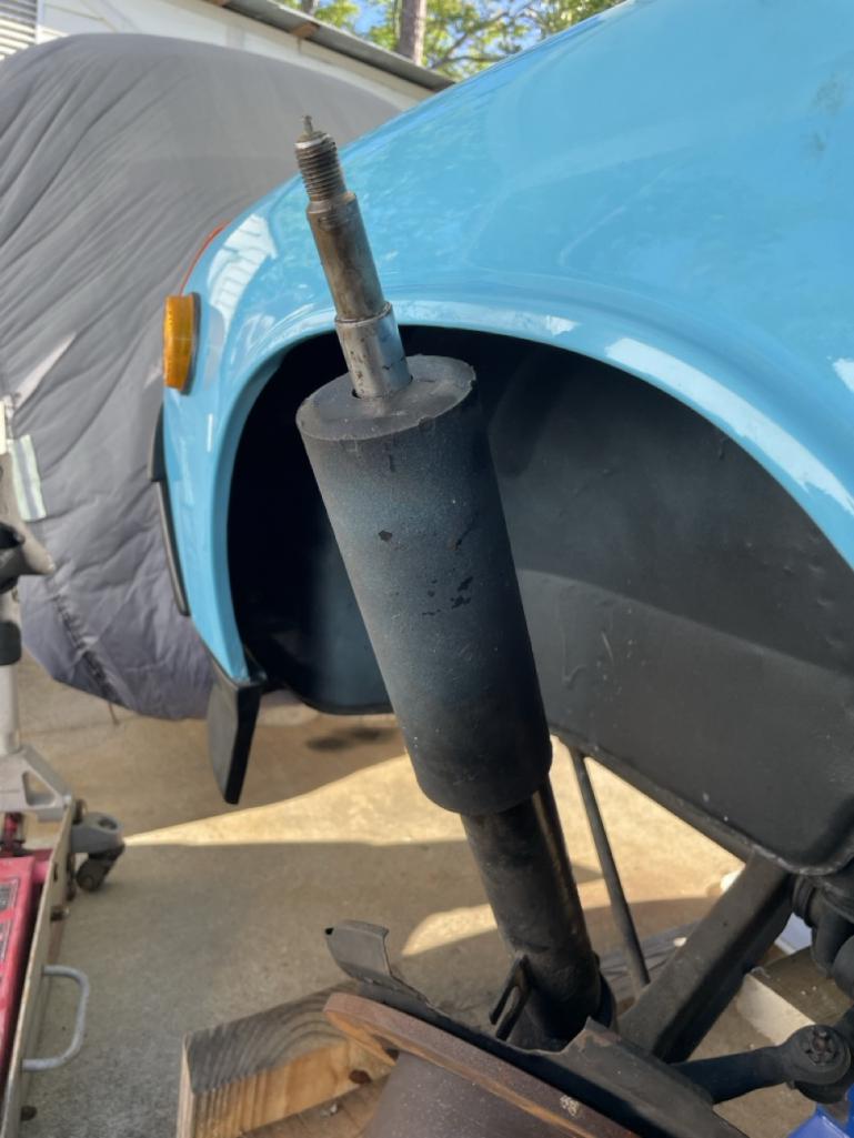

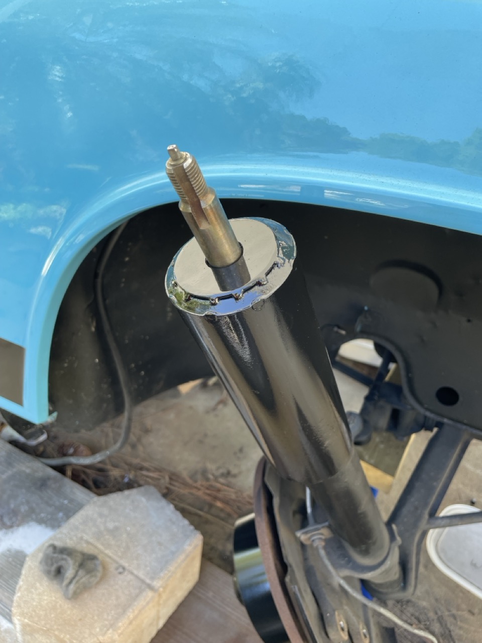

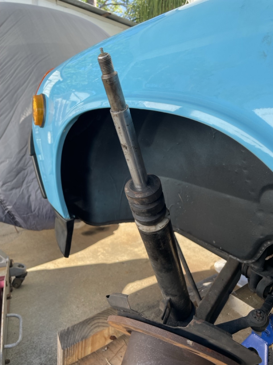

So I finally got a chance to get the front end up in the air to fix that bell ringing cap on the top of the strut. Not sure what I’m supposed to tighten down? The cap is just free floating on the top of the rubber bump stops inside of the strut.

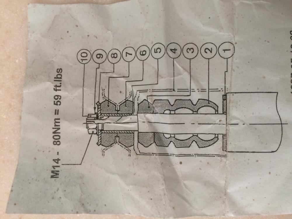

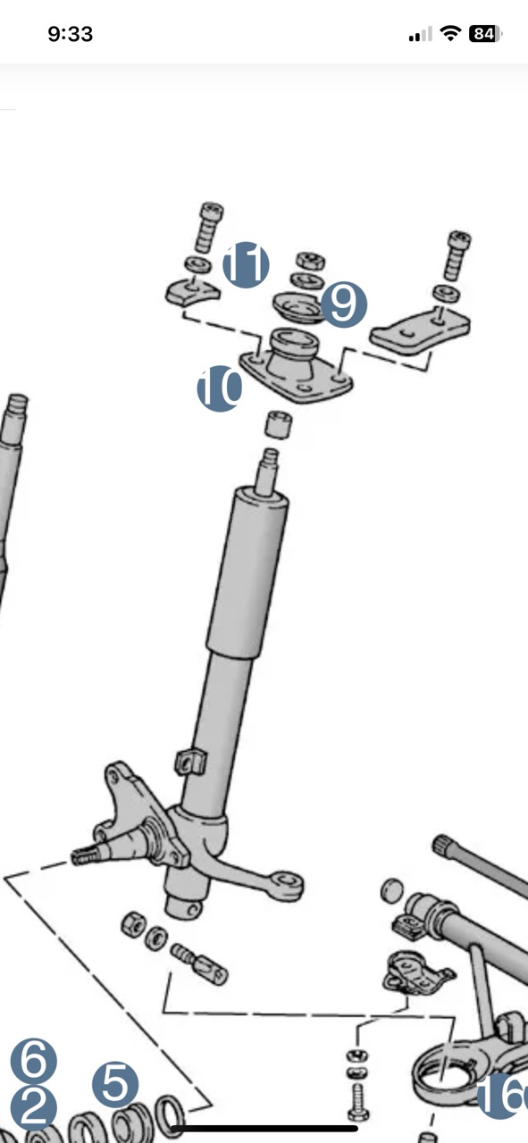

I don’t see anything on the diagram either that I’m missing with my struts….

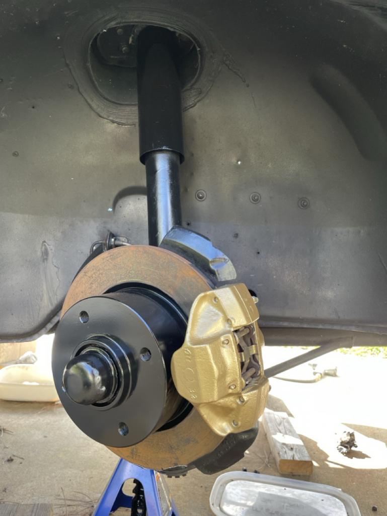

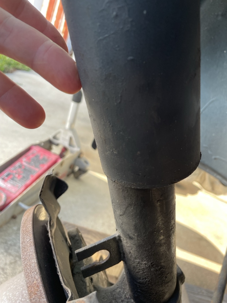

<EDITED>
The dust cover (that you have your finger on in the second pic) sits loose. Superhawk is correct and it's not resting on the shoulder of the strut as it should. (How did I miss that? I just redid my front end! (IMG:style_emoticons/default/headbang.gif) ) Make sure the gland nut that secures the strut within the strut housing is tight (arrowed below). Torque spec is pretty high but I can't recall what it is off hand (90 ft lbs?). If that's tight, then it's possible that the nut that goes on the top of the strut wasn't on tight enough. That should be 57.9 ft lbs. Tighten it with the car on the ground.

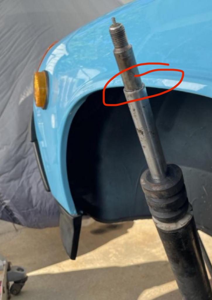

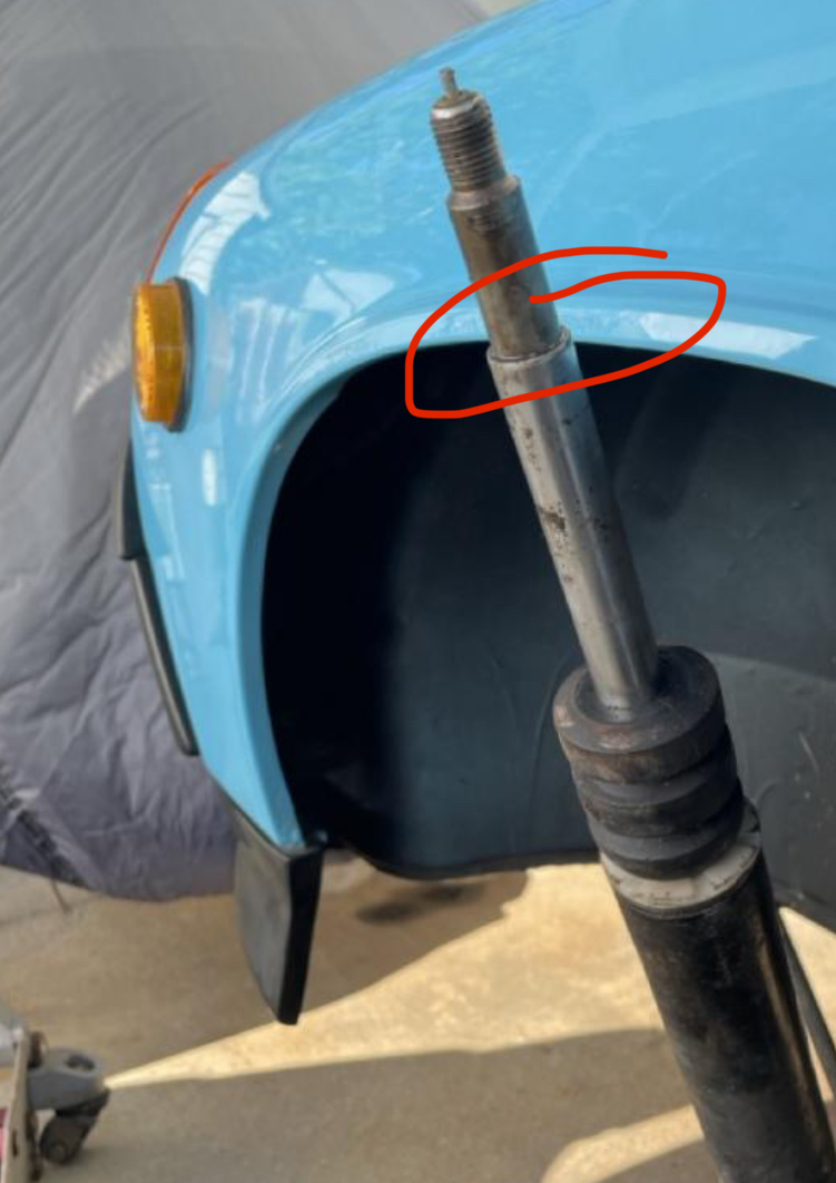

You’re not going to like the answer.

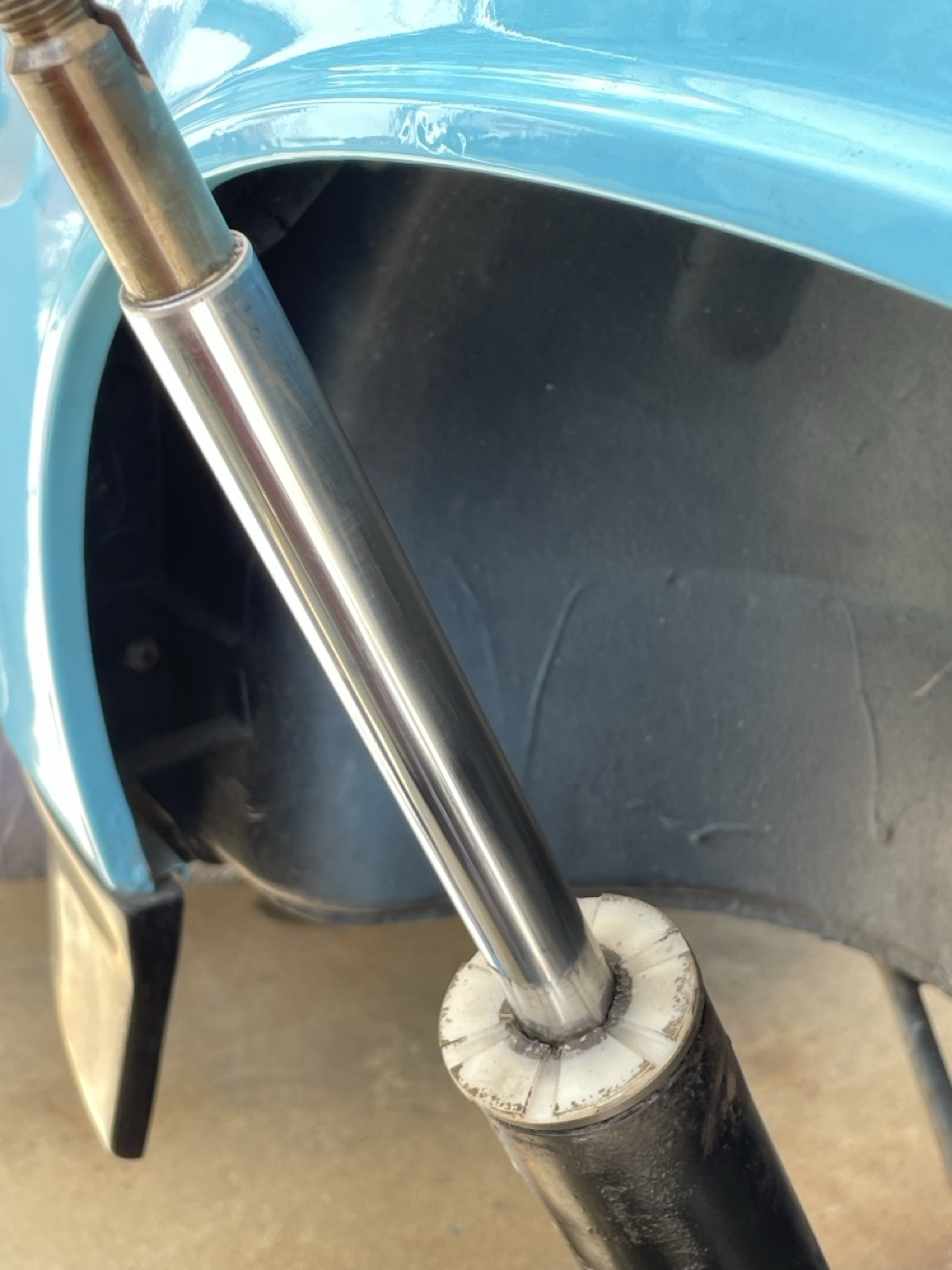

1) The strut rod cover is jacked. It should be resting on the shoulder on the strut rod (circled) and moving with the strut rod. Hole looks like it has been enlarged and is allowing the cover to slide up/down the strut rod. This is why you felt it loose and jangling even before you loosened the top nut and lowered the strut out.
2) the strut rod is jacked - there is rust on the rod. That along with the cover sliding on it will have worn out the strut seals - probably leaking internal to the strut. Sort of surprised I don’t see oil on the outside of the strut though (IMG:style_emoticons/default/idea.gif) Personally, I’d replace the struts just based on the rusted rod.
Time for new struts and find a new strut rod cover.Attached Image
sixnotfour

rust is up by bump stop , how low is you 914 ?

QUOTE(sixnotfour @ Mar 19 2025, 11:42 AM) *
Fair point.
Would really need to see better photo of the whole rod. Should have asked before jumping to the bad strut rod comment.
However, I think I see rust below where the bump stop would end and don’t forget the bump stop gets collapsed about 1/3 of its height during full compression. Depends on how deep the seals are in that strut (Old Koni adjustable?).
On the whole, you’re probably correct and that’s why there is no evidence of seal leaks external to the strut housing.

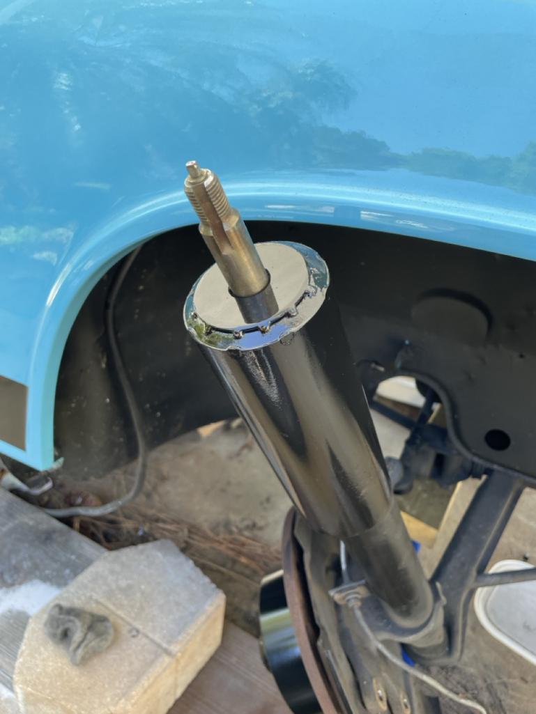

Now it makes sense! I see what you’re talking about now. I lifted up the rubber stops and the strut rod is perfect. It’s just at the top of the strut rod where there is some rusting. That’s the first thing I checked when I seen that rust at the top. I didn't see anything fluid either leaking out at the seal. I think what I’ll do is pull the caps and weld nice study washer into the cap that allows it to sit back on the top of the rod in its correct position. This should then allow it to bottom out at the top when the nut is properly torqued down. Thanks guys! I love this site! So helpful why rebuilding this 50 yr old project! And it’s still going to be a cost free repair (IMG:style_emoticons/default/beerchug.gif)

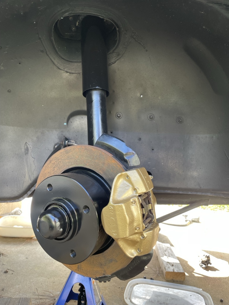

Ringing bells are silenced! Went ahead and freshened up the braking system while I had it all apart. That wasn’t rust that was on the strut rod, it was just goo from the rubber stopper on it. Every once in a while I have a good day…lol.
