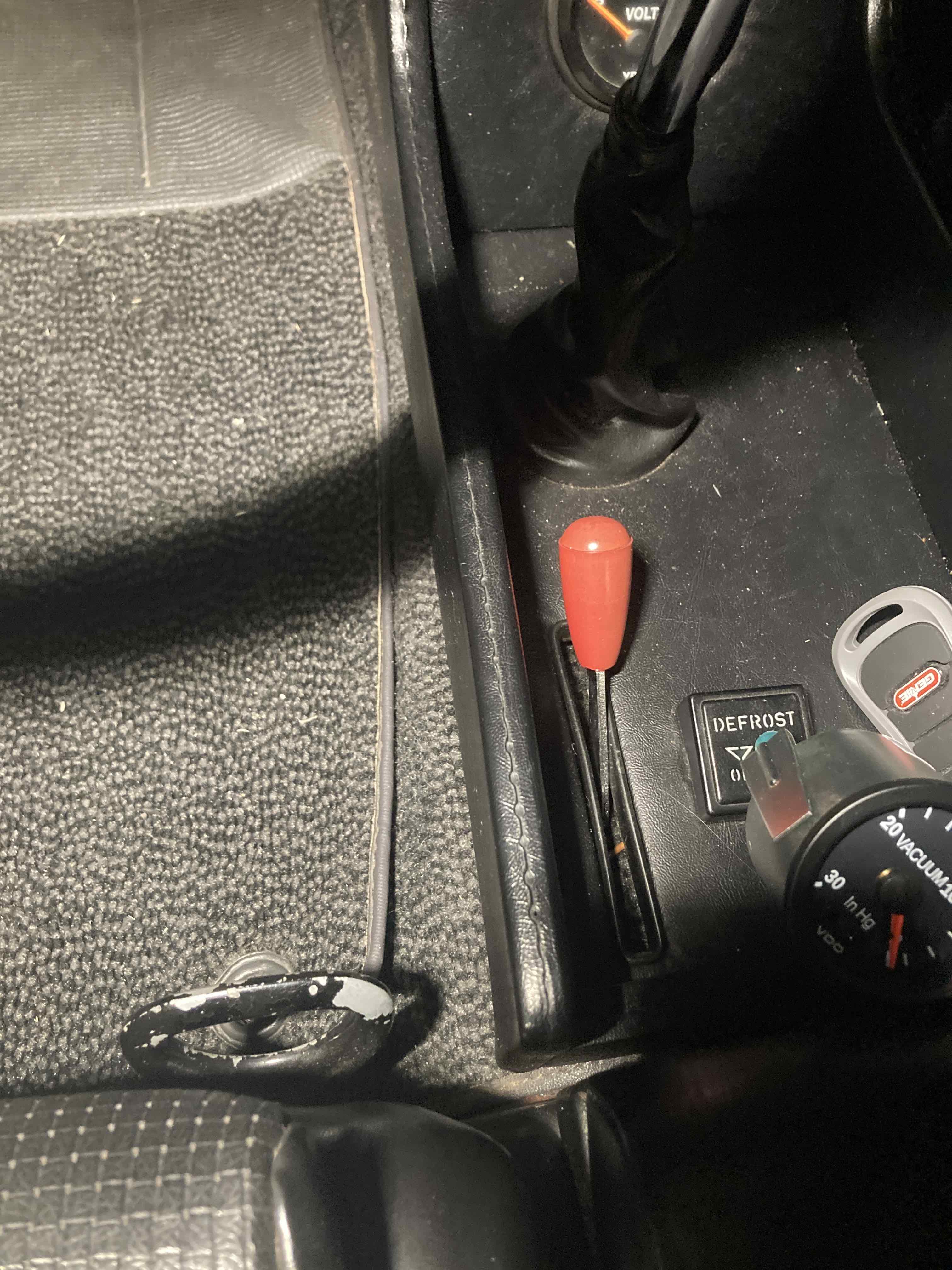

jim_hoyland
post May 16 2025, 08:58 PM
Get that VIN ?
Posts: 9,961
Joined: 1-May 03
From: Sunset Beach, CA
Member No.: 643
Where on the Heat-lever does the wire attach ?
914sgofast2
post May 16 2025, 09:19 PM
Posts: 782
Joined: 10-May 13
From: El Dorado Hills, CA
Member No.: 15,855
It attaches to a male spade type connection on the bottom of the lever’s switch mounting. The wire should have a female spade connector.
jim_hoyland
post May 17 2025, 08:39 AM
Get that VIN ?
Posts: 9,961
Joined: 1-May 03
Member No.: 643
Thanks; I’ll have to look deeper (IMG:style_emoticons/default/smile.gif)

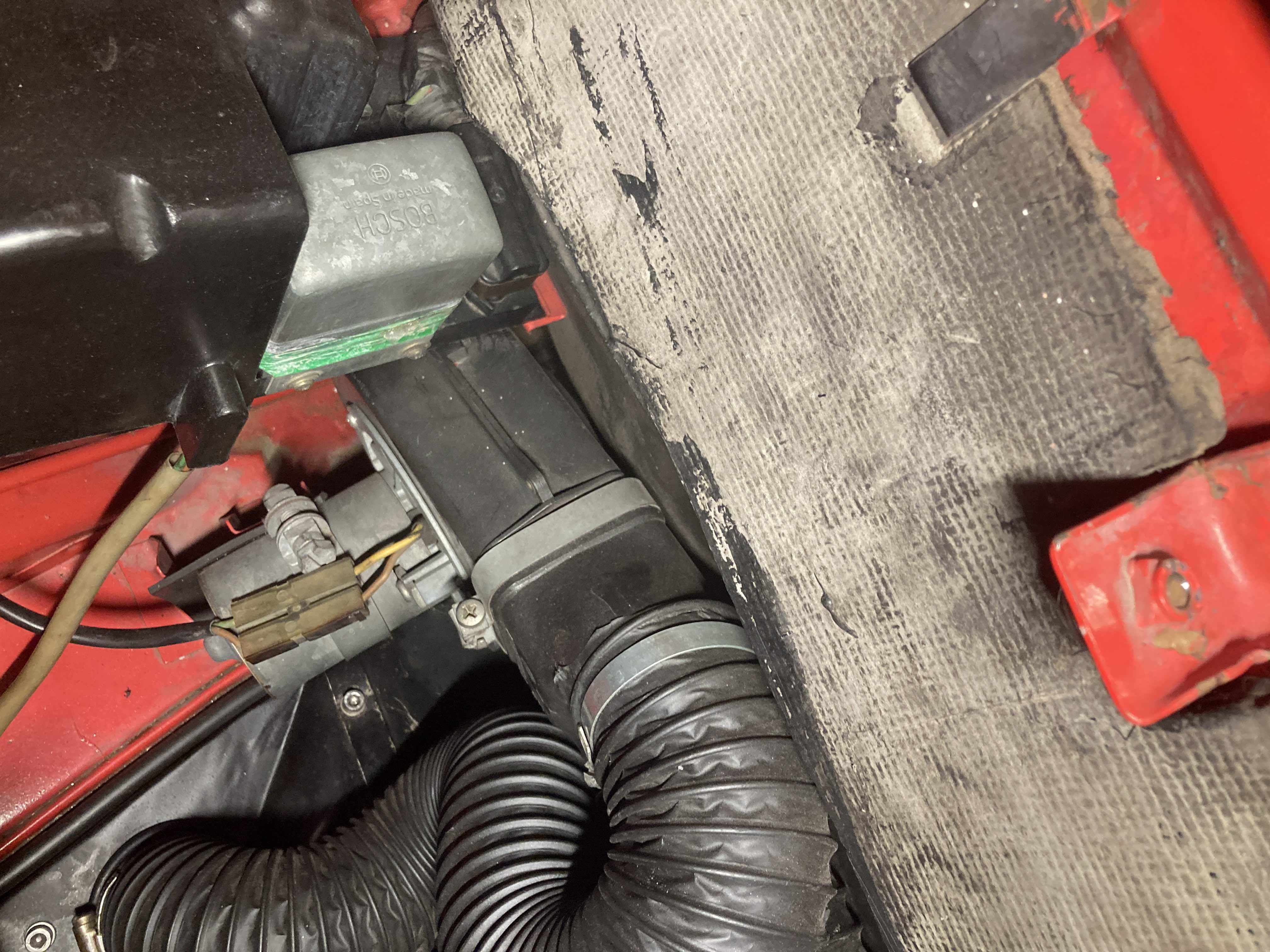

ThinAir
post May 19 2025, 12:36 PM
Best friends
Posts: 2,569
Joined: 4-February 03
From: Flagstaff, AZ
Member No.: 231
When I connected my fan to the connector in the engine bay, it started running regardless of the heater switch position. I ended running a separate wire with a switch that I can turn on when I want, but I've never been comfortable with this arrangement.
It seems that the wire must be grounded somewhere, but I'm wondering if it is just because of the way the heater lever is installed. Is it supposed to have any kind of insulation or a way to prevent the fan being grounded until the lever is all the way up?

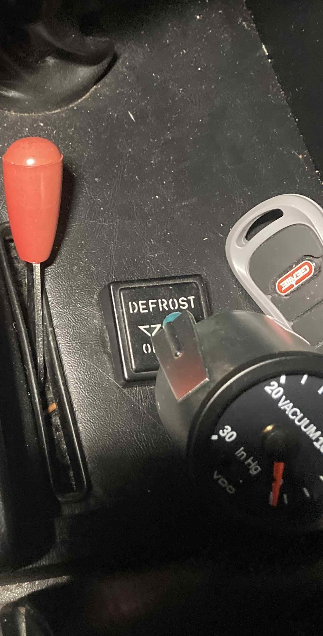

How / where is the little square Defrost light attached ?
jim_hoyland
post May 19 2025, 04:08 PM
Get that VIN ?
Posts: 9,961
Joined: 1-May 03
Member No.: 643
jim_hoyland
post May 19 2025, 04:12 PM
Get that VIN ?
Posts: 9,961
Joined: 1-May 03
Member No.: 643
BillC
post May 19 2025, 06:31 PM
Posts: 699
Joined: 24-April 15
From: Silver Spring, MD
Member No.: 18,667
QUOTE(jim_hoyland @ May 19 2025, 06:12 PM) *
The defrost light doesn't actually have anything to do with heating or defrosting. It is tied into the running lights, and is to help you find the lever in the dark. There should be a wire with a small (1/8"-ish) female electrical connector in the vicinity of the handle. On my car (a '73), the wire is black with a blue spiral.
jim_hoyland
post May 19 2025, 08:12 PM
Get that VIN ?
Posts: 9,961
Joined: 1-May 03
Member No.: 643
(IMG:style_emoticons/default/smile.gif) I see it, thanks…
