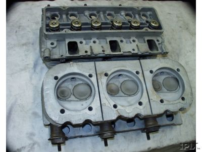

The heads are the major limiting factor in the design. They are not built in an intuitive way and rob much hp. The 140 head had bigger valves, but like its 2.0L TIV analog, would drop valve seats due to the limited amount of material between the seats in the head, and the inability of larger seats to shed heat as well as smaller seats. This can, and has been overcome by those who have been rebuilding these heads fro decades by making sure the crush tolerance on the seats are correct, and staking the seats in place.
Currently, you can get a set of rebuilt, 140hp larger valved heads, with new hardware and no core for about $1200 from Corvair Ranch in Gettysburg, PA. I bought a set that was rebuilt and had the plenums taken off for tri porting for $1500 shipped off of ebay from Starr Cooke in El Cajon, CA, another well known Corvair entity.

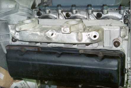

Here is a head with a stock plenum, modified with bungs for FI. This is a 140 head as it has two carb bases on it:
Standard engine:

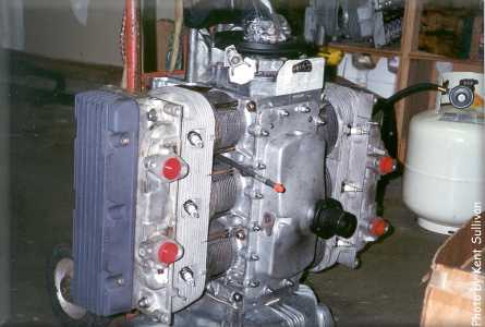

One of the cool things that many ACVW folks like is that the corvair engine has stock hydraulic lifters on it that use standard lifter, push rod, and rocker parts from Chevy. Easy and cheap to obtain.
Another great feature that I like over ACVW is the box design on the case. The top and bottom come off and allow for any maintenance. Swapping rods, bearings, what ever, is easy.
