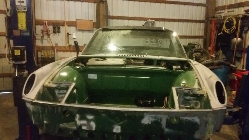

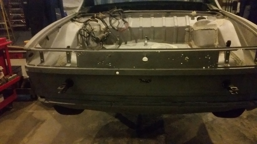

I've been asked by Mark to do some sheet metal/body work on his 75 2.0 Liter project car. The car arrived last Monday. But I needed to finish up a couple things on my project car and in my shop first. But I dove in this afternoon.

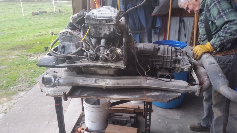

First task is to tidy things up after the paint stripping. Which included dropping the engine in order remove any residual media in the nooks and crannies. I was concerned with the rust prevention product that Dustless Blaster mixes with the glass media being left on and in the electrical connections. I'm a firm believer of an ounce of prevention is worth a pound of cure. I dribbled some OSPHO on a couple connectors in my white car. Not good. It ate the crap out the plating.
Here's Super In Law working on loosening up the media in order to blow it off. It will need to be steam cleaned.

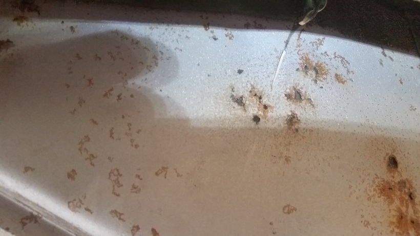

Hell hole is filled with caked in blast media. Stopping at Sears on the way home for a new filter for my vacuum. I'll look closely for prior repairs.
Both the lower longs look great at first glance

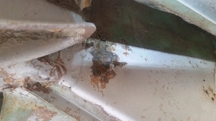

Needing more research :
A few rust pits on the upper right outer wheelhouse long
But we also a have fairly good sized rust spot a little further up the upper long. Right next to the suspension console.
These are both in the double walled section of the upper long.

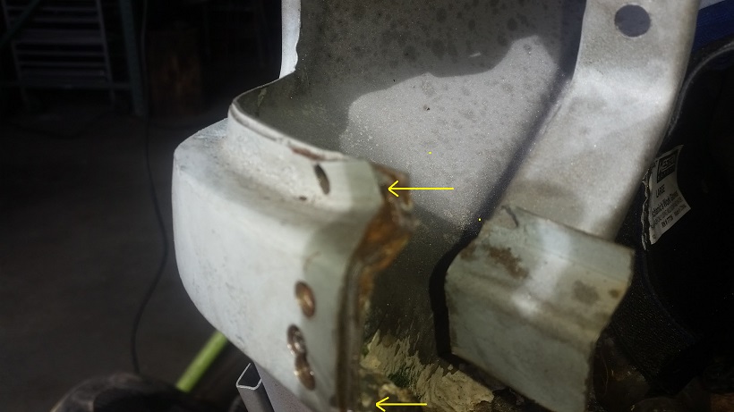

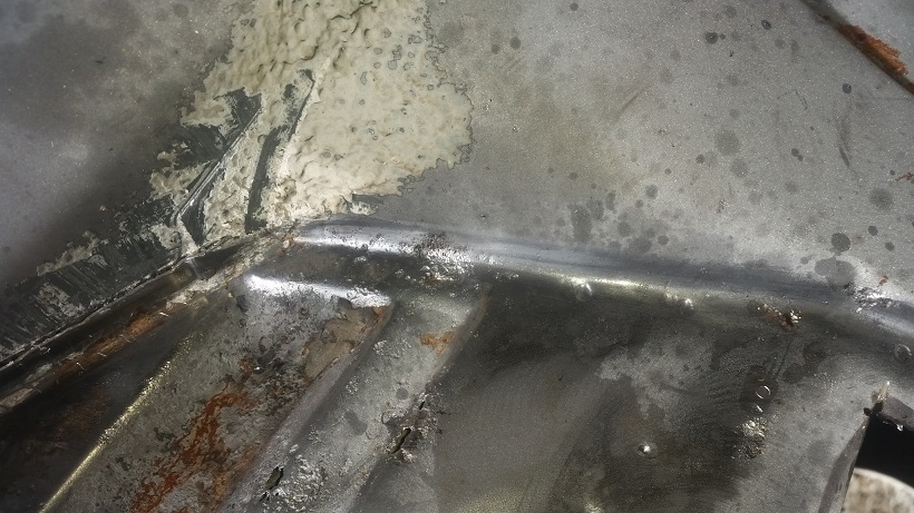

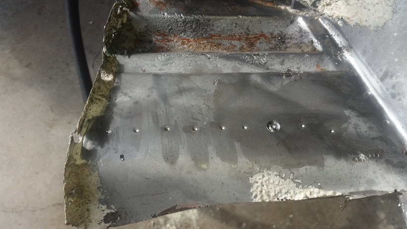

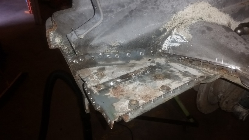

Snuck in a hour before Mark showed up on Saturday. I continued with the trunk floor dissection. Went after that piece sandwiched in between the qtr. panel corner. Started on the left side. After carefully prying around with screwdrivers and chisels I found the mystery spot weld. It was actually on the rear panel itself. Which was spot welded to the inner piece. Top yellow arrow calls it out. Sorry for the blurry picture. It couldn't be seen from the outside. The back side is pretty tough duty. It's plastered with spray on seam sealer. I'll do some more cleaning back there to prep for new spray on seam sealer after epoxy is sprayed on. I'll add a shot of the back if I find anything useful.
I drilled thru the outside and the remaining rear panel piece to get it disconnected.
The bottom arrow was a smidgen of one of the other spot welds left on the lip.
Here's a couple shots of the other spot weld locations that needed to be drilled out.

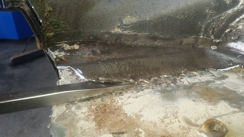

The next trouble area was caused by the rust degradation in the valleys pressed into the floor pan. By drilling out the higher area first, I could lift it up it so it would show me the area that was still attached. Once I got the area thinned down I popped it off with the chisel.
Just got it finished up when Mark and Mike (Warpig) showed up.
