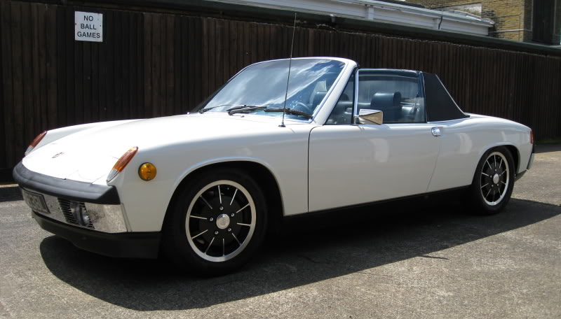

As a reminder this is how the car looked. It's a good car, not perfect but a very clean, solid example that had paint about fifteen years ago, it had also been converted to carbs many years back. There was a couple of small bubbles here and there but so far after further investigation I'm yet to find anything major.

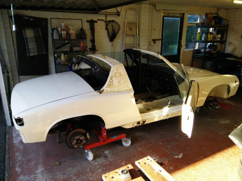

Starting the strip down.

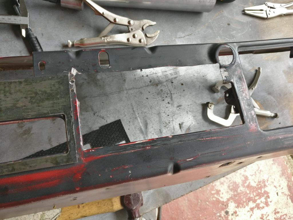

Time for a little update after taking a bit of a break from the car.

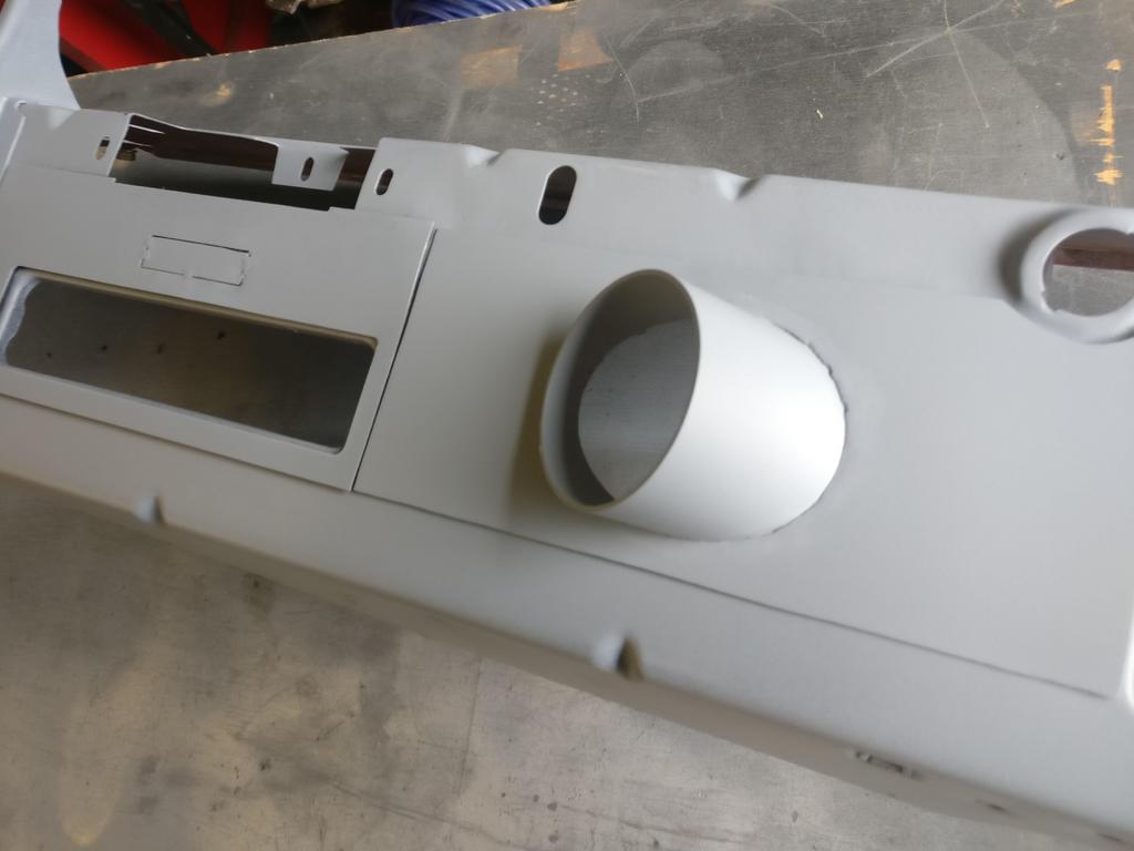

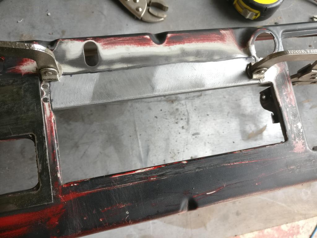

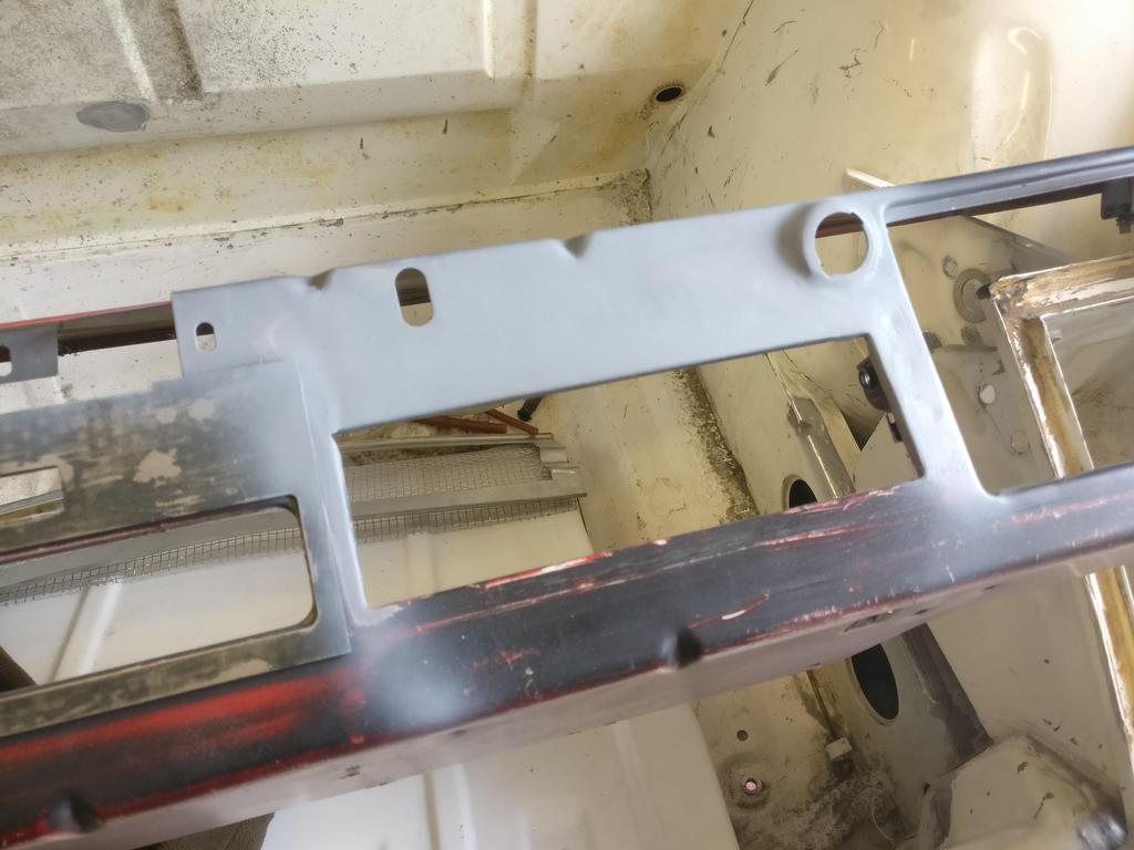

As seen earlier I made a GT style fuel gauge, no it was time to create the pod for it to sit in.
A previous owner had installed something other than the standard size in the radio aperture, step one was to fit that. Tough welding as the metal is so thin!
(IMG:http://www.914world.com/bbs2/uploads_offsite/s6.postimg.org-6621-1503731039.1.jpg)
(IMG:http://www.914world.com/bbs2/uploads_offsite/s6.postimg.org-6621-1503731041.2.jpg)

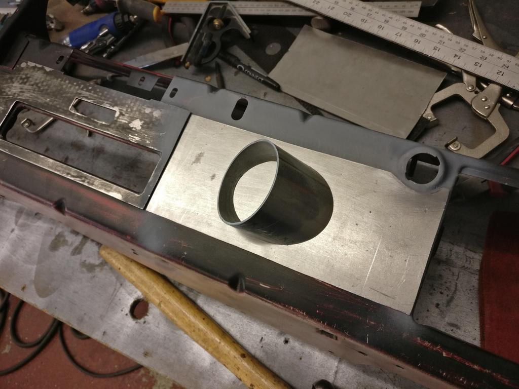

Although it'll be covered by the fuel gauge, if I want to install a radio I'll have the option.
(IMG:http://www.914world.com/bbs2/uploads_offsite/s6.postimg.org-6621-1503731041.3.jpg)
A piece of 61mm ID tube and sheet metal cut to size is all that's needed.
(IMG:http://www.914world.com/bbs2/uploads_offsite/s6.postimg.org-6621-1503731042.4.jpg)
In primer...
(IMG:http://www.914world.com/bbs2/uploads_offsite/s6.postimg.org-6621-1503731042.5.jpg)

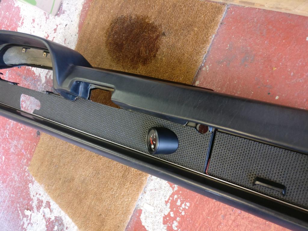

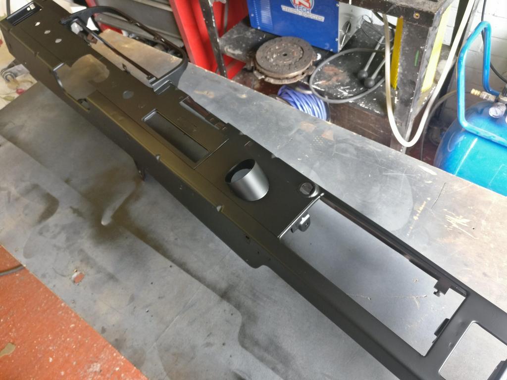

No more Bahia Red!
(IMG:http://www.914world.com/bbs2/uploads_offsite/s6.postimg.org-6621-1503731042.6.jpg)
Many thanks to Garry at Classic FX for the basketweave.
(IMG:http://www.914world.com/bbs2/uploads_offsite/s6.postimg.org-6621-1503731043.7.jpg)
All safely stored away in the loft until installation time now.
