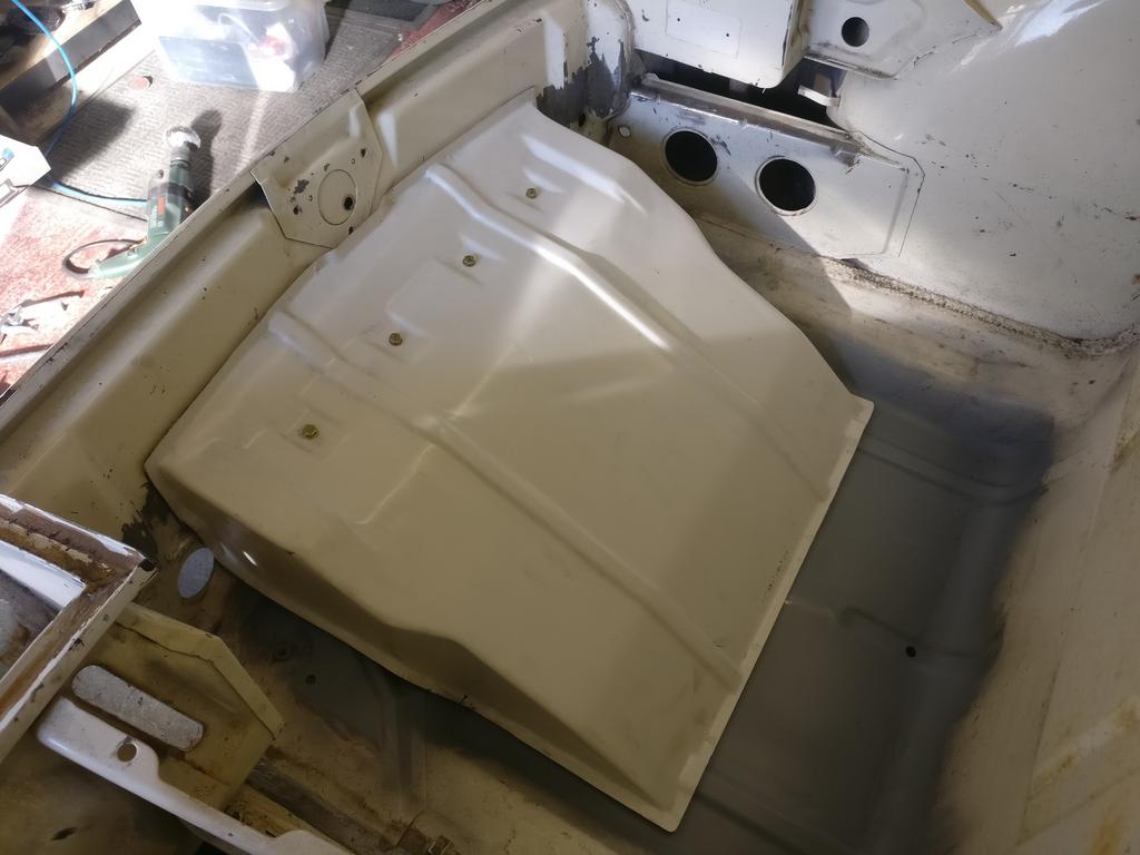

Starting the strip down.
(IMG:http://www.914world.com/bbs2/uploads_offsite/i176.photobucket.com-6621-1495877382.2.jpg)

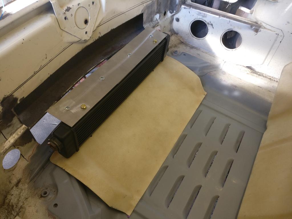

Getting close to finishing off the front oil cooler install. I wanted to use the original mounting holes on the oil cooler shroud so I made this adaptor plate.
(IMG:http://www.914world.com/bbs2/uploads_offsite/s6.postimg.org-6621-1506873927.1.jpg)
(IMG:http://www.914world.com/bbs2/uploads_offsite/s6.postimg.org-6621-1506873928.2.jpg)

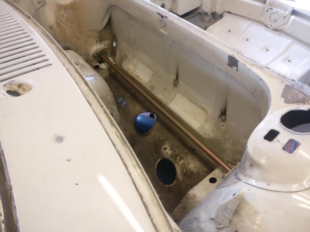

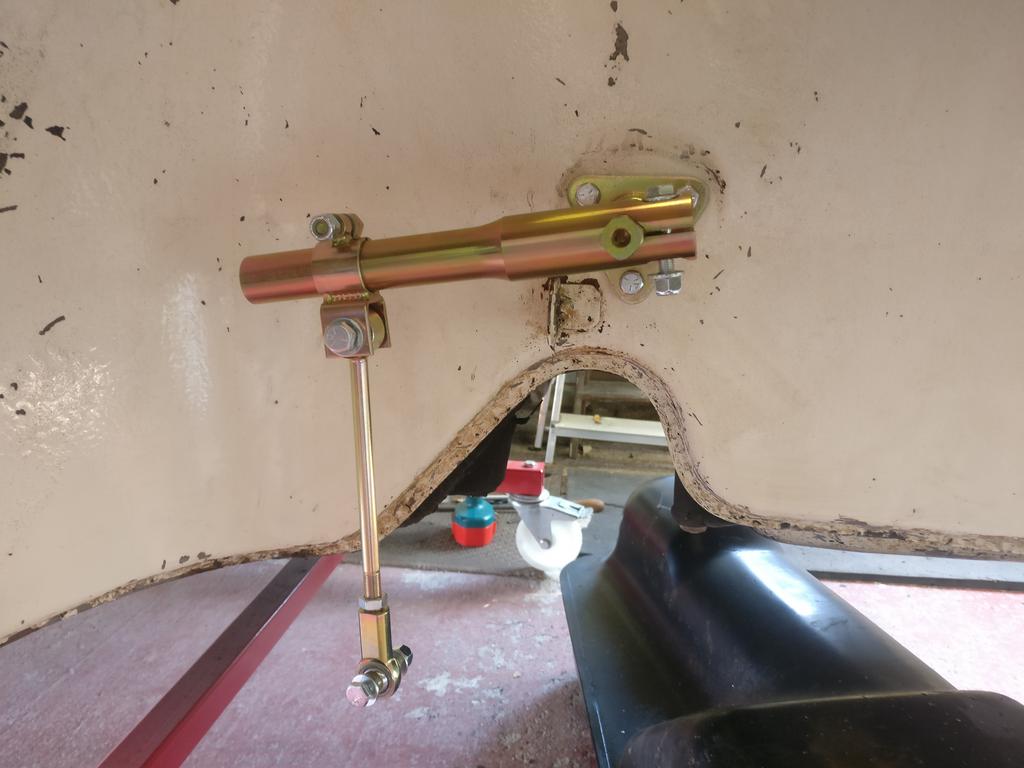

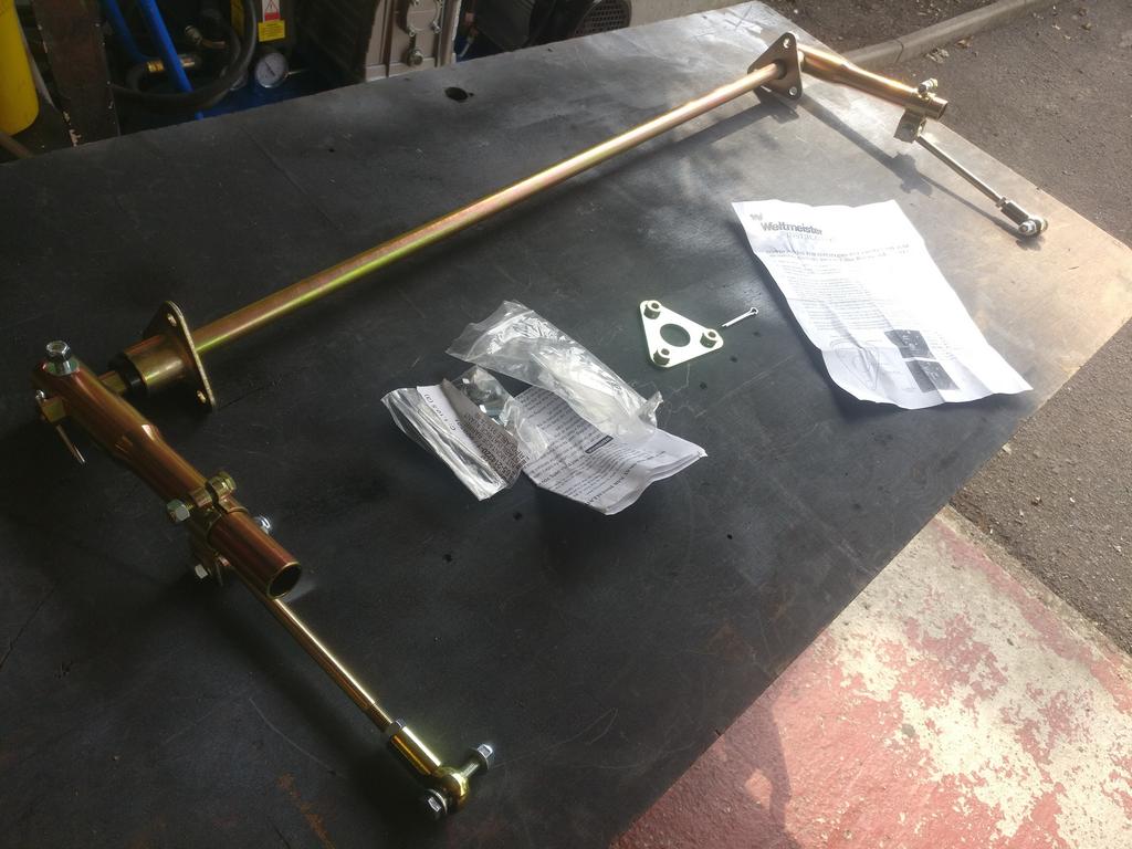

Being a very early US 73 2.0L my car sadly didn't have sway bars that became standard. Having driven 914's with and without there was no way I wouldn't be installing one. I initially found a original one but then changed that with this Weltmeister as I wanted to extra performance that offered. Installation was fairly simple.
(IMG:http://www.914world.com/bbs2/uploads_offsite/s6.postimg.org-6621-1506873928.3.jpg)
(IMG:http://www.914world.com/bbs2/uploads_offsite/s6.postimg.org-6621-1506873928.4.jpg)
(IMG:http://www.914world.com/bbs2/uploads_offsite/s6.postimg.org-6621-1506873929.5.jpg)
