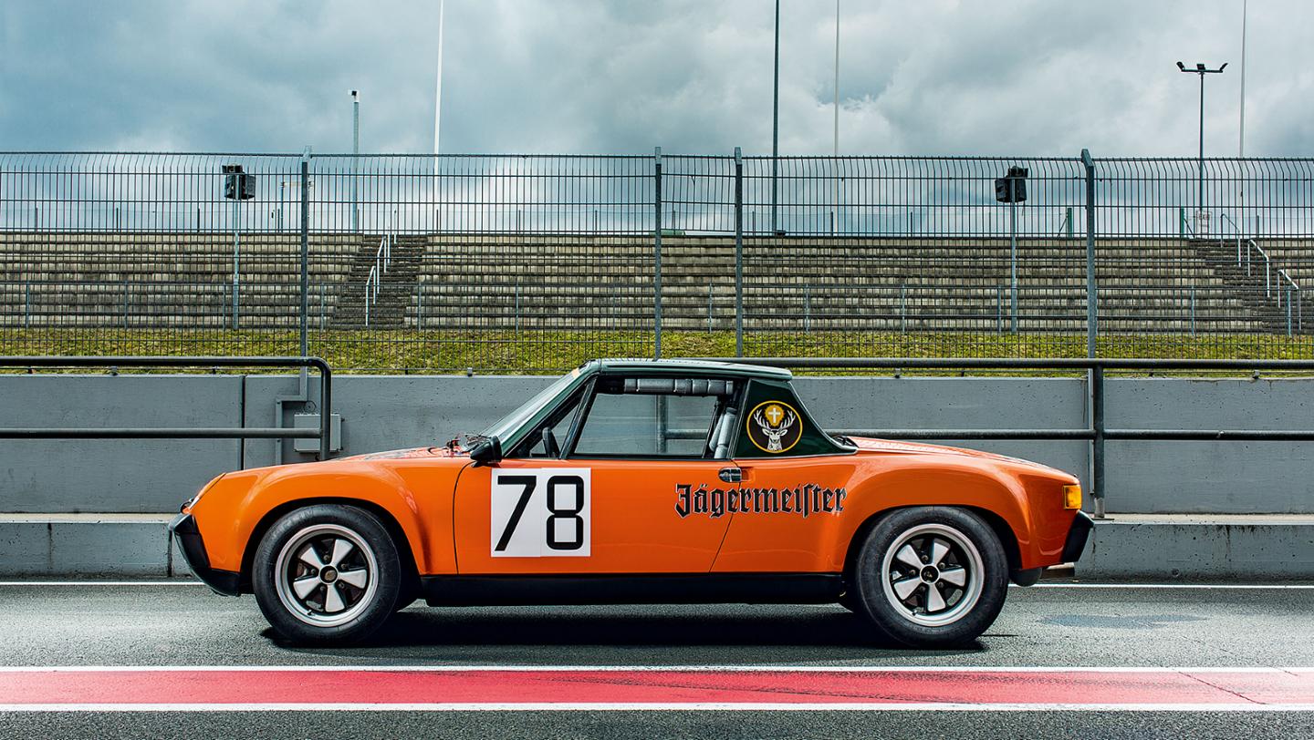

good question. I retraced where I got the pics from and it appears they are real pics. They must have some photoshop filter or something like that.
Here is the link to the article. click on gallery (IMG:style_emoticons/default/smile.gif)
https://newsroom.porsche.com/en/history/por...impf-13247.html

QUOTE(gothspeed @ Feb 14 2018, 11:55 AM) *
QUOTE(mepstein @ Feb 14 2018, 07:53 AM) *
QUOTE(gothspeed @ Feb 14 2018, 10:25 AM) *
Video game?
I think you are right. Great article. Car sits hi.
