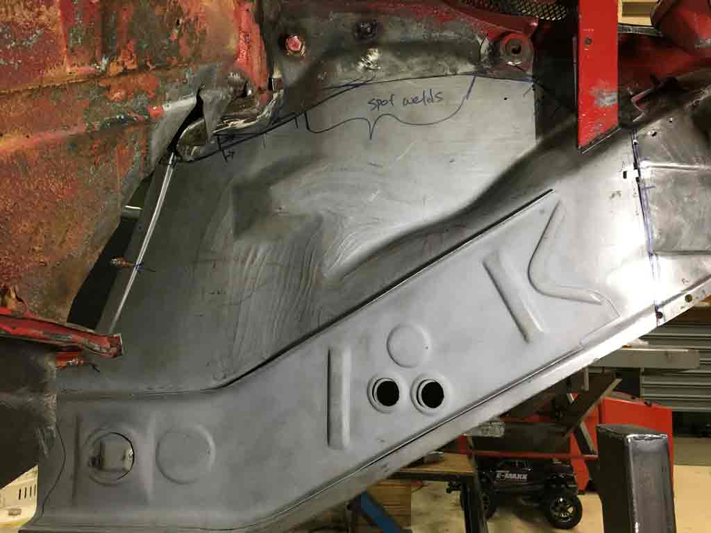

Have not posted in a while but I've been working. Not terribly exciting visual progress.
At this point I'm basically struggling with too many degrees of freedom on placement of the inner wheel house panel.
I was finally able to settle on that and have since Cleco'd it into place after I was satisfied that the panel is in the right fore aft direction and also that the basis of the interface to the inner and outer longitudinal are at the right Z height and are basically level to the other driver side rail as a reference.

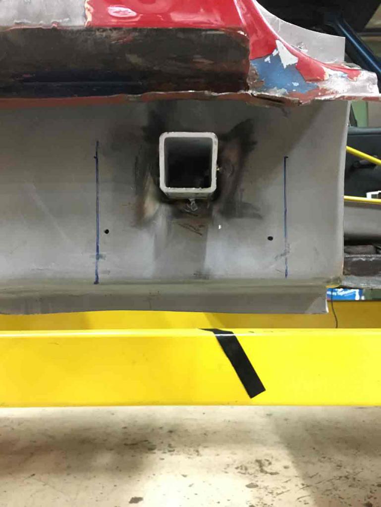

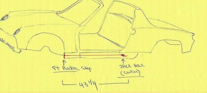

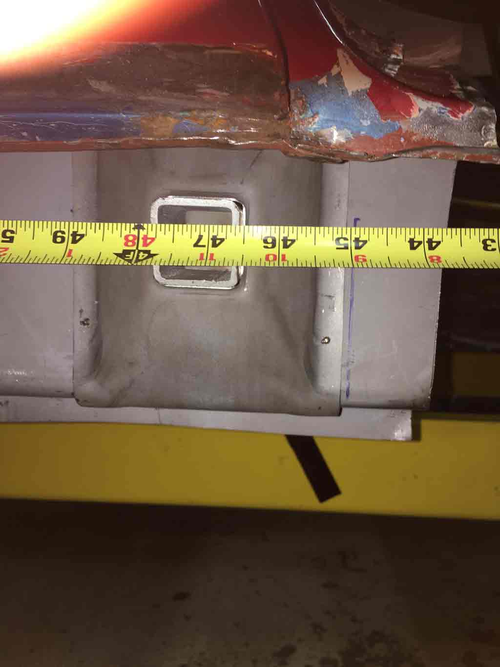

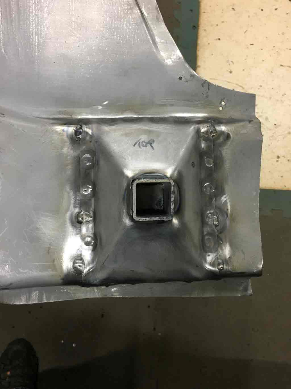

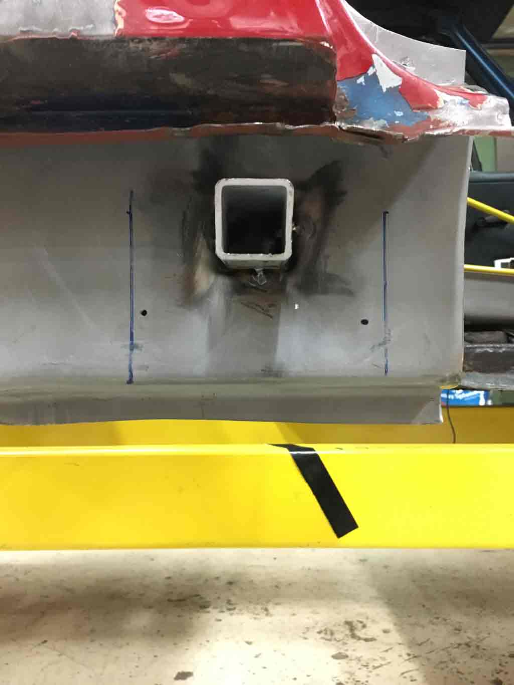

On the jack post front I ran into a interesting issue. Since I've been using Jeff Hail's Thread as the basis for getting me started and rationality checking what I do I found that the dimensions he had noted didn't match to my vehicle for the jack post location.
Jeff has kindly posted so much information and he's a much better artist than I will ever be. I think this one may have been a typo.

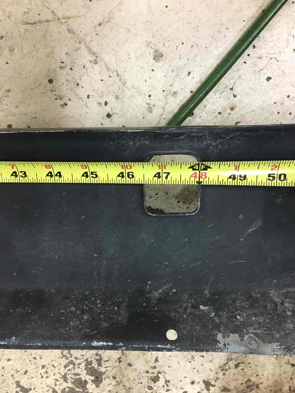

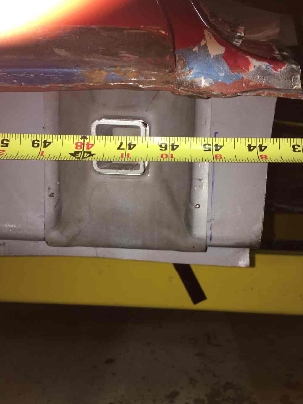

Dimension of 43 1/4" didn't match my vehicle though all of Jeff's other measurements for things like the suspension console mounts did match exactly.
This lead to much double checking and trying to figure out if I was doing something wrong. Ultimately the measurements from my car need to be considered "master" for my project.
In my case my jack post needs to be at 47 1/4 inches as measured from the very front of the front fender lip that the outer rocker locates from. It was the same for the driver side on my car.
I can't reiterate the importance of doing mock up work just to double check.

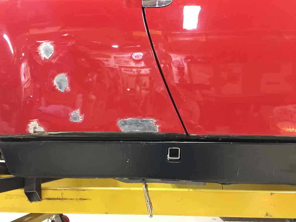

In my case, installation of the outer rocker confirms that 47 1/4" is the right measurement for me.
So satisfied that I had things in the right place, I've welded the jack post to the Wheelhouse panel.
