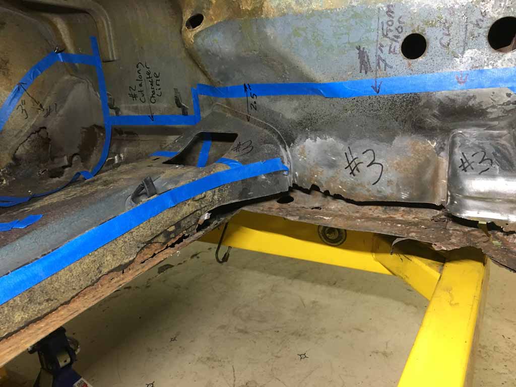

Here is the problem:
Everything starts with the simple task like getting ready to fit up the inner longitudinal. But then you have to deal with the fact that the metal it's supposed to mate to has been consumed by the tin worm. Then you have to stop the original task and then focus on this new one before you can do the main task. That is the way rustoration goes.
I took 3 vacation days from work that butted up to a weekend and went to town.
So with my newly prepped donor parts it's off to the races. Let the cutting begin. (IMG:style_emoticons/default/sawzall-smiley.gif)

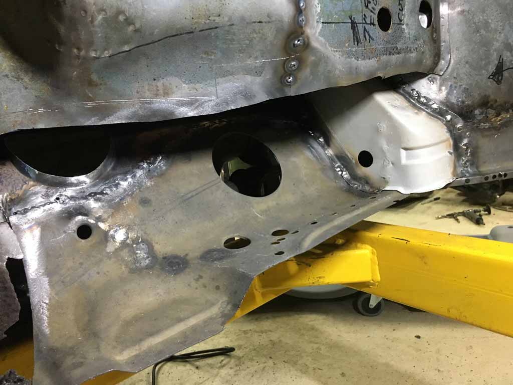

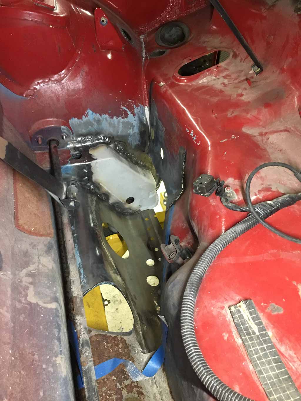

First victim - getting rid of the rear steering rack mount on the passenger side. Like the rear suspension console, it came to me "pre-stripped" by the previous owner. (IMG:style_emoticons/default/ar15.gif) That didn't really matter though because the sheetmetal was shot.

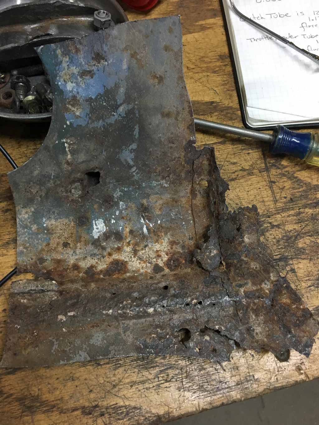

Tunnel was also removed. Like all the other metal, it is shot at that transition between to the floorpan. I got tired of getting a kink in my back attempting to work around it & scratching my back on it! (IMG:style_emoticons/default/headbang.gif) Good riddance. (IMG:style_emoticons/default/piratenanner.gif)
A donor tunnel has been sourced - we'll deal with that later (IMG:style_emoticons/default/biggrin.gif)
This car must have flexed and been as loose as the dickens given that the upper body sheetmetal is separated from the lower by rust though on the lower 1" all the way around. I often wonder how people don't notice chassis flex. (IMG:style_emoticons/default/unsure.gif)

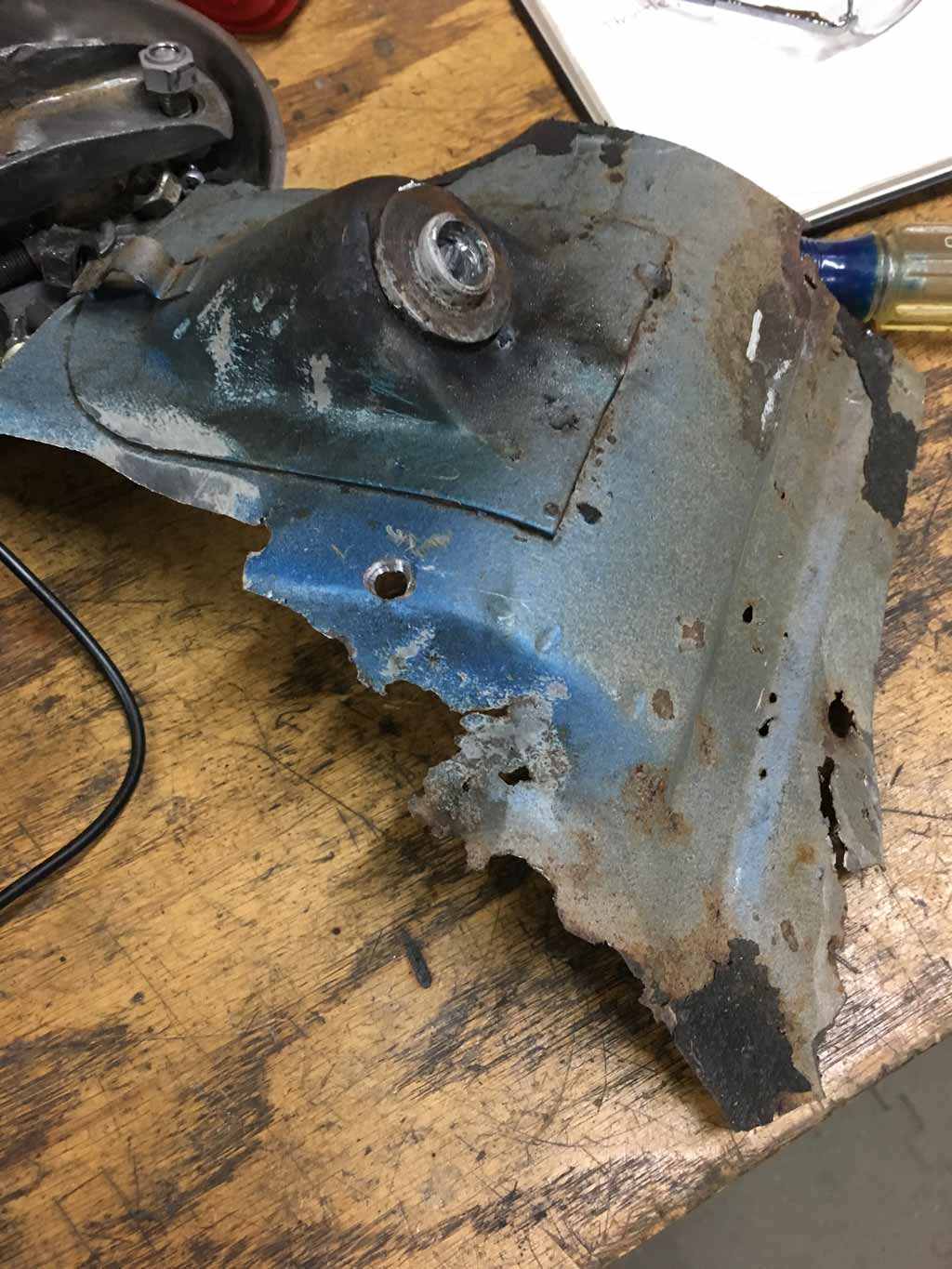

Garbage metal on the back side of the rear rack mount; absolutely no structure left here (IMG:style_emoticons/default/icon8.gif)

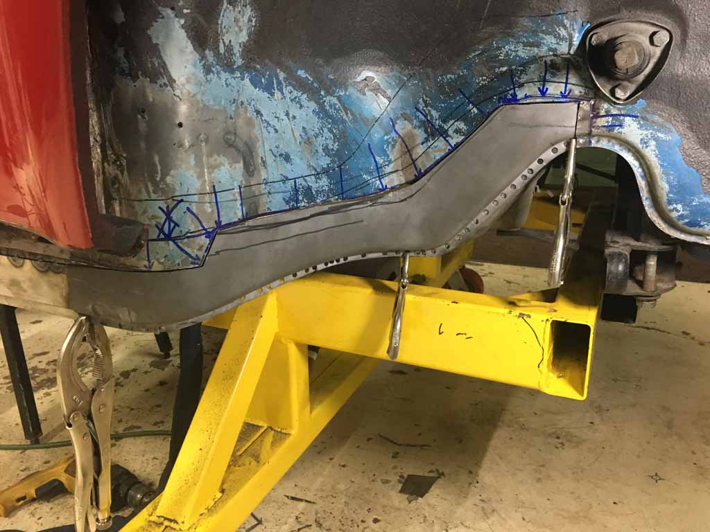

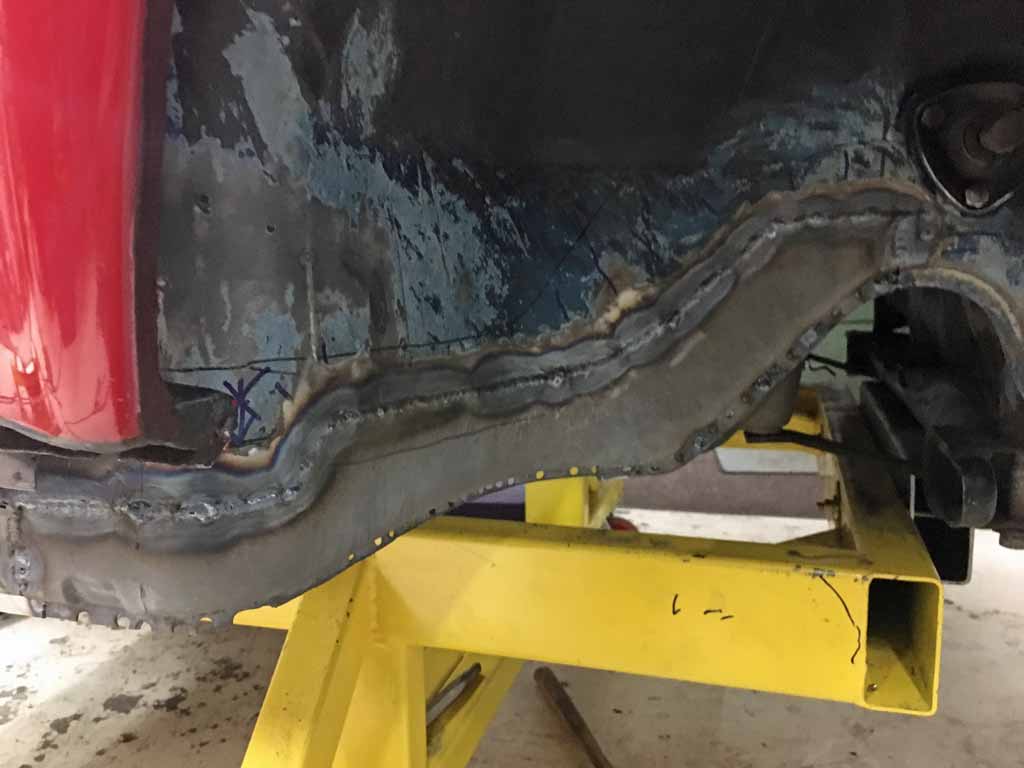

The donor metal I obtained was then fitted in on the passenger side floor
Then moved on to reworking the passenger side wheel wheel

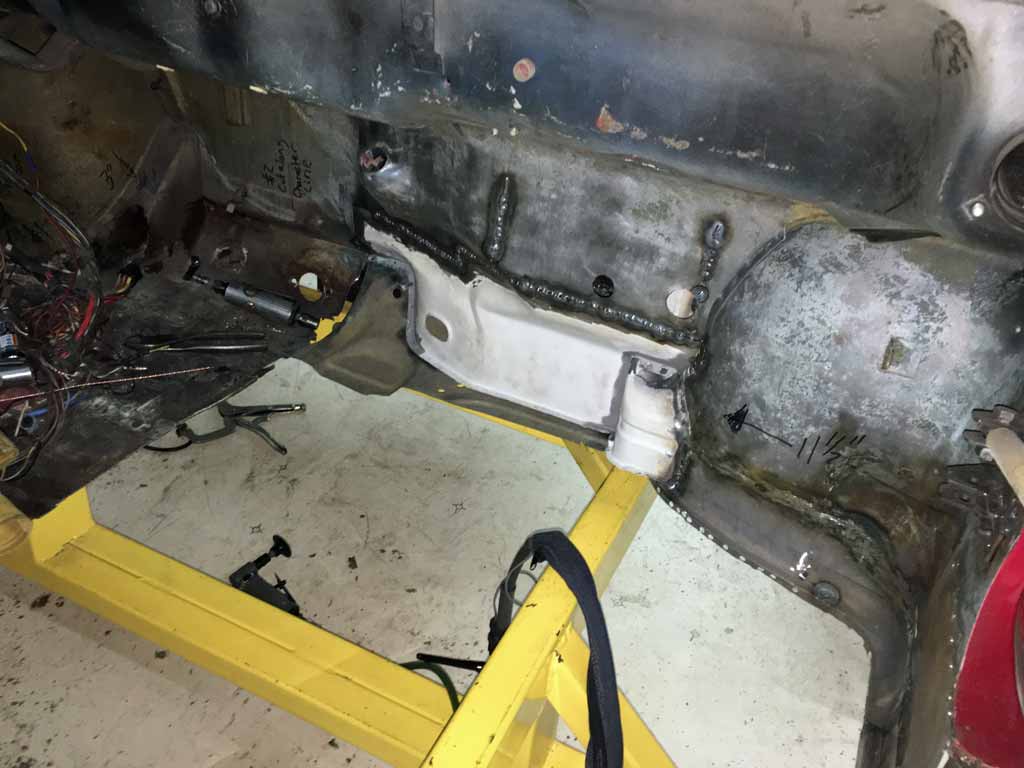

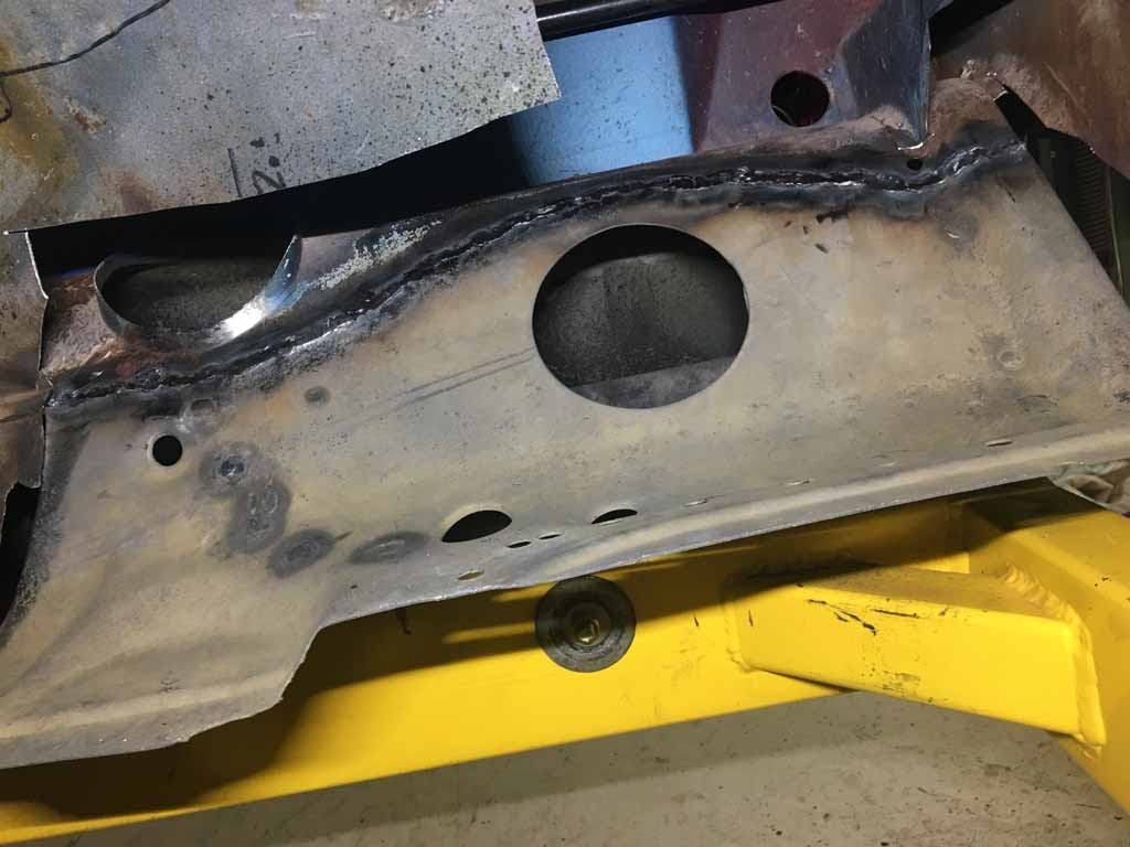

With that metal in place moved on to fixing the "frame" extension that comes in to the passenger compartment from under the fuel tank
View from the Frunk

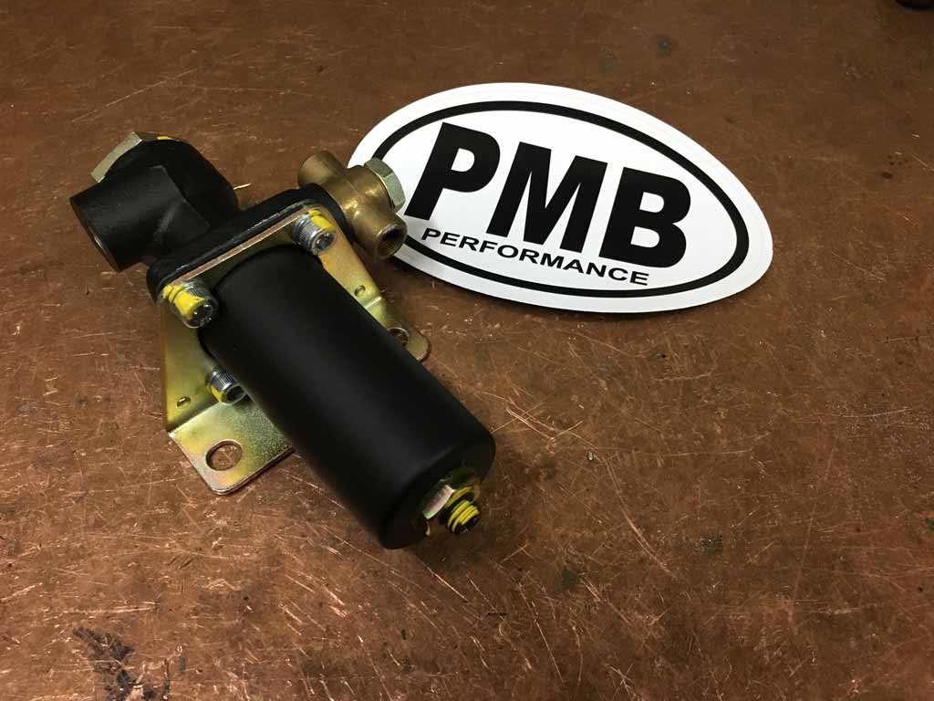

Got my proportioning valve back from restoration by PMB. Beautiful.
