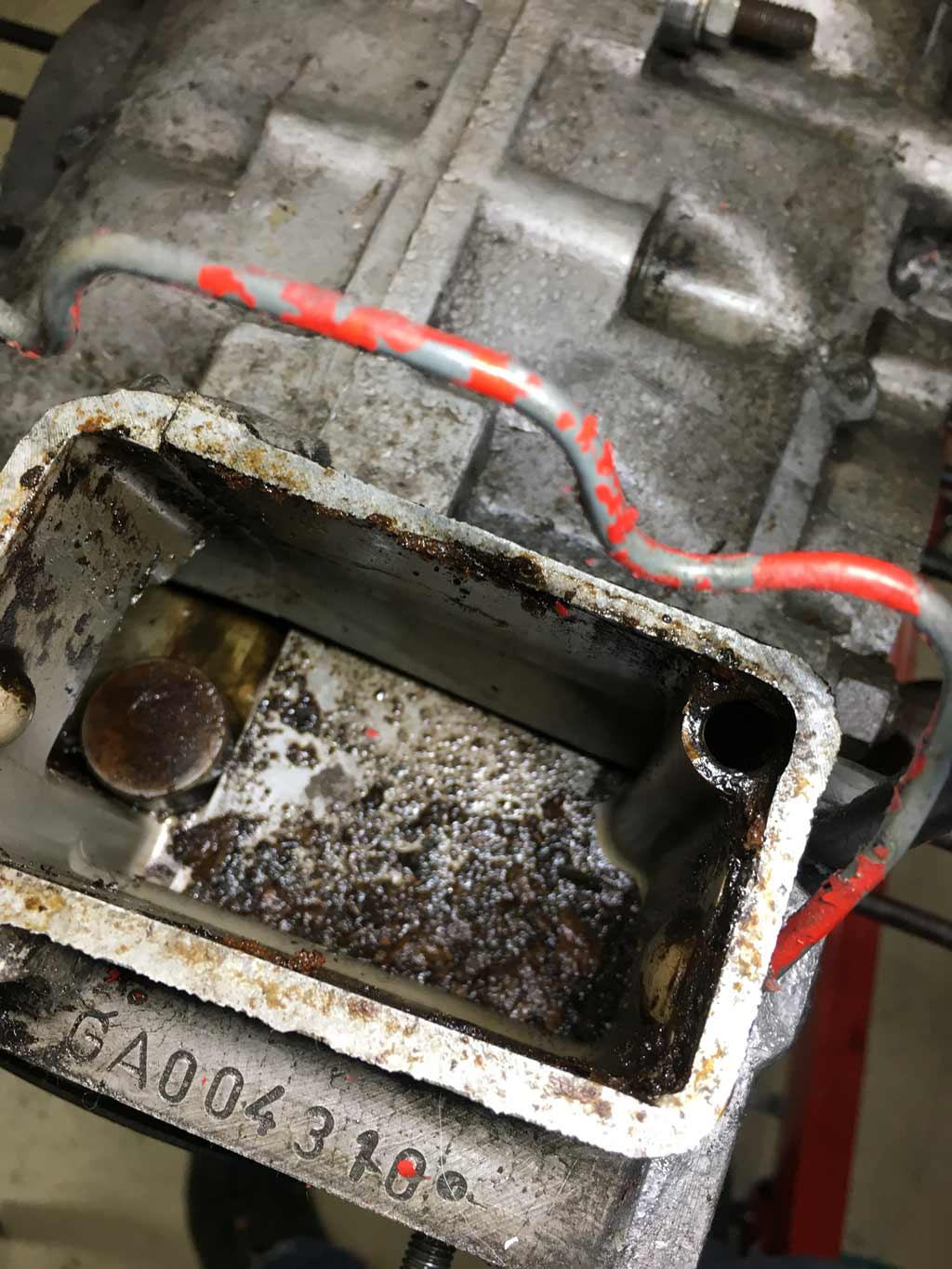

When I pulled the oil breather off the top of the case I was horrified. Here's what I saw.

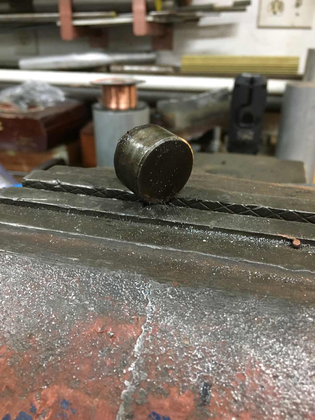

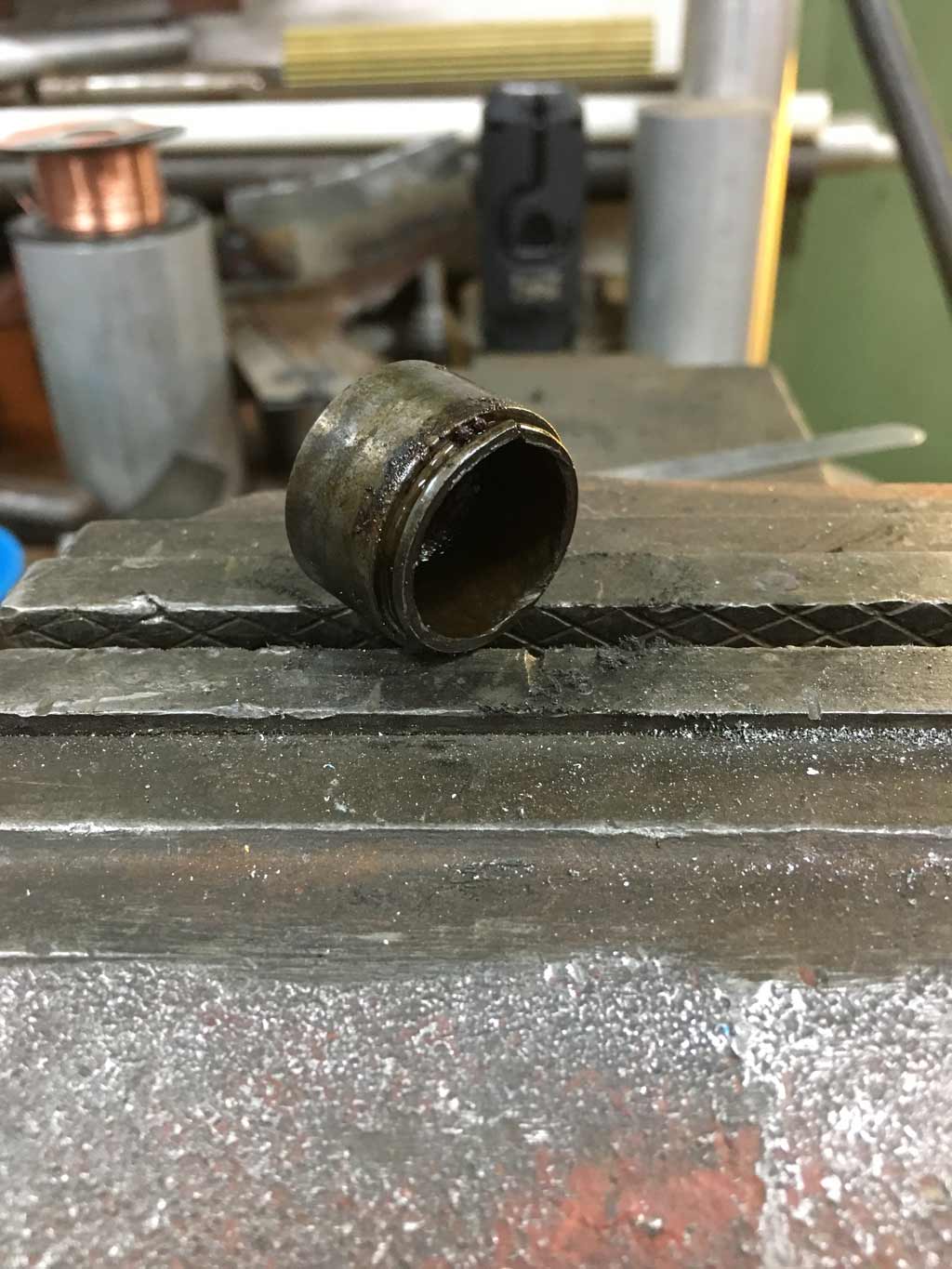

Worse than the rust debris / garbage there is some sort of round metal object in here. Luckily it was too big to ever fall into the case.
I have no idea what this is or where it came from. Any ideas? Here are two views of it
Not sure the size in the picture, but it looks kind of like one of the four ends of a ujoint off of a drive shaft.
