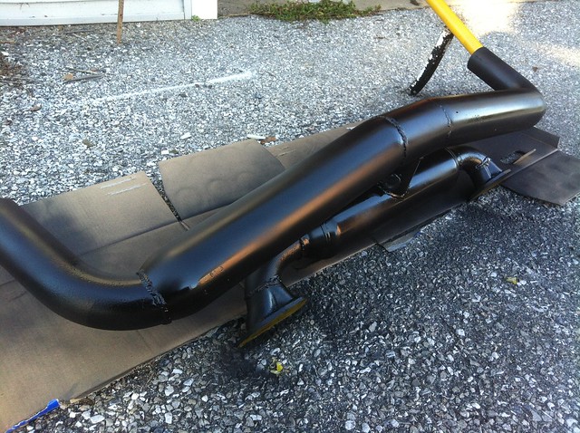

The lambda is in the muffler in the collector pipe where it can sniff all the cylinders (in theory). If I put it on the exchanger it would only be able to sniff one cylinder. The EGO probe has a heater element and is up to operational temps in a few seconds. In the below pic you can see where the bung is, in the pipe leading from the exchanger flanges to the main muffler.
