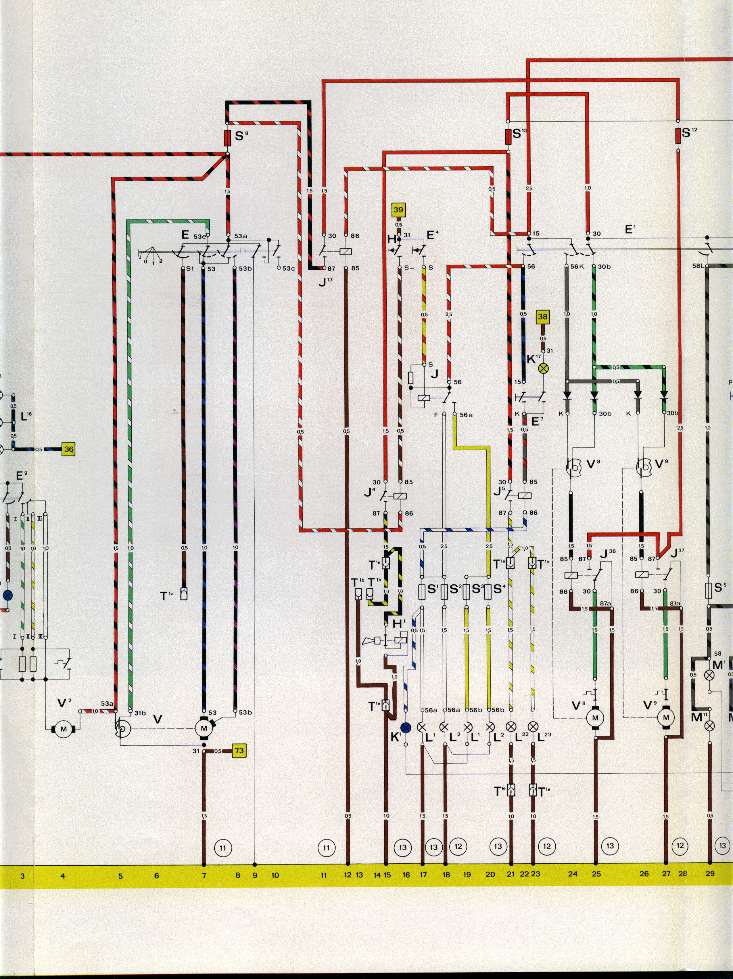

Pastormacman,
It looks like you are using the electrical wiring diagrams from the Haynes manual. They are somewhat harder to read/use that some color larger ones.
Here are the ones I used when I had mine. Depending on your year of 914, there may be some changes. With a little work, you can figure these out and make corrections on the larger prints. I made a copy from my computer and put it on a disc and took that to Staples and had 11" x 17" color copies made. So much easier to follow the lines. The number you see correspond to the numbers at the bottom of the print. Hope these come thru OK. I may have to use two posts to get them all posted.
Tom

QUOTE(Tom @ Dec 16 2019, 08:20 AM) *
Pastormacman,
Tom
Thank you very much. I think that is going to be very helpful.
