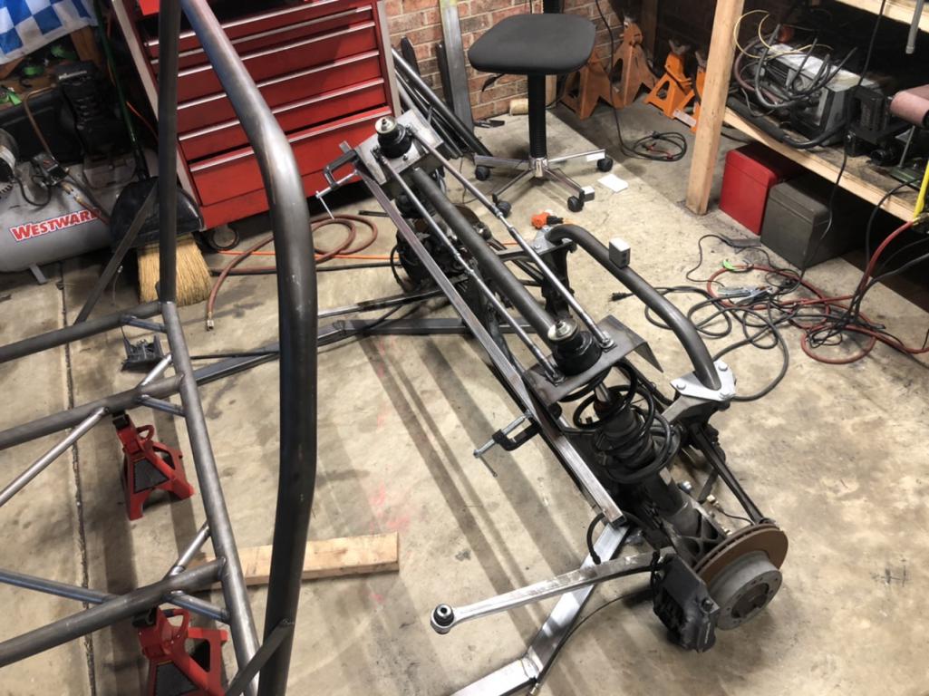

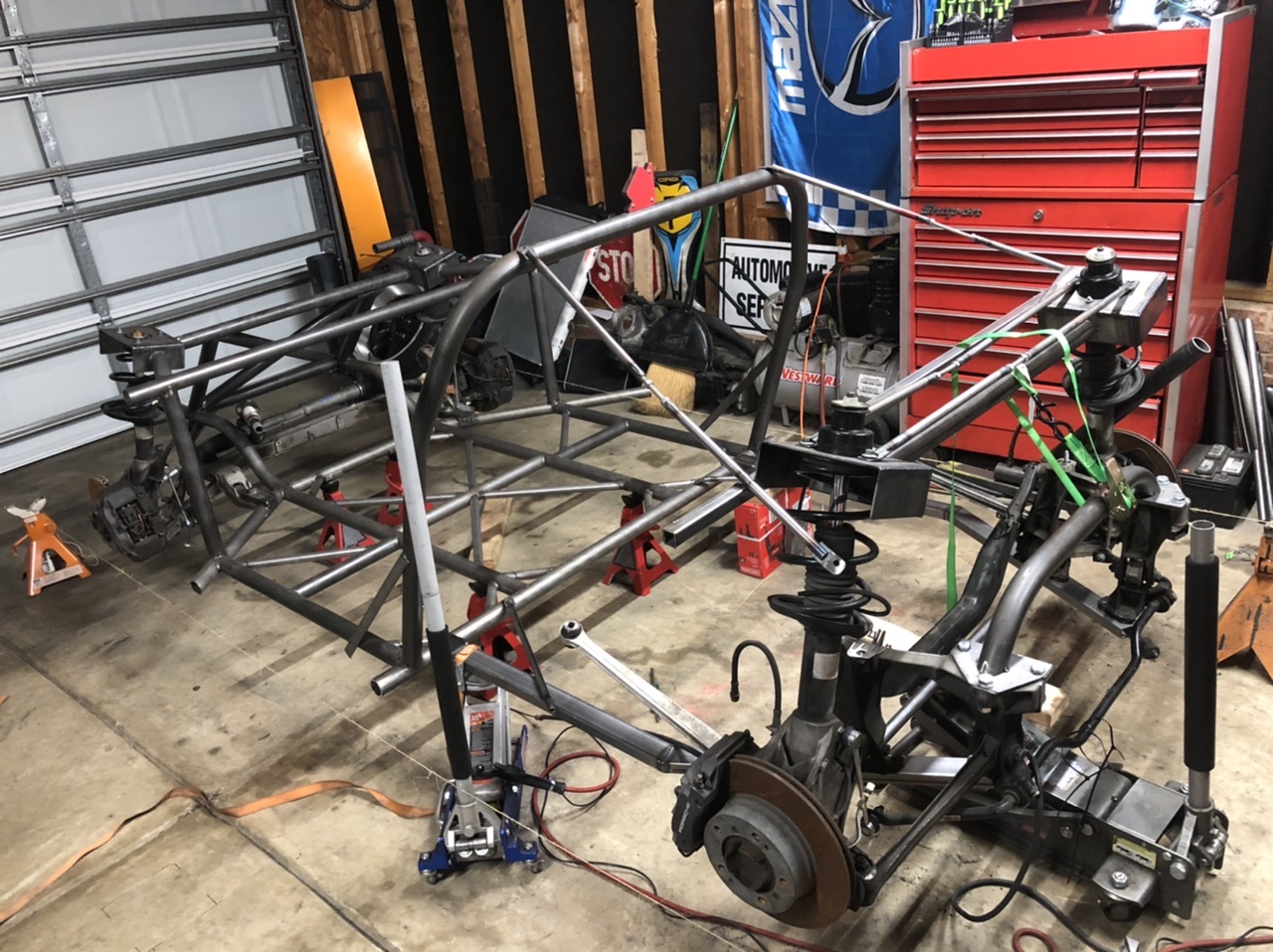

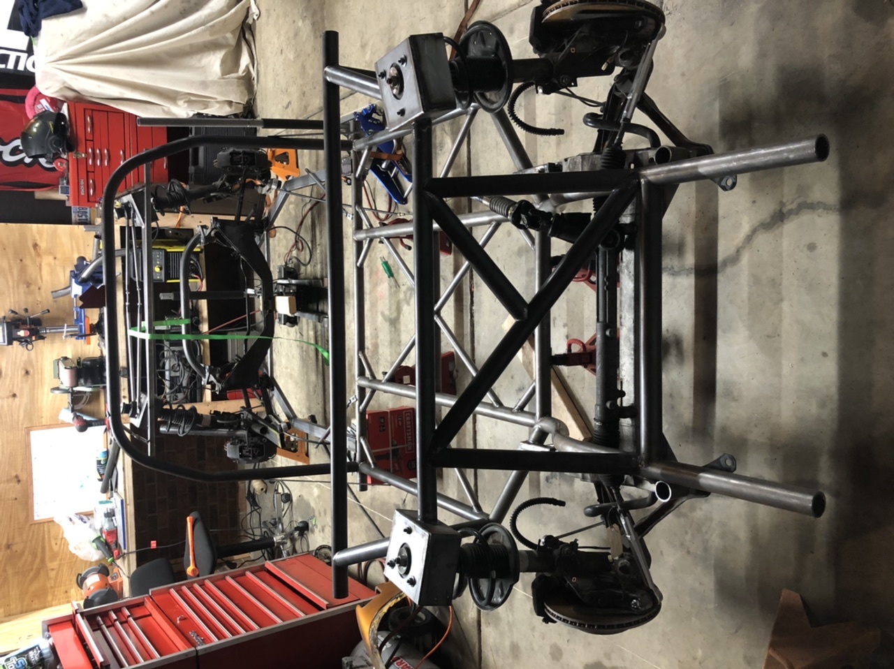

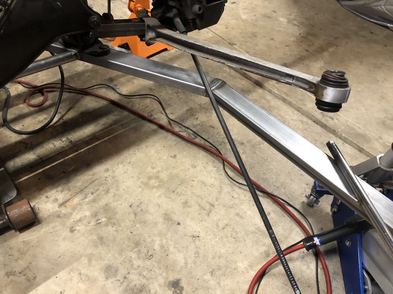

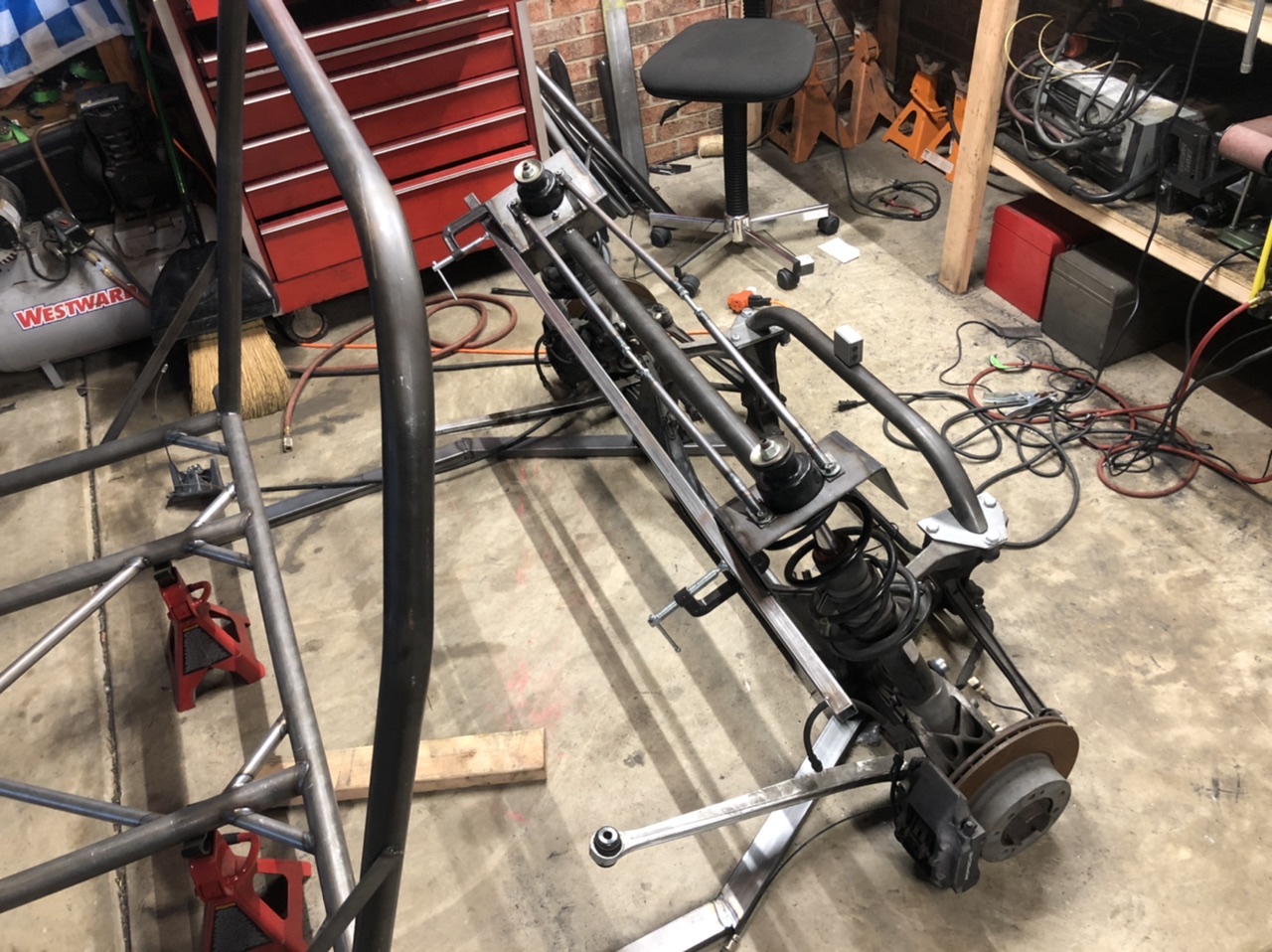

Sunday was a big day. After spending most of the day outside in the garage i completed a lot of things i needed done. First i made some spacers and mounting plates for the rear subframe mount. Some plasma cutter and like an hour of grinding later and they came out great. (i forgot to take a picture) Next i made up a ( shaped bar to connect those plates together, made another one of those fancy camber bars that go between the struts. I lined it all up and tacked it together and presto! Our first picture.
I decided that i needed to change the subframe i already built and didn’t like, so i did. I made it slightly thinner which helped it fit between the main hoop better and cut it to length which helps with the wheelbase issue.
Now came the moment i had been waiting for; Time to put it all together and line it up. First i used a trusty ratchet strap to align the rear stuts to their proper angle. Simultaneously i had the subframe up on a jack with a piece of wood to balance it. I used my other jack, a new drill in a box, lots of scrap metal, and some card board to set the subframe height at the chassis. Its ghetto but it worked. I then got the correct rake of rear subframe.
Next i setup a string alignment setup to make sure the subframe was center left to right. At some point i had to sit down and stare at it because this took like two hours to line up. But finally i got to tack everything in place and thats where we are now!

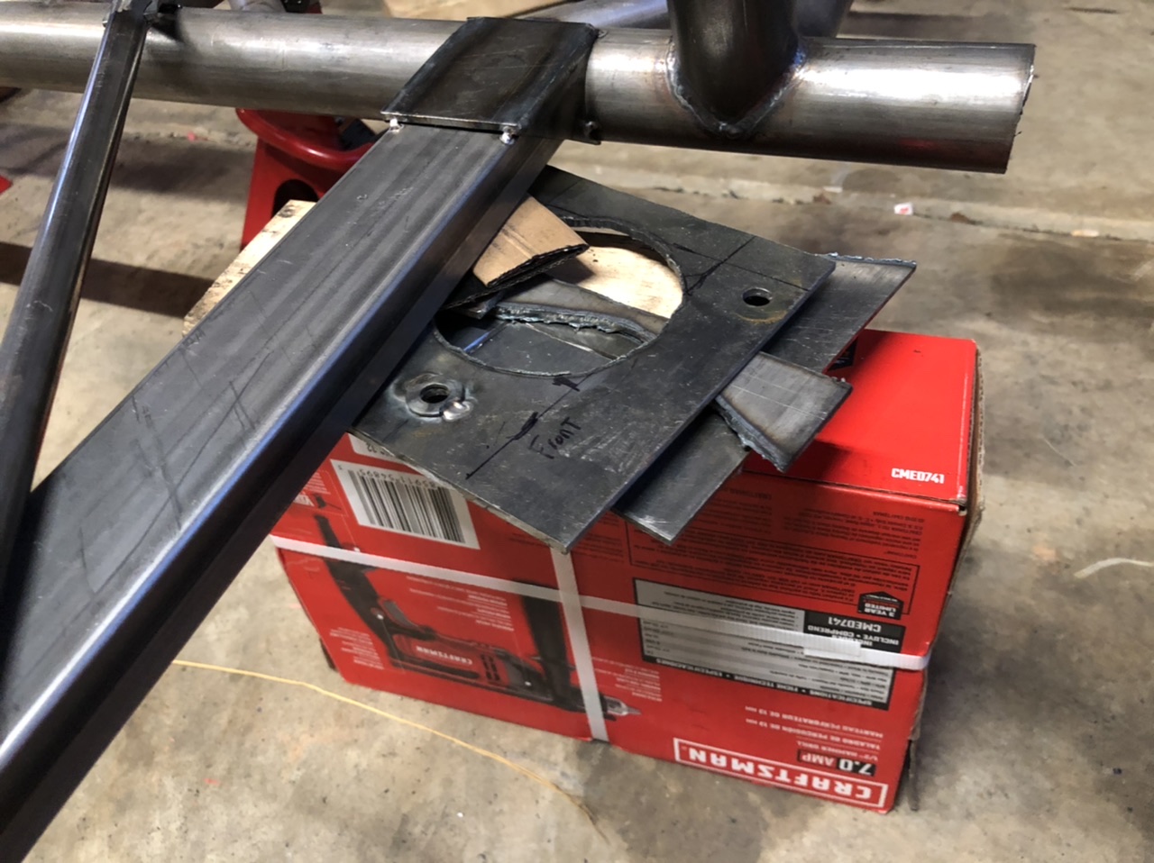

tazz9924   Made my strut tops! Ill be honest i was very e...   May 13 2020, 09:56 PM
