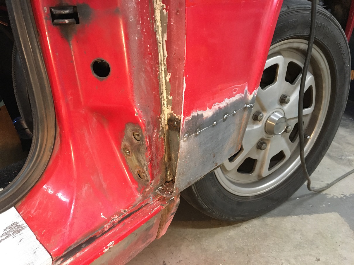

I have already started fixing some of the rust issues and will share that progress in the near future but right now, I wanted to post some of the issues i have on the passenger side front fender. (IMG:style_emoticons/default/sad.gif) I have searched and read many of the builds here but I would like some inputs from the people who have gone through this mess.
I am trying to understand the construction of the rear part of the fender, more precisely the area joining the front cowling.
Below is a sketch of how I think it is made but i would like someone to confirm...
Having removed the seam sealer in the upper rear area, I have discovered "this" (IMG:style_emoticons/default/dry.gif) which is not really unusual, but clearly a pain to fix. I am not sure though what I am looking at. If my sketch is correct, I guess the inner rusted layer is from the fender rear bulkhead that actually becomes an inner layer on the rear upper point of the fender by the door and cowling junction.
I might be able to cut this from the underside preventing me from cutting the outer surface of the fender. But I would like to better understand what is happening at the junction to the body.
How many layers are there from the fender, one or two?
Is the metal peeling off at the joint to the body the metal from the bulkhead/inner layer, or is it the outer fender layer?
As a reference, this if the situation of the channel, surface rust, but how bad? Is there a way to better know without destroying? Maybe poke with a screwdriver? (IMG:style_emoticons/default/confused24.gif)
Comments appreciated (IMG:style_emoticons/default/smile.gif)

Moving on to the other problem area of this fender... (IMG:style_emoticons/default/dry.gif)
The typical rusted lower point which is located near the doubled up packed with seam sealer, not very surprising...
Again, AA sells a repair piece but I prefer using an original piece and got this one (IMG:style_emoticons/default/smile.gif)
After removing all of the unnecessary metal and seam sealer, the parts started to look a lot better.
Time to remove the old and replace it with the old.
Result:
