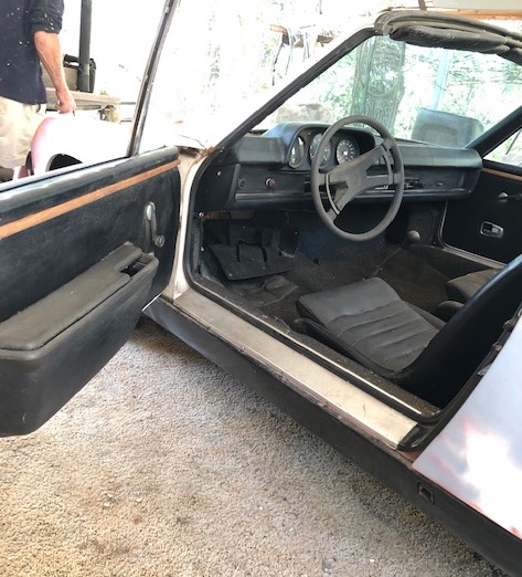

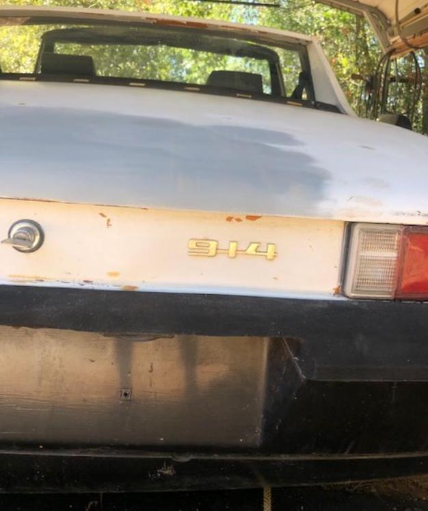

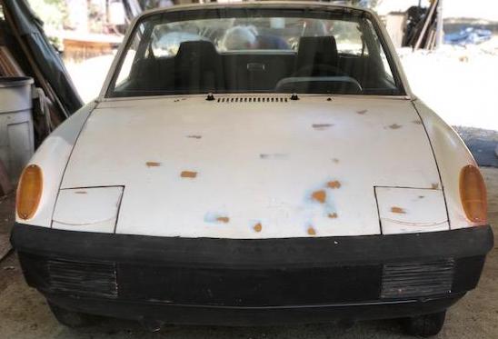

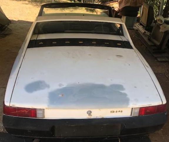

Ok Brain Trust! I am going with another 914 owner to Sonora, Ca this Friday to look at a 1970 barn find. This 2nd owner said the car has been in his barn for 20 years, that it ran when went in, and has been rolled about but never started over the years. VIN # is 4702902635, which I believe would make it the 2,635th 914 built in the first year of production, 1970. The odometer says a little over 60K miles. We will check the engine number, but have no reason to believe it is not all original. He says that other than the obvious cosmetic issues outside, there is no bondo that he could find (magnet checked) and no chassis rust (I know, we've all heard that before. We'll look Friday as best we can, hell hole, trunks, etc, but won't be able to remove the rockers).
Question: IF we can roll the car, AND the brakes are not seized, AND the engine rotates in gear, AND I bring a battery and fire extinguisher, would it be ok to hook up the battery, turn the ignition just to the "on" position and see if the gauges come to life? IF they do and that checks out positively, what about trying to start it? I know the fuel is probably crap, and the fuel lines COULD leak, but if it all seems good up to that point, what about a test start up?
I will try to find the engine number on the top of the engine. Besides lots of photos and checking the obvious areas for rust, what else might we want to know about?
It looks like it has the original standard VW steelie wheels and caps, correct for these early 914's.
Shouldn't it have a 1.7 label on the back along with the 914 label?
I will ask him for all records that he has also.
I convinced the owner to let the car go to someone who wants a project car. I told him I would be willing to post all photos and info that I get there on this site and see if any members here would like to BAT and get his project car. My GUESS at this point, with this info, is I would recommend a price around $3500.
Any further thoughts or comments before my Friday visit? Think I'm close on a price recommendation, with what we know so far?

QUOTE(oakdalecurtis @ May 24 2021, 09:32 AM) *
Does everyone agree with Front Yard Mechanic, that, based on what you see and know at this stage, it's only worth 2k?
That early rear bumper is 1k alone, if restored.
post May 24 2021, 11:02 AM
914-6 GT in waiting
Posts: 20,932
Joined: 19-September 09
Member No.: 10,825
QUOTE(SirAndy @ May 24 2021, 12:41 PM) *
I did restore & re chrome an early rear bumper. Chrome cost $450 and shipping 2x was $150. Sold for 1k.
There is a lot of good stuff in an early car but a lot of time, work & space to part and sell.
