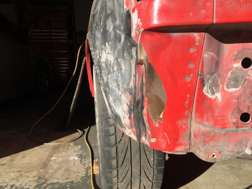

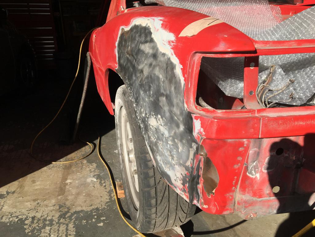

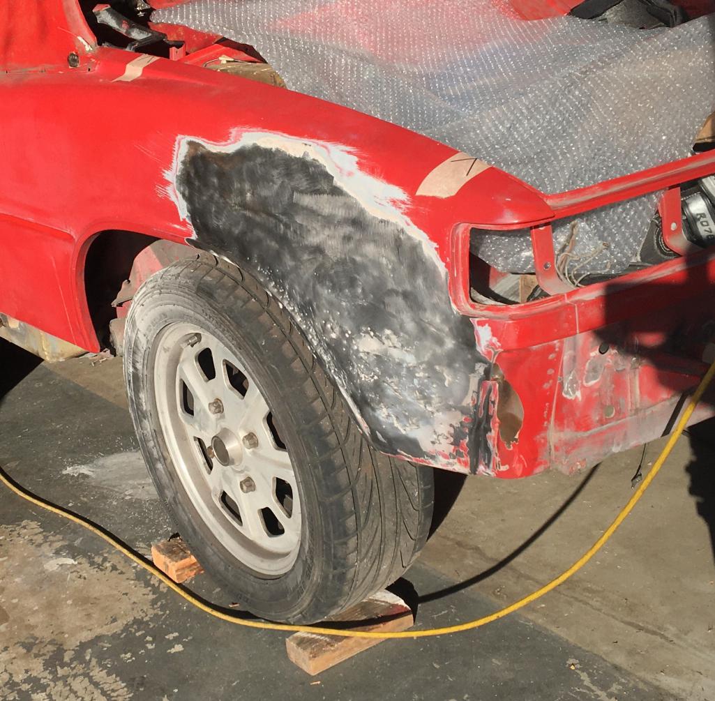

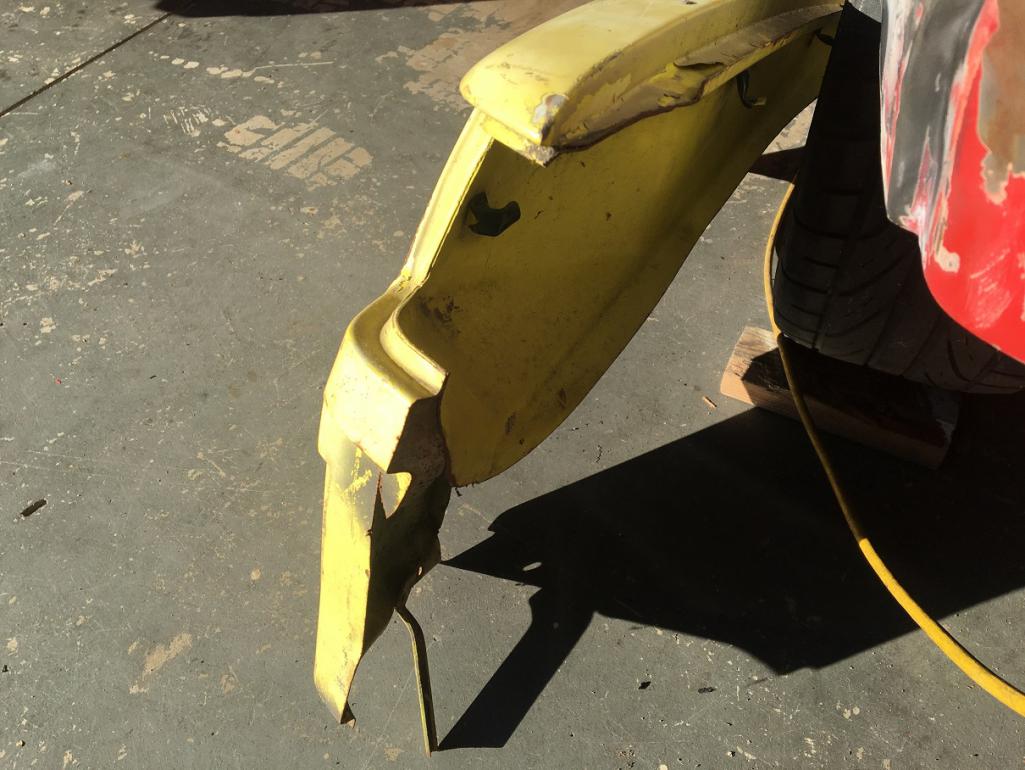

Here I will need the input from the experienced people! (IMG:style_emoticons/default/smilie_pokal.gif)
My car has been hit in the rear driver side quarter at some point and this translated into an irregular curvature. Recently, I removed the bondo that was causing most of the hump, but as you can see in the pictures below, this was a half way straightening job of the fender.
I am pretty sure this fender can be saved by the right qualified person (which is not me) but I fear the cost might be more than cutting and replacing, which is something I can do up to the level of work seen throughout this thread. (IMG:style_emoticons/default/dry.gif)
This is not a show car, it will continue being a regularly driven car with a fresh paint.
I do have a donner quarter I got from Bruce Stone. Unfortunately, it was cut a little shy on the back side but is probably manageable. Another option would be to get a whole fender from Vince and replace it but that involves dealing with the door, vent area, and sail.
So, should I get this fixed or should I cut and replace? If I do cut/replace, should I replace the whole fender to prevent the vertical scar in the middle?
Thank you for the inputs! (IMG:style_emoticons/default/smile.gif)

Montreal914   Here I will need the input from the experienced pe...   Dec 15 2021, 11:36 AM
Luke M   I've done both of these type of repairs. My br...   Dec 15 2021, 02:34 PM
Montreal914   Thank you for the advice and pictures Luke. :) ...   Dec 15 2021, 03:27 PM
Luke M   Thank you for the advice and pictures Luke. :) ...   Dec 15 2021, 06:12 PM
Montreal914   So am I understanding that you keep the tube on th...   Dec 15 2021, 08:14 PM
Luke M   Correct. Keep the tube on the donor q-panel. Remov...   Dec 16 2021, 11:07 AM

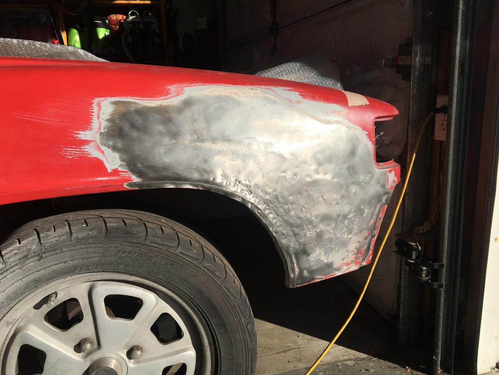

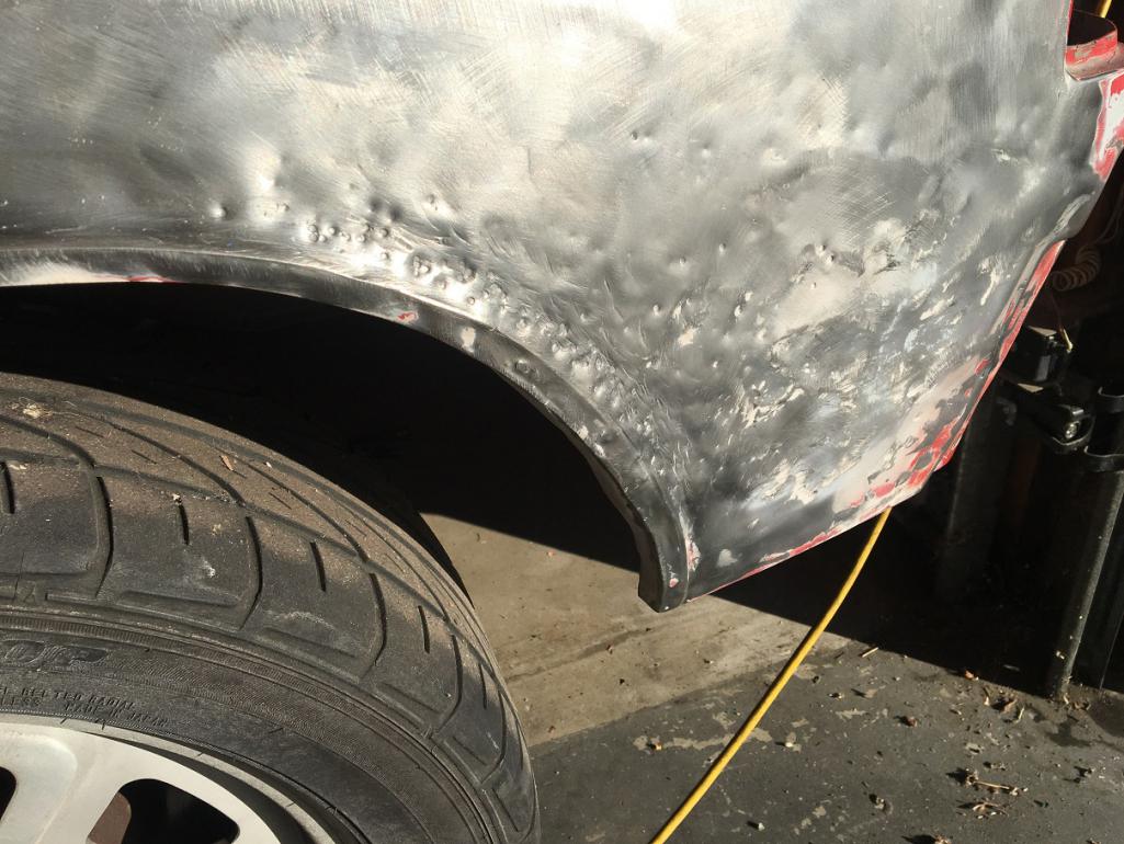

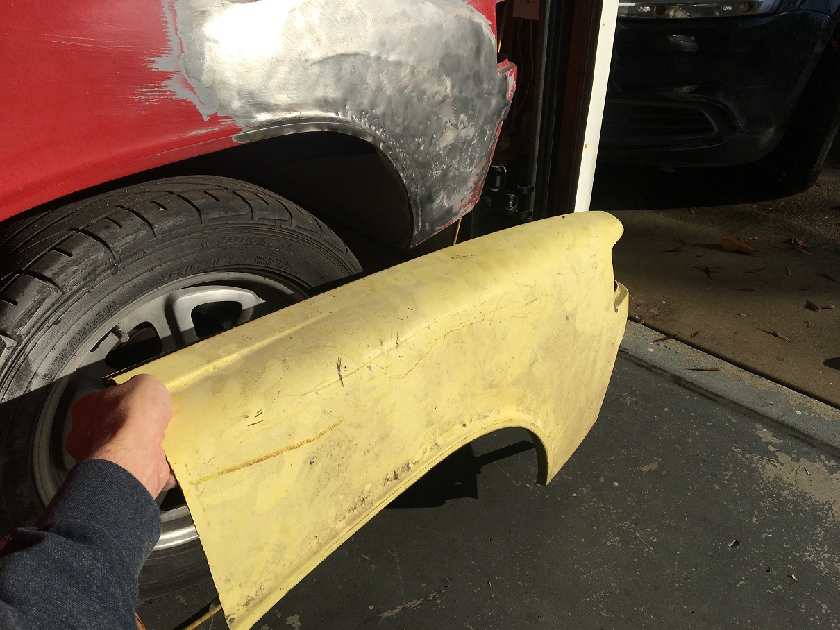

nivekdodge   I think I'm still leaning to the whole fender ...   Sep 25 2022, 07:57 PM
Cairo94507   Really nice work Eric. I agree with replacing the...   Sep 26 2022, 07:36 AM
930cabman   Really nice work Eric. I agree with replacing th...   Sep 27 2022, 11:59 AM
Montreal914   @nivekdodge : By double flange you mean this class...   Sep 26 2022, 08:14 AM
nathanxnathan   You know my original advice was to splice in just ...   Sep 26 2022, 10:45 AM
Montreal914   You know my original advice was to splice in just...   Sep 26 2022, 11:20 PM
nathanxnathan   Nathan, yes I still have all the pictures you sen...   Sep 27 2022, 11:39 AM
Montreal914   All good inputs!! :trophy: @nathanxnat...   Sep 27 2022, 08:03 PM
nathanxnathan   All good inputs!! :trophy: [b]@[url=h...   Sep 28 2022, 11:31 PM
nivekdodge   Eric I meant in the gap beside the trunk lid. I...   Sep 27 2022, 08:18 PM
Montreal914   I would probably attach the fender using a few sel...   Sep 29 2022, 06:53 PM
