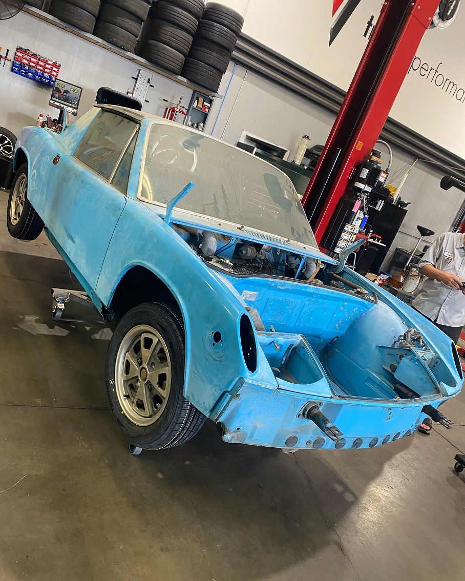

A 1975 Porsche 914 2.0 in Laguna Blue L50C. What a color!
It all started when I found a 76 2.7 911 motor on craigslist. I inquired and got a snappy text back from a known number. Turns out, it was a friend and the owner of the local Porsche specialty shop. I went over to check out the motor and ended up buying it. A pretty clean 2.7 core, missing a few parts, but had a set of Italian 40 IDTP carbs on it.
While there, I was shown the 914 which the 2.7 was actually destined to go into at one point but then the owner decided to go nuts and planned to put a 3.6 in it.
He had acquired thousands in parts but lost motivation in the project. He had flares, elephant suspension and all kinds of stuff. Sadly (or perhaps fortuitously,) he had sold a lot of the new parts to another 914 enthusiast, so what was left was just the original car.
Already having a big project in my 74 RSR tribute, I passed on the 914 and headed home with my new 2.7. My 75 911 has a similar motor and It's ready to rebuild. I thought I would take the best parts off both motors and make a 2.8 twin plug beast for my 75. Ya never know what condition the crank or heads are in, so I figured it was a good plan to have more parts at the ready for cheap, and then sell everything left over later.

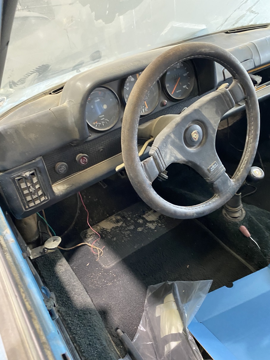

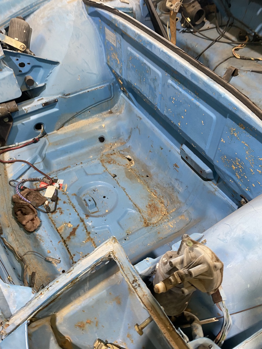

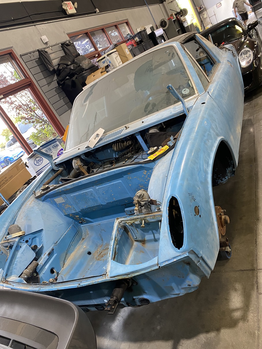

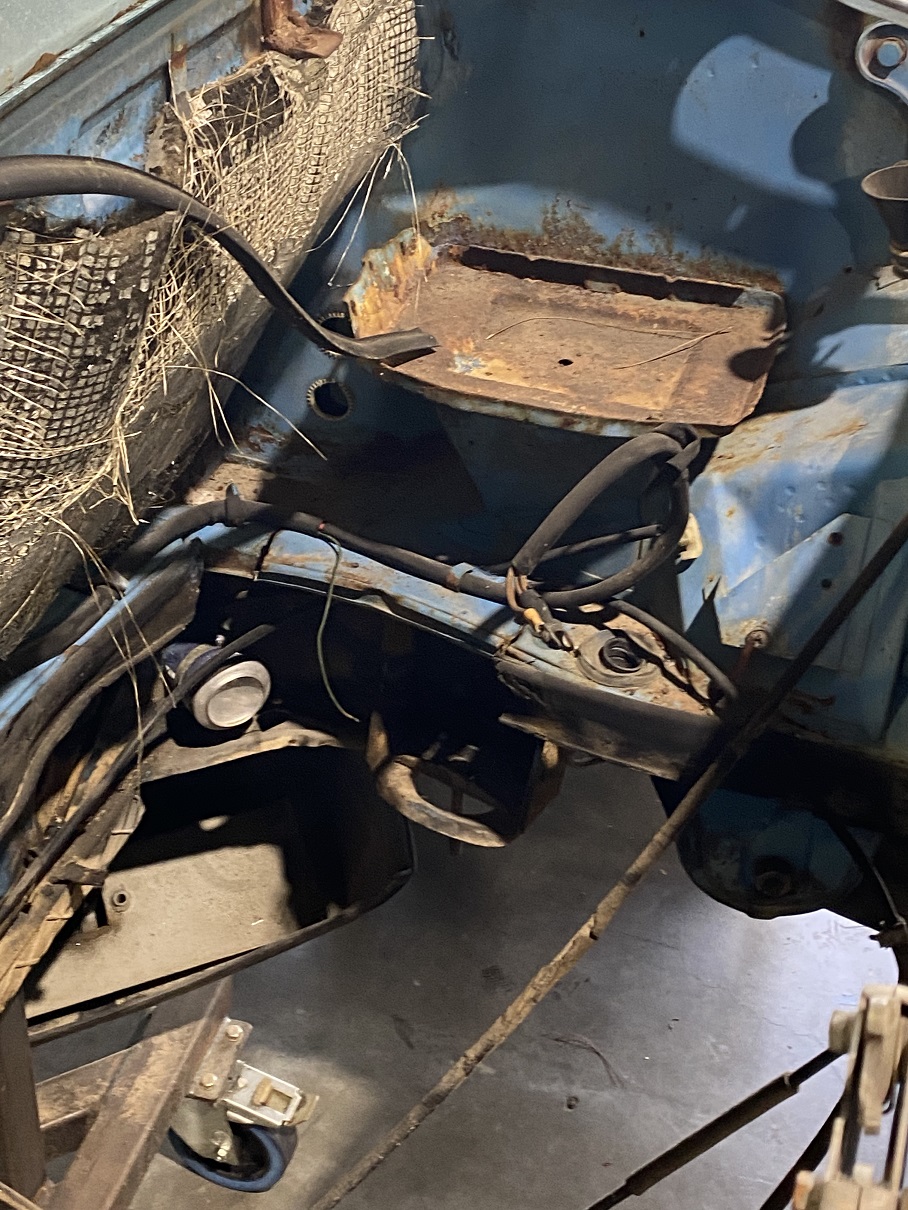

One thing that struck me about the 914 on that first visit, was that the car was extremely dry. Here's the ....ahem... heck hole.

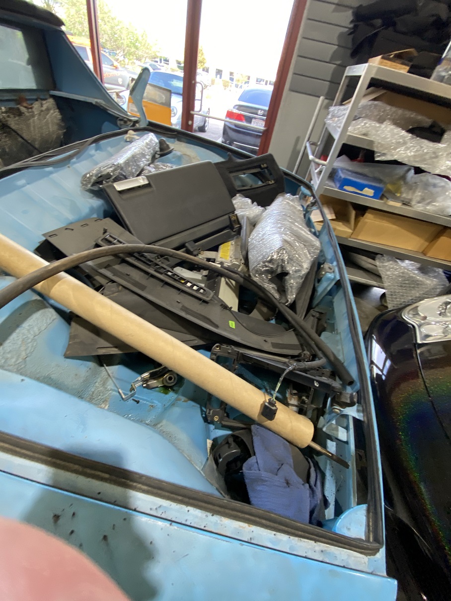

Though the car was taken apart, the previous owner seemed to have all the original parts (though many of them were in his storage facility and not with the car.) Another cool factoid was that the car was actually purchased in a nearby Audi/VW dealership right here in Las Vegas. Vegas in '74 was very, very small, so to have a survivor 914 in the same town that it was 46 years ago is pretty cool in my opinion.
The car was more or less stripped in preparation for a GT conversion. I remarked in my mind about how solid the car was and went home that day thinking it was a good deal but that I'm a snobby 911 guy who doesn't buy anything but 911s :-P The car was definitely marinating in the back of my mind...

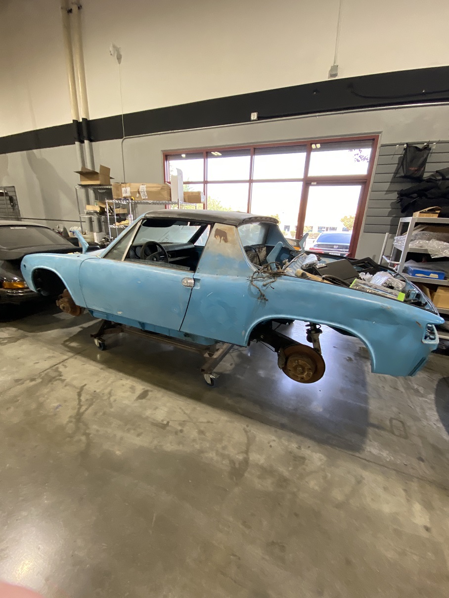

Fast forward a few months later and a younger friend was talking to me about project cars, and it got me excited about the 914. On a whim I reached out to see if it was still there and bought it the next day. I think I just really liked it and I fell in love with the color. It feels like a mix between Gulf Blue and Miami Blue. I'm actually painting my RSR Gulf, so I absolutely love all the cool blue colors.
The shop had a bunch of waterpumper parts stored in the back:

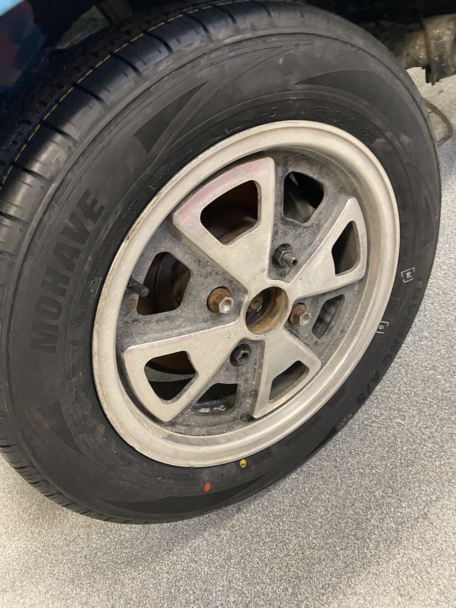

PO had the original Fuchs 4 lug wheels, but no tires. the 914 was also on a pretty sweet dolly, but unfortunately that wasn't part of the sale.
I took the wheels to a discount tire and got the cheapest tires I could buy, just so I could make it a roller for the impending flatbed trailer pickup appointment.
I had to scrounge around and find some lugs to mount them. Luckily I had some open 911 lugs as well as some 996 studs to complete the temporary fix.

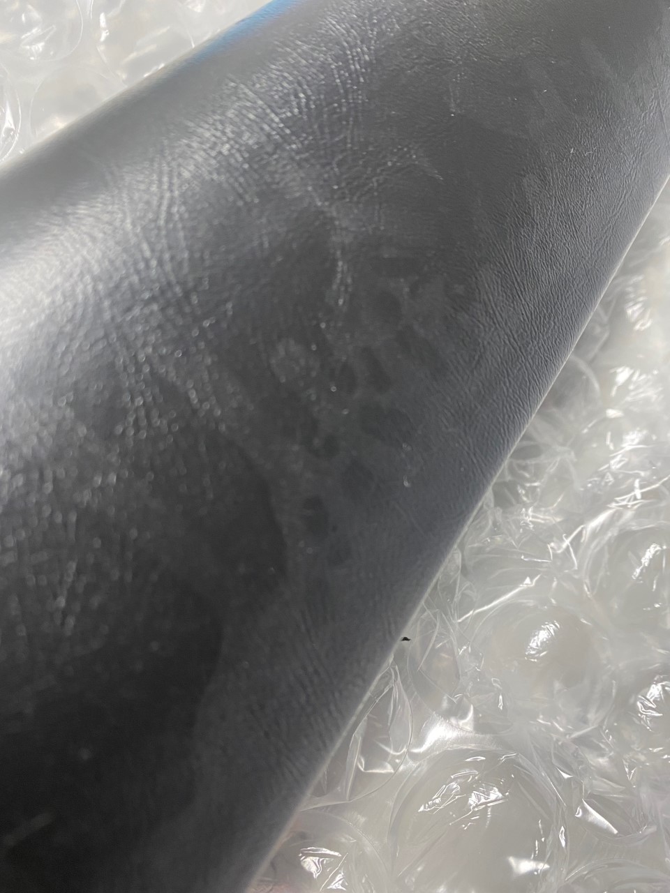

I bought a new dash, it was arrived damaged with white drip staining all over it, and a manufacturers defect right in the middle of the dash. It was also maybe 3x heavier than the original dash. Not that big of a deal in terms of the weight, but the between the weight, the defect right smack in the middle and the horrible drip stains all over it, obviously it had to go back.

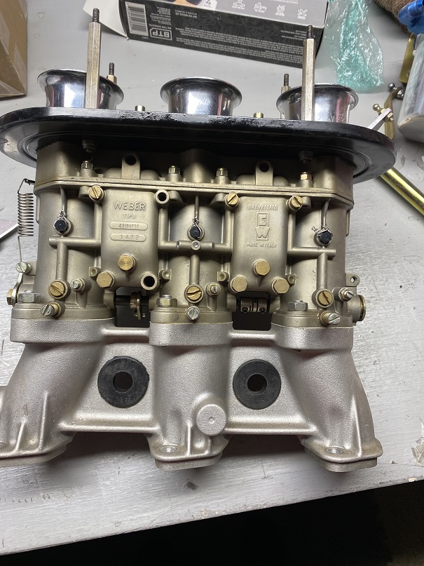

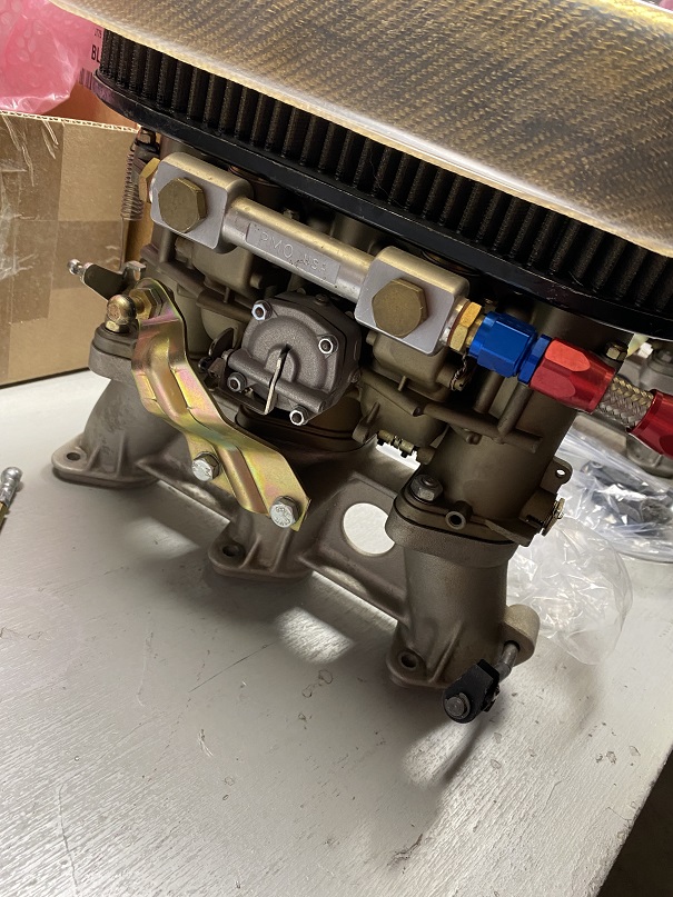

Lastly I acquired a set of Italian Weber 40 IDAP 3c carbs. I'm well versed in these as I run them on my 75 911. The seller advertised 34 main venturi (chokes) but it actually came with 32mm chokes. In the market for 34mm if you have some.
The carbs were serviced back in 2017 by Paul at Performance Oriented. Paul did the butterflies and shafts and some basic JB weld fixing from pitting.
They came with PMO tall manifolds, Sheridan amber rain hats, Jerry Woods throttle cable setup (Very cool!), and PMO fuel rails. Seller also threw in a fuel pump, and fuel filter.
If working on my 911 webers have taught me anything it's that you absolutely have to completely tear down any carbs you get used. All the way. I found so many issues, so of course I'm glad I did. Gaskets missing, o rings missing, wrong chokes, old fuel residue etc.

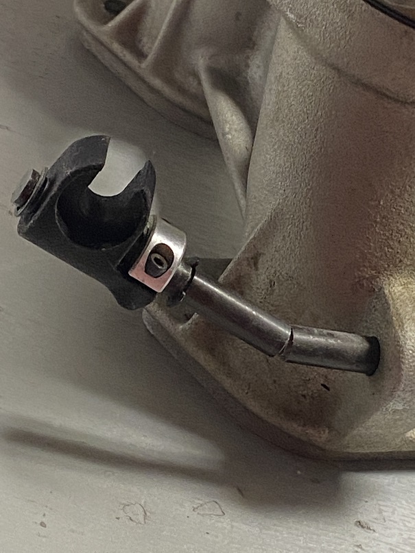

While they were packed pretty good, they failed to reinforce points that stick out with cardboard. Guys it's a must. They just poke through bubble wrap. Just take 2 minutes to make a little cardboard brace around stuff that sticks out. All the rain hat stands were bent from ping ponging off the sides of the box through the bubble wrap. Just assume the carriers are going to THROW your box. Base your packing on that.
Now I need a new shaft. I've pressed this one out already, but still, costs me so much time and energy to fix something that the seller could have easily prevented.
Also if you ship something that had gas in it at some point, either hide it with sealed plastic bags or take them apart partially and completely clear the gas out and let them dry.
My fed ex driver was livid. His whole truck was saturated in gas smell.
When I broke them down, there was probably 3-5 ounces of fuel in the fuel pump and carbs. :-/ Not to mention the danger of shipping this. I can't believe it made it to my house at all and didn't get flagged by the carrier.

914Sixer   Here is a quick fix on the lugs. Click to open. ...   Aug 20 2022, 11:01 AM
Graydingo   Thanks! I actually picked up that exact set, b...   Aug 20 2022, 11:09 AM
914Sixer   Stock lugs were 19mm heads, ones shown are 17mm. ...   Aug 20 2022, 11:54 AM
