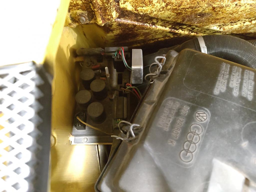

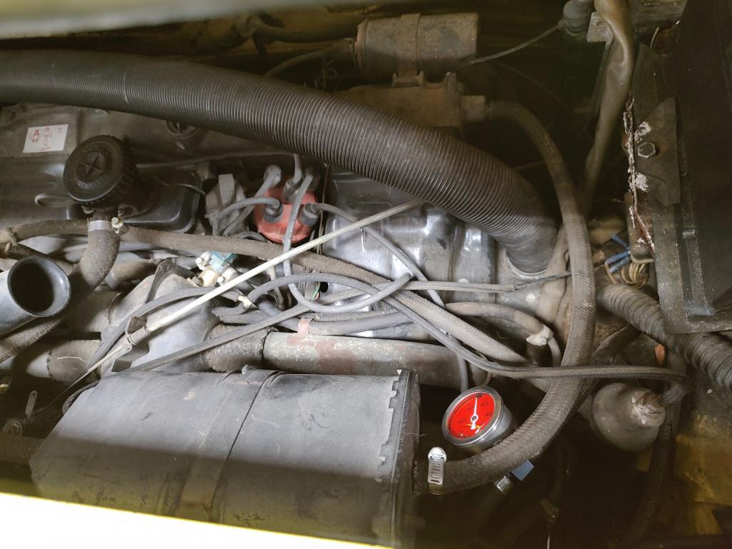

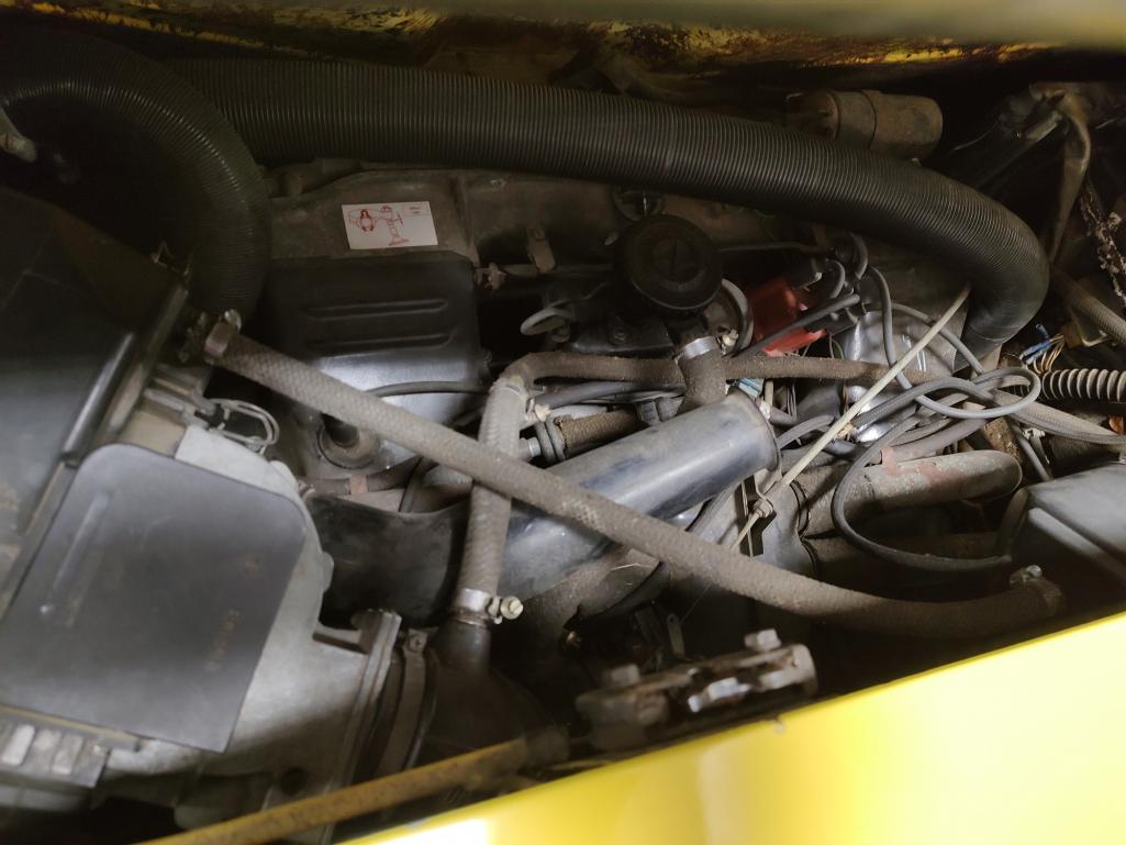

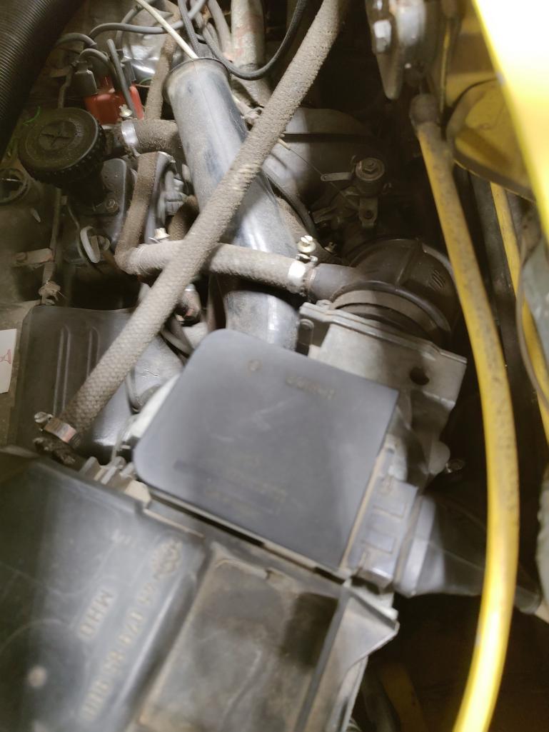

Here are some pictures of the engine bay. If there's anything I need to take in more detail, please let me know. Thank you!

Nor.Cal.914   Last one:   Oct 7 2024, 03:15 PM

wonkipop   looking close at one of your photos. something see...   Oct 7 2024, 10:24 PM
L-Jet914   That caught my attention too @wonkipop the wire ...   Oct 7 2024, 10:56 PM
wonkipop   That caught my attention too [b]@[url=http://www...   Oct 8 2024, 12:30 AM
wonkipop   i just noticed another thing. the fuse board or wh...   Oct 8 2024, 01:03 AM
