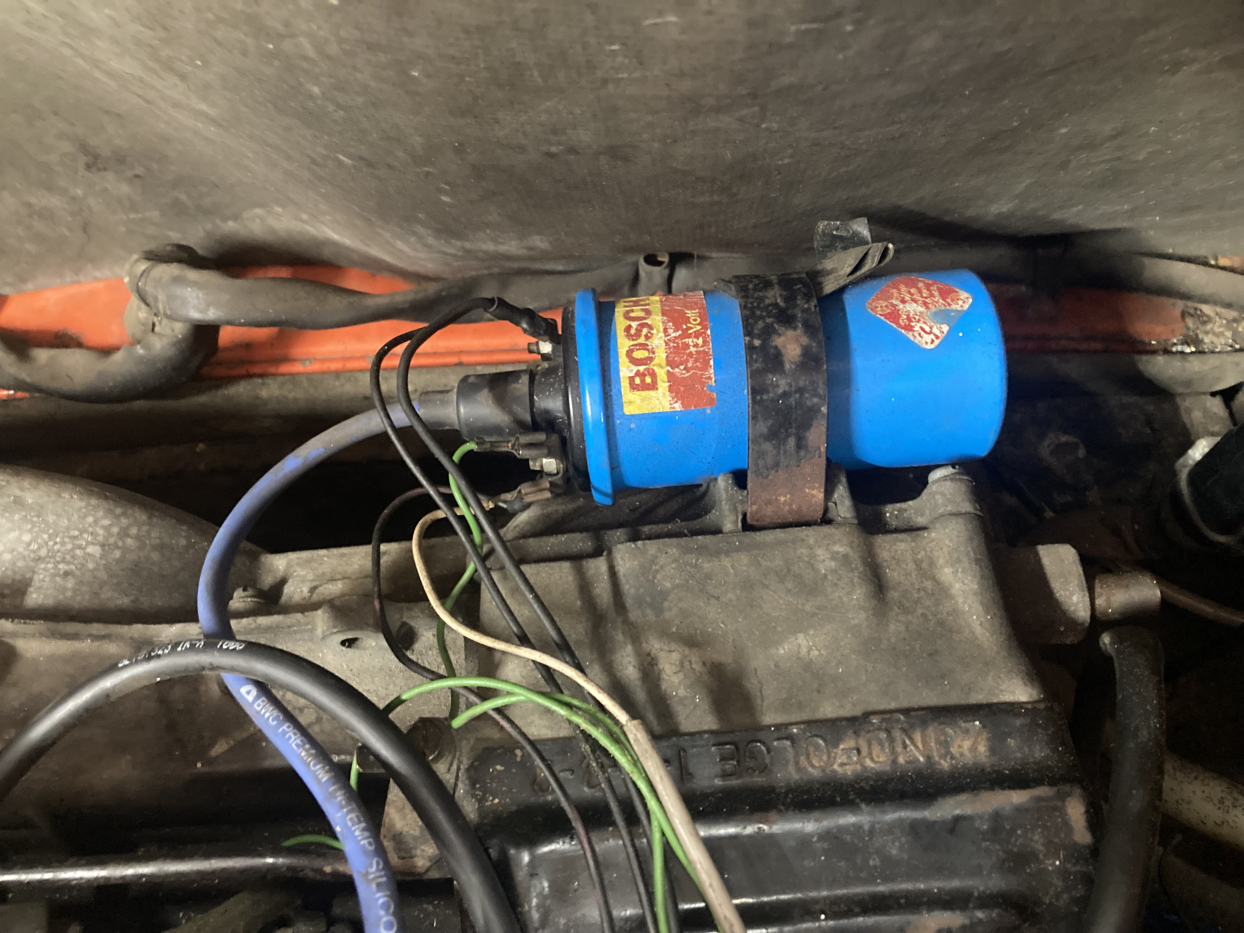

Is the fuel injection trigger wire connected to the coil?Attached Image
