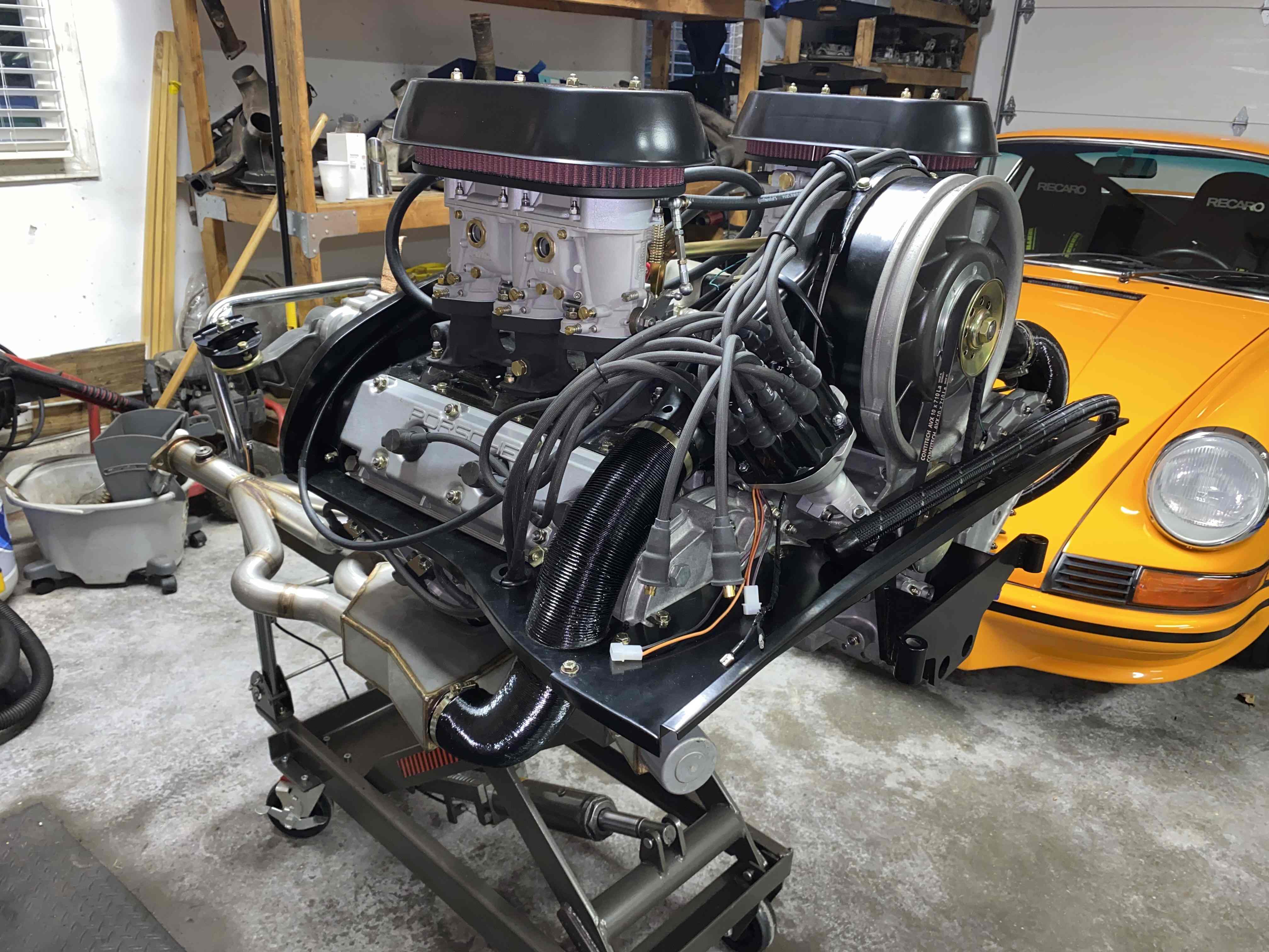

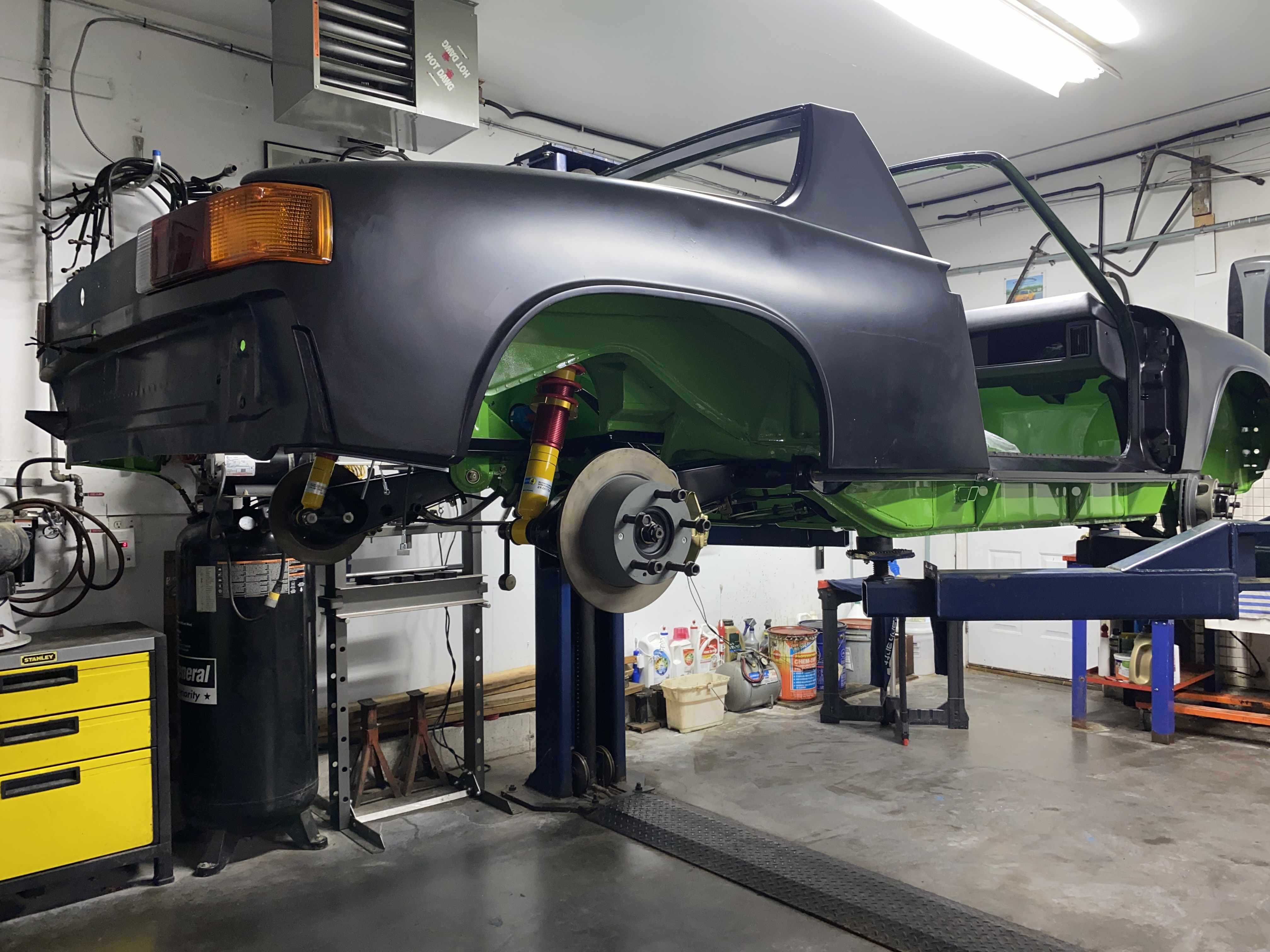

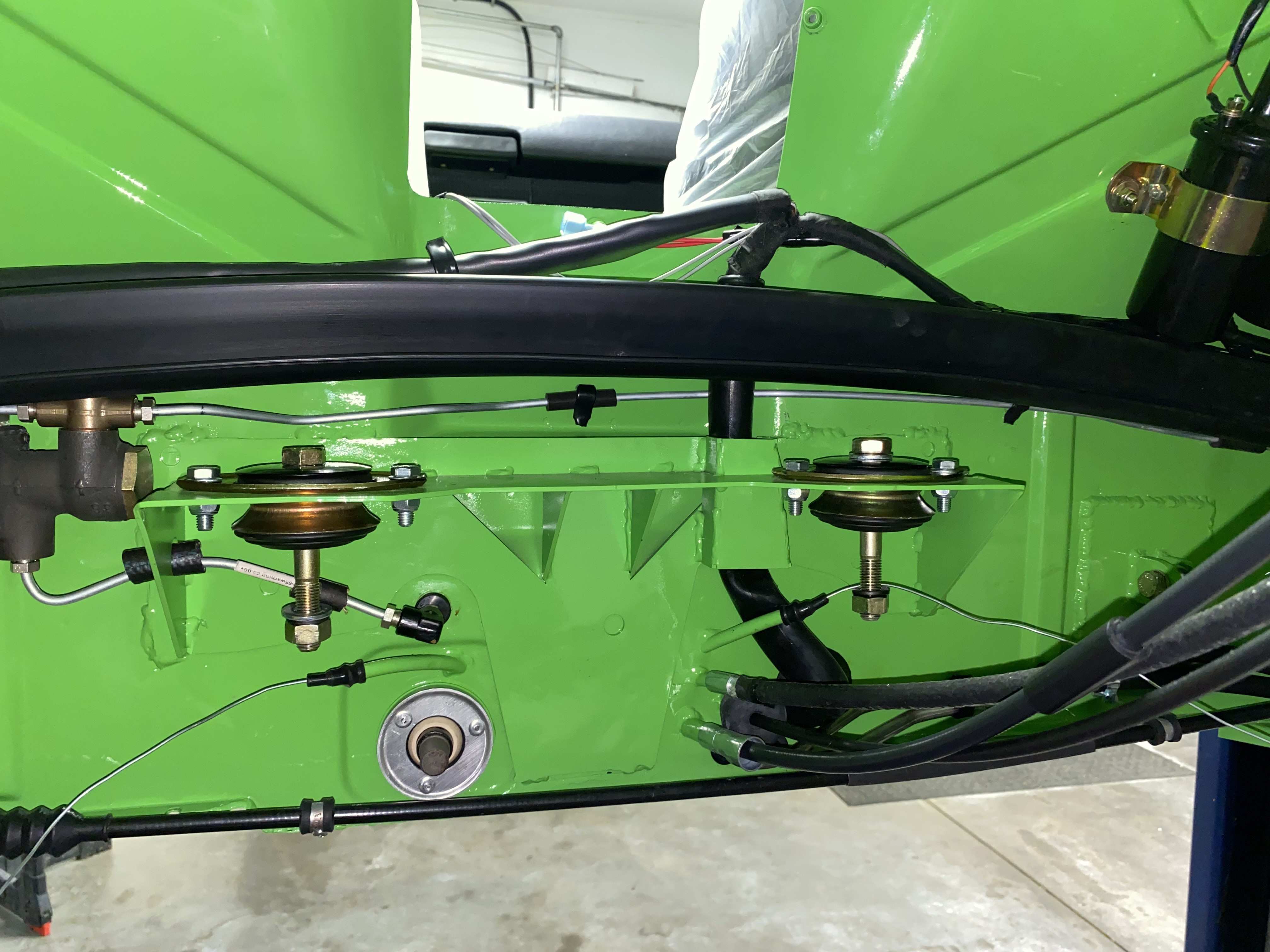

I have the car on my 2-post lift and the engine on my lift table. I am using the Mad Dog Motorsport bulkhead engine mount.
I plan to raise the engine on the lift table, lower the car on the lift and jockey the engine into position

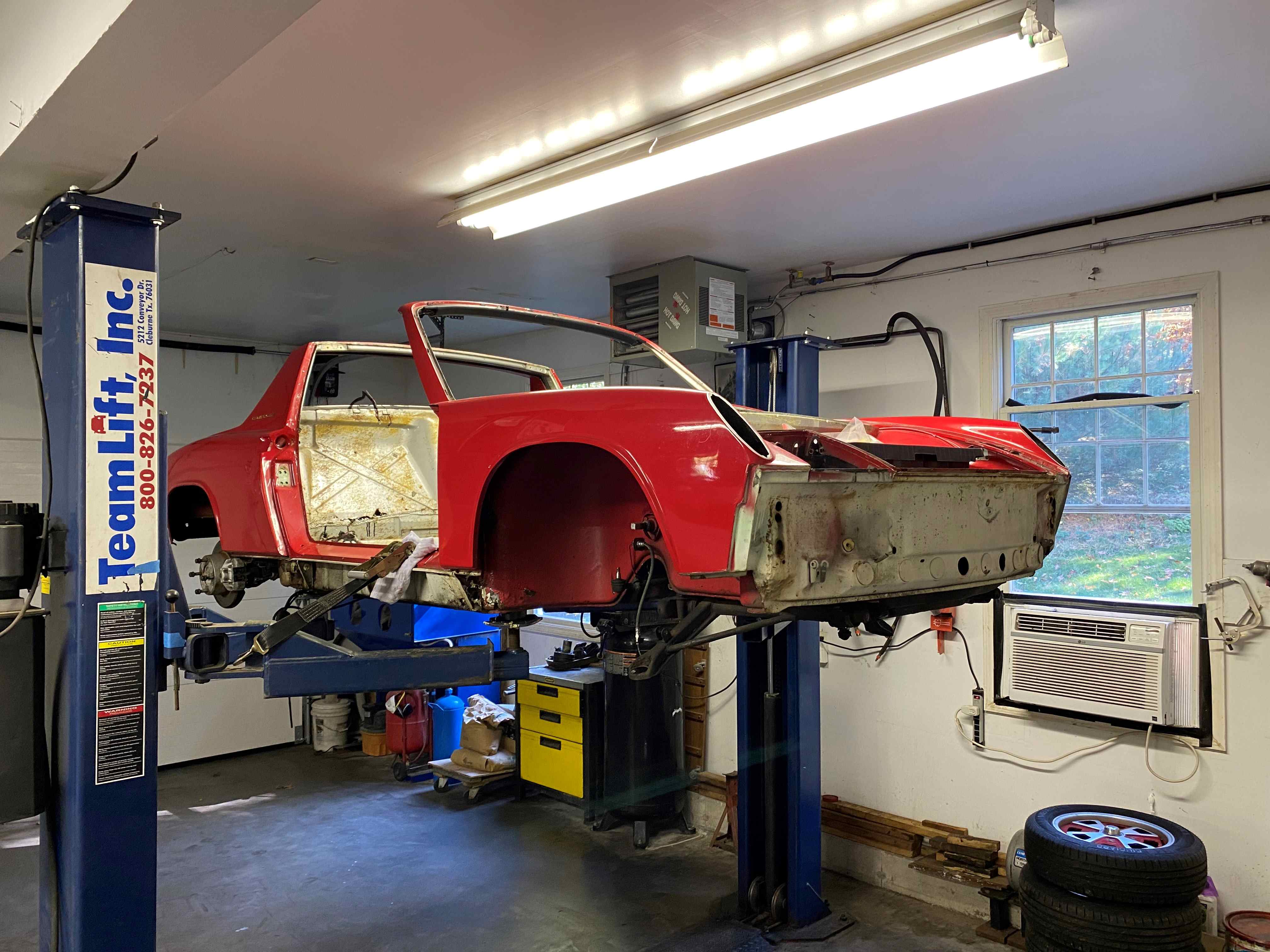

One of my concerns is the balance of the car on the lift as the heavy Aluminum case 3.2 short stroke engine is engine gets installed. I noticed that as I was disassembling the car on my lift that car was heavily weighted towards the rear before the engine and gearbox came out. I could almost tip the car backwards. I remedied this by running a jacking strap through the cockpit onto the arms of my lift to hold the car in place.
I am thinking I need to do this again before attempting the -6 engine install. Any thoughts or suggestions?

My lift is a 4 post, and my table has 4 casters, so lowering the car gradually and moving
the cart after the front tin clears the front mount was not too bad.
